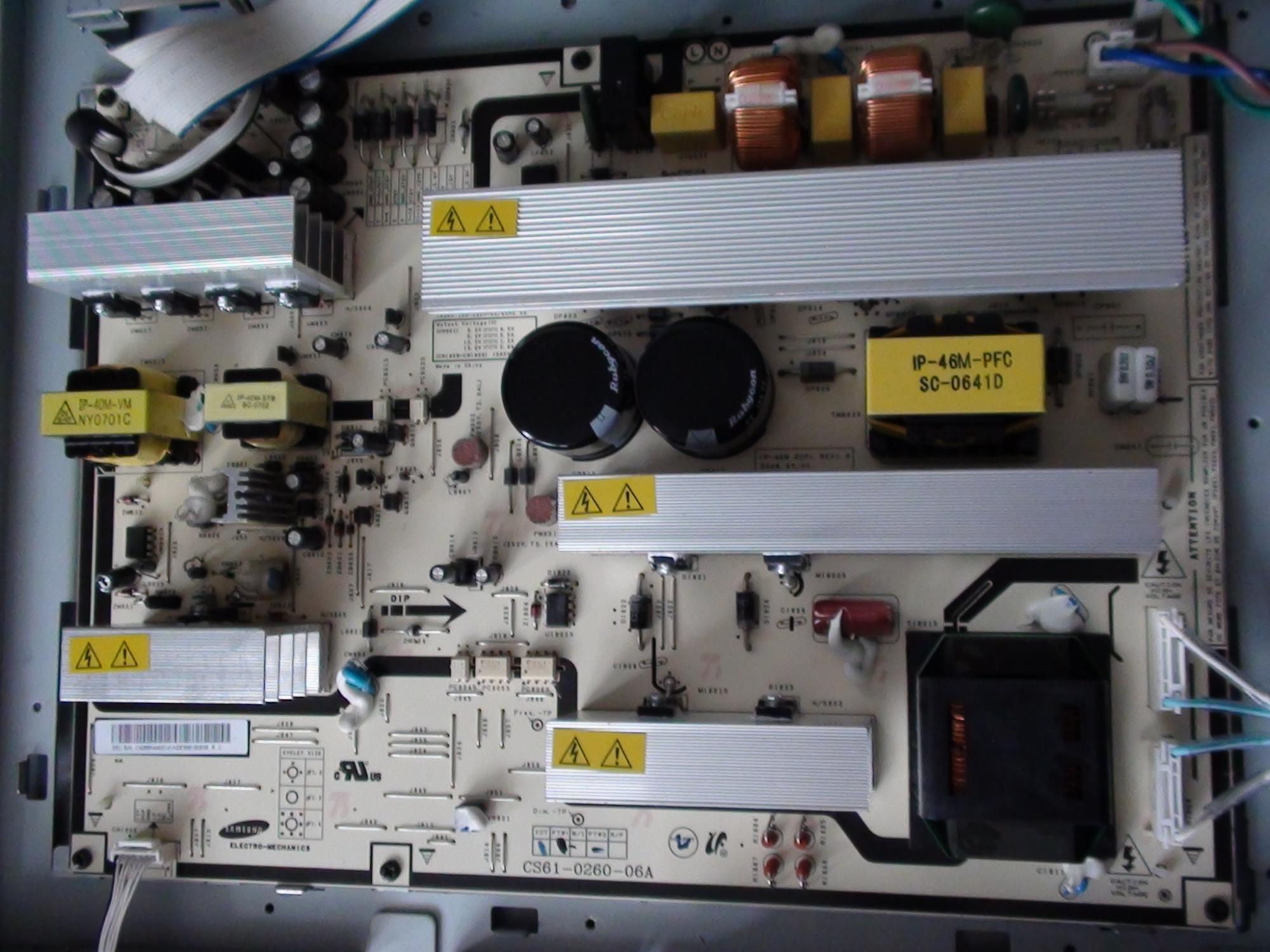

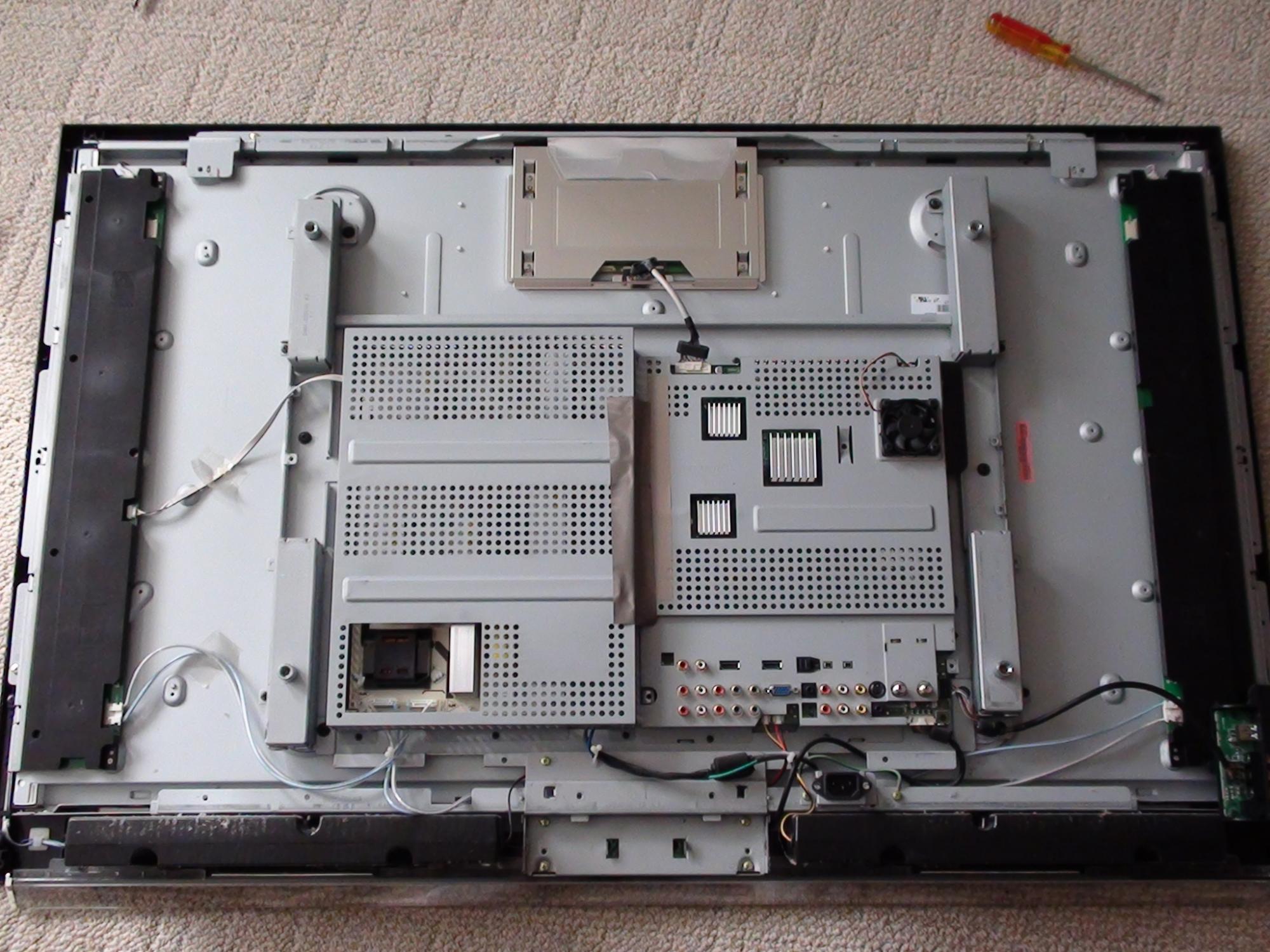

    Heres the deal.
    I'm a 17 year old highschool senior whose teacher had a bad TV they wanted to get rid of.. me being the savv tech geek i figured I can fix it... When I power it up it makes a clicking noise likes it gonna turn on, then a second later makes a similar noise and its off waits 2.5 seconds does it again... and again.. and again... I looked up and found that it is a Samsung well known issue.. bad capacators or something.. idk im not a TV geek, I work at Best Buy but noooooo geek squad member... The Model number is LNS4696DX/XAA... Any direction of what to do would be fabulous.. keep in mind.. IM A NOOB!!

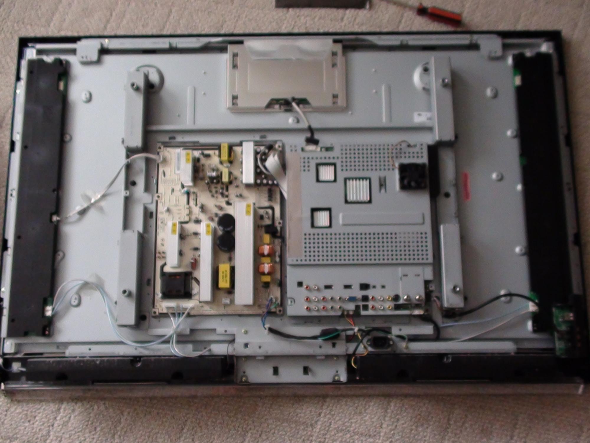

            Re: Heres the deal.
            Sorry haha misunderstood the question.. so what exactly am i taking pics of.. i just removed the back panel of the TV and idk where to go from here.. idk what these things look like.. remember.. COMPLETE NOOB :P

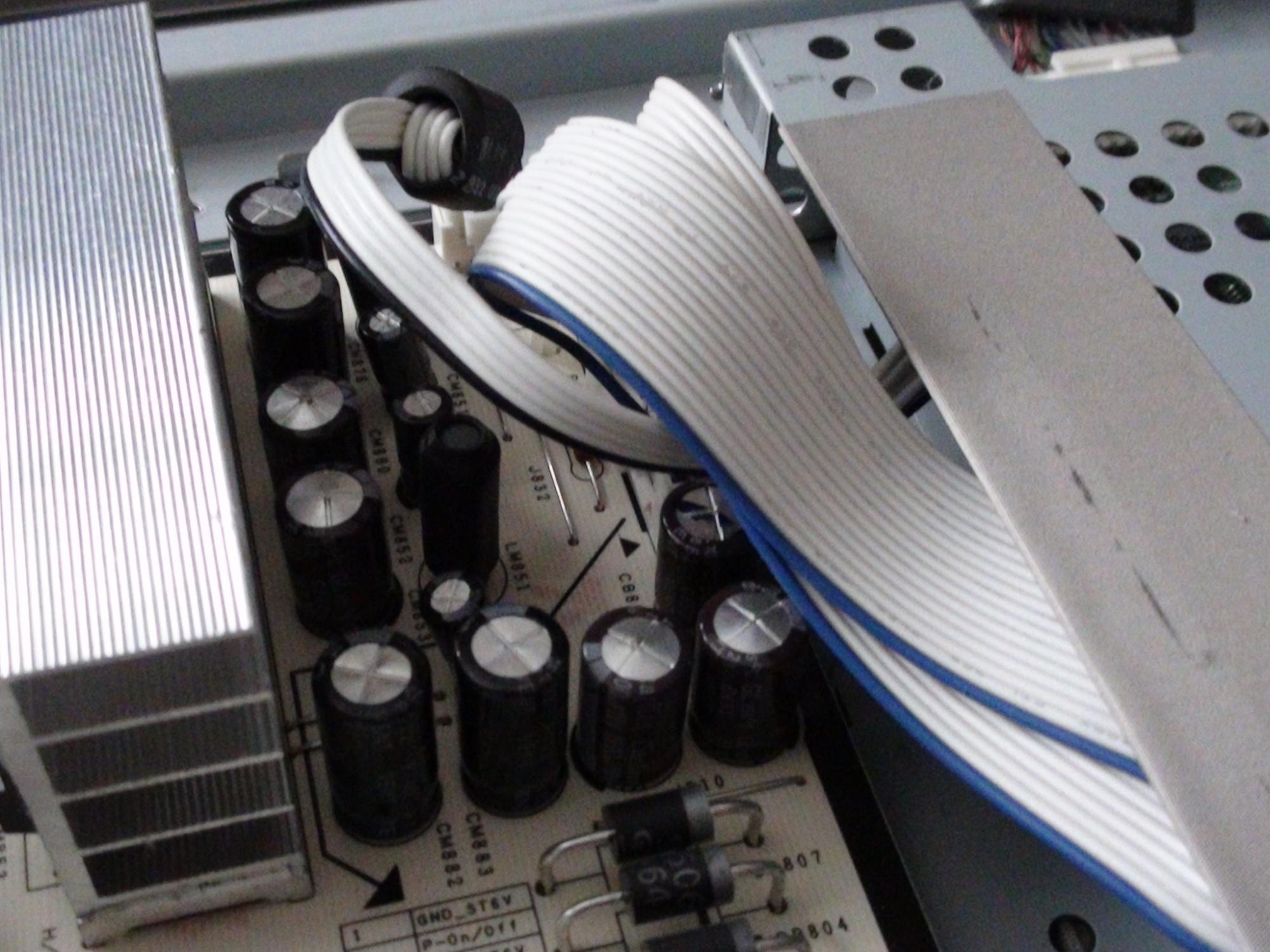

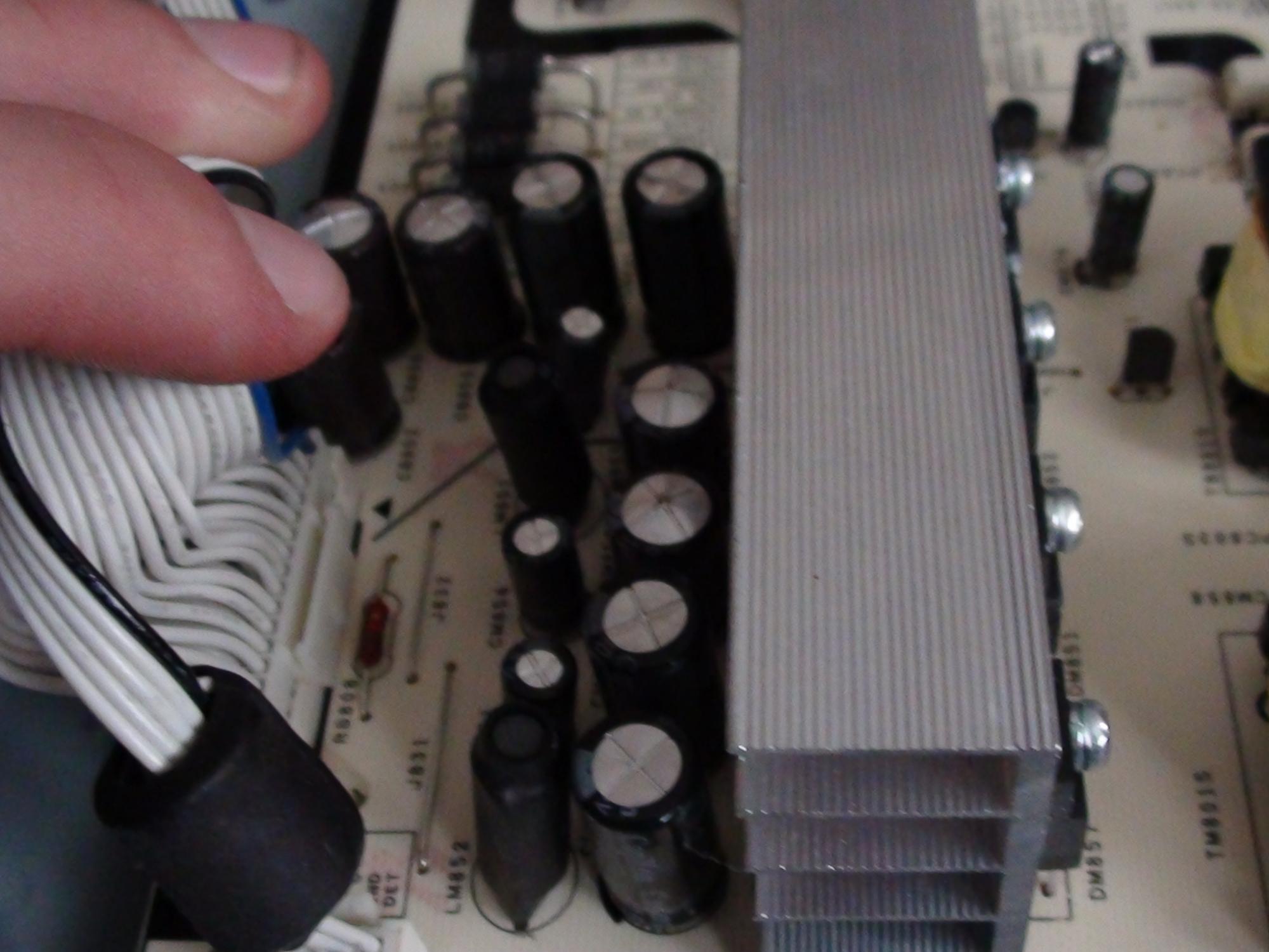

                    Re: Heres the deal.
                    I think I attached the pictures correctly.. If not im sorry for the non direct bump...
                    *EDIT*
                    I Think I'm in the right area.. I mean they kinda look like wat i was trying to find.. the other panel to the right thats covered just had heatsinks and fans.. my guess is the mobo is under there.. but if you need me to try to get a pic of that or clear some of these up.. lemme kno

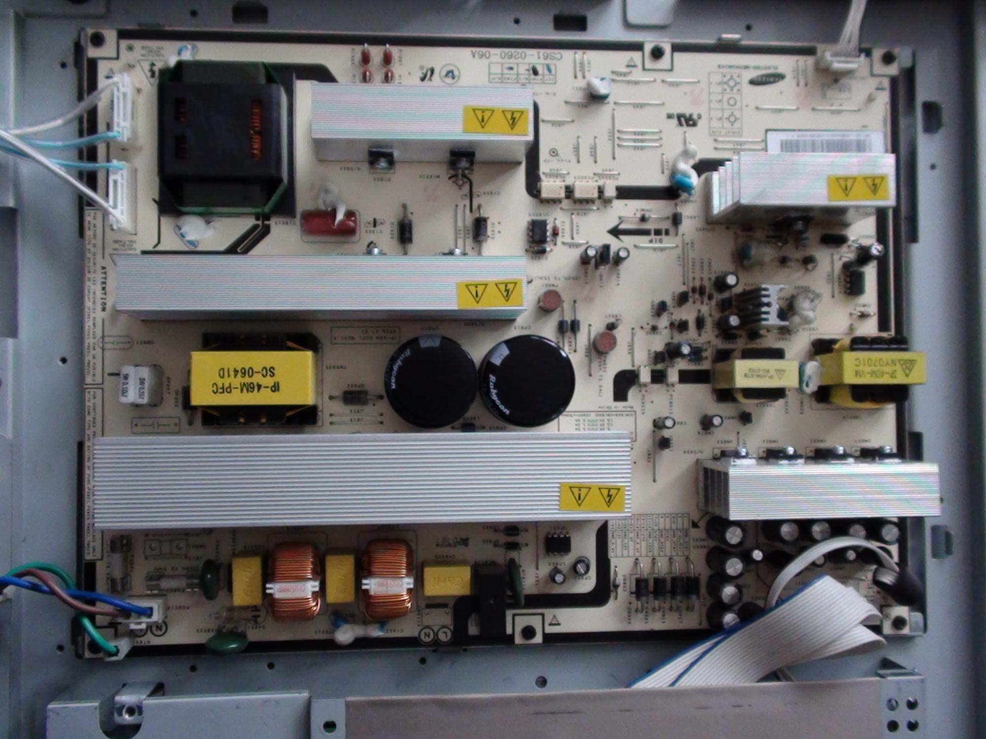

                      Re: Heres the deal.
                      Now that's more like it. Could you get a close-up of the group of capacitors in the corner of the board? They look bloated but i can't tell for sure.

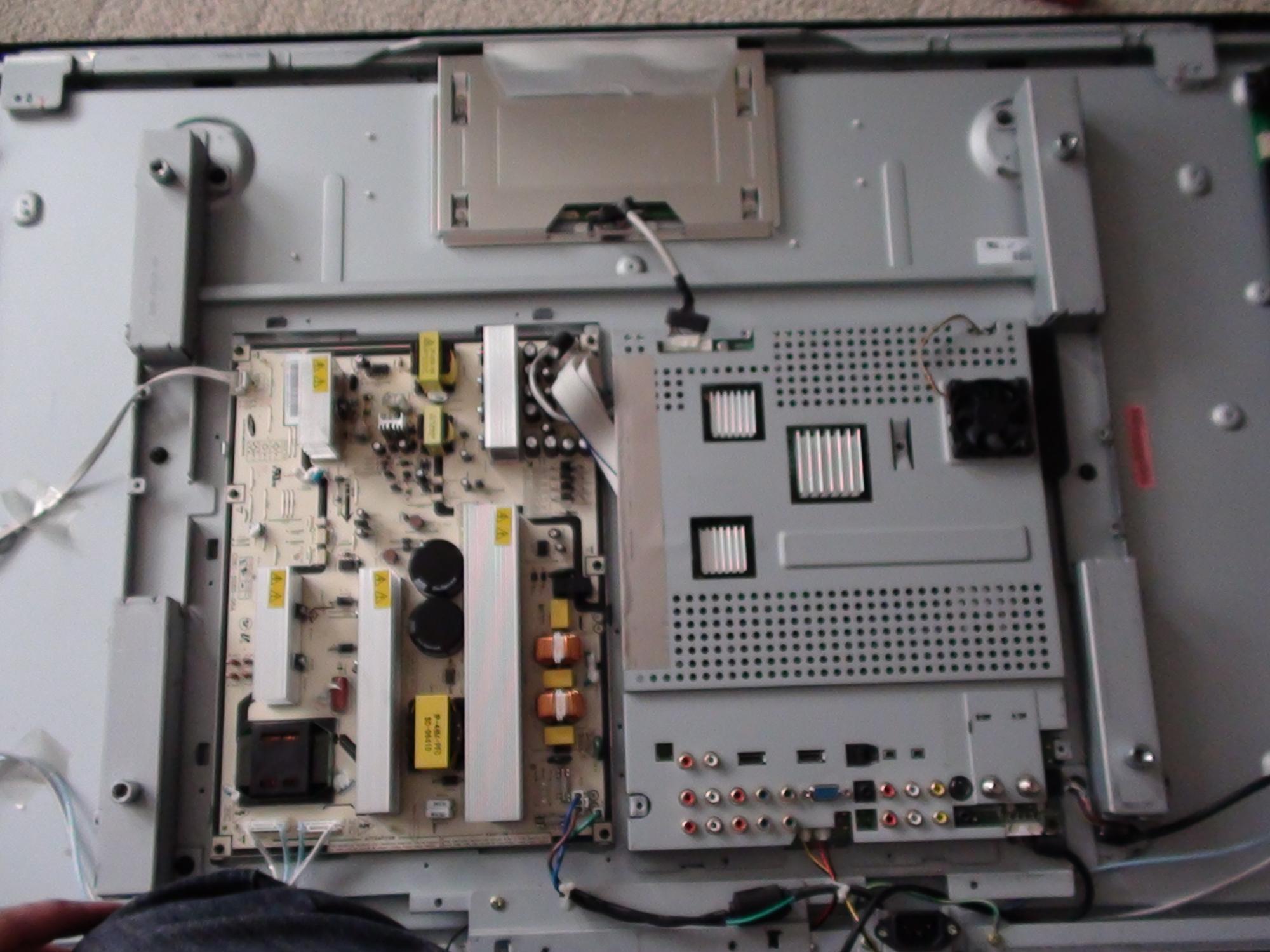

                        Re: Heres the deal.
                        Not sure, but are some of the caps in pic 4 bloated on top? Bottom right of pic.

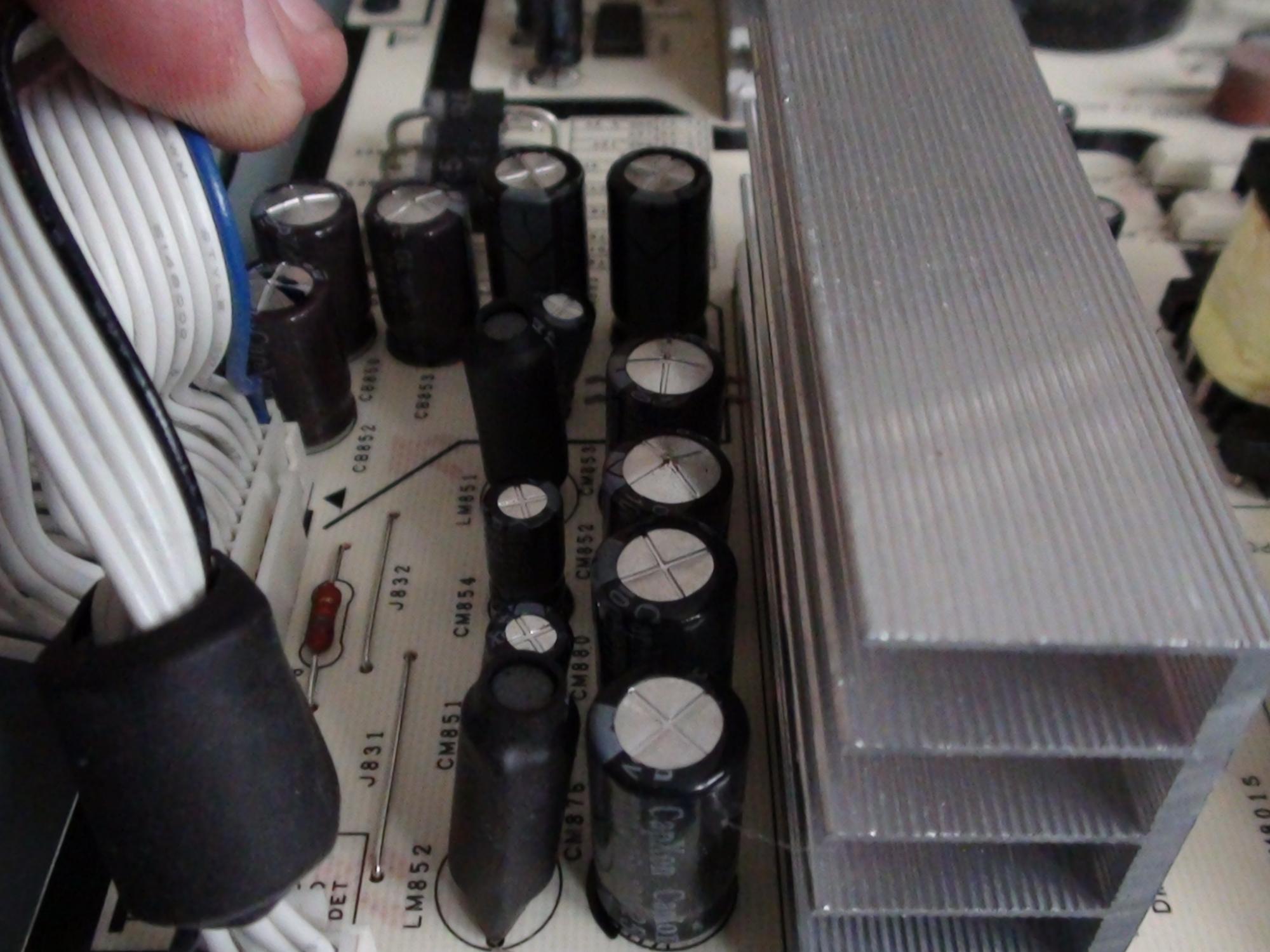

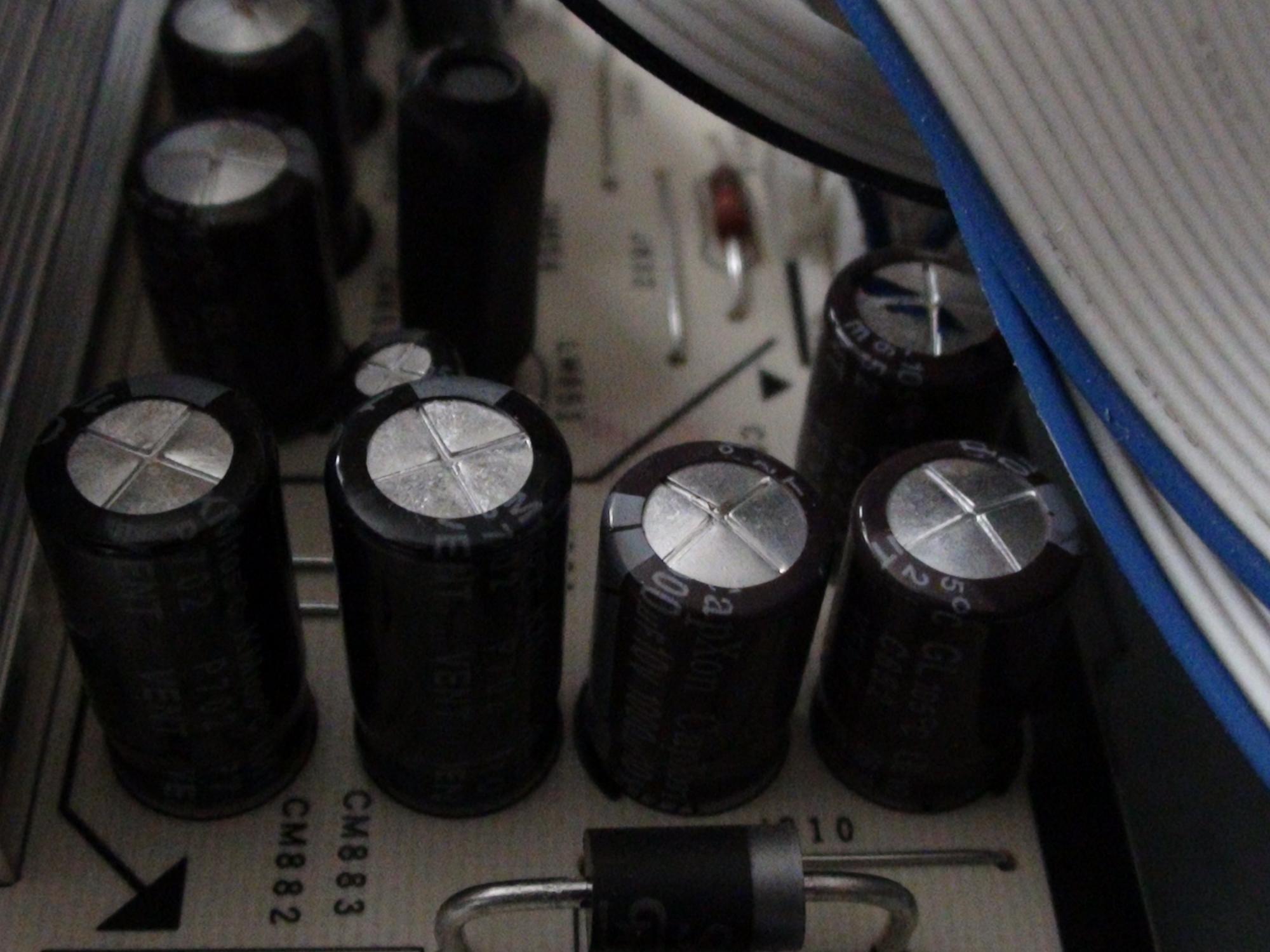

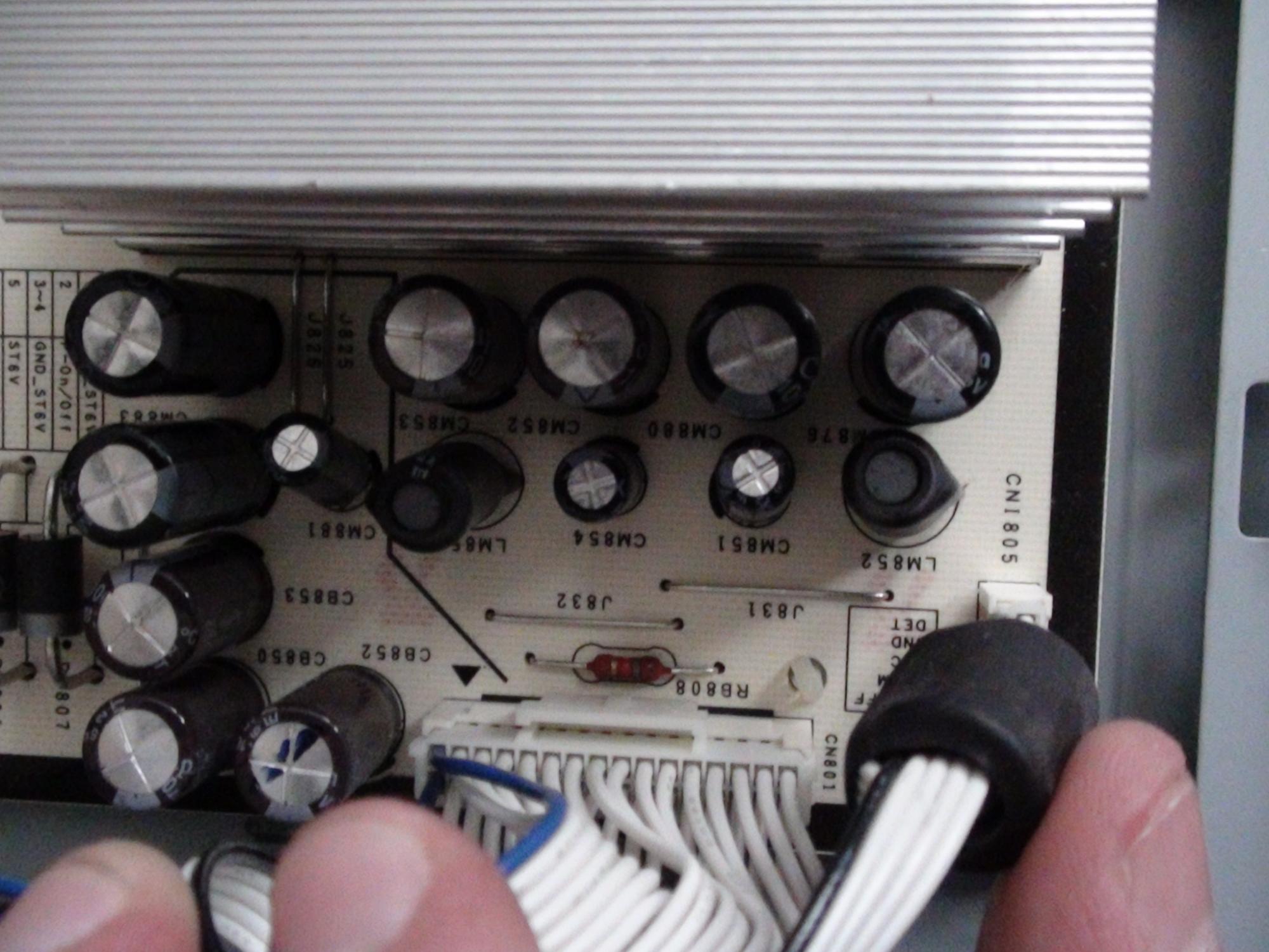

                          Re: Heres the deal.
                          Are these what you guys are looking for?? How did you tell they were bloated from that far away.. You guys are SICK!!
                          • steve2
                            • Dec 2010
                            • 121
                            Re: Heres the deal.
                            Yes, that's what you look for. All those bloated caps are bad and Should change all the others of that brand also that are in the area. If those caps are all over the board. I personally would change them all. What brand are they? Scratch the brand, After delawares post I looked again to see they are capxon.

                              Re: Heres the deal.
                              Make all 12 Capxon caps in the last photo go away. Panasonic FC or FM series are a good choice.

                                Re: Heres the deal.
                                It's easy: the tops of the caps are raised on at least one of them is actually leaking. The larger ones appear to be 1000uF, 10Volt. What series Capxons are they? Usually it's a 2 or 3-letter code (such as FC) near the temp rating.
                                If you're going to replace them, the sizes are important because if they're too tall you can't put the back on the TV without hitting them. If the diameter is too large you won't be able to fit them in if in tight placement.
                                Presuming you're in the US, Mouser and Digikey are good, reliable sources for parts. DON'T rely on Radioshack for capacitors. Their capacitors are general purpose and will not work reliably in power supplies and computers (SMPS-Switch-Mode Power Supply).

                                  Re: Heres the deal.
                                  They are also polarity sensitive. Look at them before you start taking it apart and note where the white stripe is. Then look at the board to see how they marked it for negative. Could be colored white or may just have a +at the other side. I f you put one in backwards, you will know as soon as power is applied. If you know someone at the geek squad where you work, they may be able to solder it for you.

                                      Re: Heres the deal.
                                      They will be marked with ???UF which is the capacitance. They will have 85c or 105c for the temp range. Usually have a series FC, Fm , Hm, etc. You would want to try to match that series or upgrade it. Then you have the voltage rating which is how many volts it can handle. I didn't figure to take the whole tv in to geek squad. Just the board with the bad caps.

                                        Re: Heres the deal.
                                        I've already spotted these capacitors in that corner, replace just the bloaters with good quality capacitors, all you need are the uF and voltage info. Rest will last for long time.
