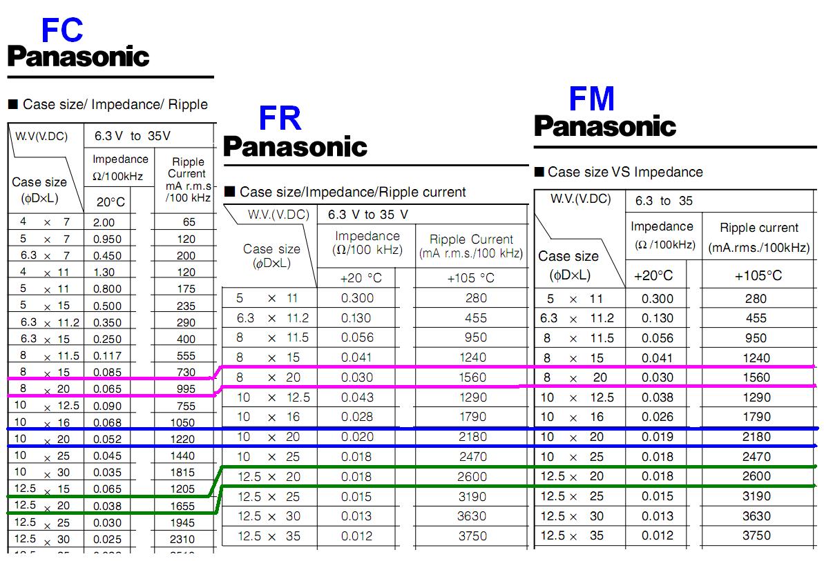

        When comparing 'grade' look at the same size cap between series.
        I use 8x20mm, 10x20mm, and 12.5x20mm both out of habit and because most all series have those sizes.
        Look at can size, ESR, and Ripple in my doctored data sheet screen shots.
        - First notice that they even have a "Can Size / ESR / Ripple chart".
        - That's because ESR and Ripple are based on the Can Size - WITHIN EACH SERIES.
        You will notice that FR and FM are the same 'grade'. [apart from a slight difference in the 10mm ESR]
        FC are lower grade.
        In -each series- as can size goes up the ratings get better.
        However, the FC is a far enough lower grade that the 10x20mm FC is rated lower than the 8x20mm FR and FM. [Even though it is larger.]

          Even better. Thanks. This would be helpful almost in a FAQs section or stickied.

            What is better than what gets trickier as the grades get closer together because different series' might have different Can Sizes.
