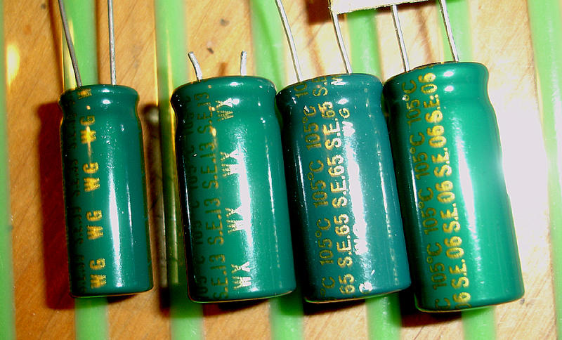

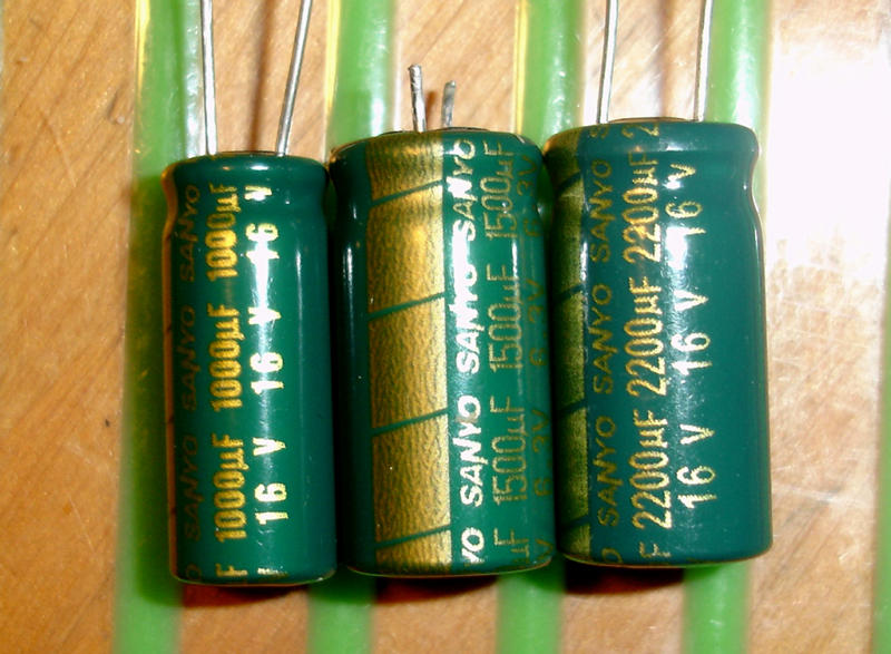

    So I opened ip my caps box and took a few measurements on some caps I bought, before I got wiser.
    There are 16v 1000uf 10mm, 16v 1000uf 8mm, 6.3v 1500uf (real & used), and 16v 2200uf.

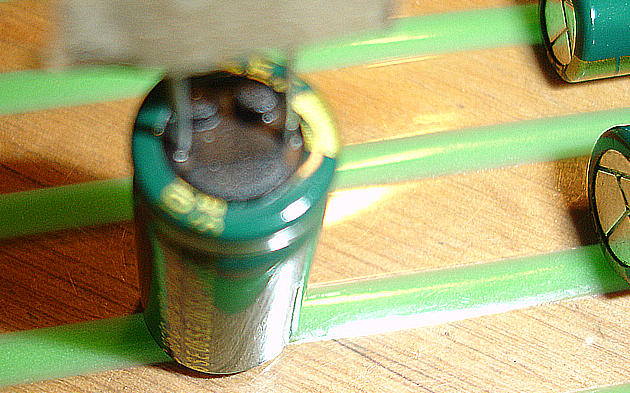

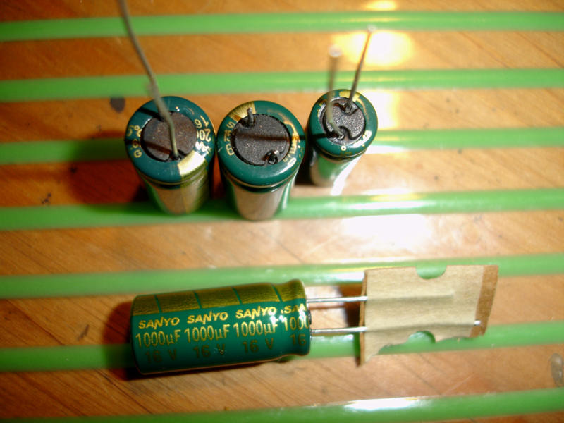

    The 16v 1000 10mm have no series identifier. Their ESR is .03, their capacitance is 1050. They are consistent from cap to cap. They have an elaborate bung with three projections. Their colour matches that of the used ones I have taken off motherboards. I think these are real.
    The 16v 1000uf 8mm are .015 ESR, capacitance 980, consistent for the lot. Series is WG.
    The 6.3v 1500s came off an Asus TUSLC-2 I recapped. I measure their ESR at .02 and their capacitance ar 2100 (yes). They are WX series.
    The 16v 2200uf are a bit of a muddier green than the others. Their is a "wave" in the series lettering. ESR is .02 but the capcitance is 1550(!) and there are variances among
    them. I believe these are fake.
    All have the "K" on the top. Pictures were blurry so I did not post.
    Do you see more fakes than the 2200s?
