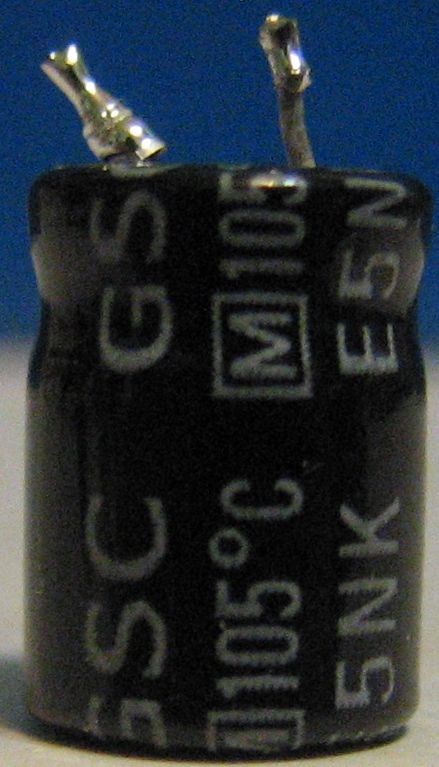

                  Now that we're on the topic of this defunct manufacturer, I have a "GSC" cap, which uses a similar namesake to this Evercon cap, and I would love to know it's official specification:
                  "E5NK", 16V 470uF.

                    I would love to know too.. But I've looked and looked and I just can't find a damn thing
                    -David VanHorn

                          How can I check if my GSC cap is non-polar? I'm asking because I find two interesting references to an "NK" series capacitor one from Capxon and one from Jamicon, both of which are non polarized.
                          Is it possible to have a non-polar capacitor on a motherboard? Maybe for the sound subsystem? Though it is right next to the PCIe x16 port.
                            Not likely. All i've seen have a large NP printed on them, and are significantly larger than a polarized cap of the same value (that's normal since they are two caps in one).

                                You're right. The dimensions are wrong. The Capxon NK is 10x16 and the Jamicon is 12.5x25. Mine is 8x11.5.
                                But still I can't help but wonder, the 330uF 6.3 Capxon NK is 8x11.5. If I had the datasheet for this motherboard, would it indicate whether a bipolar cap should be placed there?
