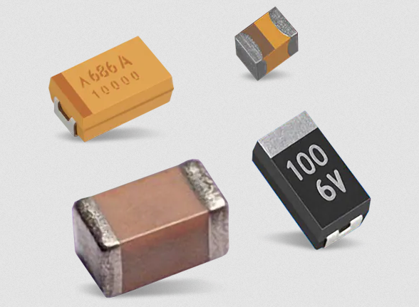

    Lately I've been refurbing and modding a lot of gameboy consoles and usually their main filter cap is 100uf 6v. I've been pulling 100 and 150uf 6v tantalum caps from dead macbook logic boards and using them in place of the original electrolytic. They are small and solder in quite nicely. It's my understanding these are solid state with really low ESR and should outlast the console. Is there a difference between the yellow and black ones? Should I avoid tantalums in certain circumstances like audio circuits?

    i think the yellow and the black/white ones are the same.
    be a bit carefull about black ones that are laser-etched - some are polymer and have a higher capacitance than you would expect.

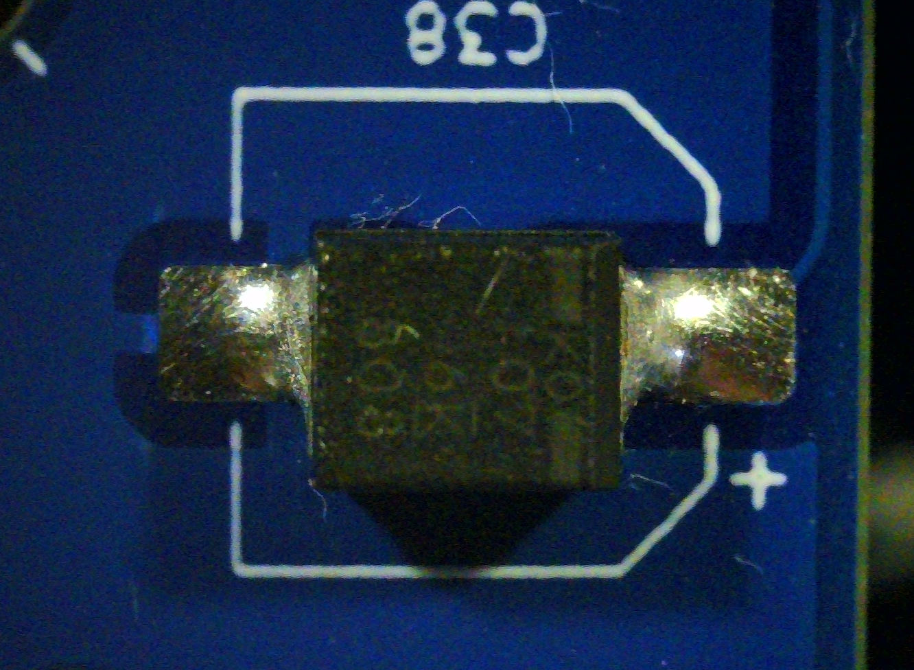

        cracked tantalum cap on a video card. safe to apply power without fireworks?
        by ChaosLegionnaire
        please refer to the attached pics. is it safe to apply power with that tantalum cap like that without causing fireworks? i dont wanna burn a hole through the pcb as the gpu chip is on the other side.
        happened to me once before with a shorted mlcc. shorted mlcc on a vrm power phase burned a hole through the pcb power section but thankfully that was nowhere near the gpu chip. but the video card still ended up in the landfill anyway tho as the burn-through was not fixable.
        so do let me know what u think of the chipped tantalum there. thanks....

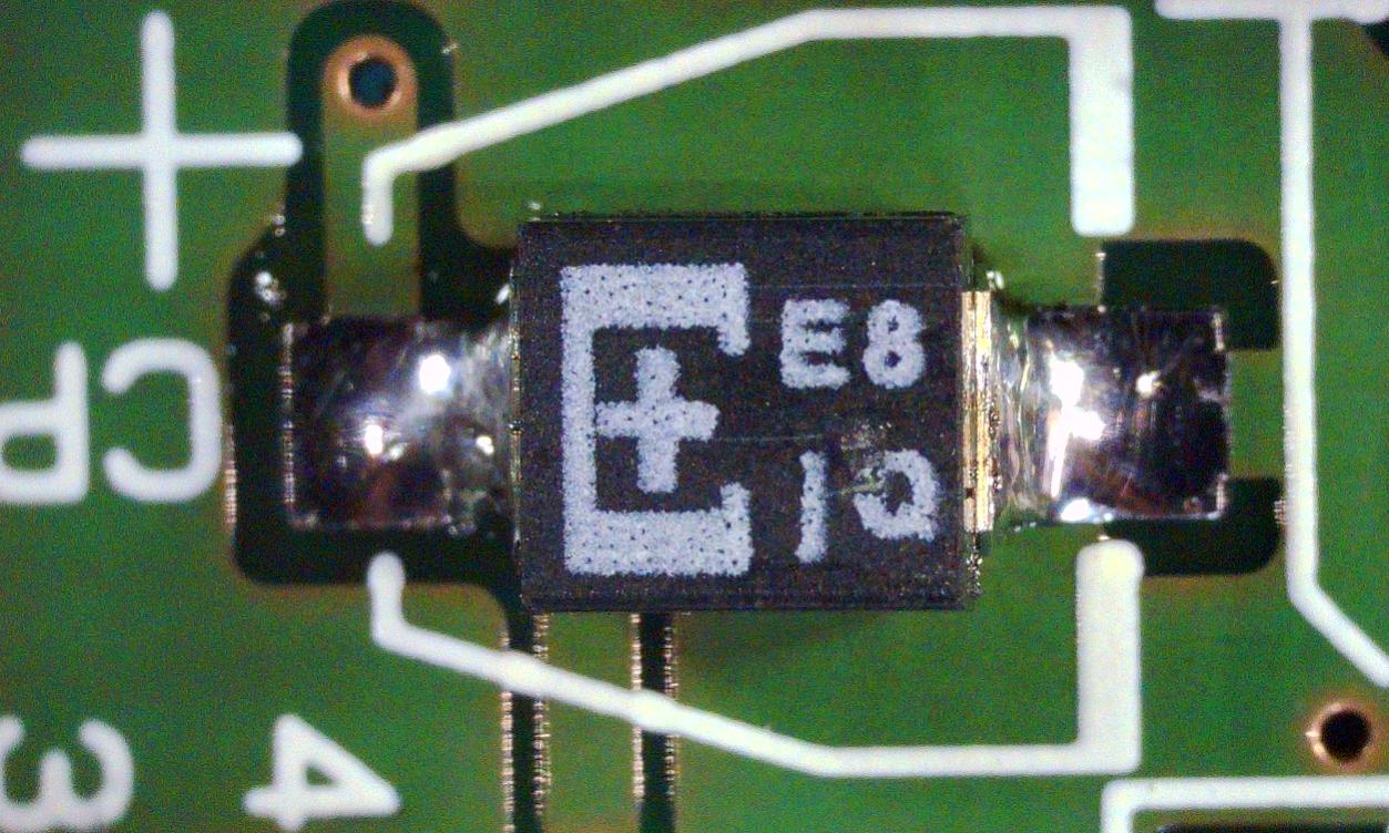

        Help Identifying a Tantalum Capactior!!!!! 68 C79 Please help!!
        by jrutla2
        Hello BadCaps Forum! I'm new to the group and hope you guys can help me with something. I have a 2017 Apple imac A1419 board # 820-00609-A that i'm trying to identify a capacitor failure on. The capacitor is a tantalum 68 C79. See pic attached. I've tried to figure this out using the web and unfortunately can't find the information. Can someone tell me what the Capacitance value, voltage, etc is for these 68 C79 caps are? Where could i pick up a replacement? Thanks in advance!!...
