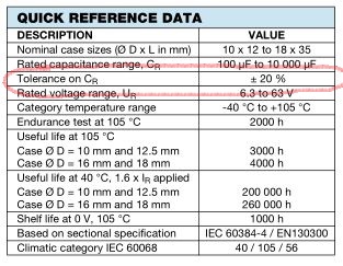

      Re: capacitor value too high
      Specs
        yes, but thats VR, in the real world at room temperature your going to get -20% and +nothing%.
        they are never over - i'v always suspected they are graded at the factory for special customers.
        and i have seen many dozens of caps read over-value.
        every one had internal leakage on my tester
          Oh yes, you're right in this aspect /still can't wake up/
