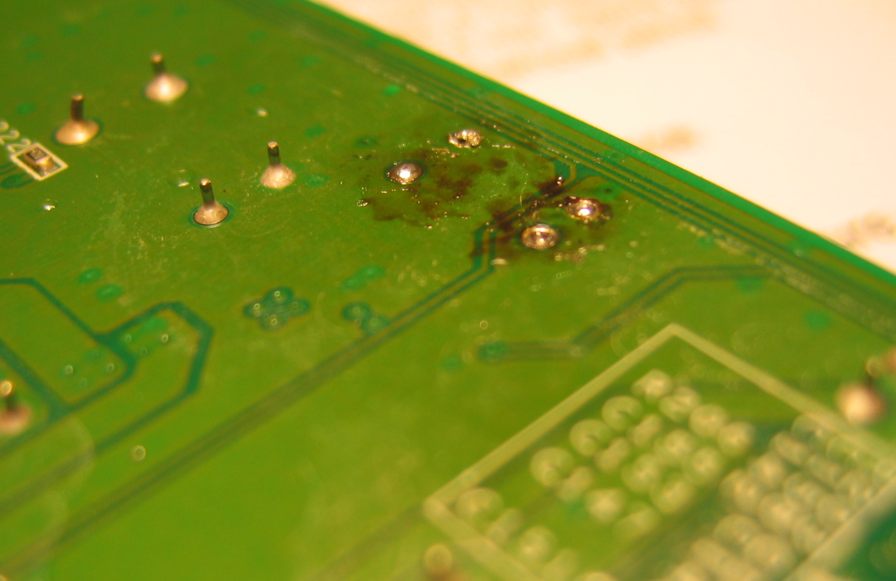

    Hey guys,
    I just started soldering and this forum has been a godsend for information!
    One thing I couldn't really find though, was how to tell if you've caused heat damage to the board you are working on. I've got a terrible soldering iron (I'm in the process of finding a replacement) and I'm afraid I may have spent too long desoldering some capacitors and therefore caused damage to the board.
    Is there a way to tell based on visuals alone? I noticed that the flux was turning slightly brown which is what made me worry. It's also possible that the board I am working on has lead free solder on it, making it very difficult to remove.
    Thanks for your help!
    -Tom

    An acid brush as well as alcohol will remove the flux, even if it is brown. Sometimes it will even flake off when lightly scraped at. As far as damage to the board, I wouldnt worry unless there are pads lifing up due to direct heat exposure. Sure, sometimes it doesnt look pretty due to having to work with sub standard soldering equipment but... if it works, it works.

                Thanks for the info guys! I don't really plan on selling my monitor so using lead solder is not a problem.
                I guess the brownish flux is not a big deal either. How about the the boards then? Is there a way to tell just by looking whether or not it is damaged?

                  We can take a look just for kicks - if you post pictures of this repair. It wont tell us much but it wont hurt.
                  By the way, the flux is a problem due to it's conductivity. I have had failures before due to flux. This needs to be cleaned off with alcohol. Alcohol desolves it.

                    Just had the chance to take a photo of this.
                    What do you guys think? I'm still trying to remove the solder from the holes...it's a pain in the neck!
                      • 31214
                      Re: Burned boards?
                      looks like flux to me.
                      can you scrape it off?

                        @op looks like flux on that pic, and based on own experience i dont think the board is damaged by heat, to me doesnt look that bad (not yet, at least ) but thats jm2c

                          The board looks ok. Clean it up an see what you got. Sometimes I use a Q-tip (cotton swab) with alcohol if I dont have an acid brush available.
