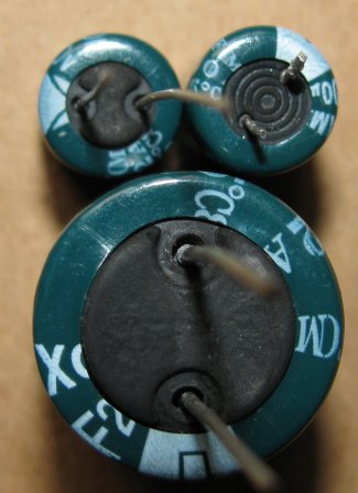

    Bottom and top left: SamXons which appear to be genuine - can you please confirm?
    Top right: Suspect SamXon pulled out of a Strong SRT5405 with 'circles' rubber bung.
    All are GF series.

        Yes they are genuine Samxon and by genuine I mean genuine crap chuck them into the nearest garbage can.
        GF was a lemon Samxon series tons of monitor inverters are plagued with these bulgers.
        That bullseye bung looks fishy though I haven't dealt with enough Samxon caps to determine if that design is in character for them.

          The one in the upper right appears to be a fake. Thats not a bung type I've ever seen on a genuine Samxon cap....and its no mystery that there were some Samxon fakes running around. Yes, I have seen some legit bad GF series in some older monitors, but nothing recent.

            He told me that pics of the other sides of the capacitors are needed
            Apparently Samxon did use some different bung designs in production...
            (So the bung can't tell you if it's a fake Samxon or not)

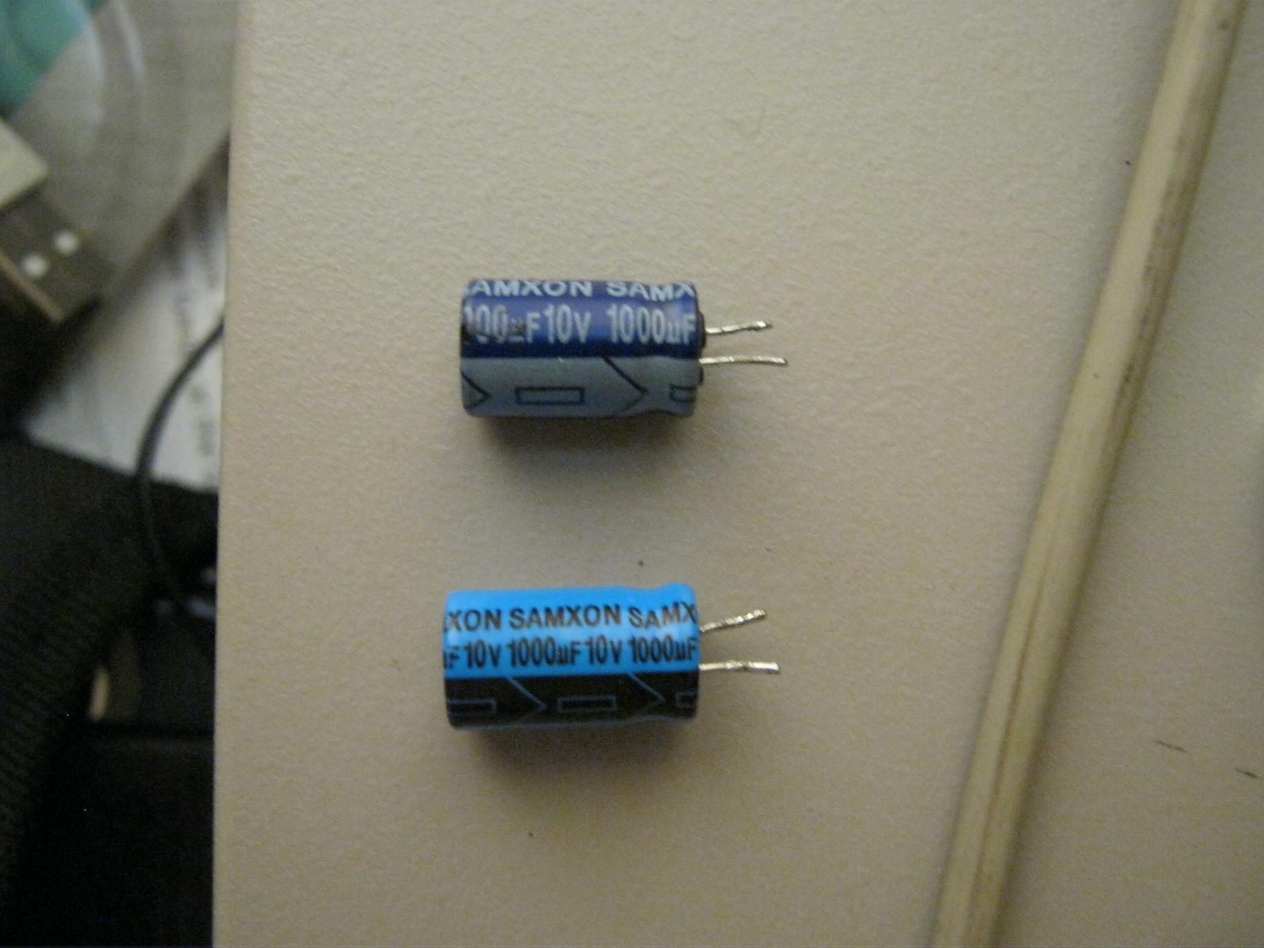

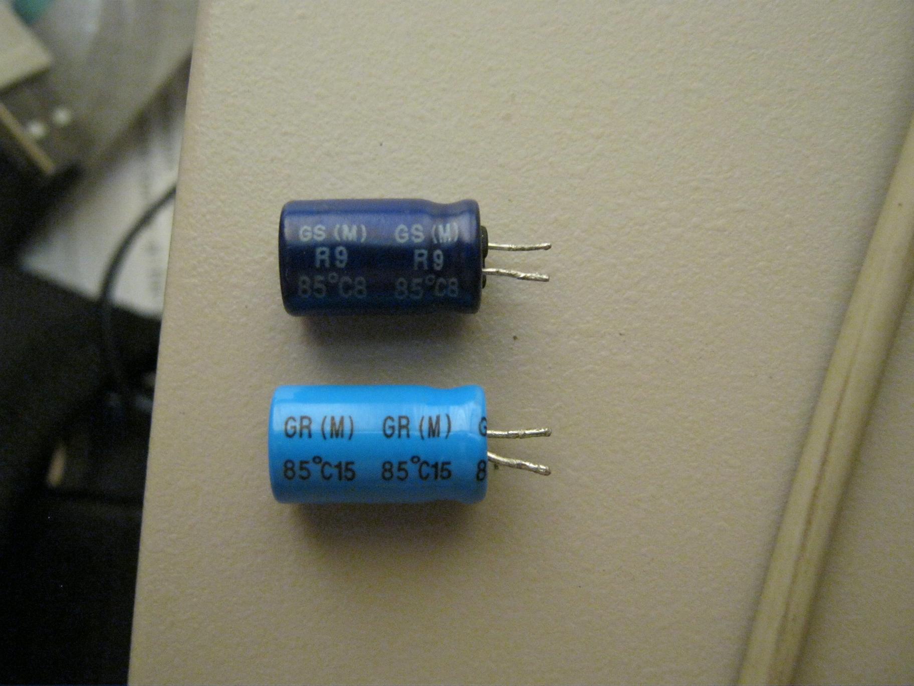

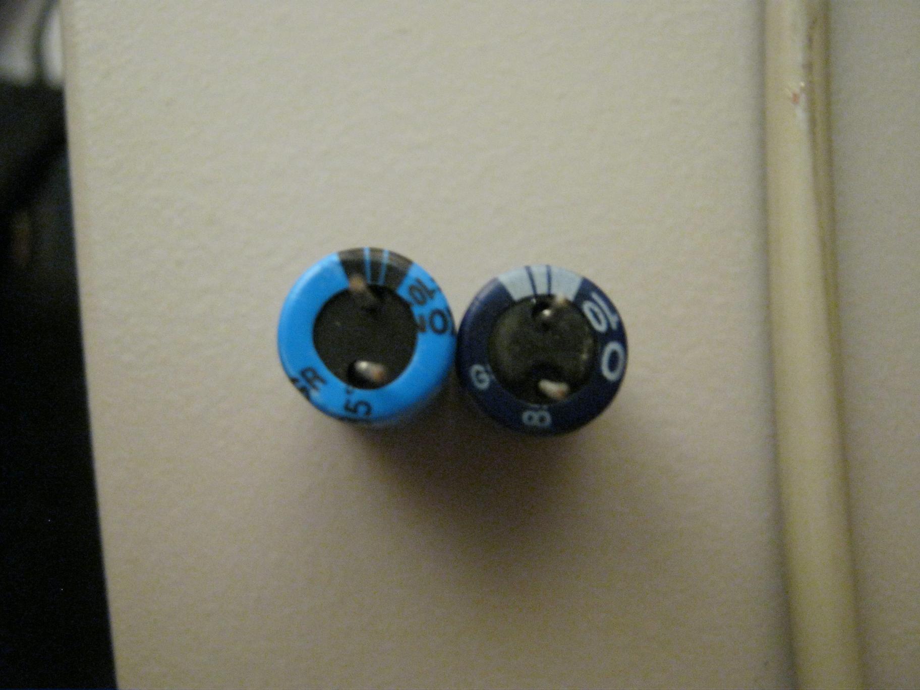

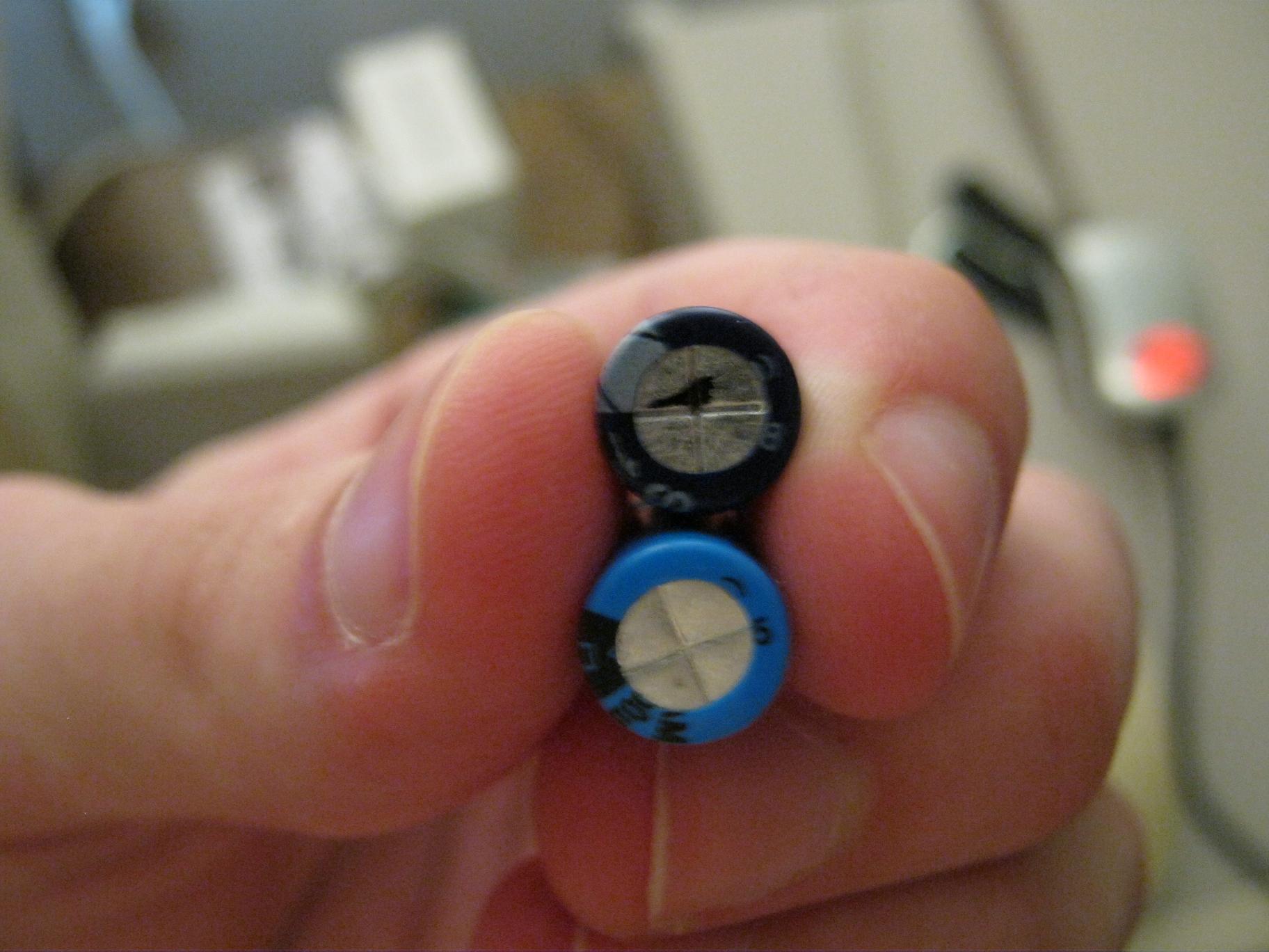

              I have a Samxon GR with a completely flat bung (it doesn't even have the "bullseye" pattern). Here are four pictures comparing it to a Samxon GS. Both caps were found in a Dymo label printer.

                I have been informed by PCBONEZ and Topcat that "experimental" Samxon caps do indeed have concentric (Bullseye) bungs. So if you get Samxon RS with such a bung, it is not a fake.

                    I looked at my stock [RS and GD] and the bungs are smooth like the light blue GR.
                    Samxon is a Chinese company [or rather that's where their factories are] that started making their own aluminum foils [and presumably aluminum cans] in house a few years ago so now their aluminum quality is consistent.
                    I'm guessing they still outsource the bungs so the style varies.
                    - Just a guess.

                      The GS has the same bung I have seen in most Samxon caps. It has a raised area between the leads. The GR has a perfectly flat bung.

                          To shed some light on this, the last round of Samxon RS series 3300uF 10v and 16v caps did have the 'ringed' bungs.....I guess Samxon is cheaping out and raising prices.... At the time I made post 5, I had never seen those bungs on a Samxon cap... Times seem to have changed.
