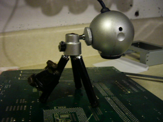

    it is a test of my new setup- a good webcam mounted on a counterweighted tripod, connected to an imac G5. it is designed to allow close ups of the solder tip and pcb pad. i will take pics of it and post them soon.

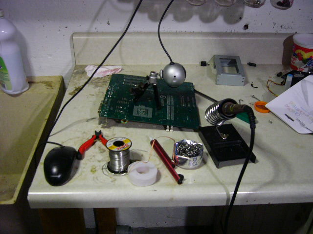

                        good. once i get a better pick, the needle trick will be next.
                        pics of the new setup:
                        the SolderCam:
                        the mouse in the first picture has the optical sensor taped over... it is used to remotely start/stop the recording since the button on the webcam will only do stills.
