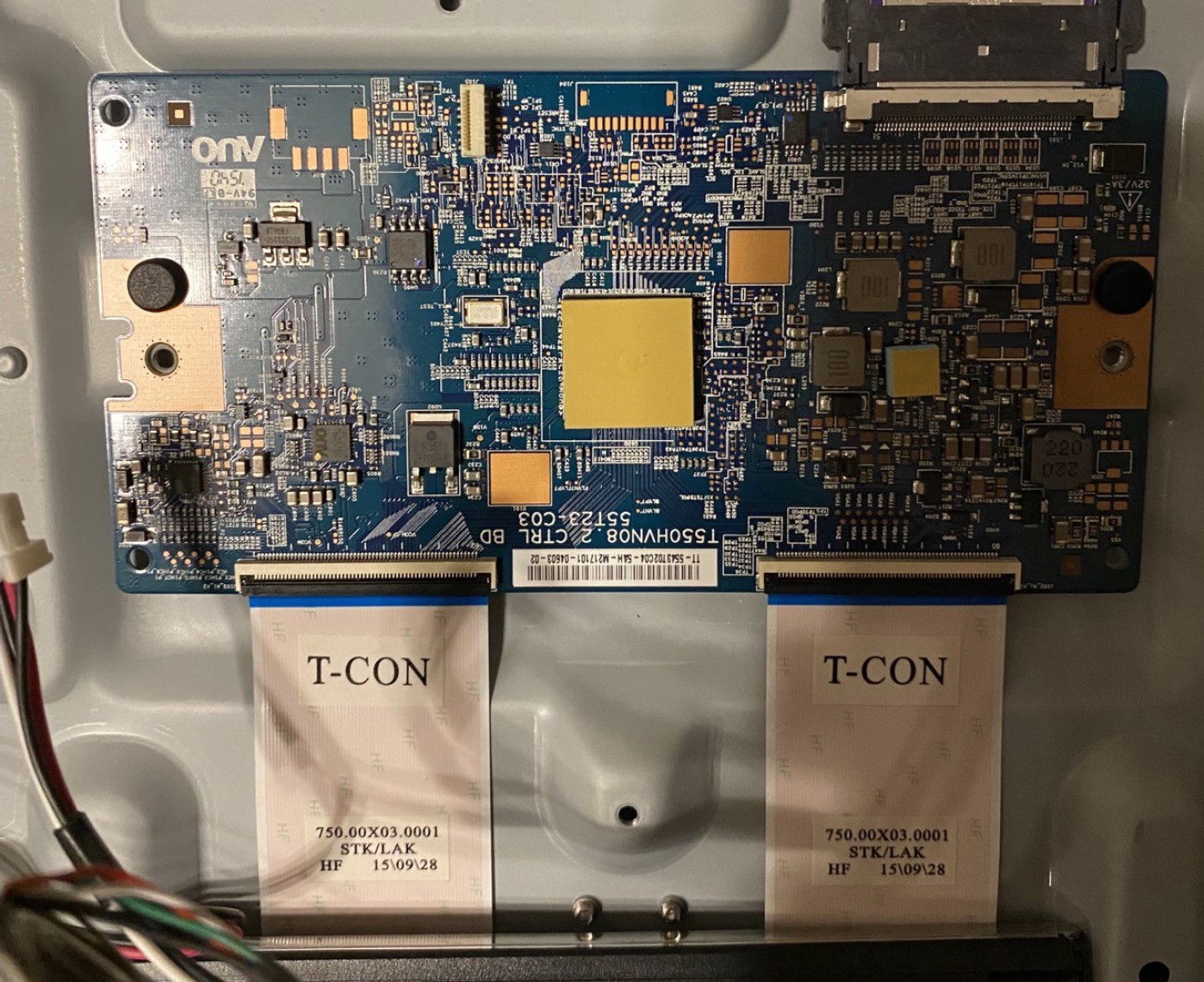

    I was sentenced to replace the t-con board (T550HVN08.2 BD CTRL 55T23-C03). A new one was ordered at a well-known Chinese site.
    The parcel arrived in 20+ days. I replaced the t-con board. The TV turned on completely immediately without updating firmware.

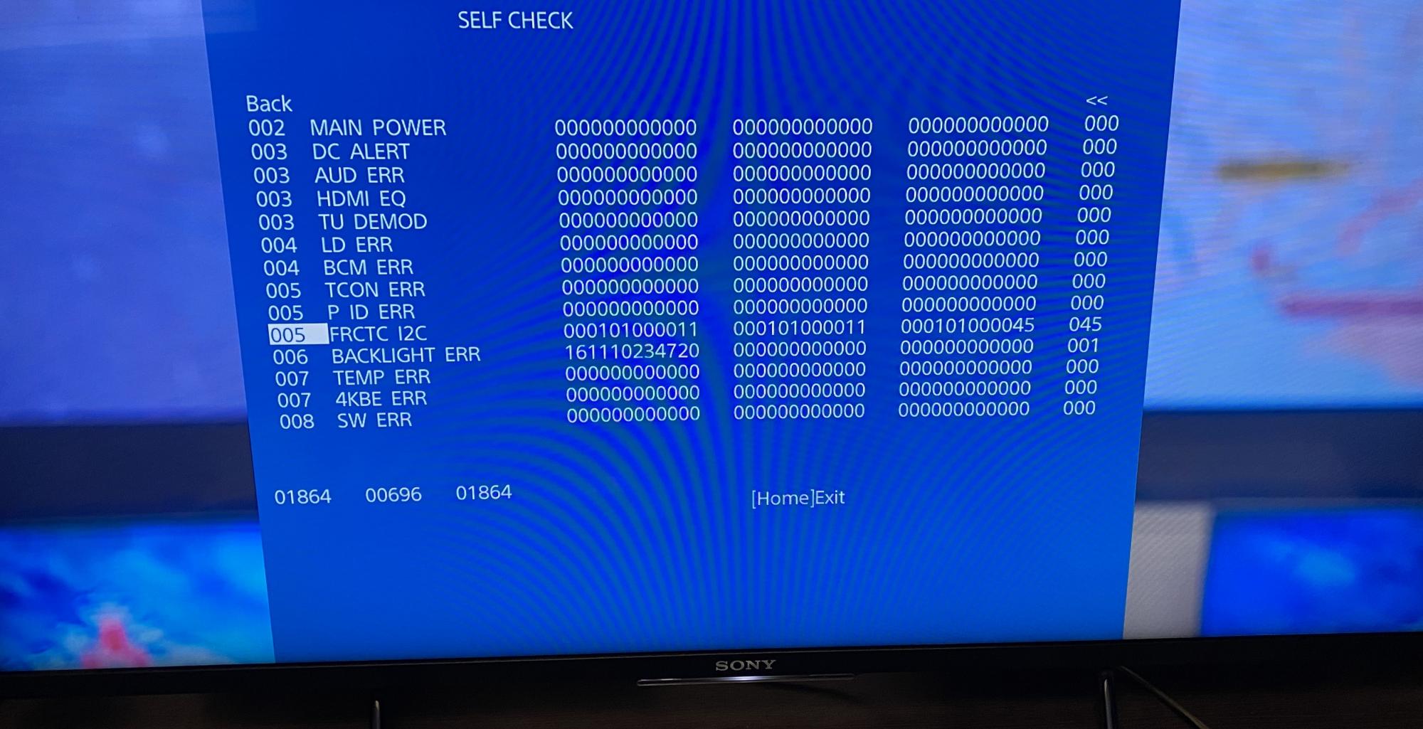

    Accordingly, self-diagnostics entered me from the remote control and we see such a situation. It turns out that the t-con is defective?

    To begin with, clean, wipe the contact pads on the cables between the T-con and the panel and the LVDS cable and see if they are inserted into the connectors. If it doesn't help, then transfer Eeprom and SPI flash from your old T-con board to the new one you bought.

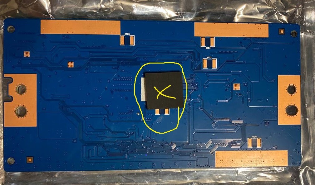

        I decided swap t-con boards. There's green stripes full screen (old t-con). Disassembled t-con board once again. I removed the black thermal pad support from the back surface of the board, Assembled TV and it works with old t-con as if nothing had happened.
