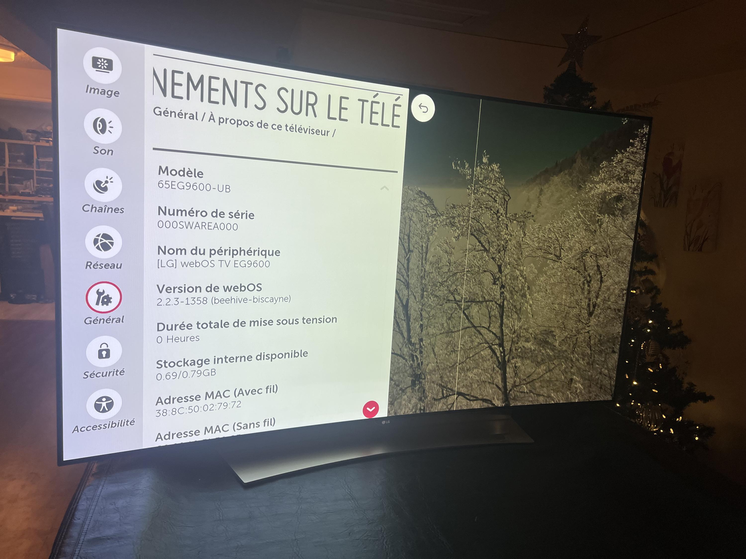

    Hello, ive got this LG OLED 65EG9600 model that wasn't powering on, only the LG logo led was flashing constantly. Bought it as is..
    So, took an lg service remote, used power only, and it fired up. Shutted down, and then it worked using the original remote, and if works every time.
    What happened, why does power only with a service remote got that thing back to life ? I just don't get it.
    Anyhow, ive got a nice white/yellow line going down the screen, the guy said that line wasnt there before. Attached the picture of it..
    Is that a sign of a bad panel, or is there any chances a replacement tcon would fix that ? is there any way in the service menu i can confirm that in some way ?

    An internal panel short happened which sent the mainboard into protection mode, then this line is the result, it may have been impact or the TV did this by itself which is common for these first gen OLEDs, lots of panel failures, no repair for vertical lines is known.

      Well from what i know no impact, it did this on it's own.
      There is no ways to even turn a single panel line off, from the service menu or any other method of doing so ? Having it off would have been better.
