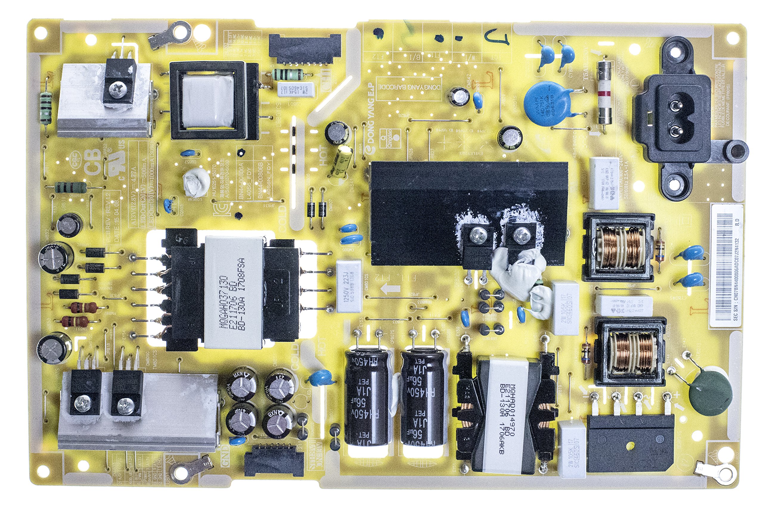

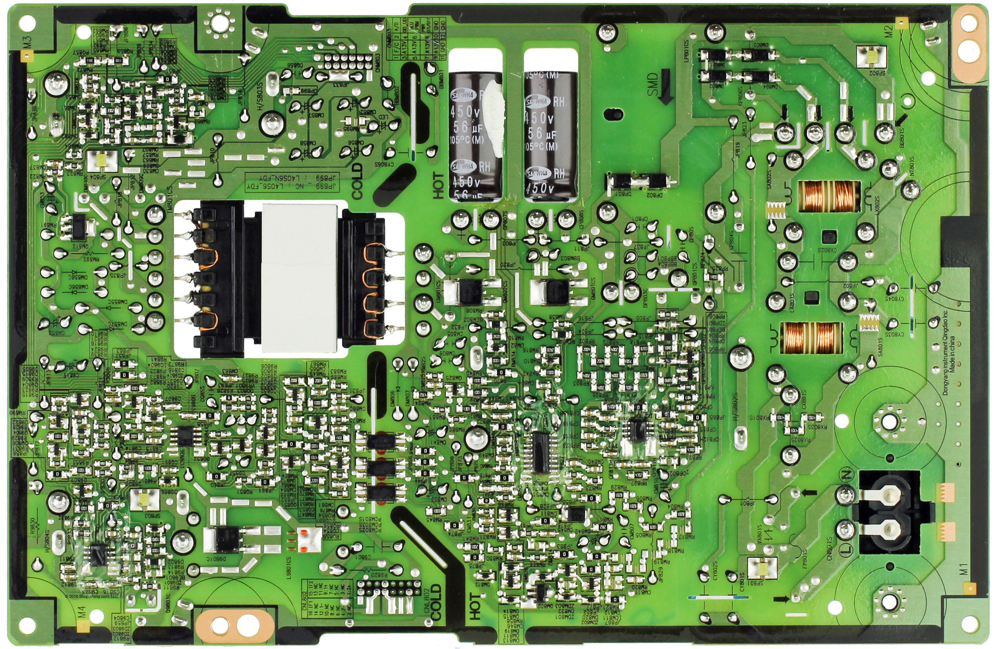

    hello...Samsung UE40KU6172U, source module BN44-00806A...initial defect...the LEDs are blue (you can see the image in blue)...or bought new LED strips (same code strips) and installed...after turning on without mounting the display, speakers, etc., the Samsung starts from standby, the LEDs light up, then it stops, goes into standby and starts again...and so on...from this moment it cannot be turned off from the remote control...I put the bars back on the blue and it still does the same thing..any idea???...maybe I did something wrong!!!...maybe someone has a diagram???
