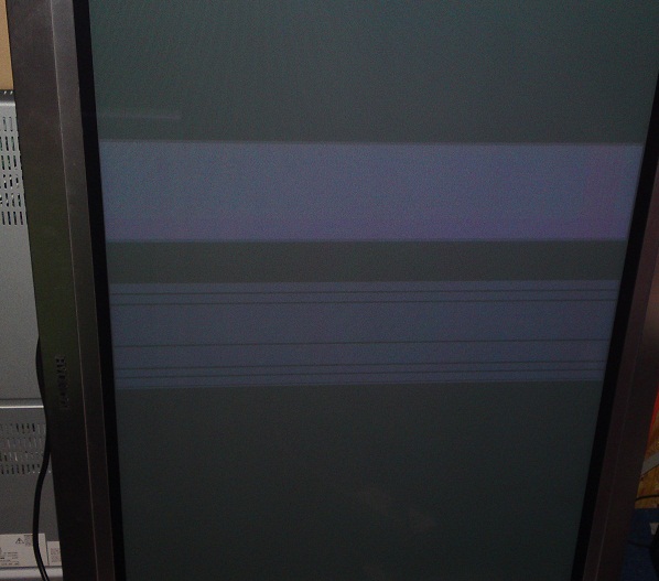

                                    • mbates14
                                      • May 2005
                                      • 169
                                      Re: Hyundai plasma HY4210 buzz no picture
                                      Aint it the truith. ive pounded my head in the wall over this goofy toshiba. that uses the PDP50X3 series panel/chassis, and parts are crazy expensive.
                                      I rebuilt the YPPD Hybrid-IC IPM and got it up and running. then i got the same exact bars you were having. turns out, the y-scan signal was missing becuase mosfets blew on the buffers, so instead of the address period being able to address the individual Y pixels, it addressed the entire row, no way for the individual pixels to be selected. I replaced mosfets and got it goi ng for a little bit, but eventually failed again.
                                      the person just bought a new TV, so im stuck with this PDP50X3 Panel and parts. the panel is good. but the rest of it, not so good.
                                      So i am out there looking for a prime candidate for a panel swap, like trying to find a TV with a PDP50X3 in it with a busted panel. perfect candidate. Problem is, I dont know of a way to find out what TVs and models of TVs that used the PDP50X3
