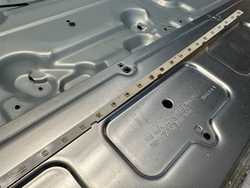

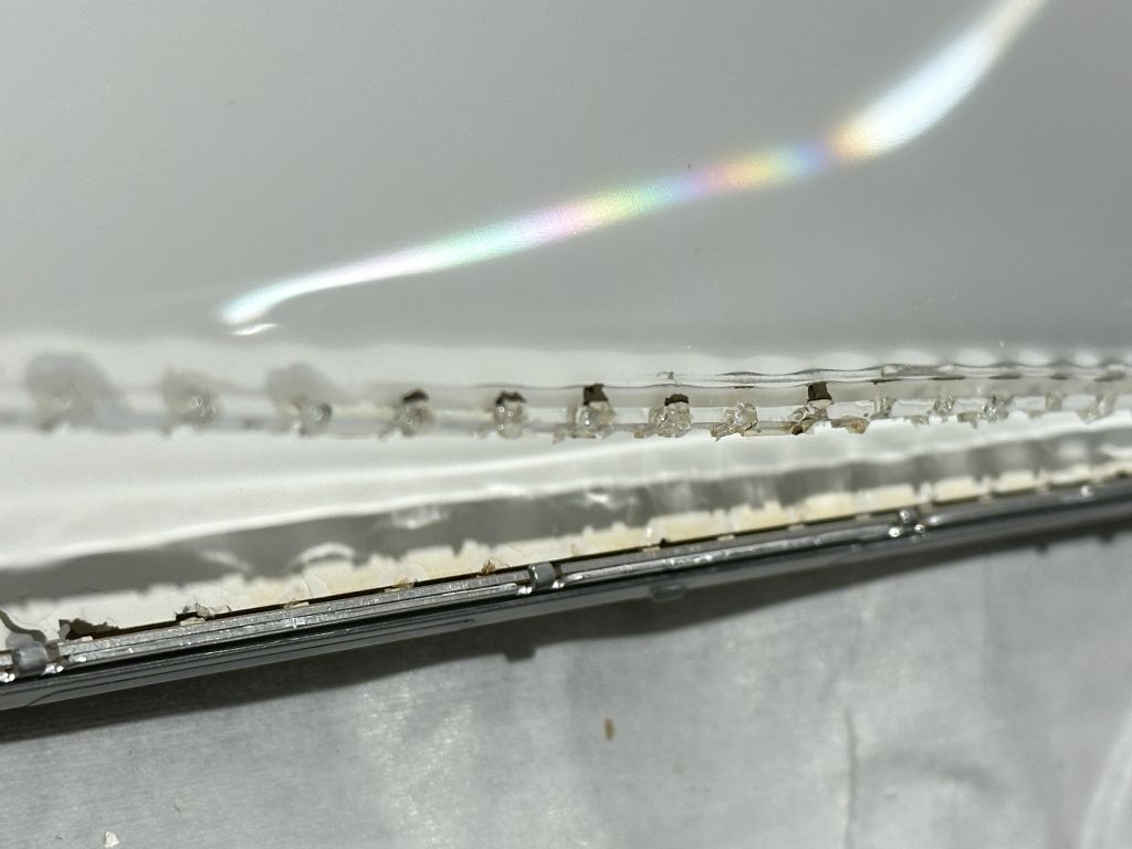

          Originally posted by Ihandyrepair
          Samsung uses bottom edge for the led back lights, specially the NU mu models. The worst parts, if led failed or burnt, diffuser might be melted or cracked...
          Well, it turns out that the new strips (one specifically) did just that. Installed them, everything looked spot on and back to normal, unfortunately one of the new strips didn't last twelve hours before failing on one side *and* overheating/burning/cracking the diffuser on the other half of that strip.
          The big question is how/why the heck did a brand new strip fail followed by is it possible to get a new diffuser? I've taken a quick stab at it and have yet to find a source/vendor that has that part. Disappointing to see this being the end result for a three year old tv...

                                  Originally posted by 80r15
                                  Update - supplier is pointing the finger at power supply. I won't have time to take a look at that until Sunday evening (at best), but off the cuff seems up in the air that the right side strip partially failed, then right after installing new strips the left side of the left strip failed within twelve hours and the right side of the left strip overheated and damaged the diffuser.
                                  Thoughts?
                                  If you want to give it another shot I would replace the LEDs strip with reputable ones (probably OEM pulls from another set).
                                  As for the diffuser you can you can rotate it 180 degrees so what was top is now the bottom touching the LEDs. You can/should clean off the burned parts of the diffuser just to keep as much uniformity as possible.
                                  With Samsung Edge Lit LEDs they say reduce the brightness to the very lowest setting you can find acceptable to watch TV. You wont enjoy it but as much as the flash and dazzle that having the LEDs on 100% will give you but it will prolong the life of your LEDs and screen.

                                      • 80r15
                                        • Dec 2022
                                        • 14
                                        • US
                                        #39
                                        Re: Samsung UN65NU6900FXZA Vertical Gray/Dim Area
                                        lots have tried rotating, very few had a decent result, just puts the defect at the top.
                                        Yeah, as expected, rotated diffuser and not up to snuff. Add in that led's on strip aren't lit up evenly, could be strip, could be board, but doesn't matter since I've yet to find a source for a new diffuser. Samsung won't give me a part number and I have yet to find a part supplier that has the item available or the necessary information to look up the part. So, if anyone has a suggestion on how/where to find the part, that would be great, otherwise the remains are going in the trash...
