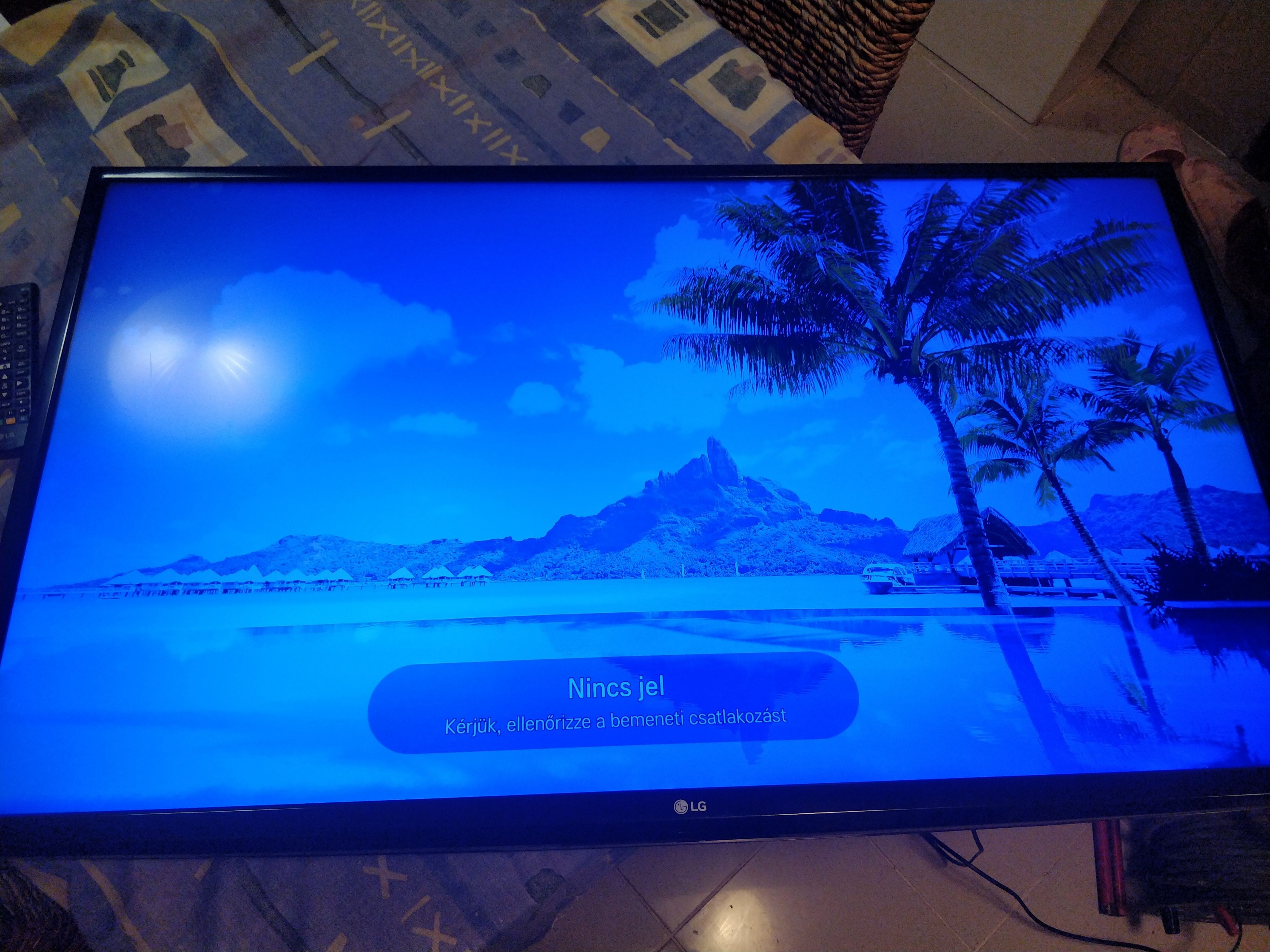

    Hey guys!
    I have a LG TV with very dim blueish colored backlight.
    I have 3 rows of LED strips, with 8 LEDs on each. 2.8V each of them.
    Can I change the whole rows with another backlight strip from a Samsung TV?
    The LED's voltage is the same, only difference is that there are 9 LEDs on each row instead of 8.
    Could the PSU handle it or should I take of 1 LED on each row to match the voltage of the original rows?

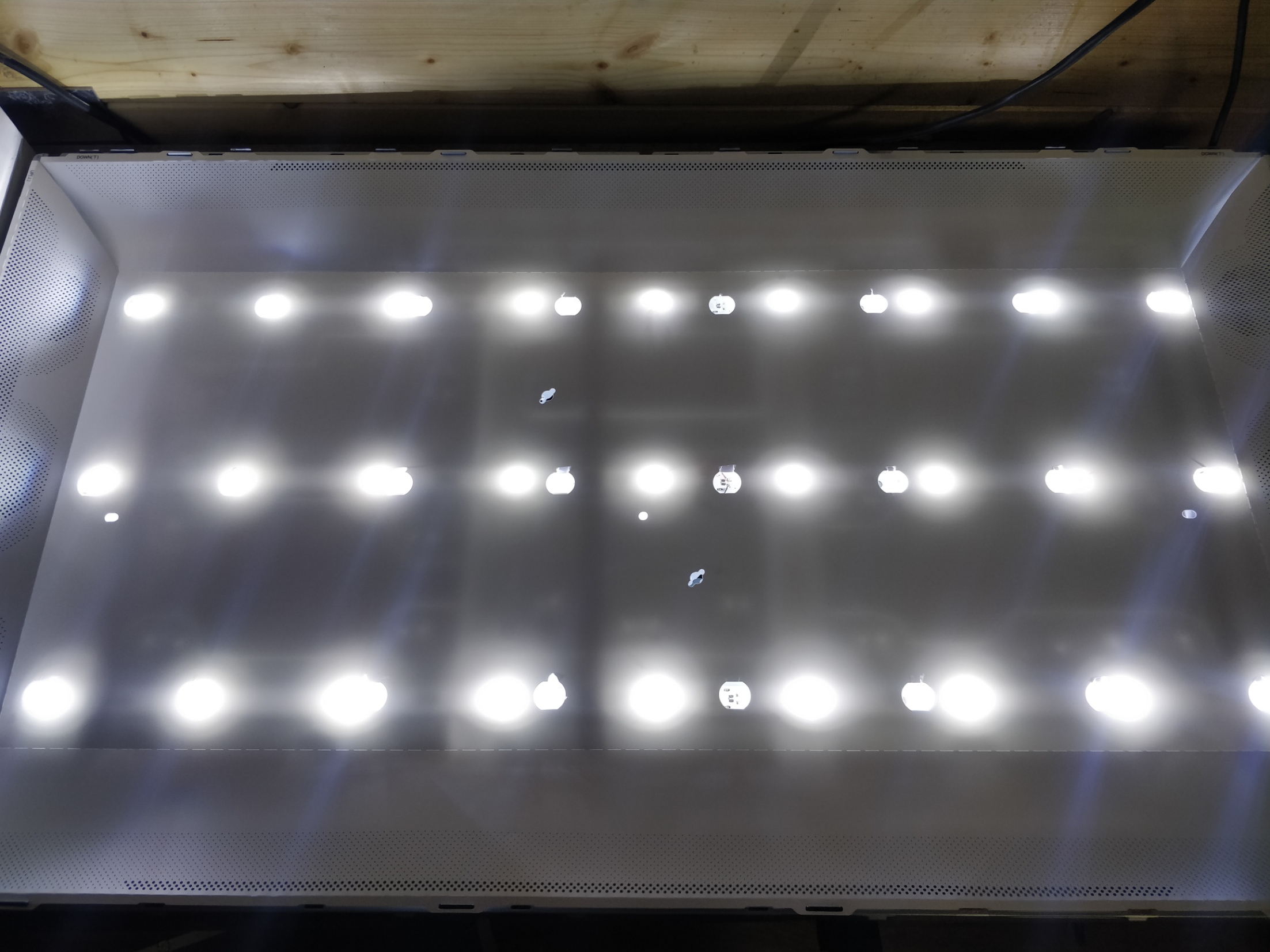

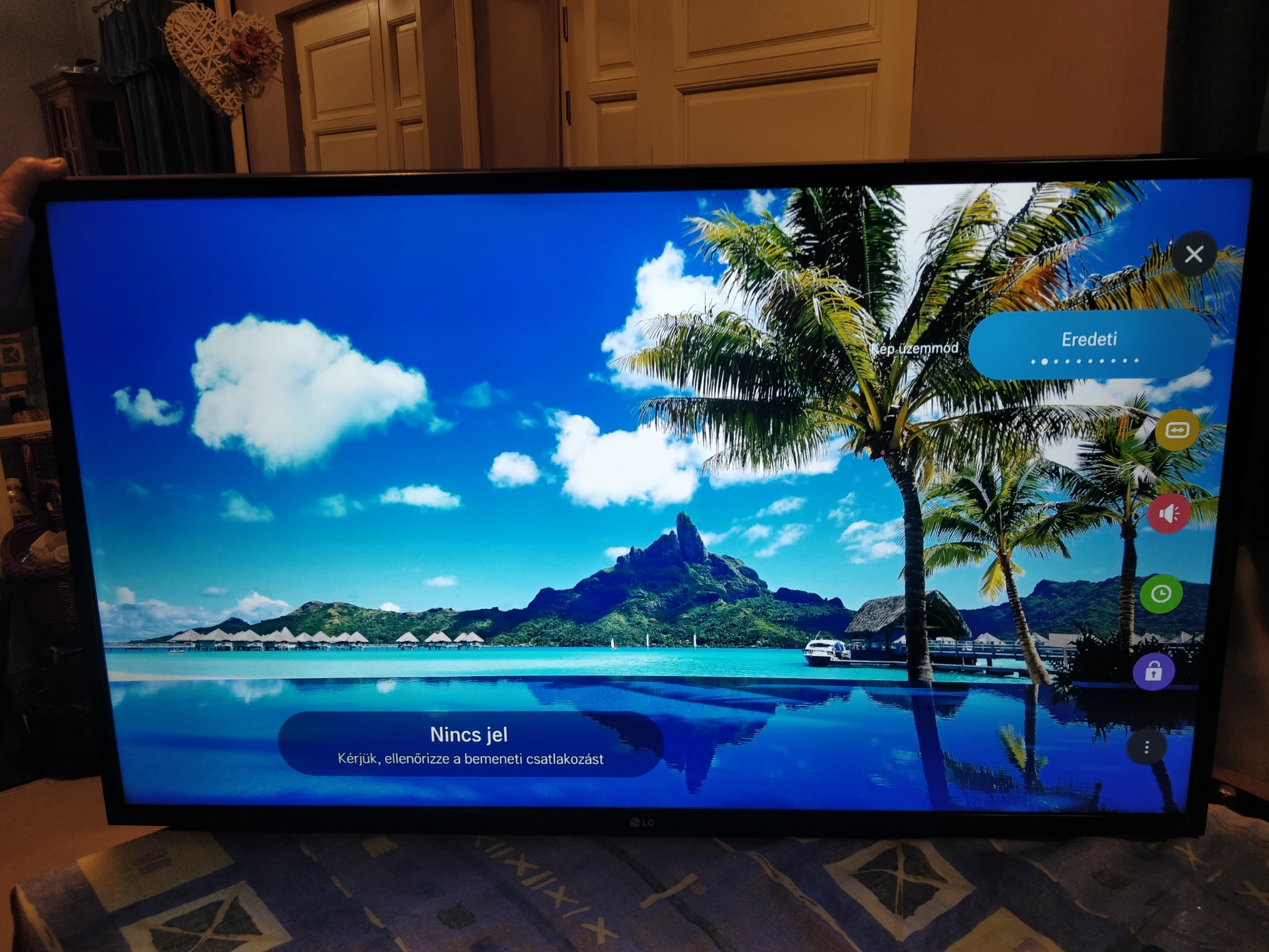

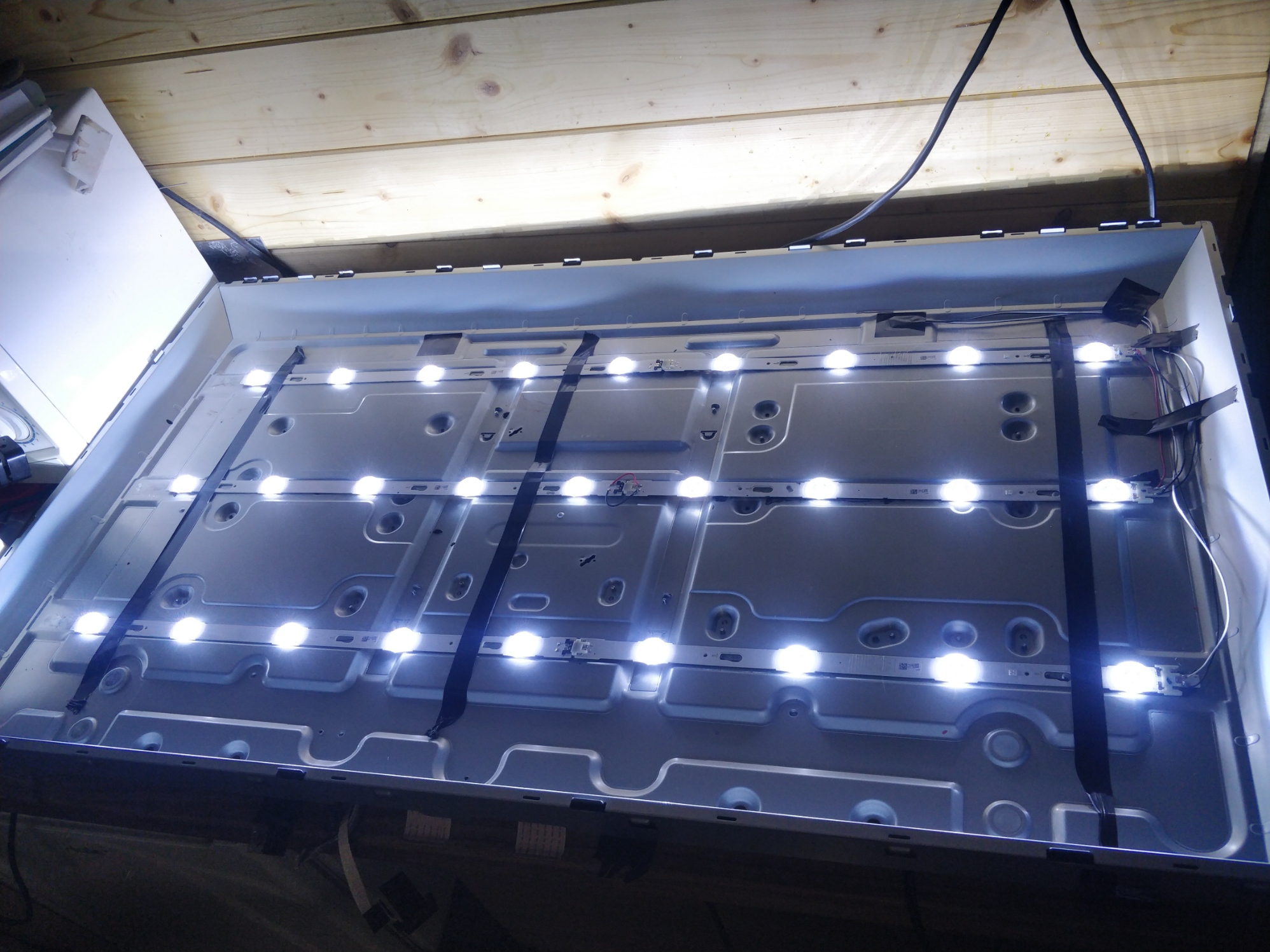

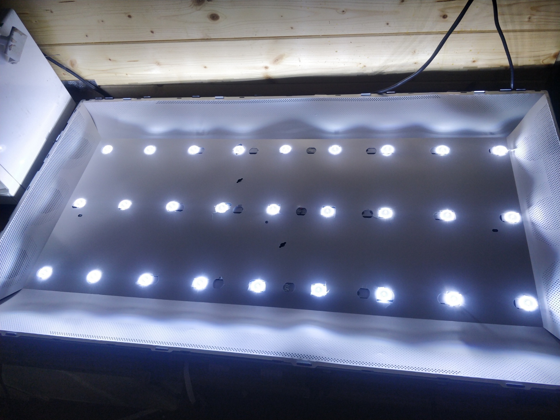

              IT WORKED!
              I checked the startup voltage of the backlight output on the PSU, it showed 140V. So I installed the Samsung's backlight strips without removing 1 LED from each.
              I had to cut new holes on the diffuser paper for each LED, which was tedious but to my surprise it turned out pretty good!
              In fact, the display shows almost no white spots because of the stronger LEDs, only in very certain situation...so they are barely noticeable.
              Before/After:

                white spot only visible when reflectors on strips have different height or shape or oily spots on lamps.
