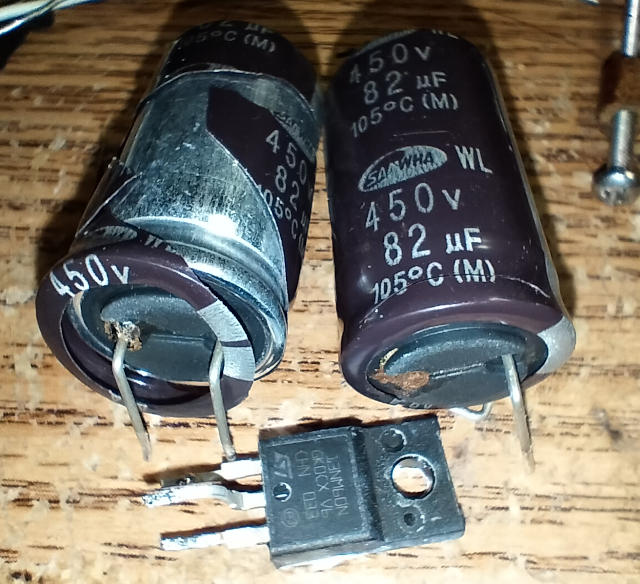

    Well, I got another TV to repair.
    This one unfortunately seems quite used. It's (of course by the model number in the subject) backlit by CCFL.
    Well, it's dead as a doornail. 6.3A 250V safety SB 5mmx20mm Fuse blown. DBT says the input's shorted.
    It's an APFC PSU and apparently the main caps blew and took out one of the APFC MOSFETs (the other one seems like it's still alive...wonder if I can still use it). And of course it probably took out the APFC controller too.
    Oh well, wonder if I should get an APFC controller, get a MOSFET, and cheese the main caps, or at least I don't think I have 160uF's worth of 450V caps to replace them.
    Hmm... next steps...

        These capacitors look very fine.
        (well, that mosfet is also dead (3 way short) but hard to tell from looking at it of course.)

              HO HO!
              Got lucky! APFC driver was still good.
              Got lucky sorta: I subbed in horrible substitutions: removed both MOSFETs and used a single 18N50 using an alligator clip to clip it to the heatsink (since it was an experimental fix) and used two 200V 470uF capacitors in series with 560K bleeders (likewise as an experimental fix) ... DBT no longer indicates a short and looked like another APFC PSU that I've played with...
              Replaced the 6.3A fuse with a 5A TD fuse, and now the TV sprung back to life.

                  I guess it's another save from the landfill, at least for now. I really should get proper transistors and caps in there, though I wonder what the life expectancy will be.
                  I suspect the caps are the #1 indication of life...
                  Original:
                  2x 450V 82uF Samwha WL 105°C capacitors, parallel.
                  Now:
                  2x 200V 470uF Chemicon 85°C (forgot what series) swiped from a dead ATX PSU with 560K bleeders, series.
                  Potential swaps:
                  Single 450V 160uF 105°C? Or should I stick with two 82uF in parallel?
                  TV is buttoned back up and "usable" with the jury rigged fix, surprise waiting to be discovered if someone swipes (and opens) the TV...

                    the rule is never undervolt, you can go over but not under, should try to keep the uf about the same, I dont see why it shouldnt last a good while with the right components in there, I would put 2 450v and 82uf, 100uf should be fine too. the 200v prolly wont hold up, use 105 not 85 and low esr caps.

                      some of the old plasma boards have 900 volt caps in them, if you found one with about 160uf, you could use it instead of 2 caps.

                        Yeah, figured as much, alas did not have better spec caps on hand as I'm no repair shop. And yeah since I calculated out 390V I'm cutting it real close, but depending on Chemicon's history that this is okay at least for now. My Sencore reported about the right amount of leakage - the bleeders/balancers is more than the capacitors.
                        Need to order new parts... Someday.
                          With good Japanese capacitors, I imagine the next service item will be the CCFLs... which may or may not be that long from now. But who knows. It will probably all depend on how sensitive the inverter is to lamp imbalance and over-current from old age. I picked up one very old Compaq 15" LCD many years ago that was left on 24/7 in an IT room, and the backlights would barely glow red/pink. Inverter looked cooked to death, but kept going nonetheless. LOL!
                          Originally posted by eccerr0r
                          Potential swaps:
                          Probably might not matter much, but I can't say for sure. I imagine two caps in parallel will have better (lower) overall ESR.
                          What I've been doing on some of my ATX PSUs with APFC is I've been adding 450-630V film caps in parallel with the main one(s). Not sure how much that helps with reducing ripple from the APFC circuit on the electrolytic caps... but I figure if the electrolytic caps fail open again, the film caps might have just enough energy storage to absorb whatever the APFC coil dumps to prevent the APFC MOSFETs or anything else connected downstream from getting destroyed with high voltage spikes. Though whether or not that will work is yet to be proven. I did see this done with a ceramic cap on the Enermax PSU, though. And I also saw it on a hefty-built Newton/Delta for a Dell T-7400 workstation 1.1 KW PSU.
                          In regards to finding replacement parts...
                          If you happen to find a Playstation 3 PSU, particularly Nichicon P/N ZSSR539IA, those have 3x Nichicon PT 450V, 140 uF caps, IIRC. And probably suitable MOSFETs for the APFC as well. Just mentioning this, in case you find one of these PSUs for less than what it would cost to get new caps and MOSFETs.
                          I hate APFC PSUs with a passion now - they regularly kill the primary caps after some years, and then you are left with a PSU that needs expensive caps (at a minimum) to get it working.
