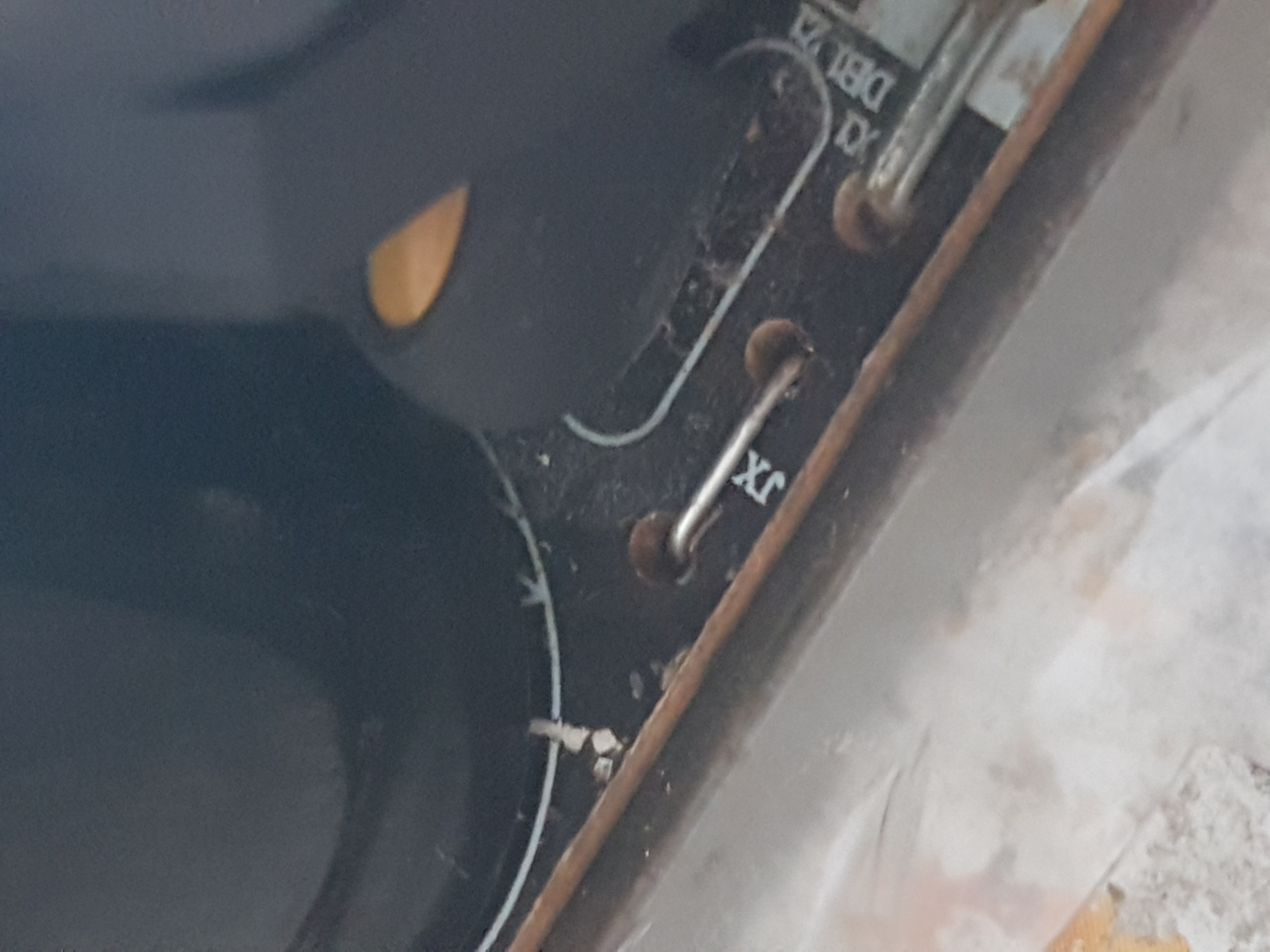

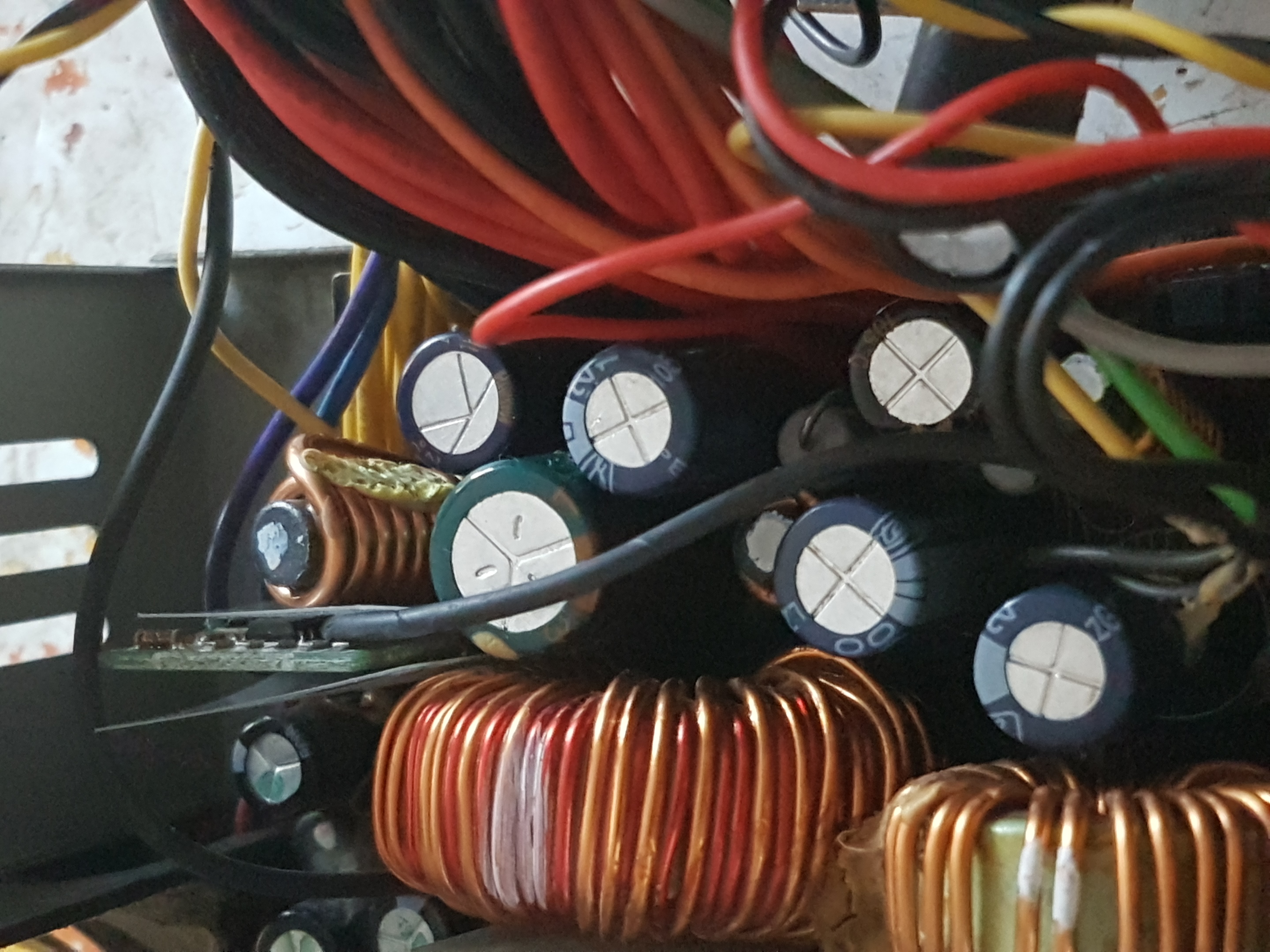

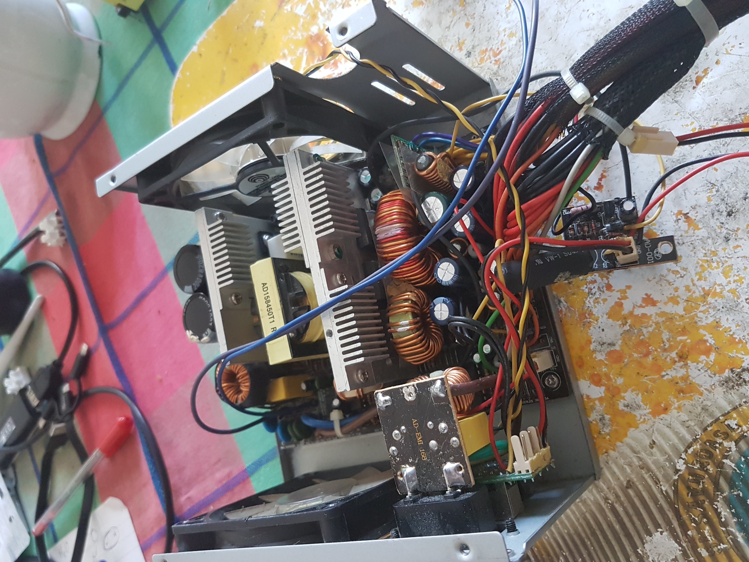

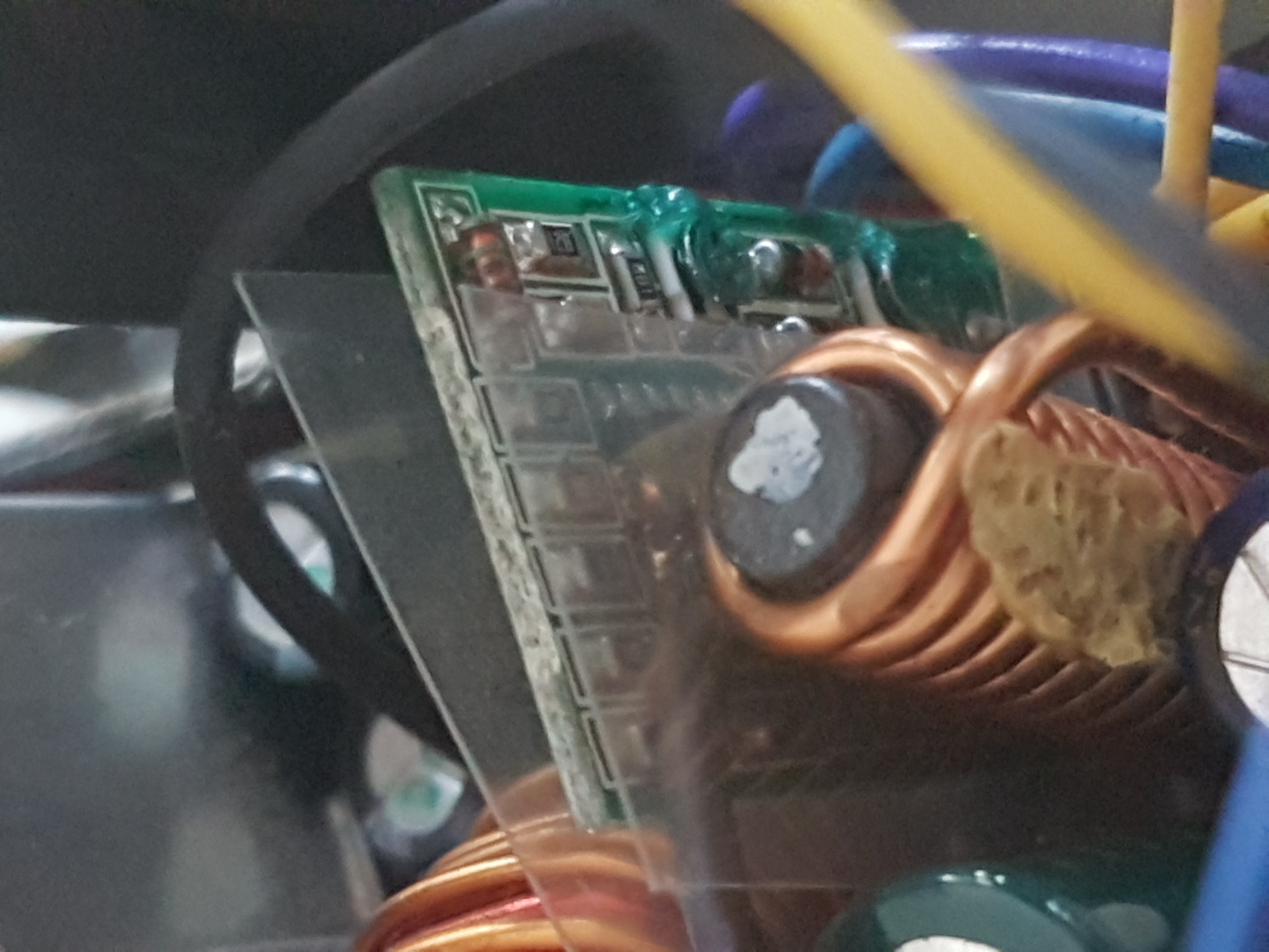

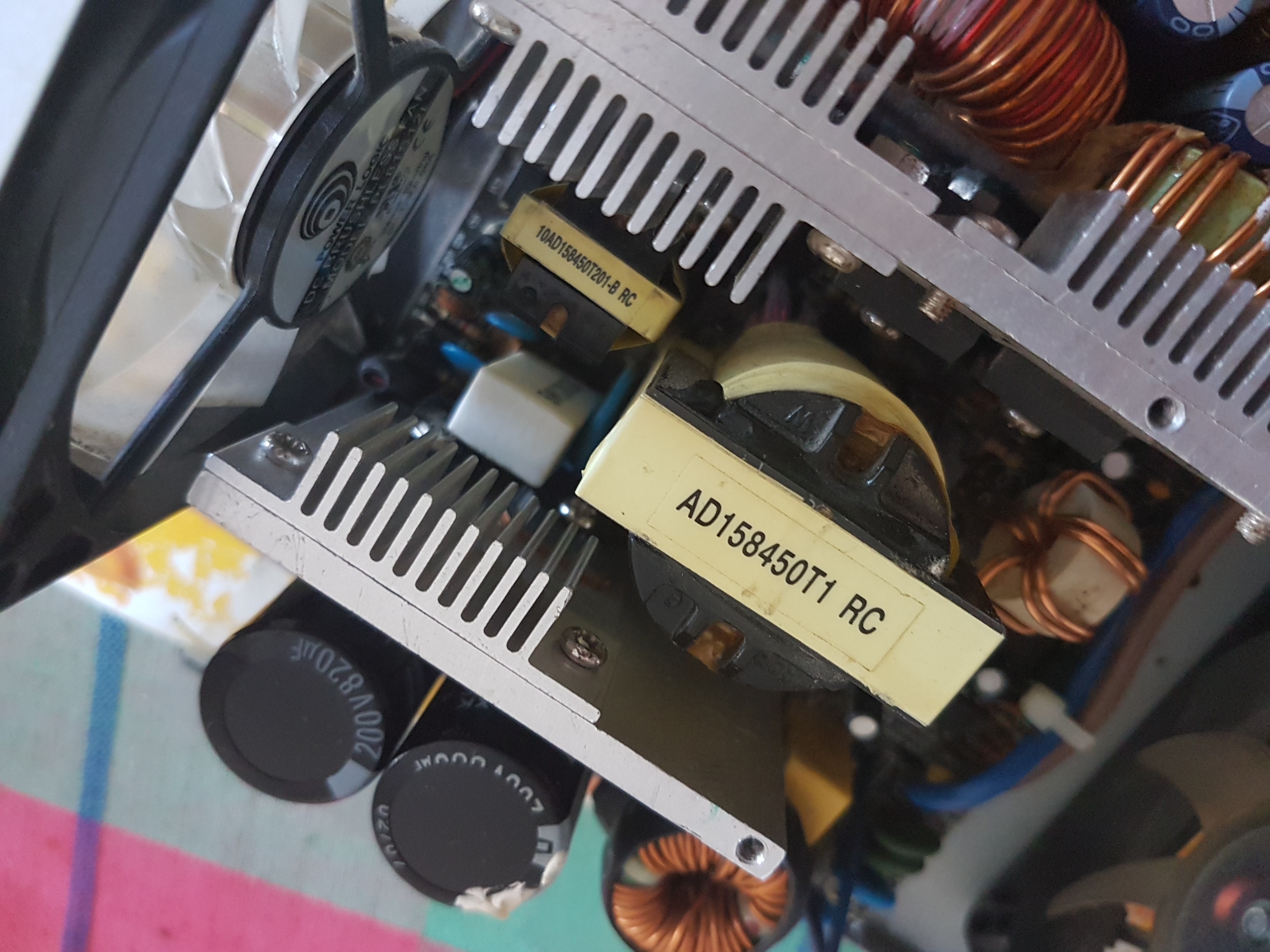

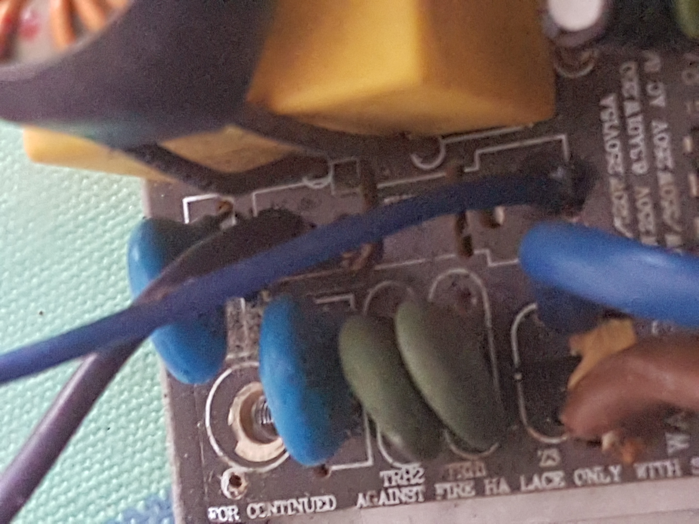

    As the title says - I have here a Hiper PSU model HPU-4S525 that came with a blown to smithereens APFC board, blown fuse and main caps.
    So far this is what I did:
    -remove the APFC board
    -jumper the PFC spot on board*
    -replace all capacitors - it had bulging caps on both primary and secondary
    -test main FETs - all check fine
    With no success so far. I temporarily replaced the fuse with a 60W lightbulb (the old fuse was blown anyways) so I could prevent any part go nuclear.
    Symptoms:
    -without shorting the PS_ON wire, 5vSB comes up okay at 5.1V and lightbulb flashes one time accordingly then stays dark as it should
    -shorting PS_ON however will result in the lightbulb remaining bright, no voltages present on the secondary, until I cut the AC power.
    Is there anything I might have missed out?
    ICs present on this PSU:
    -TL3842 - near main input wires
    -2x LM339 - one near the secondary caps, the other on a mounted PCB near 12v wires.

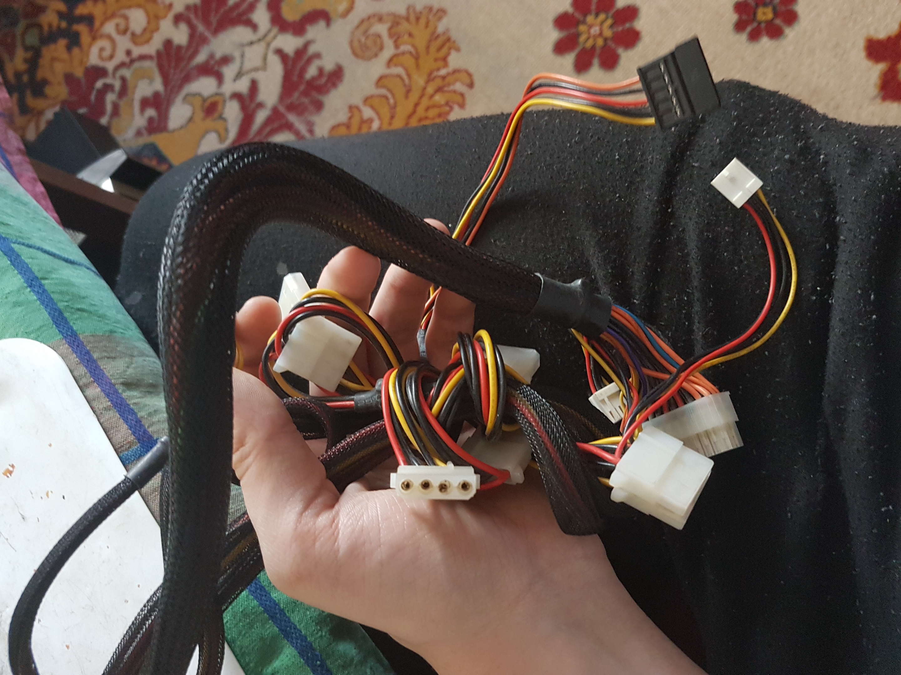

    Finally, I'm leaving a few pictures of it in hopes somebody can tell me what I should check and possibly remove.

          I suspect the TL3842 might be bad too or whatever is driving the main PS MOSFET (there might be a "buffer" driver circuit after the TL3842, implemented by one or two transistors and diodes - if yes, remove and check these for sure). Either that, or it is configured improperly by design. A well-designed PSU with 3842 PWM controller will shut down when it detects an over-power / PWM duty cycle too high condition.
          Another thing to check: voltage across primary caps before and after you attempt to turn on the PSU. Is the voltage across the two primary caps even?
          Also, are you sure the secondary only has two LM339 controllers? I would expect there to be a supervisor chip somewhere - perhaps on that daughterboard. It may be just a tiny 8-pin SMD chip, so have a look. Two LM339 comparators for main PS feedback sounds like an awfully sketchy design.
