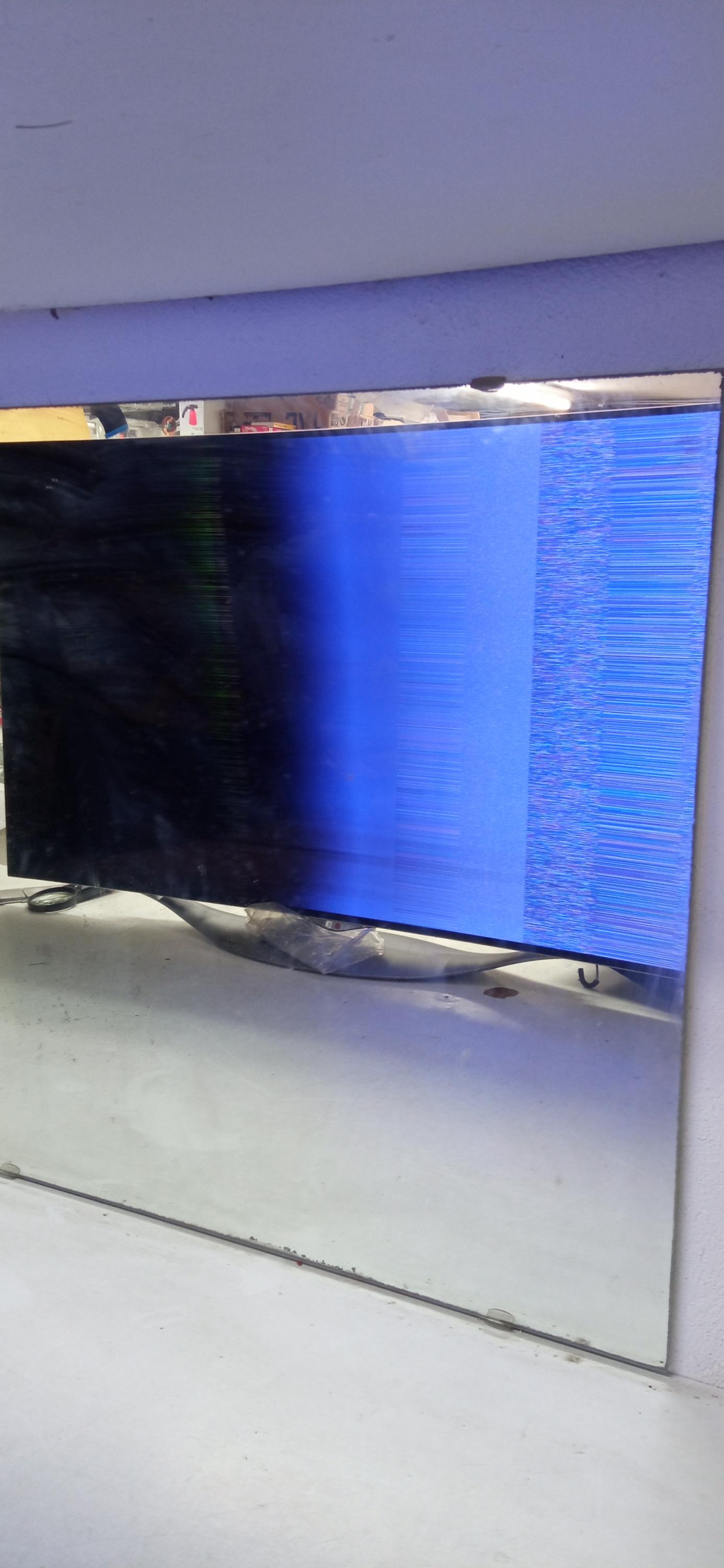

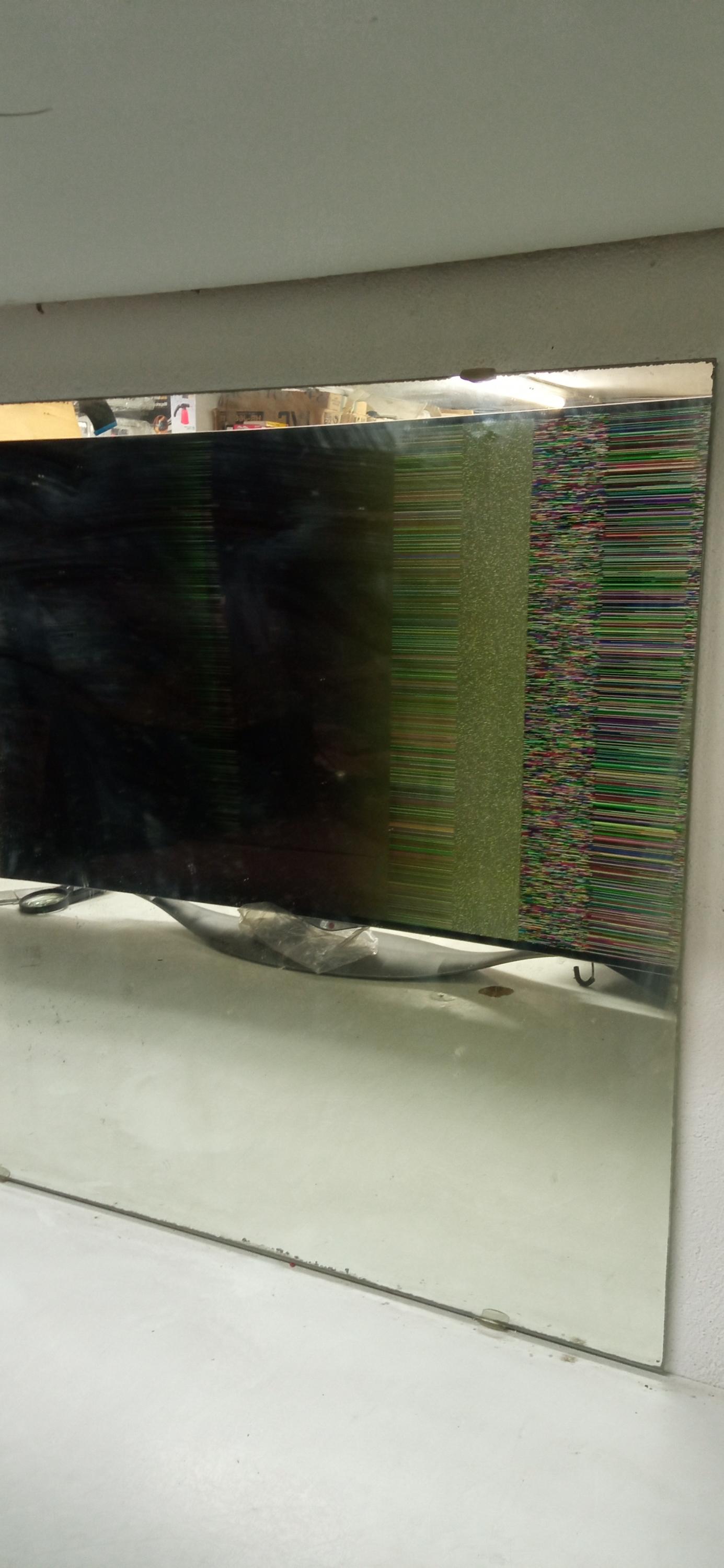

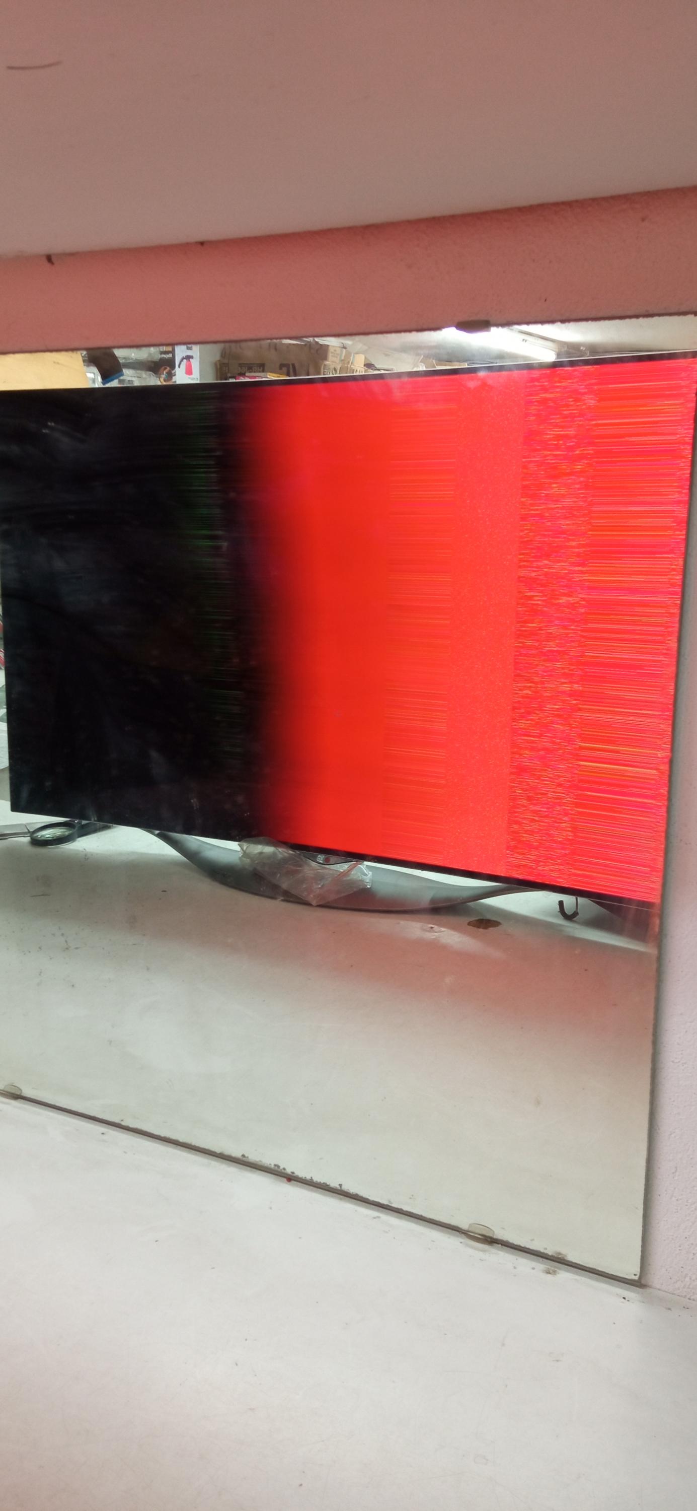

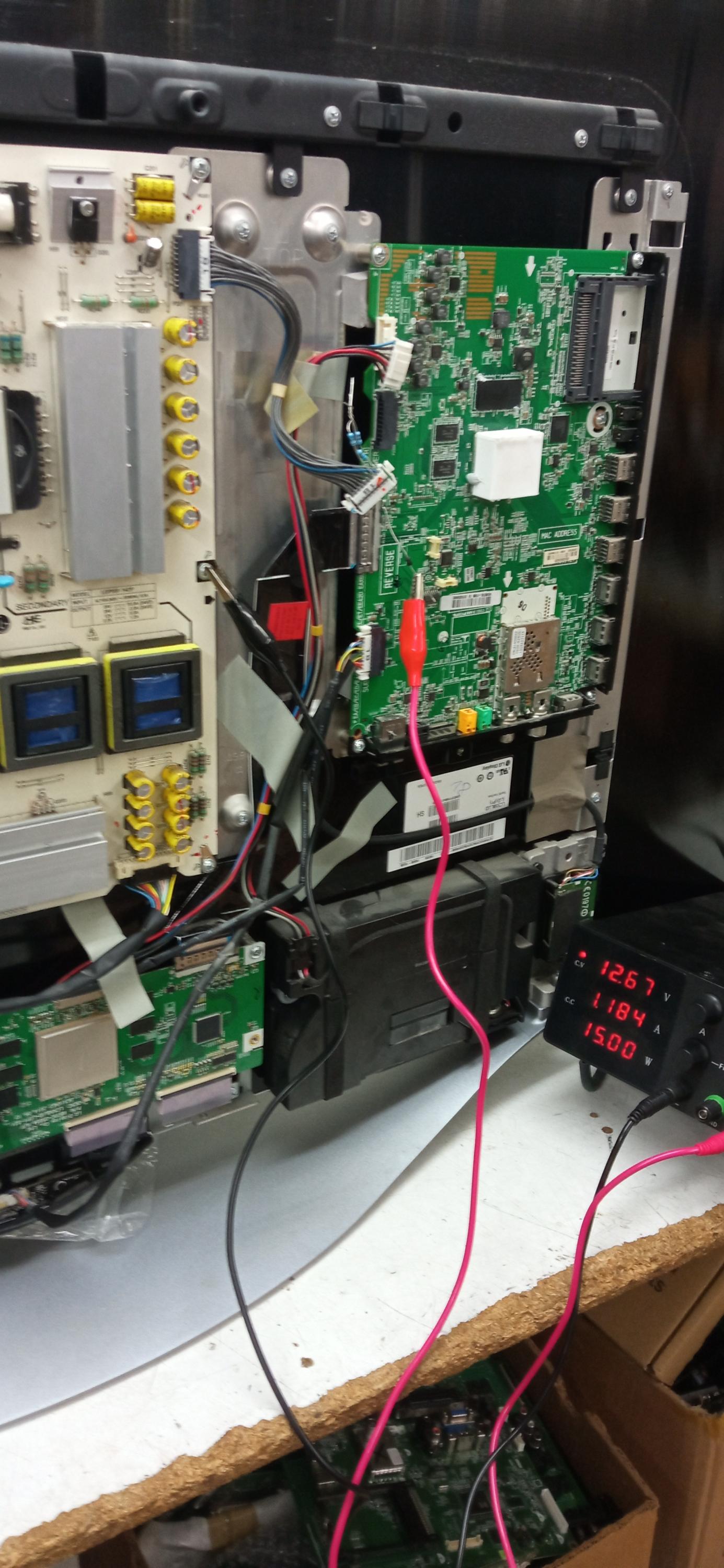

    Lg55ec930v-za
    good morning, I add the photos obtained after forcing po on and dvr on with two resistors and 12v on the tcon board with external power but I still have doubts, will it be the display or the tcon
    the images have many clippings which leads to think about the tcon that
    It's already discontinued at lg, if I find a used one I'll still try
    would appreciate other opinions
