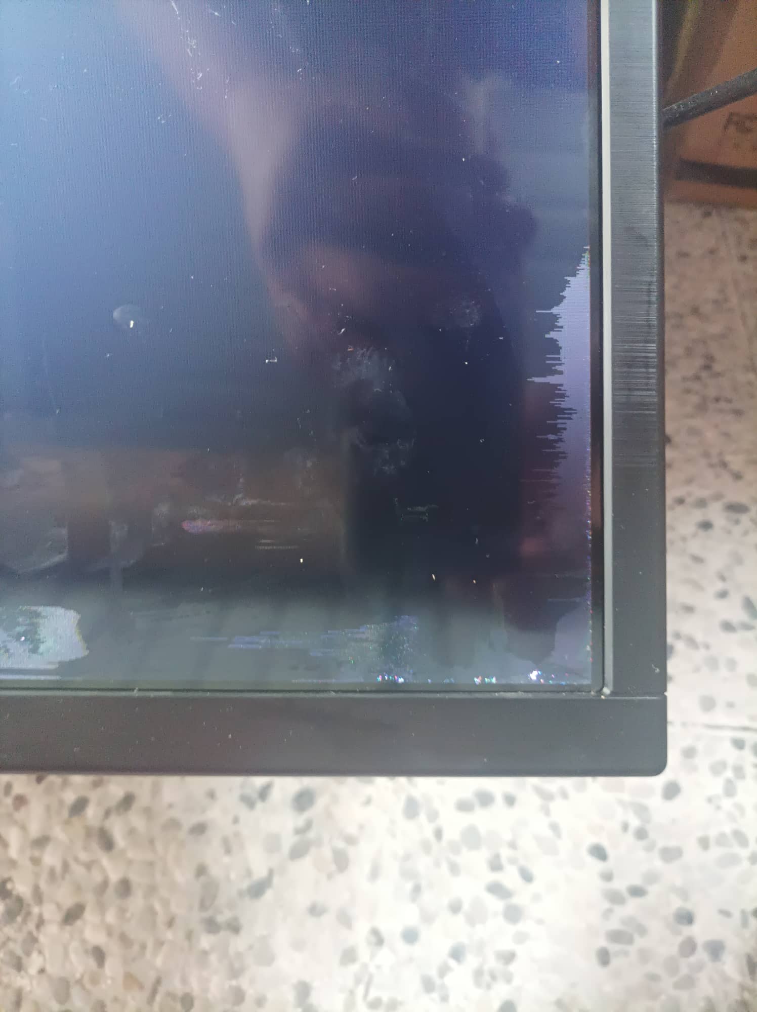

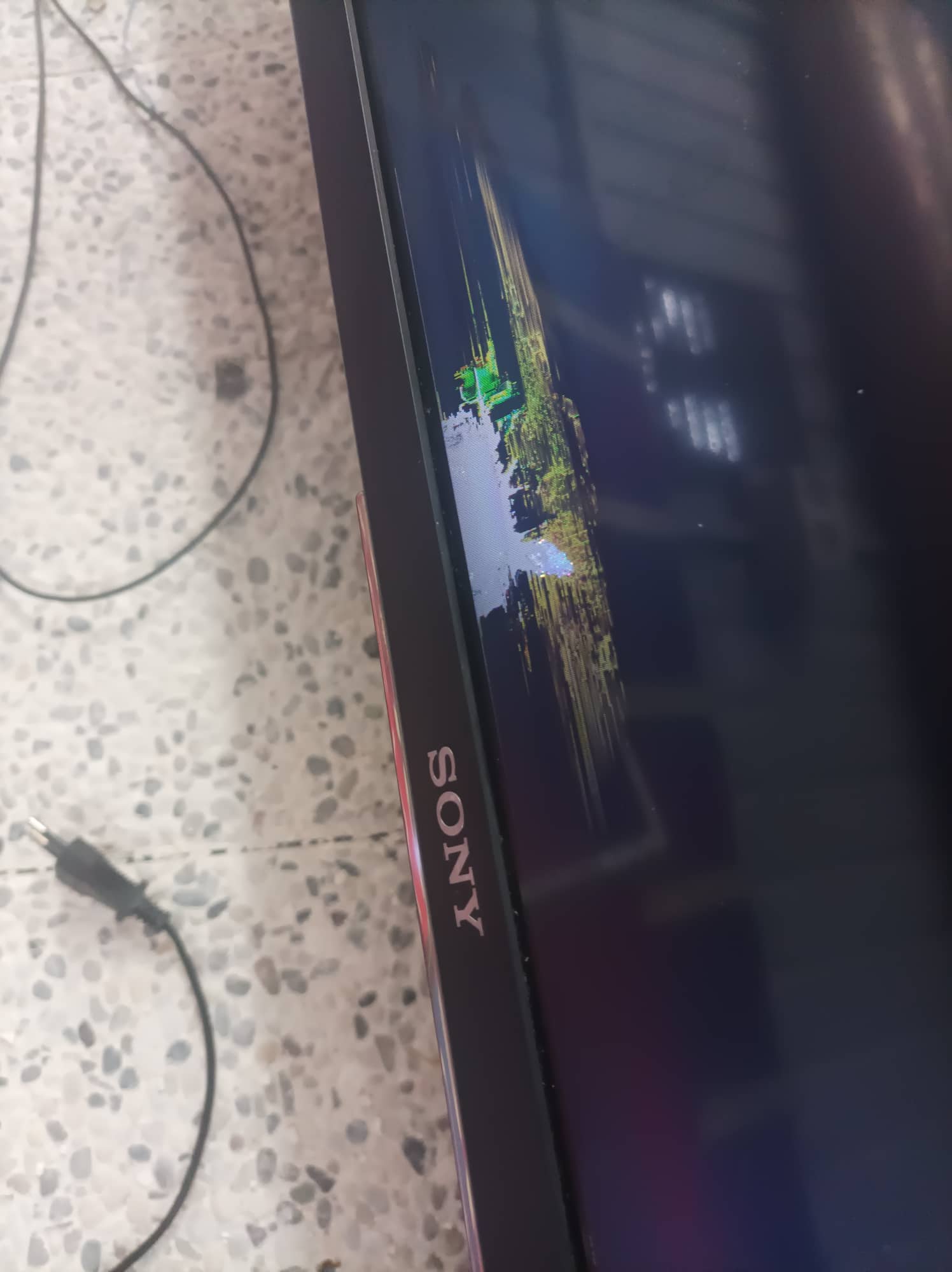

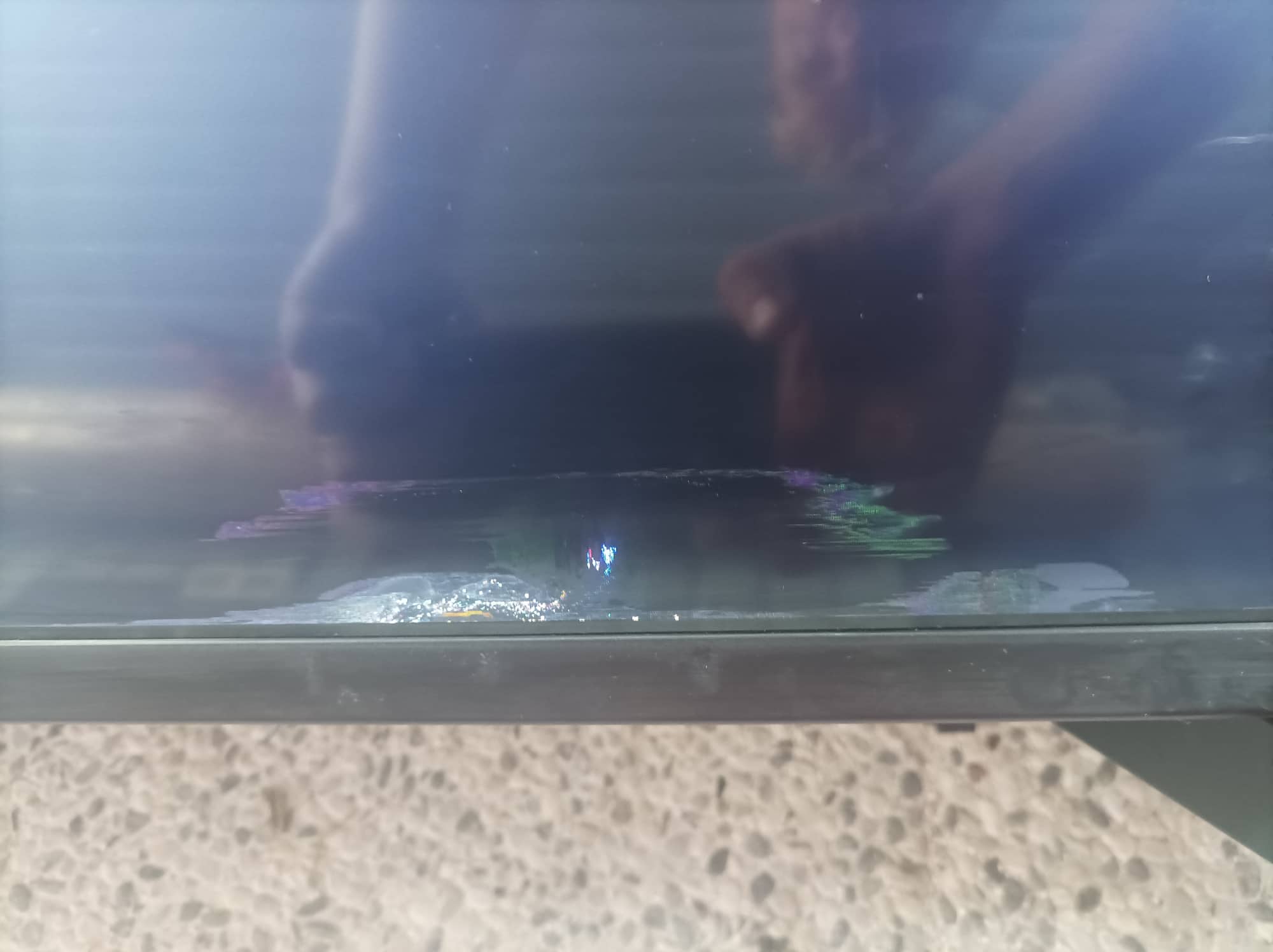

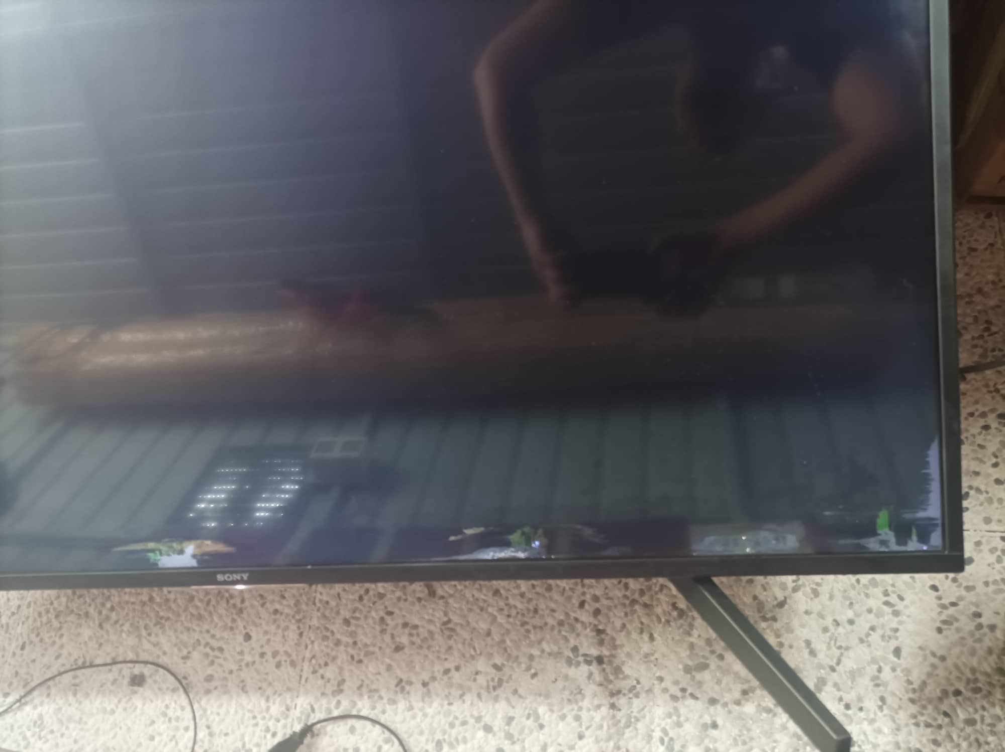

    posible water damage on led tv
    i got this tv and owner who had it told me it could be moisture it sayd the screen is 100% not broken so is this fixable never seen something like this, thank you
  • nomoresonys
    • Jan 2013
    • 12276
    • U.S.
    Re: posible water damage on led tv
    just had one that displayed pretty much the same pattern, was a very small crack in the screen on one corner, couldn't see it til I took the bezel off and looked closely.
    • CroBUTKO91
      • Jul 2022
      • 22
      • Croatia
      thats something i didnt want to hear it looks like water damage i will surely have to open it and see whats hapening but i cant do it for a few weeks so im just hoping someone had similar water damage not cacked and it was able to clean it
      • handsworth
        • Oct 2015
        • 174
        Water at the bottom of the screen could point to the fact the screen panel tabs would be fried. However the diffuser sheets can possible be saved. Dont wipe them, just hang them on a clothes line and let them air dry.
        • CroBUTKO91
          • Jul 2022
          • 22
          • Croatia
          great thank you i could fix a burned cable with microscope and a wires if its not too much i hope pixels are not fried
