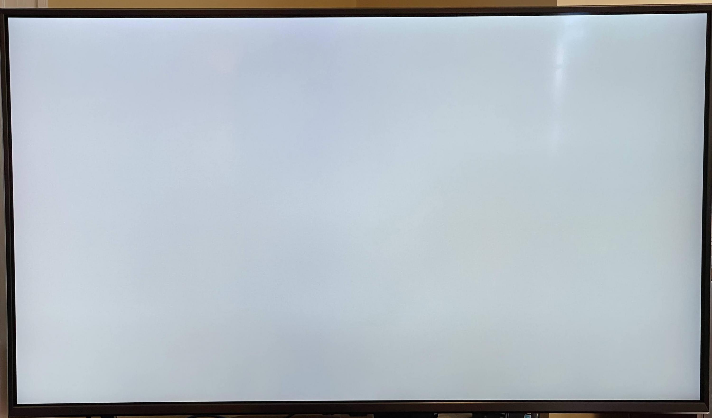

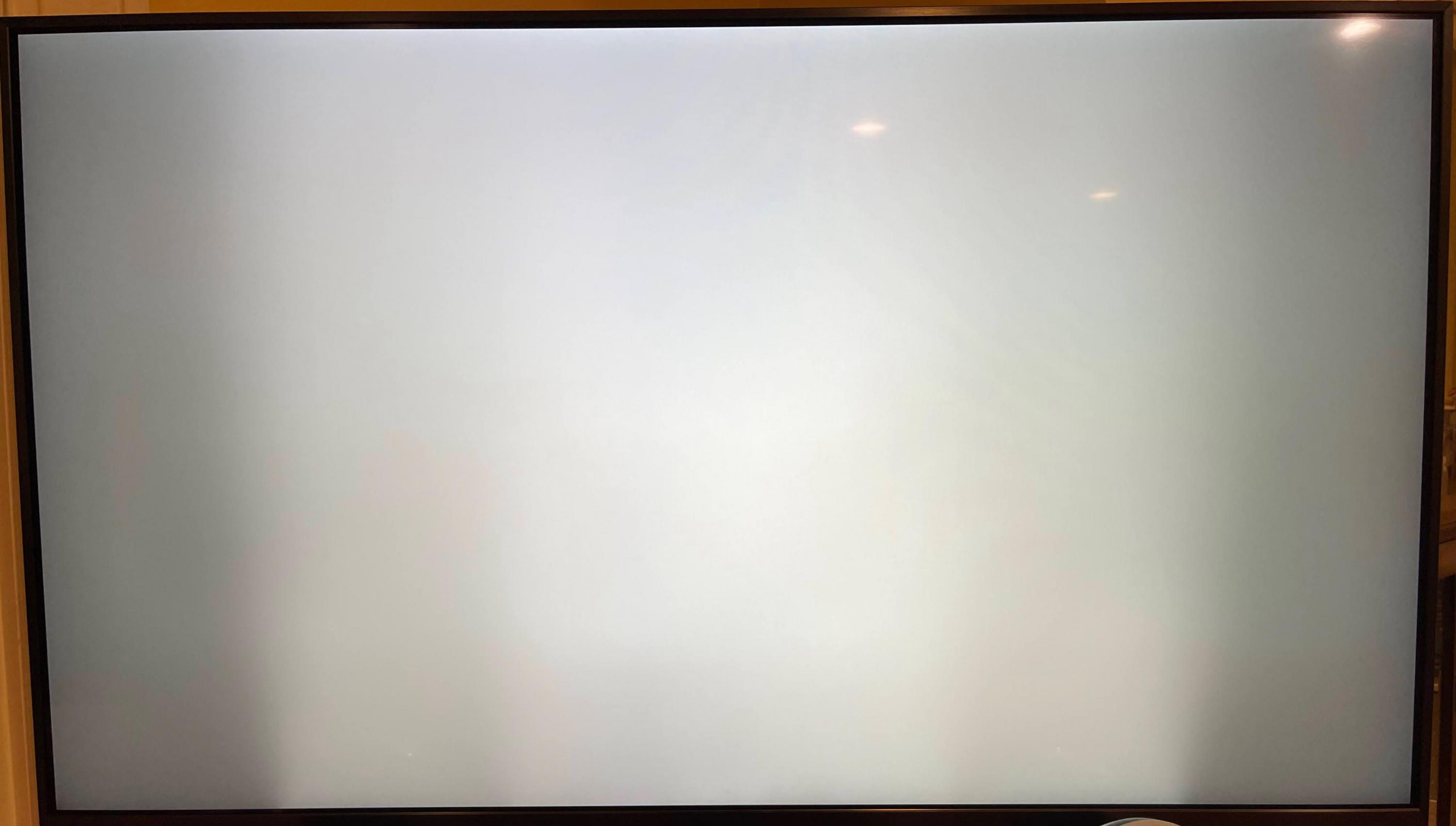

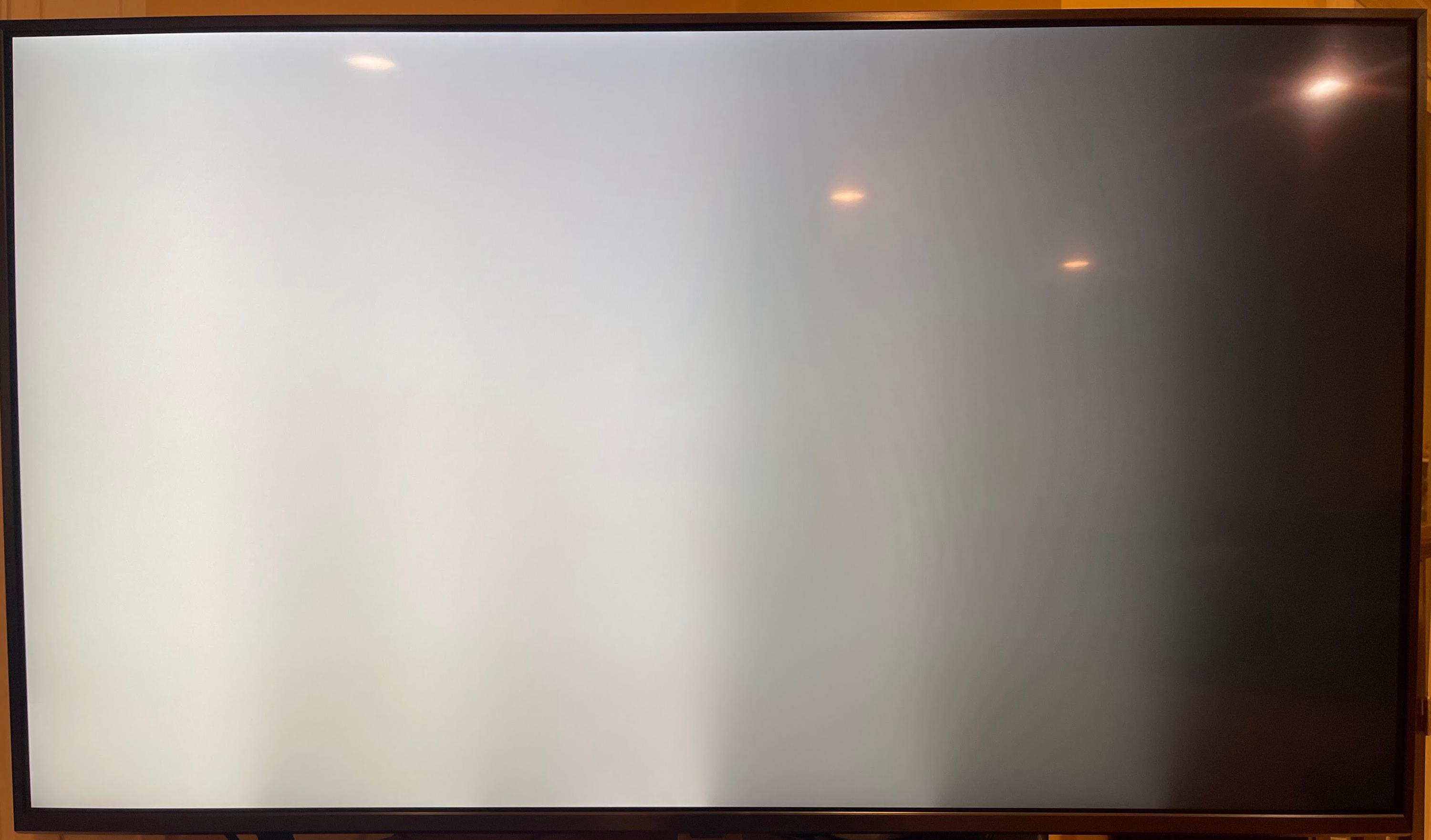

    I have a 2018 LG 49SK8000 with a bit of an odd problem that I haven't seen discussed elsewhere. It's an edge-lit (bottom) LED UHD TV with local-dimming (6-zones I believe). About 5-10% of the time when I turn the TV on after it hasn't been used for a couple hours, one or more backlight zones will not power on normally.
    Some observations:
    - If I power off (standby) and back on, it almost always works normally and continues to do so indefinitely.
    - If I switch inputs, the zone will briefly light up and then go dim again.
    - If I change the video preset (e.g. cinema to HDR effect), it will also briefly light up and then go dim again.
    - A zone may come on normal, dim, or totally dark.
    - Local dimming settings, including off, have no impact
    - The dim zone seems to vary each time, although maybe the ones on the sides are more commonly problematic.
    - This happened very rarely when the TV was newer, but has become somewhat more frequent.
    The backlight is usually at 100, which I've now learned is not the best thing for longevity.

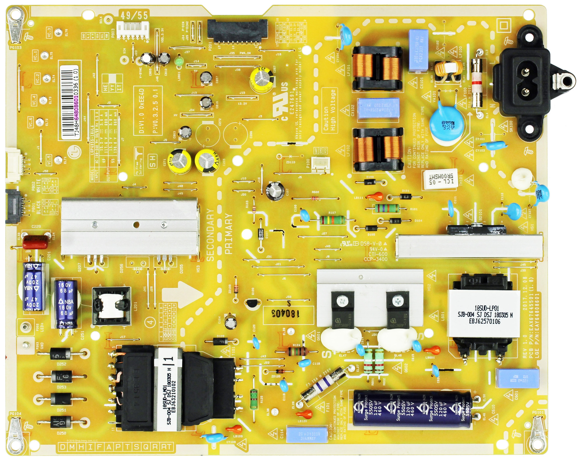

    I'm ready to open it up and do some testing, but since I can't reproduce the problem reliably, I'm afraid it will be a waste of time. This seems to potentially be a power supply (includes the LED driver) vs LED strip problem, but that's just a guess. Maybe something that is impacted by a cold start and is resolved after a brief warm up?

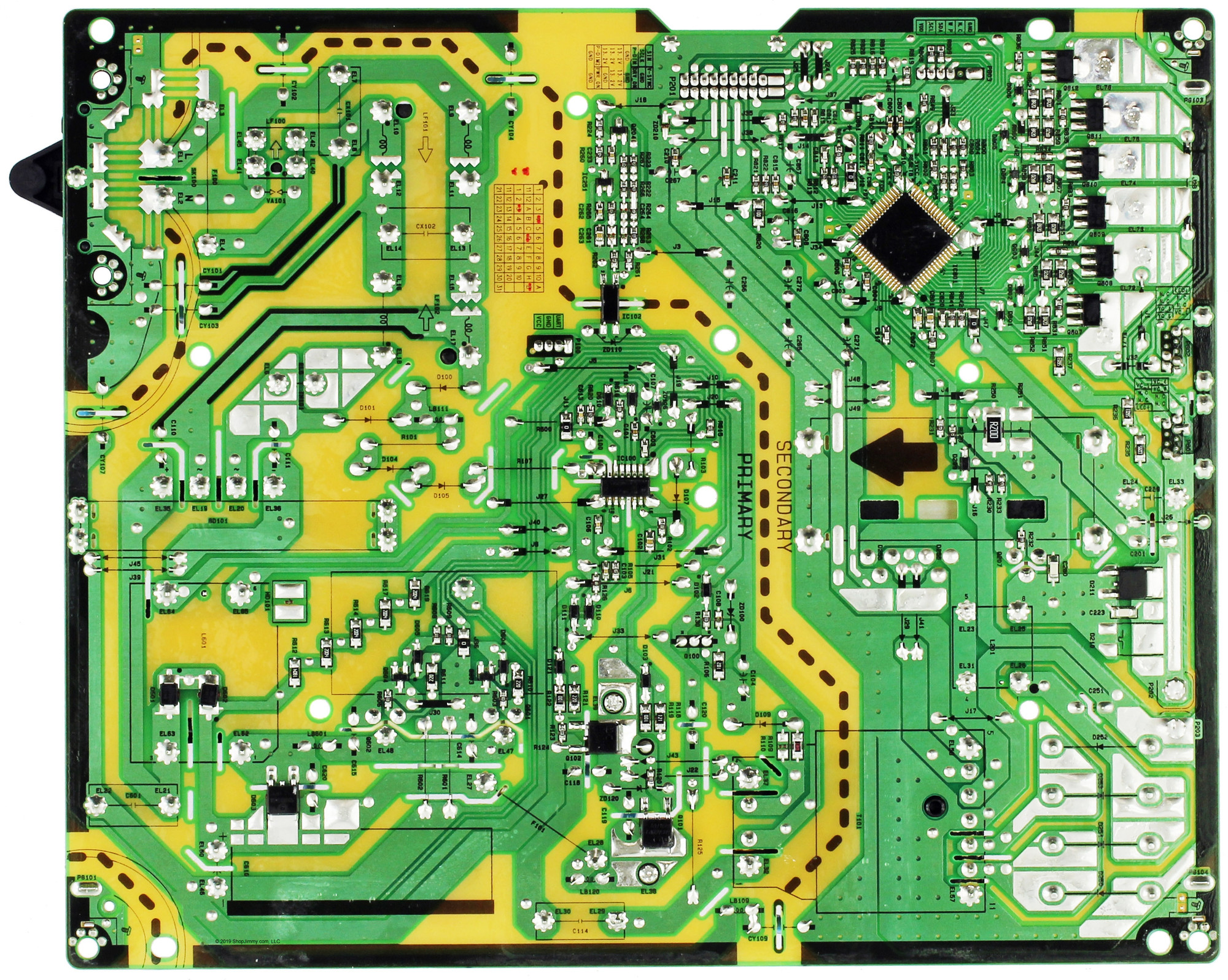

    I have attached a few pictures of the screen displaying a white test pattern, as well as pictures of the PSU from Shop Jimmy. 3rd pic is it looking normal.

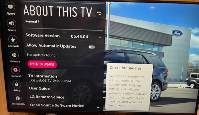

    make sure the firmware is up to date.
    • zward
      • Oct 2022
      • 5
      Re: LG 49SK8000 intermittent dim backlight zones
      Thank you for the suggestion. Firmware is up to date using the built-in updater. I had long hoped that would do the trick, but no dice.

          My guess is a bad solder joint, which could be anywhere, or something with the driver section of the PSU.
