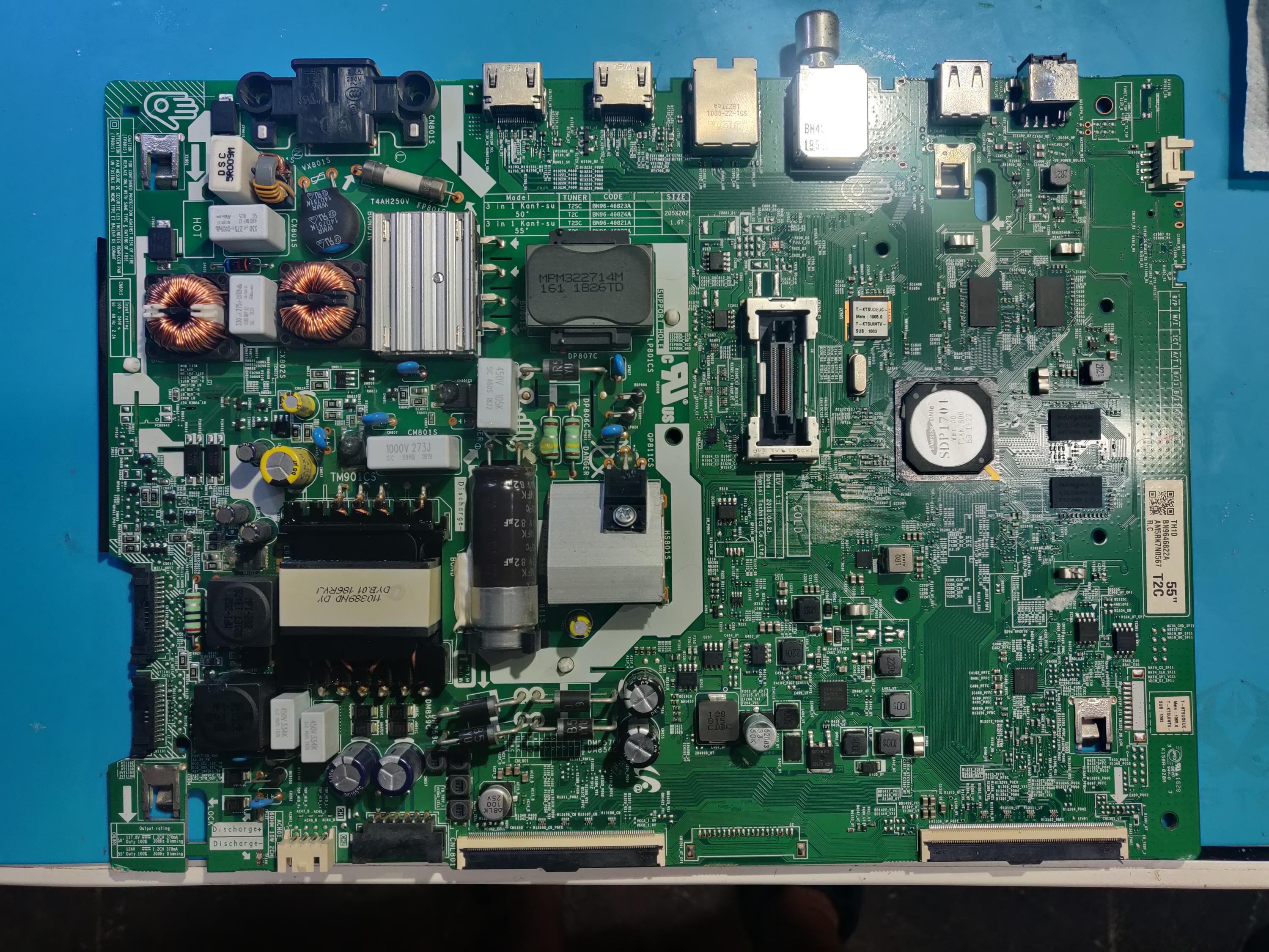

    Hi all, I have a Samsung 55" with a startup problem, backlights light up and there is an attempt to show a picture but it turns off, flashes 3 times on power LED and tries again to start. When I remove one of the T-Con flexes I can hear the startup sound but nothing appears on the screen apart from the backlights turning on, same happens each side. I cannot see any damage to the T-con strips so I am not sure at this point if the problem is Mainboard or LCD panel.
    The customer claimed the TV just stopped showing a picture all of a sudden.
    Any help would be highly appreciated.
    Main/Power board is BN9646822A - Panel is CY-NN055HGLV6H

    locate on the panel's distribution boards an eventual short circuit on caps/diodes

      Tested all caps and diodes on both boards, nothing was short or damaged. Not sure where to look now.

        If you don't have an image on half the screen when you disconnect a ribbon, it means that the protection comes in at the t-con. To see which part of the screen has problems, you must cancel the t-con protection.

          This is an all-in-one board with PS, Main and Tcon on one PCB. I can't find anything relevant to this type of board online, just videos in hindi for common T-Con boards.

                    Disconnect power supply from Mai board backlights should fire up ok
                    Disconnect main board to screen bothe lvds cables see if it boots properly if it does panel is shorted, use tape to insulate lvds top five or six traces of the top lvds cable is a good start

                      I already stated in my first message that backlight isn't the issue... with either one of the flex going to T-Con connected it boots as I can hear the startup chime, with both connected it reboots. I'll reassemble and return to the customer as I'm not prepared to spend time or money on it just to find out the panel is bad. Thank you everyone for your input and time.

                        I have the same problem.The problem is panel.When I disconect any flat from T-con,the tv starts and I can hear audio.When the connect both flat cable from T- con the tv restarts.

                          right on both tvs, panel problem.

                            If panel distribution board has shorted rails (by testing both side of caps for continuity), then thermal cam + voltage injection can find it. Recently fixed one like this.
