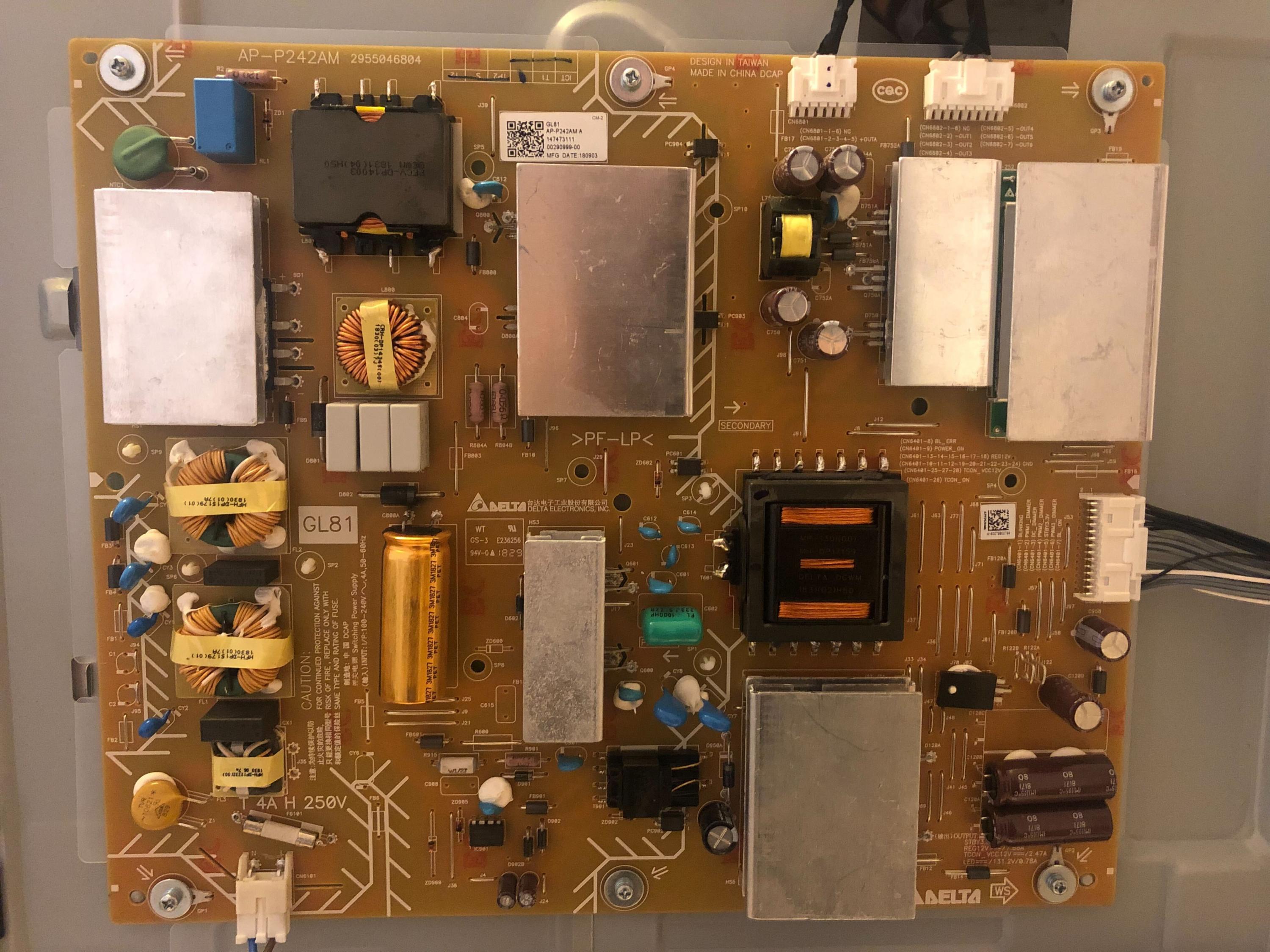

        When I plug in the TV, everything stays black, the status LED also stays off.
        PFC: 390V
        CN6801-2-3-4-5: 75V
        CN6401-5 (STBY3.3V): 3.5V
        CN6401-8 (BL_ERR): 2.3V
        CN6401-13 (REG12V): 12.7V
        CN6401-25 (TCON_VCC12V): 0V
        At the Mainboard (for example at the ICs at the top) there is 3.5V present and also at the wifi board.
        When I try to turn on the TV with the power button or with the remote control, nothing changes.

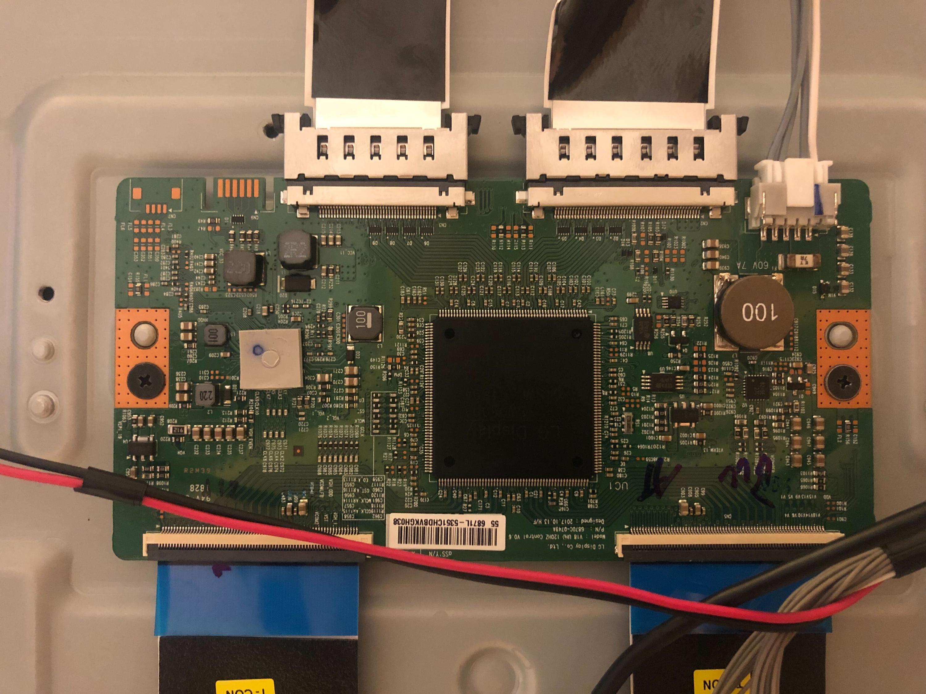

        Next I checked following:
        CN6401-7 (BL_ON) connected with 3.3V:
        The relay on the PSU clicks and switches
        CN6401-26 (TCON_ON) connected with 3.3V:
        12.7V at T-CON board but no change on panel.
        CN6401-26 (TCON_ON) connected with 3.3V and ribons between mainboard and t-con-board removed:
        12V at T-CON board and the panel changes brigthnes/color. Looks like green <-> black?!

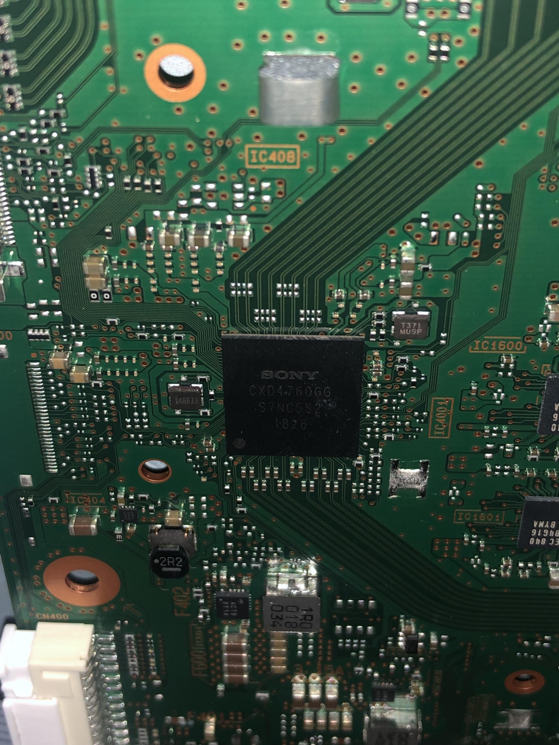

          check if there is a microcontroller on main board for example called PICxxxxxx, i see it probably neat the green audio jack con., it must to be rewritten, have you got an eprom programmer?
          • TobiasG
            • Sep 2022
            • 16
            • Deutschland

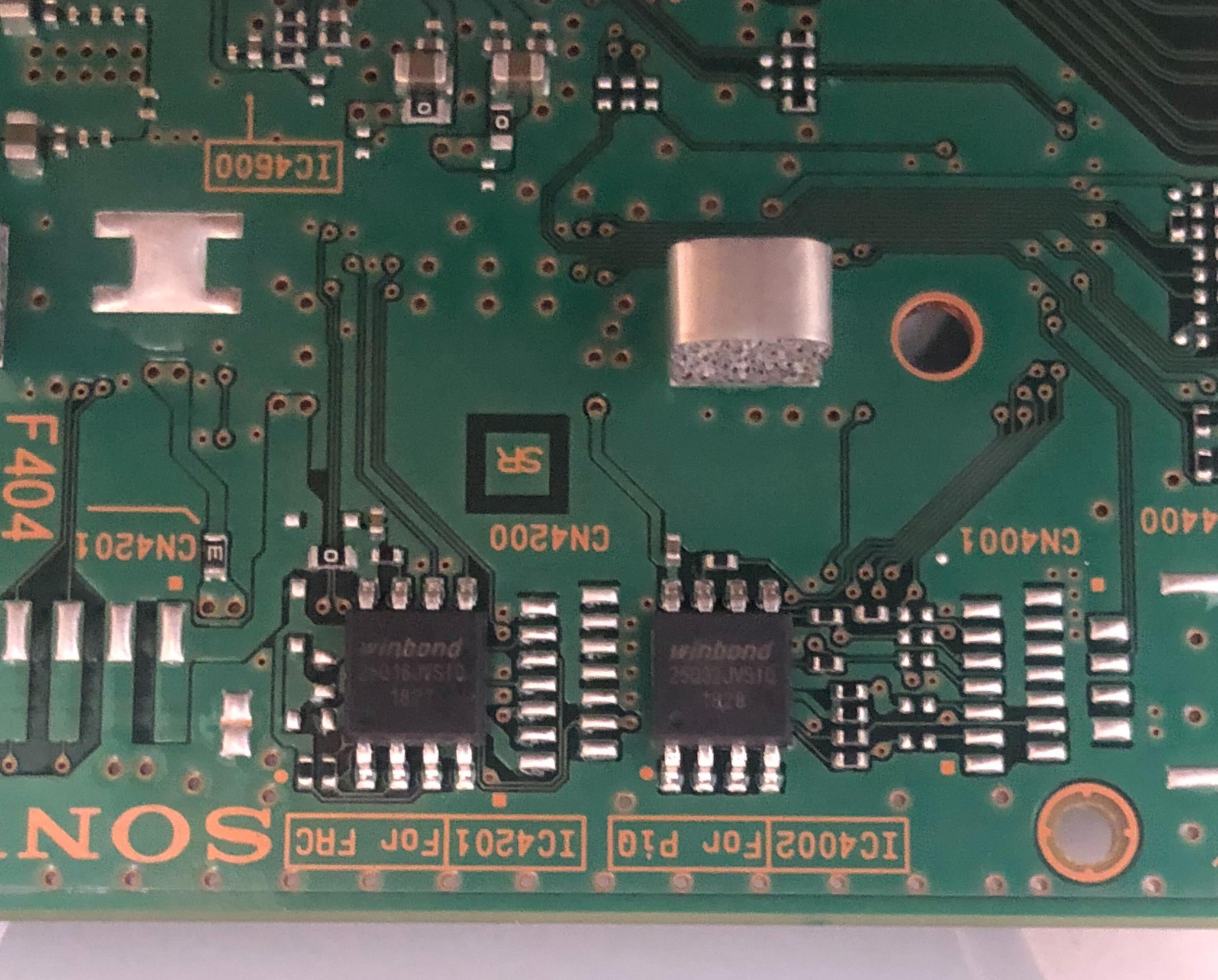

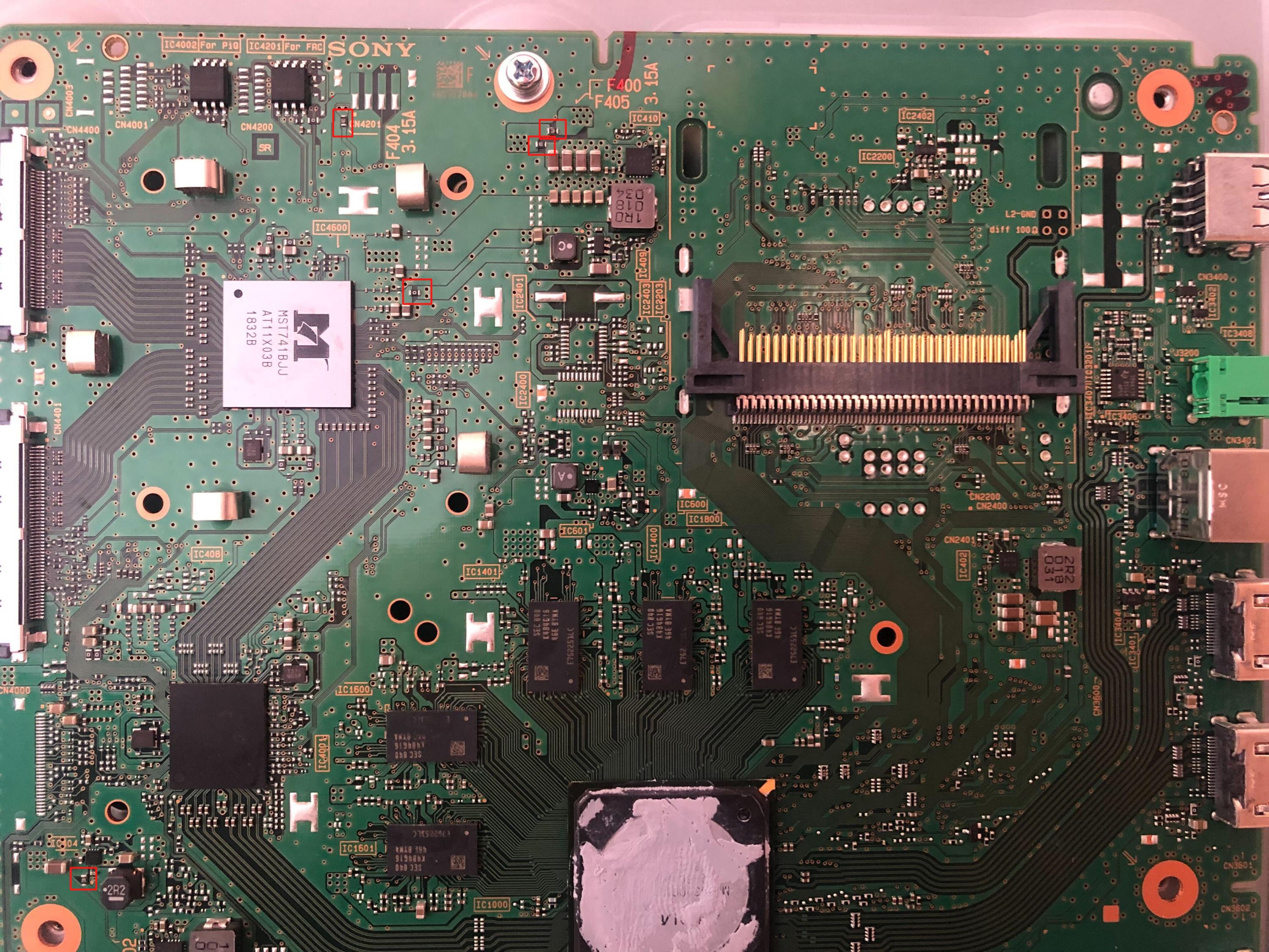

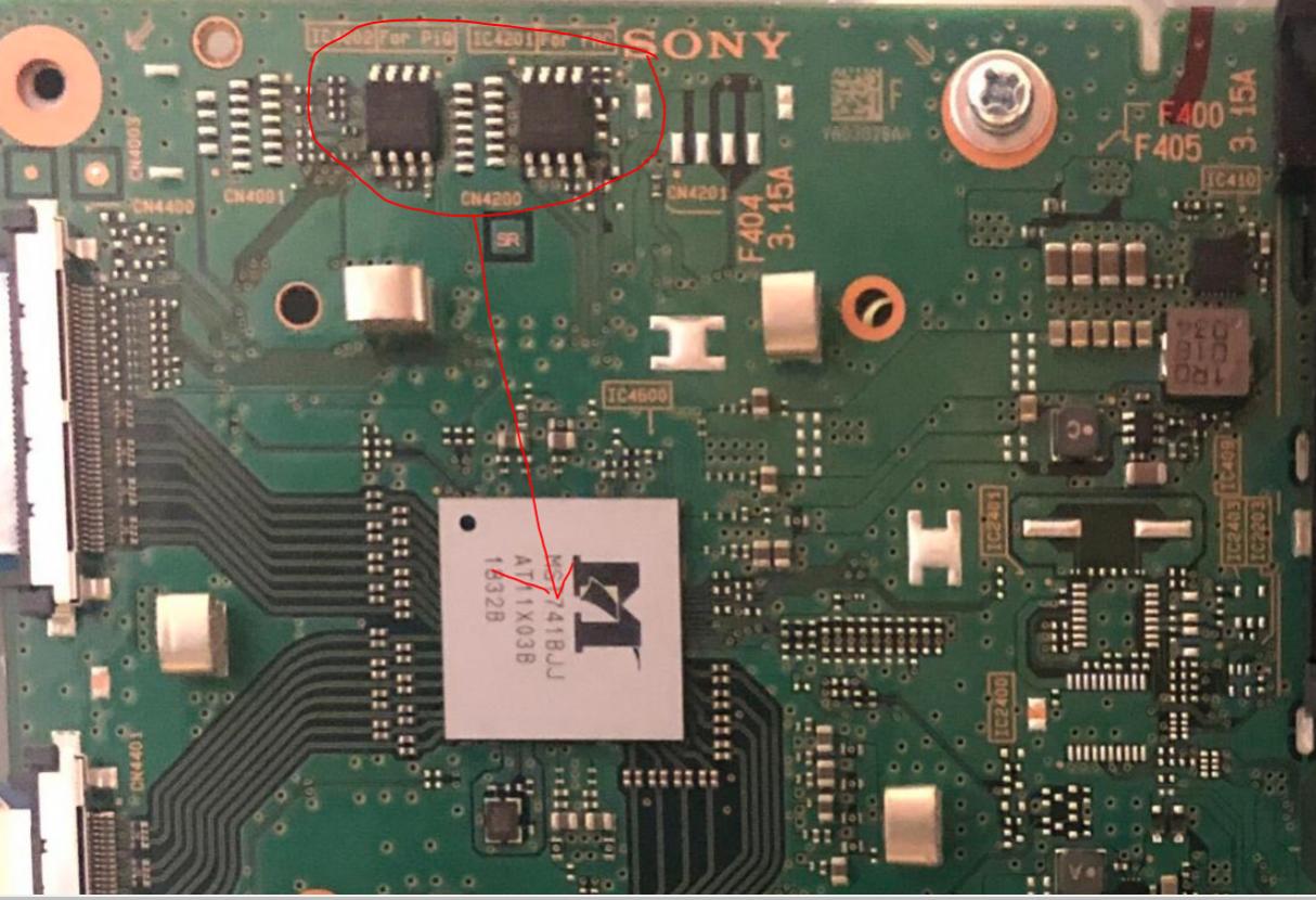

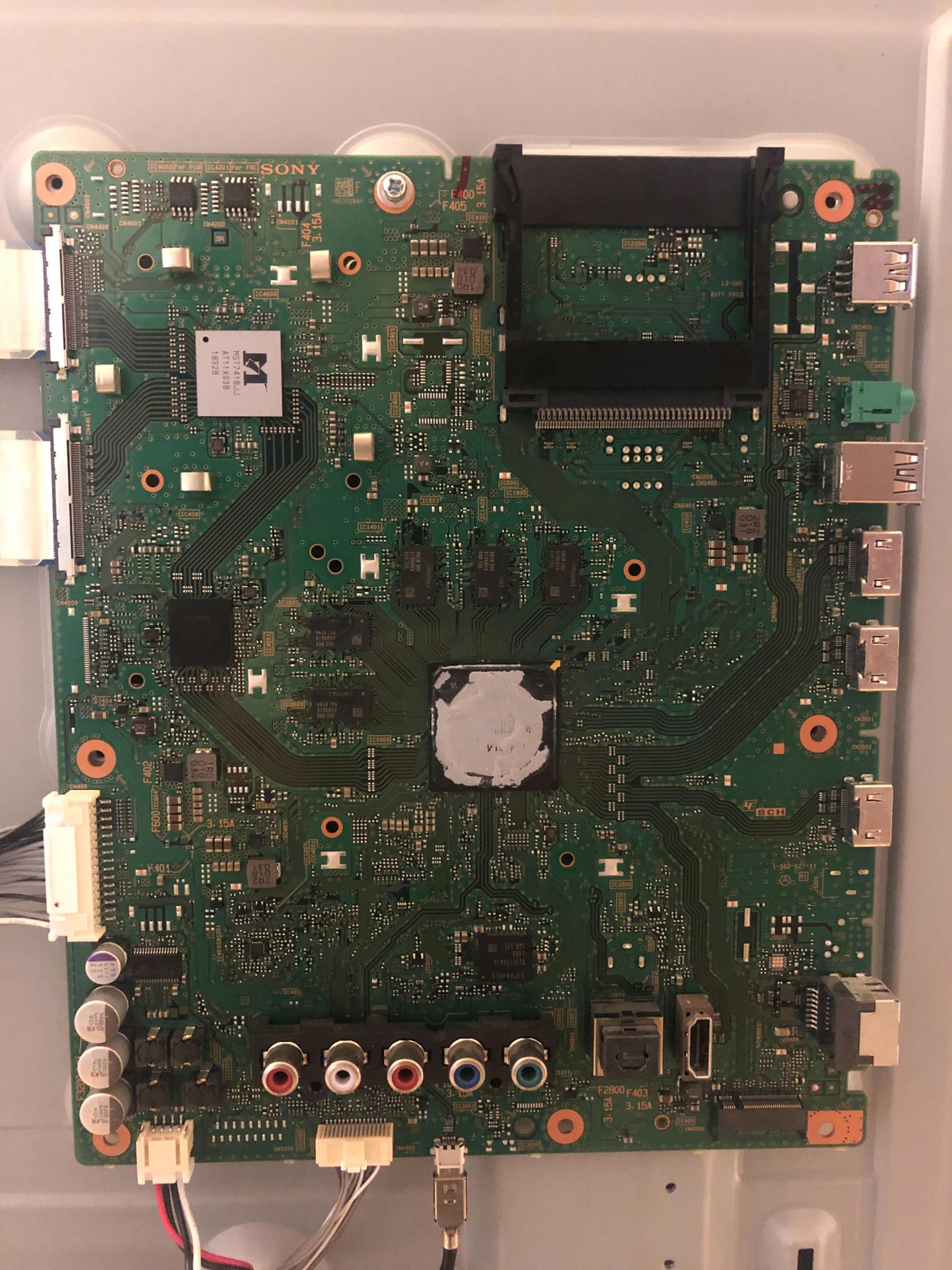

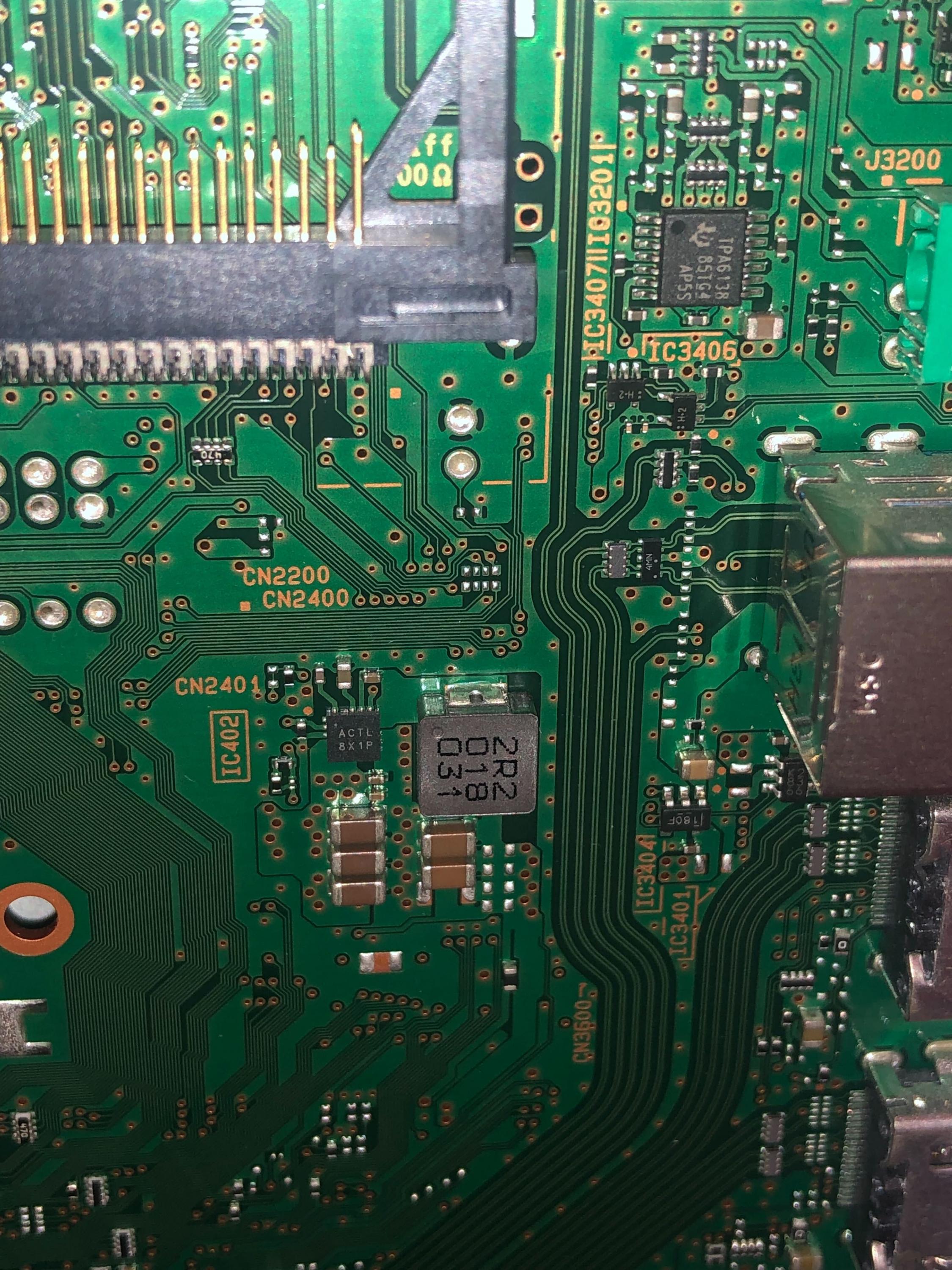

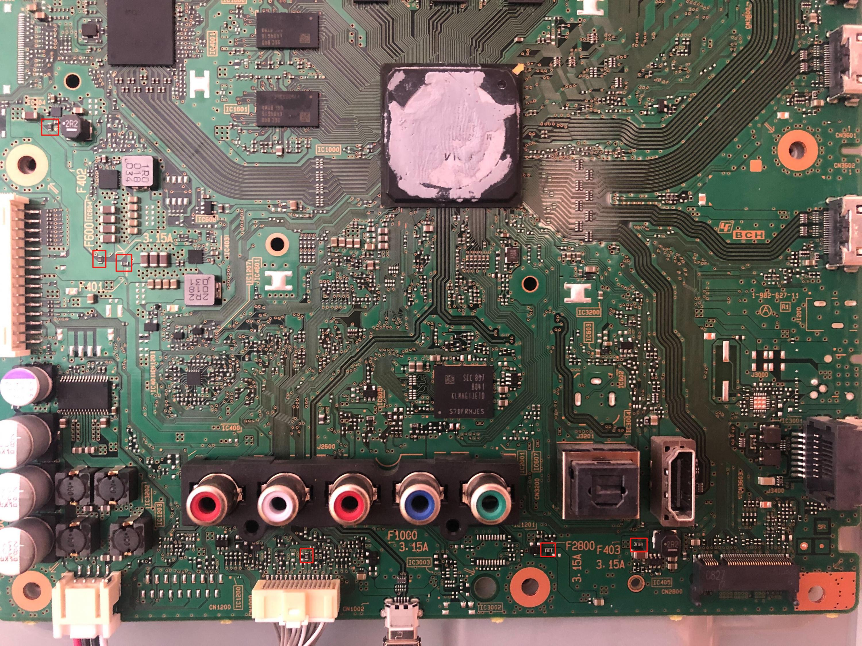

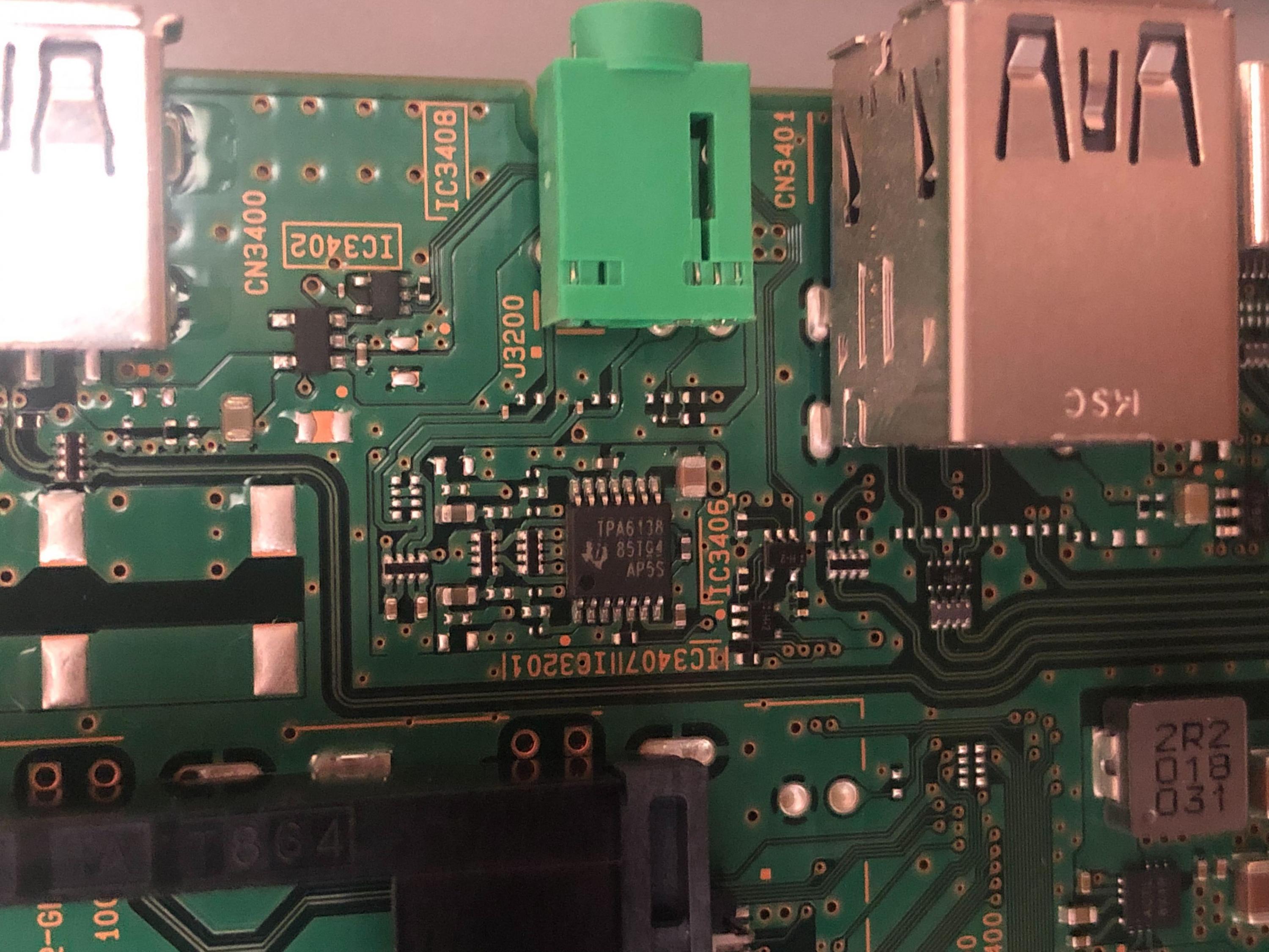

            Re: Sony KD-55XF8505 won‘t start
            No there isnt any called PICxxxxxx :/

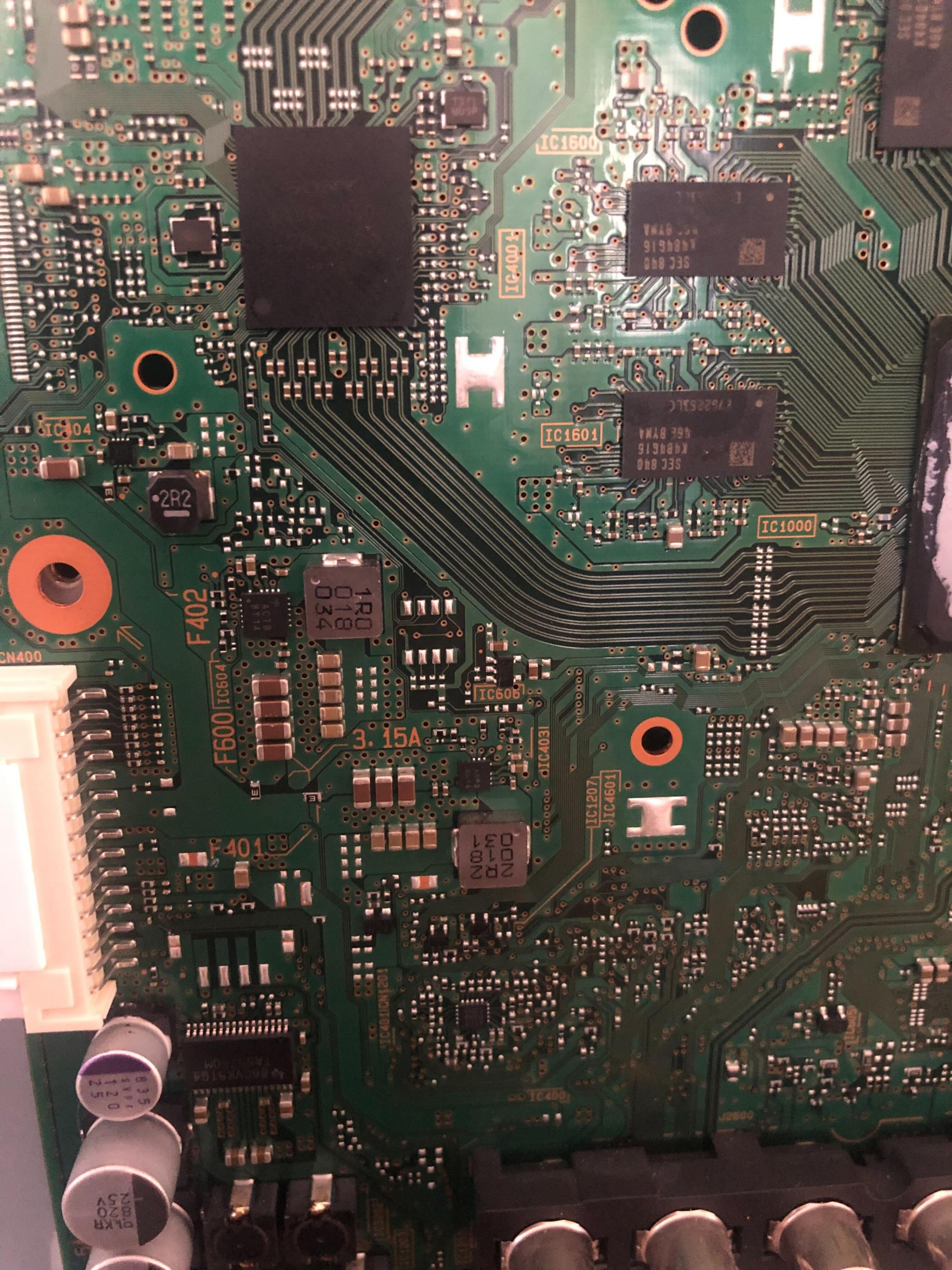

            I attached some pictures.
            And yes i own an EPROM programmer
              what's the marking of IC4001? are there any other spi flash like the 2 you photographed? Is there any IC on the under side of the board?

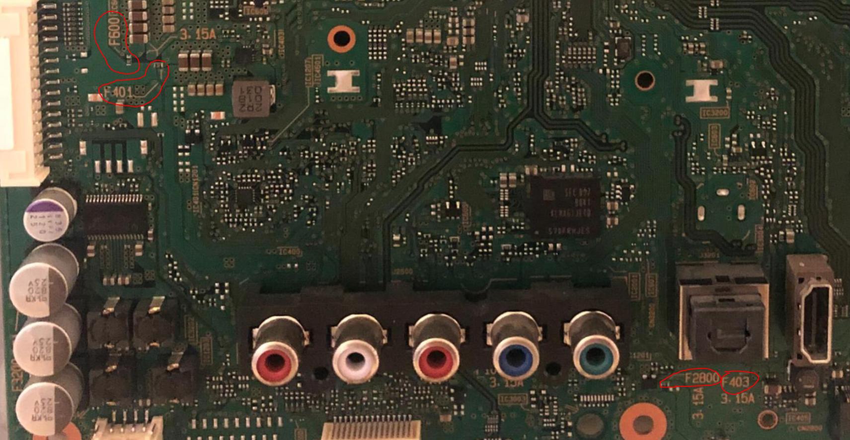

                Sony often put fuses for protection under the designation Fxxx, there are a lot of them on the board, you need to check them all with a multimeter, and the firmware is in the eMMC (IC2001).
                  IC4001:
                  Sony CXD4760GG
                  S7NC5S2
                  1826
                  Under the board there isnt anything.
                  And no, I think there only this 2 winbond 25Q16 chips with the flash memory
                    so ic4002 probably stores the stby firmware (i don't comprehend what is PiG) and must be rewritten, try desolder it, freeze it on the programmer and soon read it, then save dump and rewrite it on the same eprom, if it doesn't work another possibilty is there..

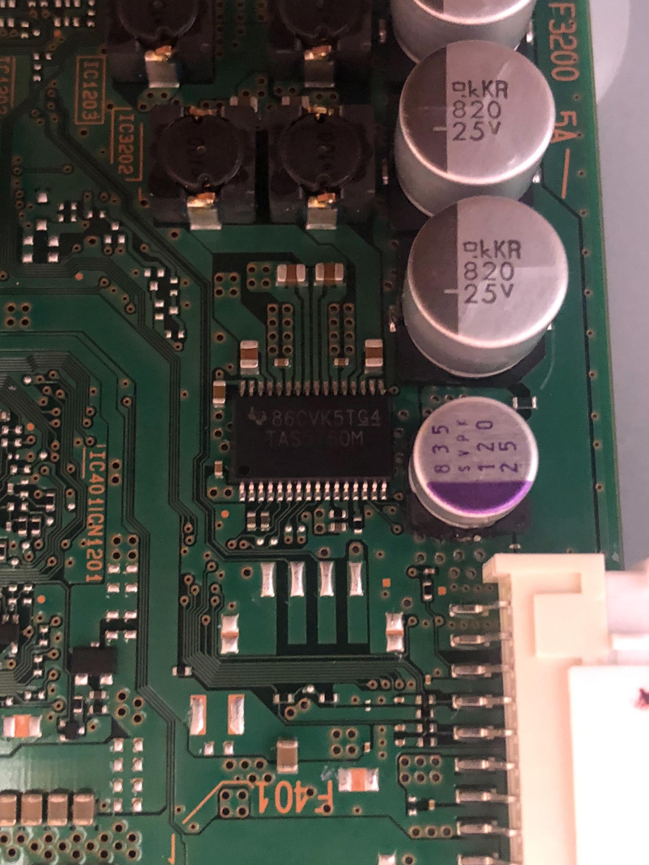

                      I tested the fuses and none seems to be faulty.
                      In the picture I highlighted every tested fuse

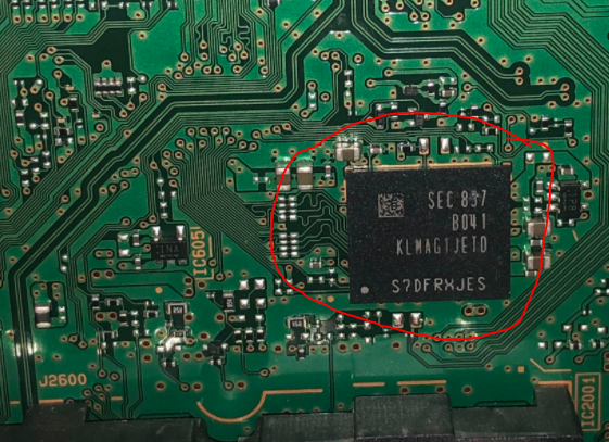

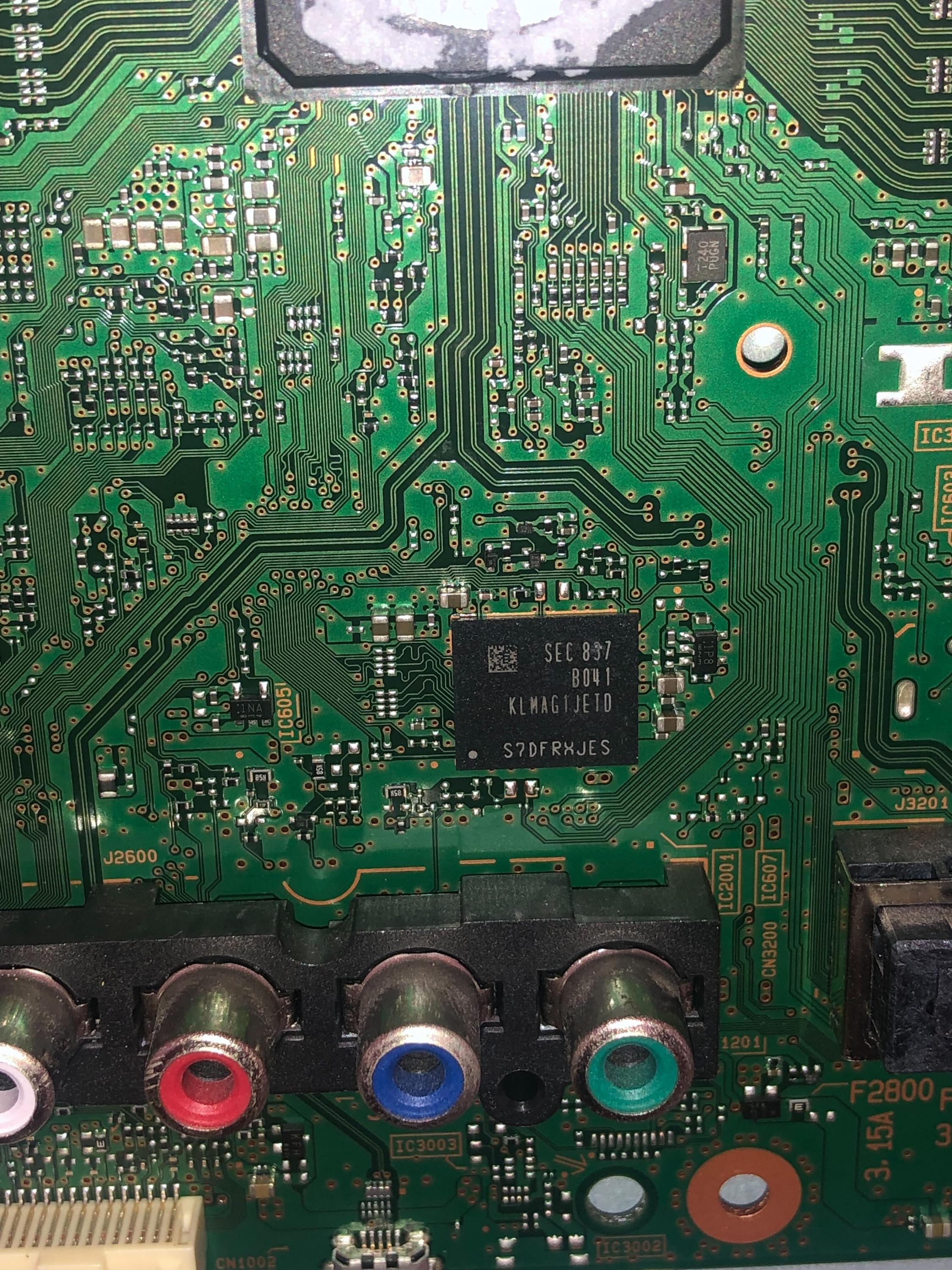

                          Yes IC2001 is the eMMC (Samsung KLMAG1JETD-B041).
                          But could it be, that the firmware is faulty?
                          And if so, how could I test or fix this?
                              Yes, there may be a problem in it, the bootloader is located in it, only the EMMC programmer and a known working dump for this chassis will help here.

                                  Most likely they (SPI Flash) refer to T-Con, (settings for different matrices).

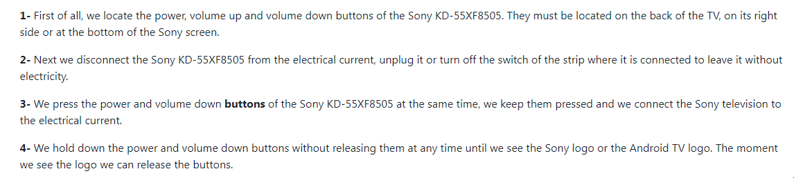

                                      Try to make a hard reset by pressing the buttons and connecting to the power supply.
                                      • TobiasG
                                        • Sep 2022
                                        • 16
                                        • Deutschland
                                        Unfortunately, I've tried that before, but without success
