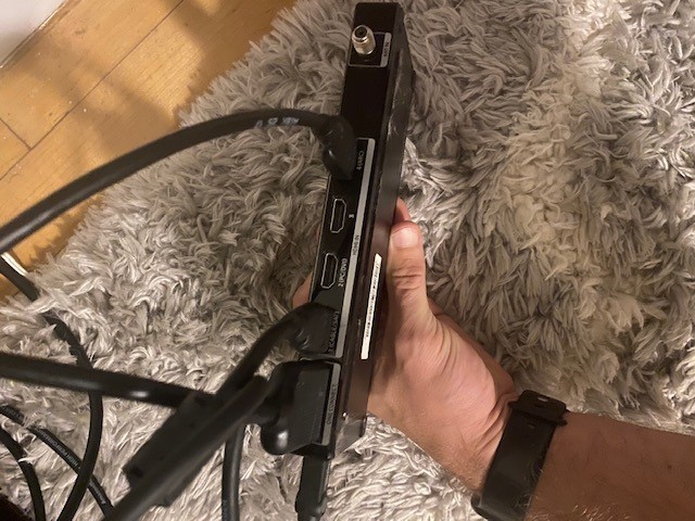

    Hey all,
    I cant get my TV to turn on properly. It has power, the red light is there and solid but when I press the power button, the screen looks like its about to turn on and then it goes black. Then without touching anything, the TV looks like it is power cycling, repeating this process of partially turning on and then off. I even walked away for an hour and it continued to do this the entire time.
    I've tried holding the power button down but that doesn't do anything. I've tried unplugging from wall and using different outlets but when I plug it back in (has power) the same process repeats when I try to turn it on.
    I contacted Samsung but they couldn't tell me anything other than I'll have to create a service ticket for it and pay close to what a new TV costs to repair it.
    Any ideas?
    I added a video (zip) hopefully you can view it of what's going on.

    unhook cable from powerboard to mainboard, leave it off, plug power cable back into powerboard, see if backlights come on and stay on.

      This one uses the one connect box right?

        Re: Samsung UN65KS8500F
        TBH I'm not entirely sure what you mean with your instructions.
        But yes it has the One Connect box.

          ok, I don't think you can fix this issue without taking the back off and doing some testing, might get lucky and see something obvious, otherwise will need at least a multimeter to do some basic testing, if you want to give it a go, post some good clear straight on pictures of each board and one of the whole back as to see how everything is connected.
