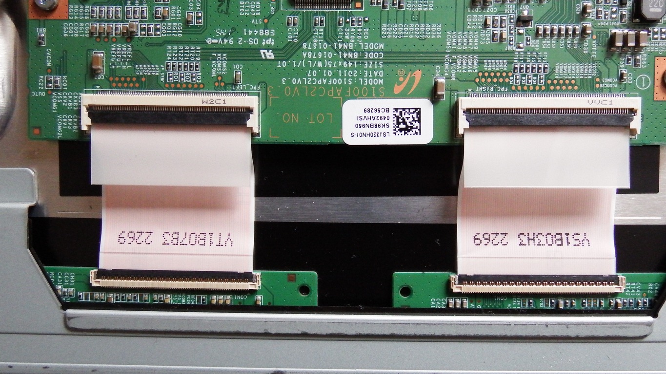

    Hi everyone
    I have a couple of questions to ask if I may.

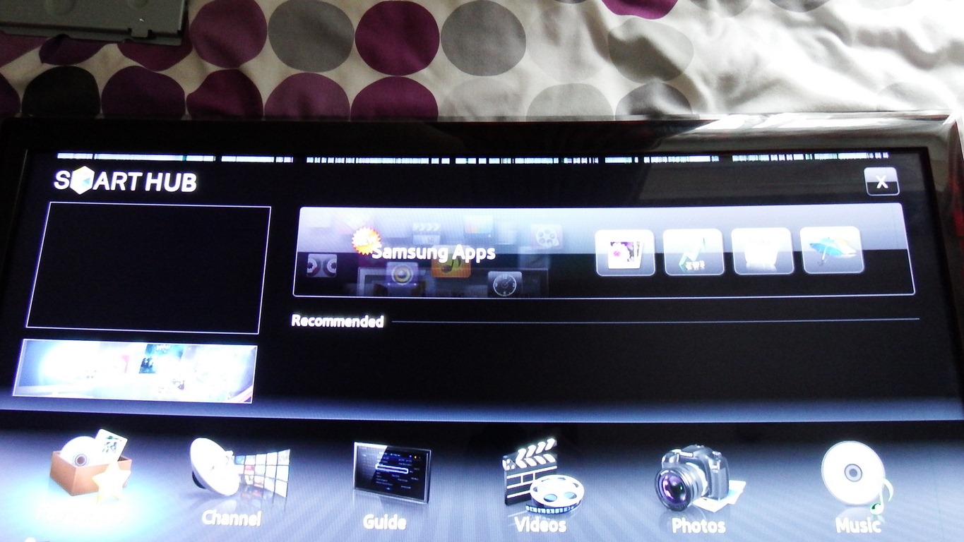

    I have a couple of issues, the main one is that of the horizontal lines at the top of the screen.
    These fade in and fade out as I change menu's. However fine lines are there when playing a movie say.
    I have re-seated the cables and the T-con ribbon cables, one of which I think needs replacing on the
    right hand side as I have a one green fine line vertical on the right now. So where is the best place
    to get a single ribbon cable?
    I have updated the interface software with no change.
    So would the horizontal lines be created by the t-con board? Or is another board responsible for this?

    Re: Samsung UE32D5700 RSXZF screen issues advice welcome
    So, you have vertical lines on screen, but no lines on menu?
