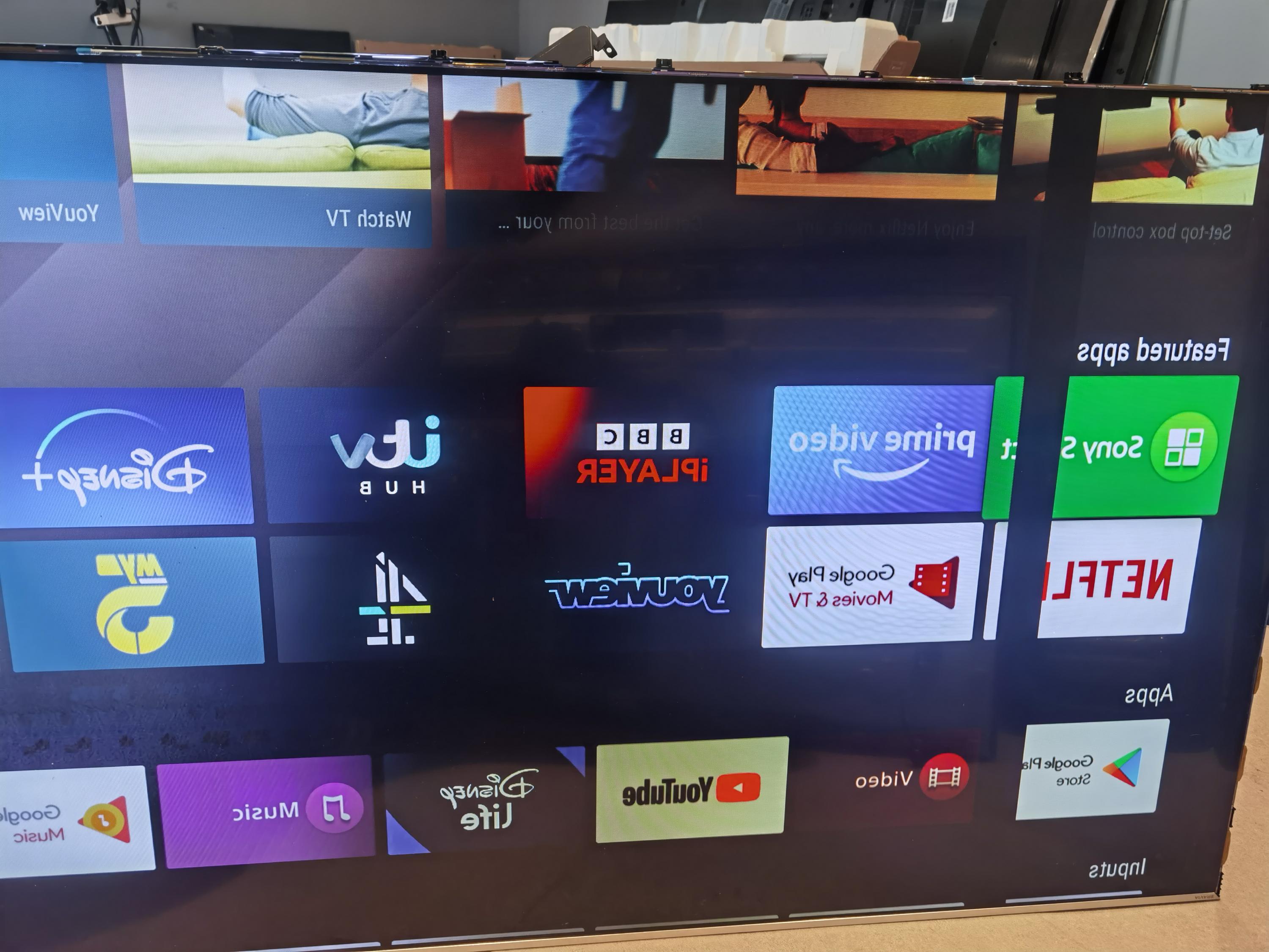

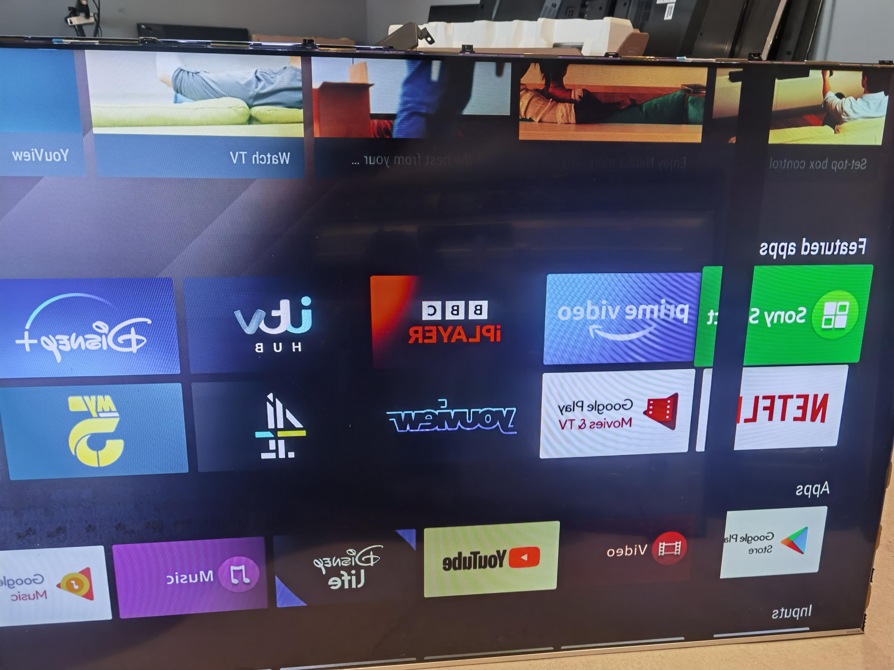

    Hi, me again.
    Grabbed that Sony with 6 blinking lights. Easy job, especially that I had LED set. Replaced them, upon reinstalling everything and doing test I was shocked. The picture is upside down and mirrored. There is some fading effect on one side (4th TV in a row with backlight problem that turned out to have this issue as well...), and there are 2 black vertical bars. Touching side and bottom tabs doesn't produce any change at all.
    The LEDs were taken from kdl-x857c, basicay same model. I transferred screen to its chassis to save time, but just in case of any incompatibility I transferred main board, tcon and psu as well, so the only thing from 857c is the backlight and chassis.
    Funny thing is, 857c from which I've taken leds, had similar issue - screen fading at one side and black bars. Screen wasn't mirrored though.
    Any ideas or advices? Many thanks in advance.
    https://streamable.com/zo8p54
    My phone automatically rotated the photos. TV is standing upside down on the photos, just to be clear.

    are you sure the backlights are good, is that fadind/darkness in the middle there on those pictures? did you test them with a backlight tester? can get one for about 20 bucks on ebay or amazon if needed.

      That's definitely not backlight - all strips were tested with lab power supply and the backlight is spreaded evenly - its darkening/fading effect here. If you check the video, you can clearly see the slo-mo fading on one side of the screen (the one with black bars).

        ok, I think its either a bad/loose tab bond or a shorted panel.

                    Just played around with tape, no joy. One side is obviously bad, when that's the only side connected there are some stripes on the screen. The typical vertical stripes.
                    With only good side connected, the disconnected part is black instead of expected white, and the remaining half screen is still mirrored.
                    I'll check all the voltages and look for shorts, but honestly I think this one won't be possible to fix, as thee are 3 issues with it: fading/slomo effect, black fertical bars (present even when playing around with tape resulted in colorful artifacts) and the picture being mirrored.

                      might be a lost cause, maybe tear it down very carefully, big screen easy to accidentally break, inspect the cofs closely see if any are burnt or discolored or much hotter than the rest, if you don't detect anything wrong on one side check the other side of the cofs, had one recently cof looked ok on outside the easy side to see but when I got the board to where I could see both sides, one was obviously burnt.
