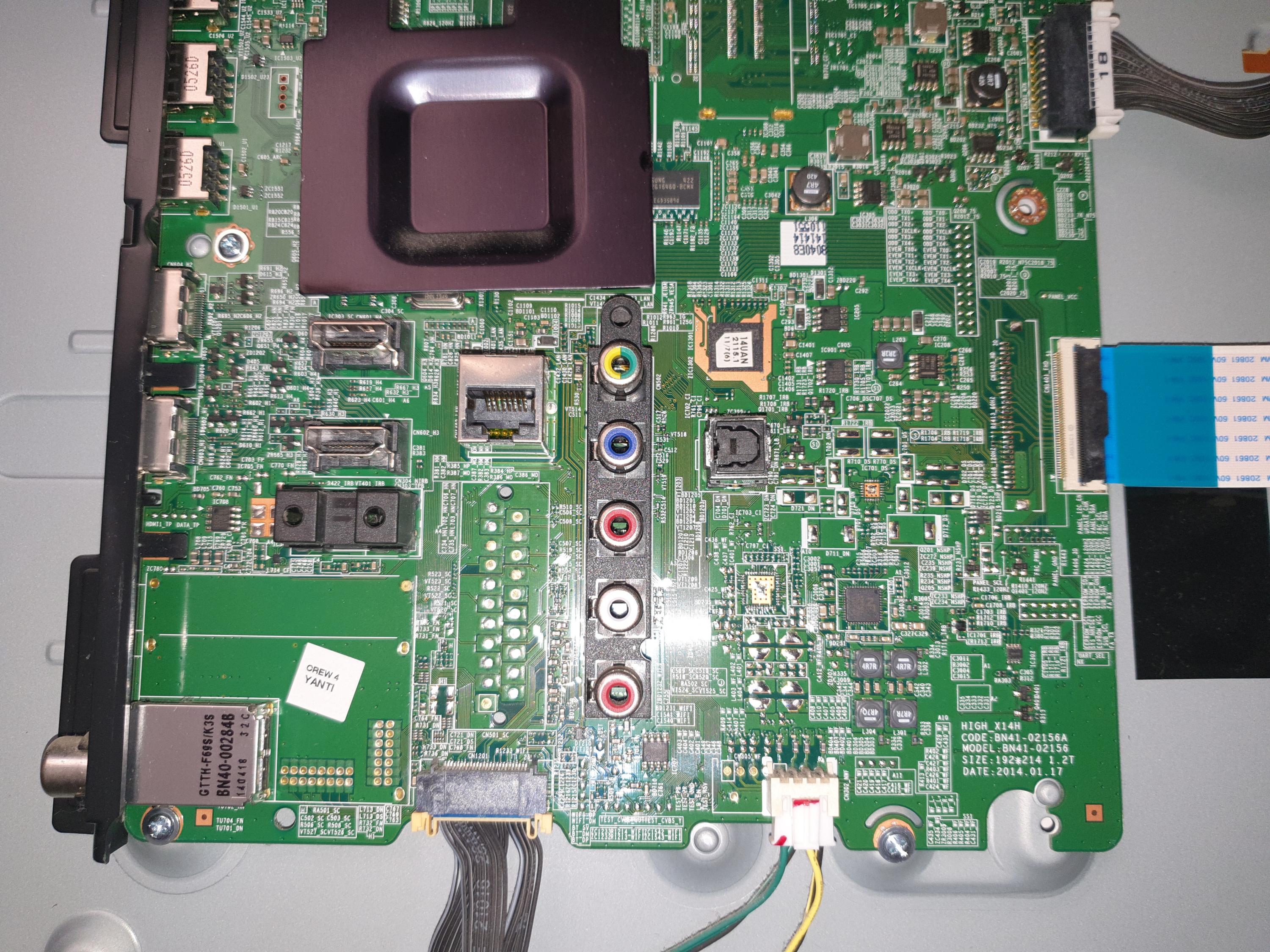

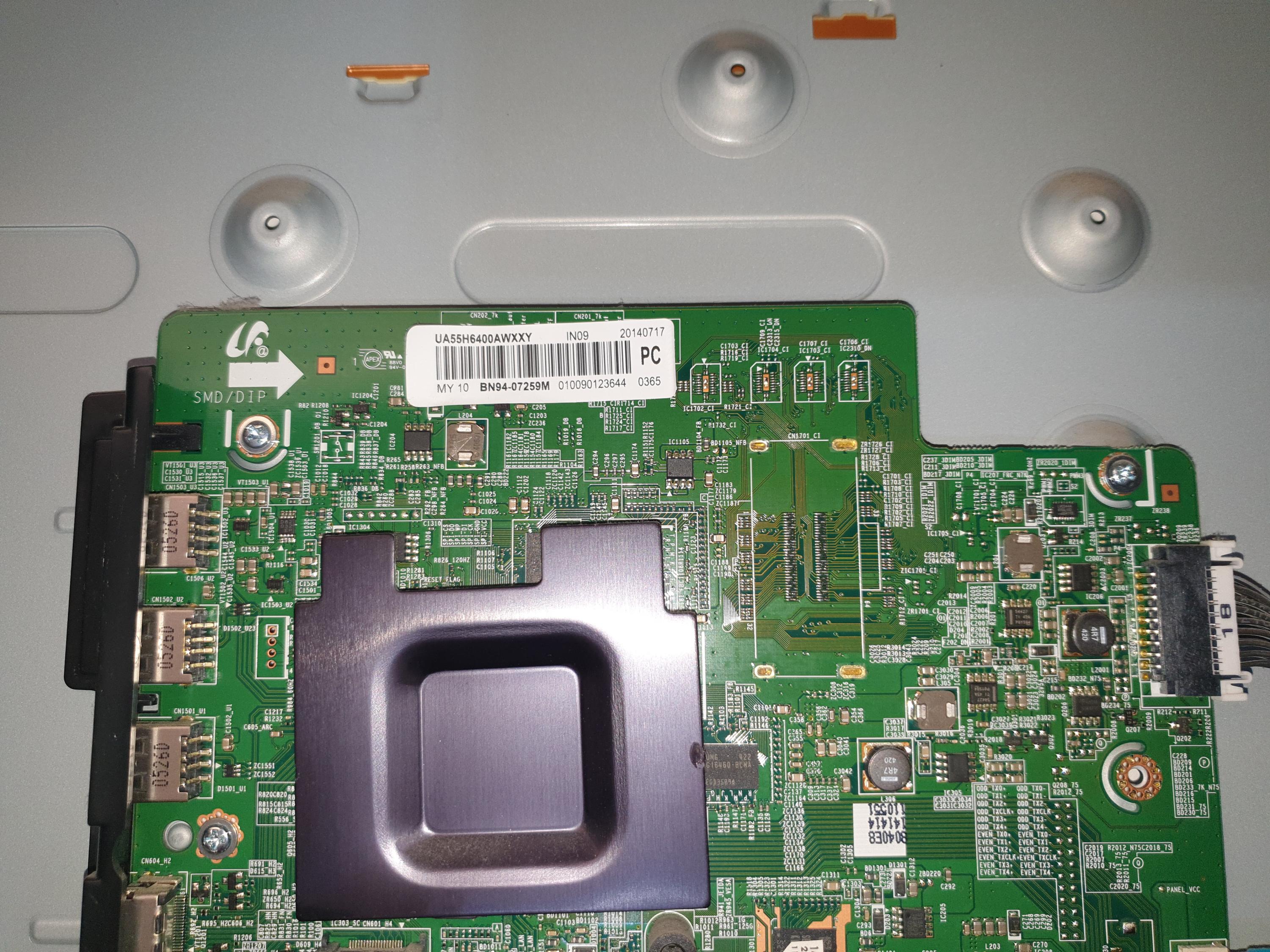

Samsung H6400 random restarts or black screen
  • nubinator
    • Jan 2012
    • 34
    TV works as normal for a few seconds then either get black screen or restart and will continue doing this randomly. If it goes to black screen subtitles and sound keep working.
    In HDMI will get the random reboots but takes longer. With TCON disconnected it still randomly restarts. is this main board issue?
  • dskall
    • Oct 2016
    • 2905
    • usa
    Re: Samsung H6400 random restarts or black screen
    Need to check you power board voltages.
    • nomoresonys
      • Jan 2013
      • 12123
      • U.S.
      samsung, unplug cable from powerboard to mainboard, leave off, plug power cord in, see if backlights come on and stay on, if they do, then backlights and powerboard are ok.
      • nubinator
        • Jan 2012
        • 34
        Yes it is main board. Menus and sound work its just video that goes out doesnt matter what source. Where on the main board would the video processing part be? I might just look for bad solder joints.
        • dskall
          • Oct 2016
          • 2905
          • usa
          Heat up main processor and then try and turn on tv and see if you have picture.
