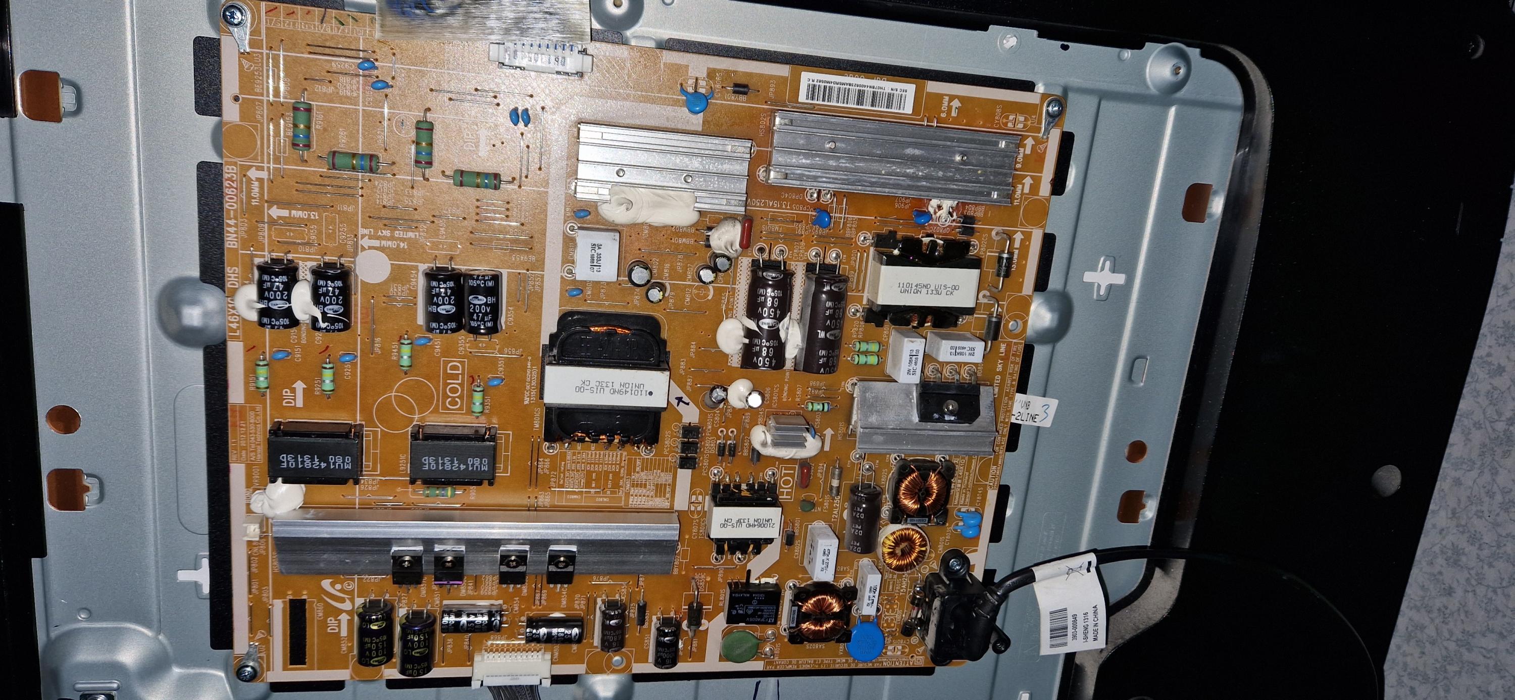

    Bn44-00623B pfc mosfet very hot
    Found pfc mosfet Qp802c shorted. Replaced together with Pfc ic and blu ceramic caps.
    Now pfc is working at 388v. However the heatsink is too hot to the touch. Have compared most values with a scrap o
    Pcb and consulted circuit.
    Any tips on this common board?
    I have the 46 model.
    The 42 is Bn4400622b with same pfc circuit.
    Thanks.

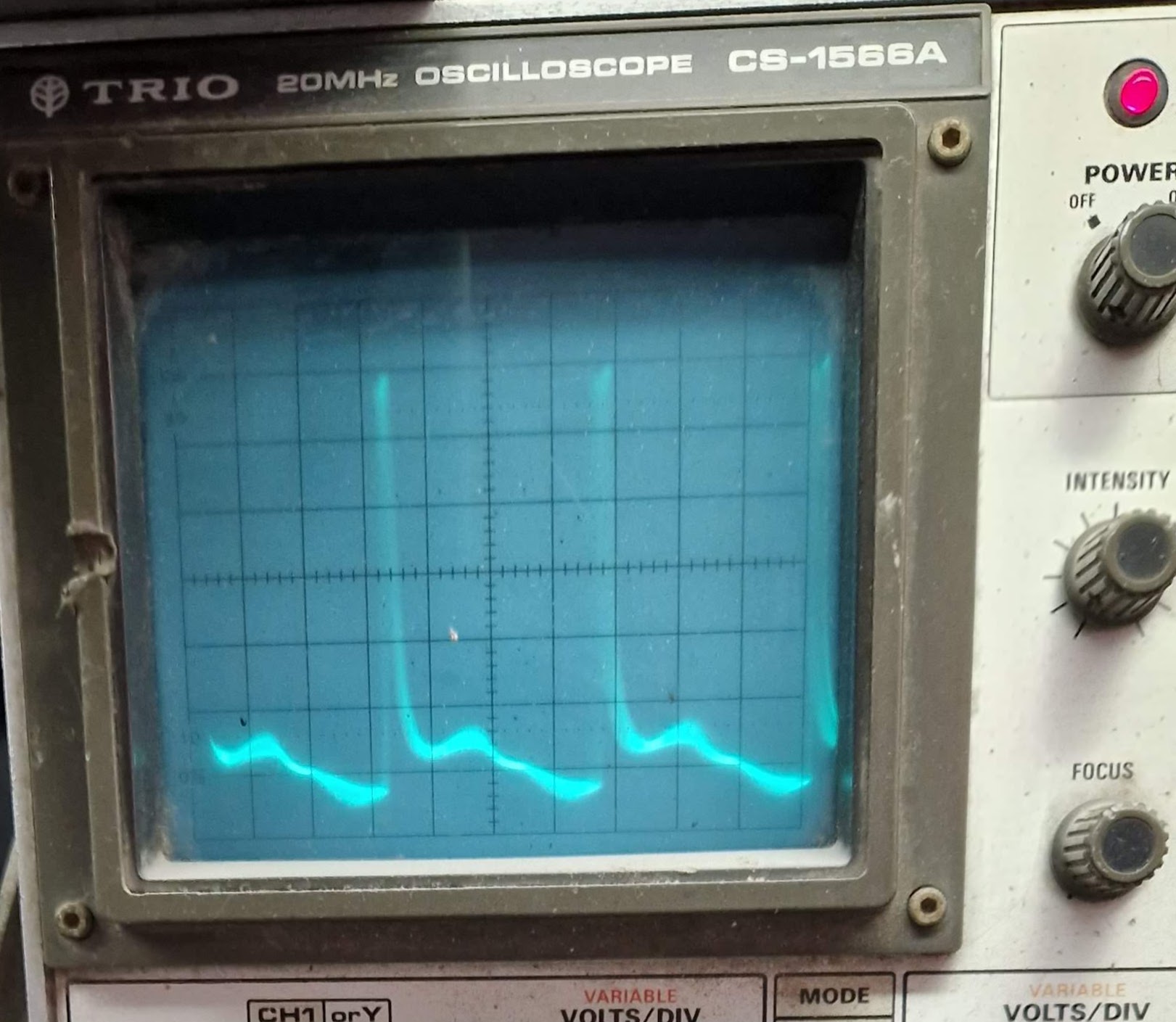

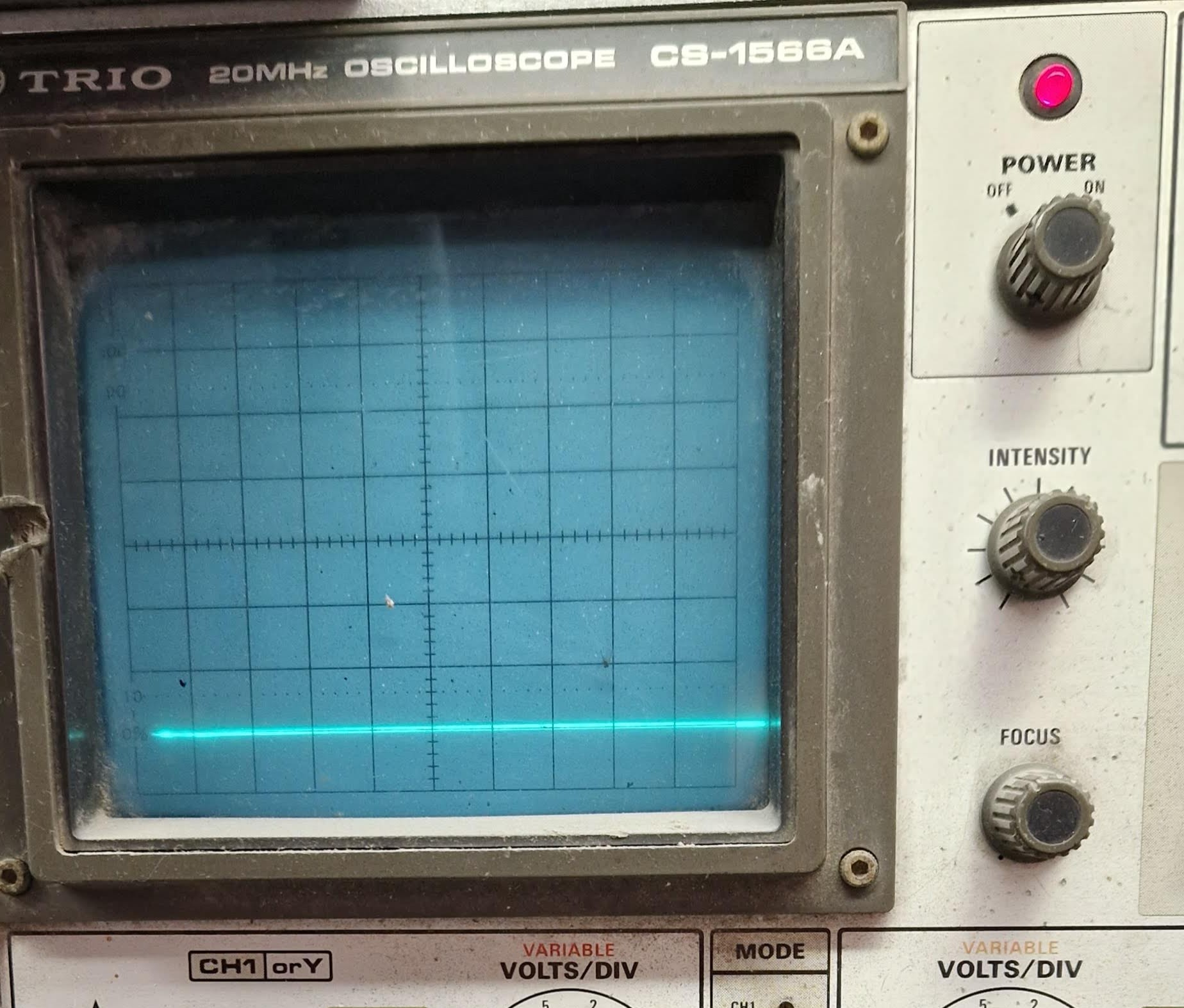

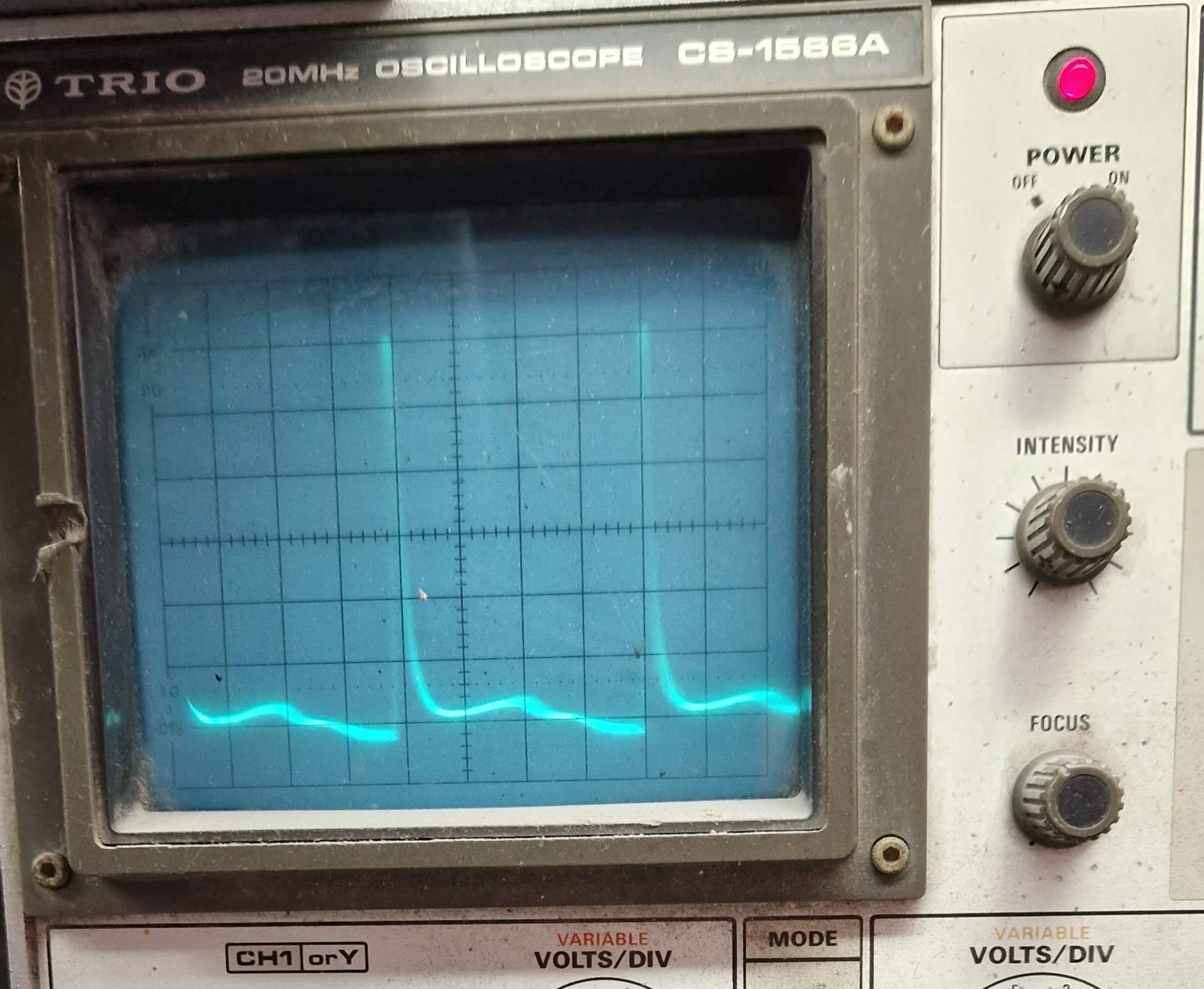

                Re: Bn44-00623B pfc mosfet very hot
                HI,
                I have replaced most of the Gate driver compoinents and others as highlighted in pdf attached.
                I have scoped both the bad board and a good one I have as spare. There is a slight frequency difference as both settings where the same.
                Offset 0V
                Bad board Gate pin
                Good board Gate pin
                Highlighted schematic
                Still no progress.
                I am trying the board on its own now on the bench. Still heats up, a bit less due to less load but still more than the good one.
                Any clues?
