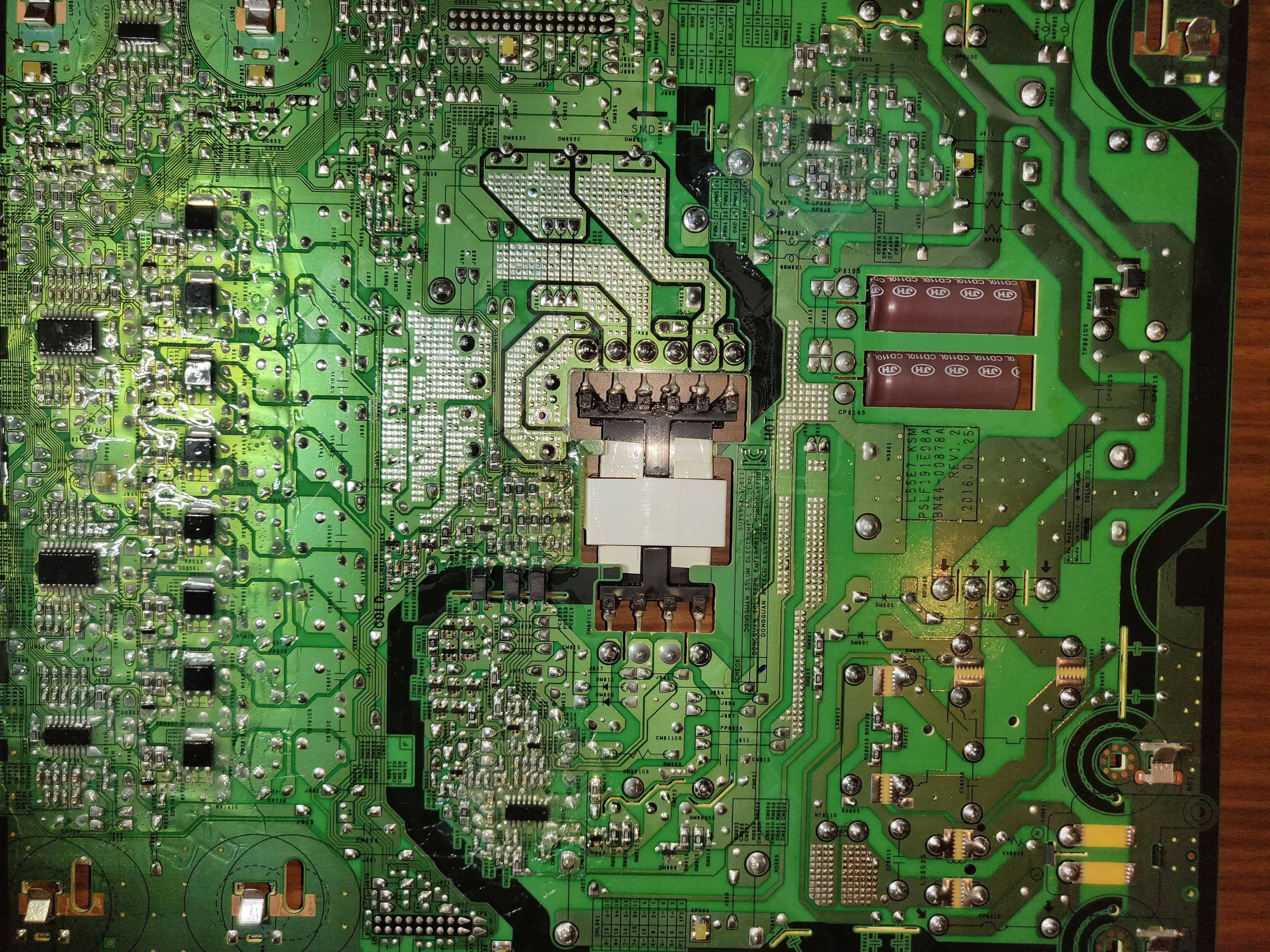

    Re: Samsung UE49KS7000SXXH - No standby light
    can you trace that diode back? the dark green is the trace, see what it leads to.
      maybe check those 2 transistors on that heatsink.

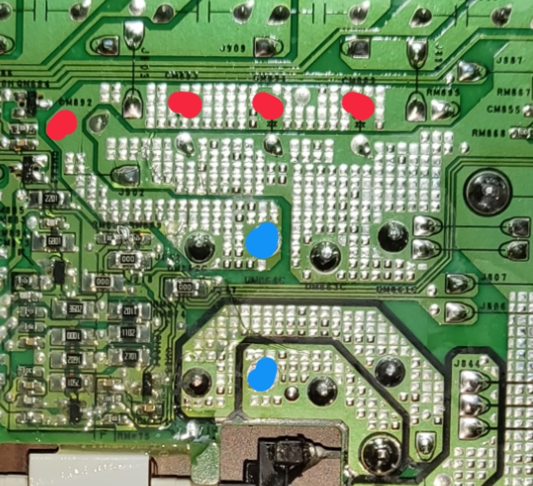

            #45
            I'm looking at a picture of a similar board but it isn't very clear to see, not focused.
            Image of the board.. if something is causing diode to get shorted, do we need to look before diode or after?
            That diode and one next to it (second adn third diode) are connected to the transformer pin. I guess that in the middle is the transformer? Another two diodes are connected to the oppsoite transformer pin

              #46
              looks like it feeds to CM891, maybe check that cap.

                #47
                you were getting 390 at the big cap, I think that means the transformer is ok.

                  #48
                  a diode that failed from reverse voltage in excess of the breakdown voltage of the diode will tend to fail to a short, while one that failed from excessive forward current leading to overheating will tend to fail open, but that is not guaranteed.

                    #49
                    So short can happen if 60+ voltage (SB560 is 60v) come to the cathode (-) of the diode?

                            • Serbia
                            #53
                            All 4 caps are on the shorted diode path, plus sign of caps are on that line.
                            What to test on it? Voltage or? I need to solder diode back before testing it with power on?

                                      #58
                                      I'm facing a repair that has the same exact description, did you ever find out what was wrong?
                                      • B0r1s
                                        • Jun 2022
                                        • 21
                                        • Serbia
                                        #59
                                        Yes, one of the connections from big transformator in the centre of the board was broken i guess. I removed solder from all these connections and added new solder at these spots, and it's working after that. There is a video on youtube, some guy fixed his samsung tv with reflowing these spots but cant find it now.
                                        • nomoresonys
                                          • Jan 2013
                                          • 12331
                                          • U.S.
                                          #60
                                          So you couldn't be bothered to come back and type a sentence that you fixed it by reflowing the solder joints, you are no more important than the rest of us, right?
