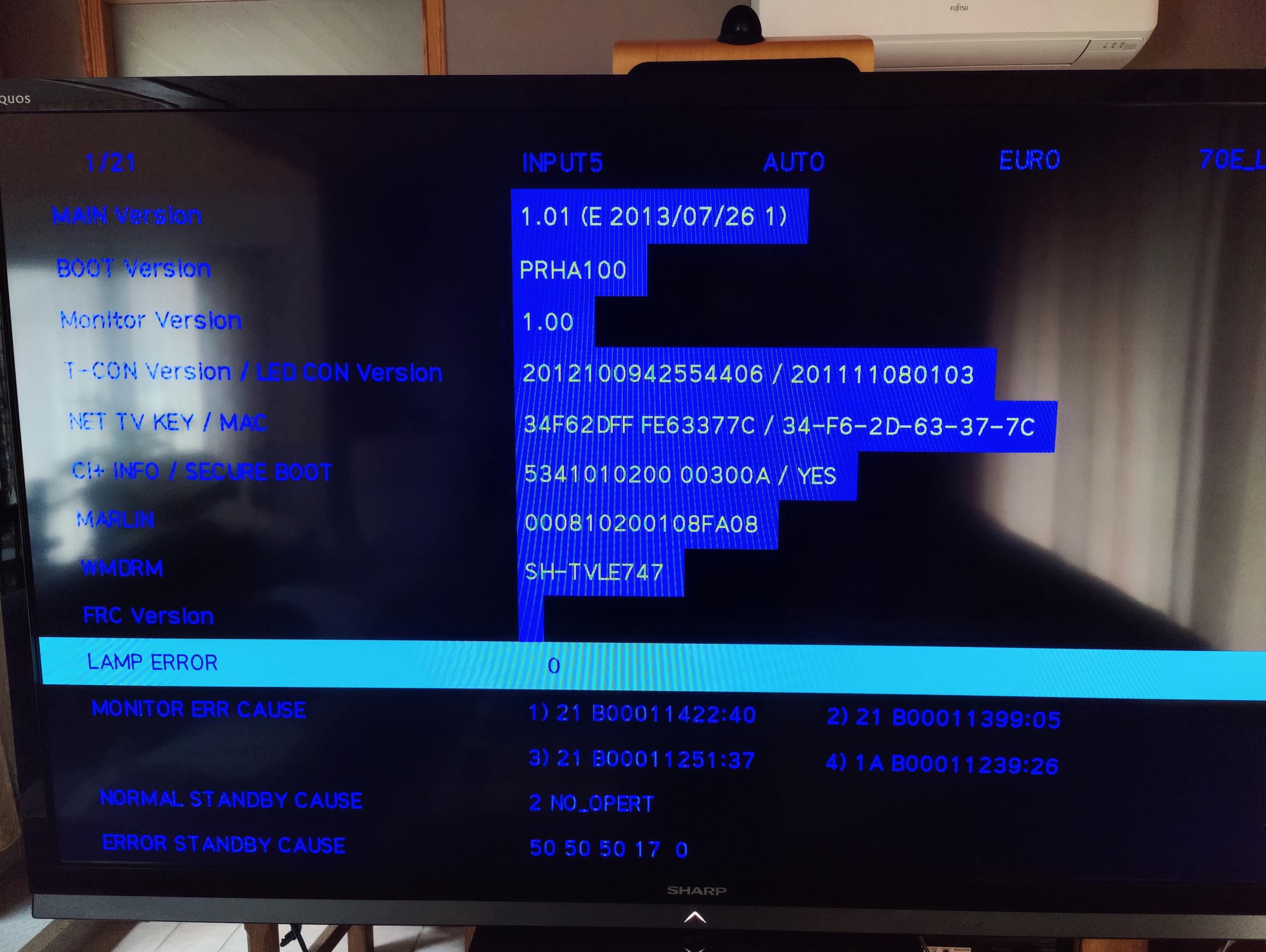

            I've checked the first page of the inspection. See included picture.
            Lamp Error = 0
            There are some monitor err causes.
            1) 21 B00011422:40
            2) 21 B00011399:05
            3) 21 B00011251:35
            4) 1A B00011239:26
            I hope this give a clue where to search.

              so the inspection mode pointed to 21 PCB Panel power failure

                Okay. that's the PNL 12V on the PSU board.
                How did you figure out this detail?

                  early i uploaded for you the service manual at my post #6 .. display code detail listed on Page 63

                    Oh, I read only the page you indicated me earlier. I didn't realise what an information treasure you posted to me. I am sorry for this aberration.
