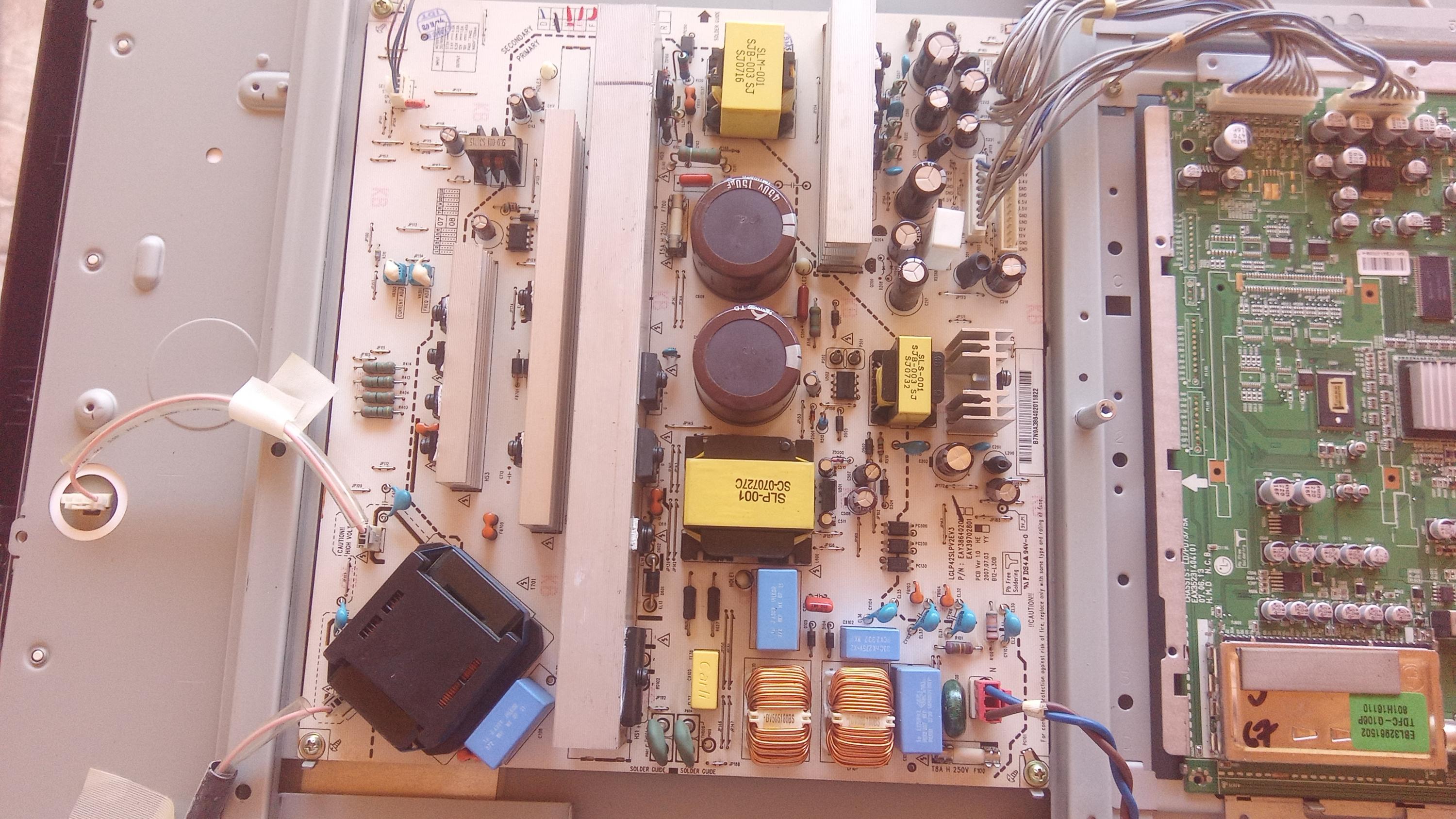

    hi to all
    i have the above model lcd tv
    the problem is like the title blinking the green led 7 times after is steady green for 30 seconds i can see picture without backlight used a lens and after i hear something like sound from the speaker i think and the green led goes out with the image of course
    thanks in advance

    Re: lg 42lc55 7 times blinking and after goes out
    need good straight on pictures of every board and one of the whole back as to see how everything is connected and a clear closeup of the map/legend of the powerboard.
      ok sir
      i have take some pictures
        Need to test backlights.
          thanks for the answer sir
          and i believe maby its backlight problem
          in my case if you notice from the foto i have two plugs go to the ccfl lights
          , but each plug has one wire
          how can i connect external a ccfl light for testing the inverter ?
          one or two lamp must i connect ?

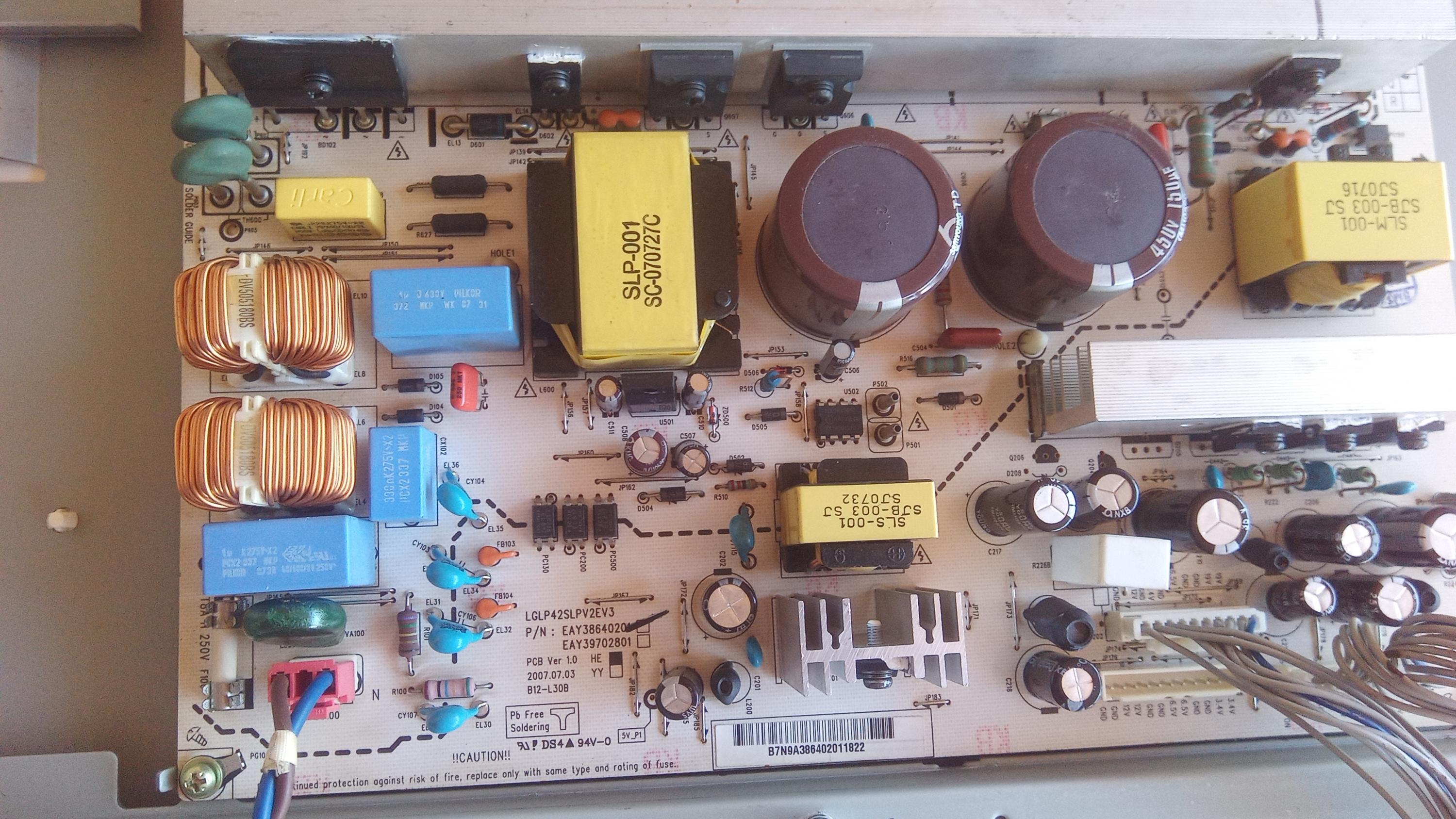

              Looks like 2 circuits. Test one at a time. Appears ground is chassis. Also high voltage.
                        hi again in my case the responsible inverter ic is oz9965gn
                        i read ho can i do bypass but i cant understand because there isn t schematic
                        (OZ9925GN Protection Remove
                        We solder the LED on the 13th leg. Protection is disabled. The first element with 13 legs is a capacitor. Here we solder it in parallel.)
                          parallel capacitor.
                            and what type led must i use ? i mean characterestic volts ?
                            the tv isn led is lcd with ccfl lamps
                            • lotas
                              • Jan 2016
                              • 4708
                              • Russia
                              Regular red LED
                                  sir dskall
                                  i found the the schematic of power supply in electrotanya and i have confuse and i wanted from your experience little more help
                                  i thinking to use 2 lamps ccfl T5 for the simulation in the same time and no one each time
                                  my problem is from the plan where i connect the connectors of the lamps
                                  the first lamp the one connector on the plug p401 and the other connector on the capacitor c404 wich connected on the ground with the symbol P or on the trimmer v302 wich connected with the ground
                                  similar the second lamp must i connected between the plug p402 and capacitor c409 or trimmer v302 ?
                                  thanks in advance
