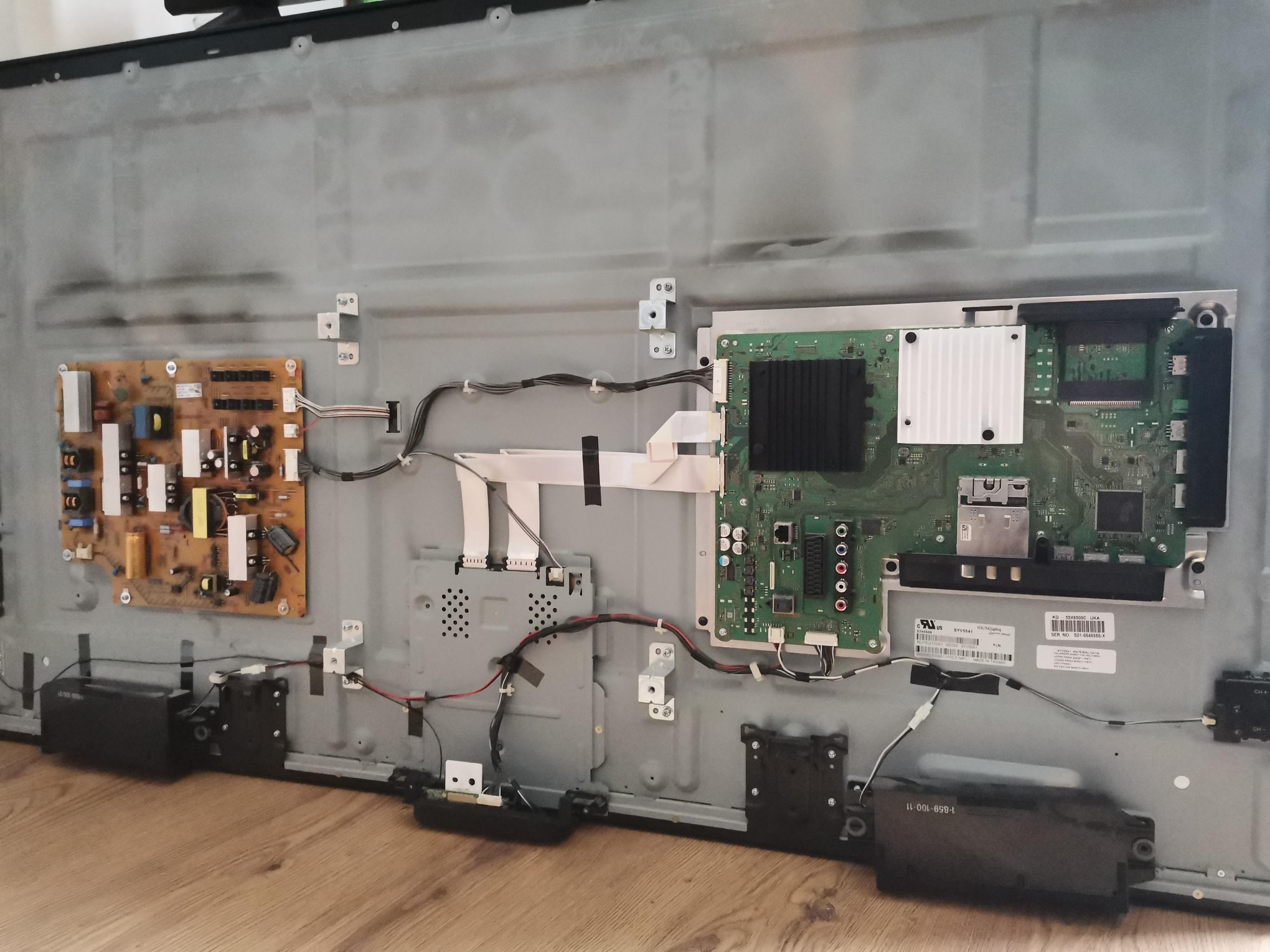

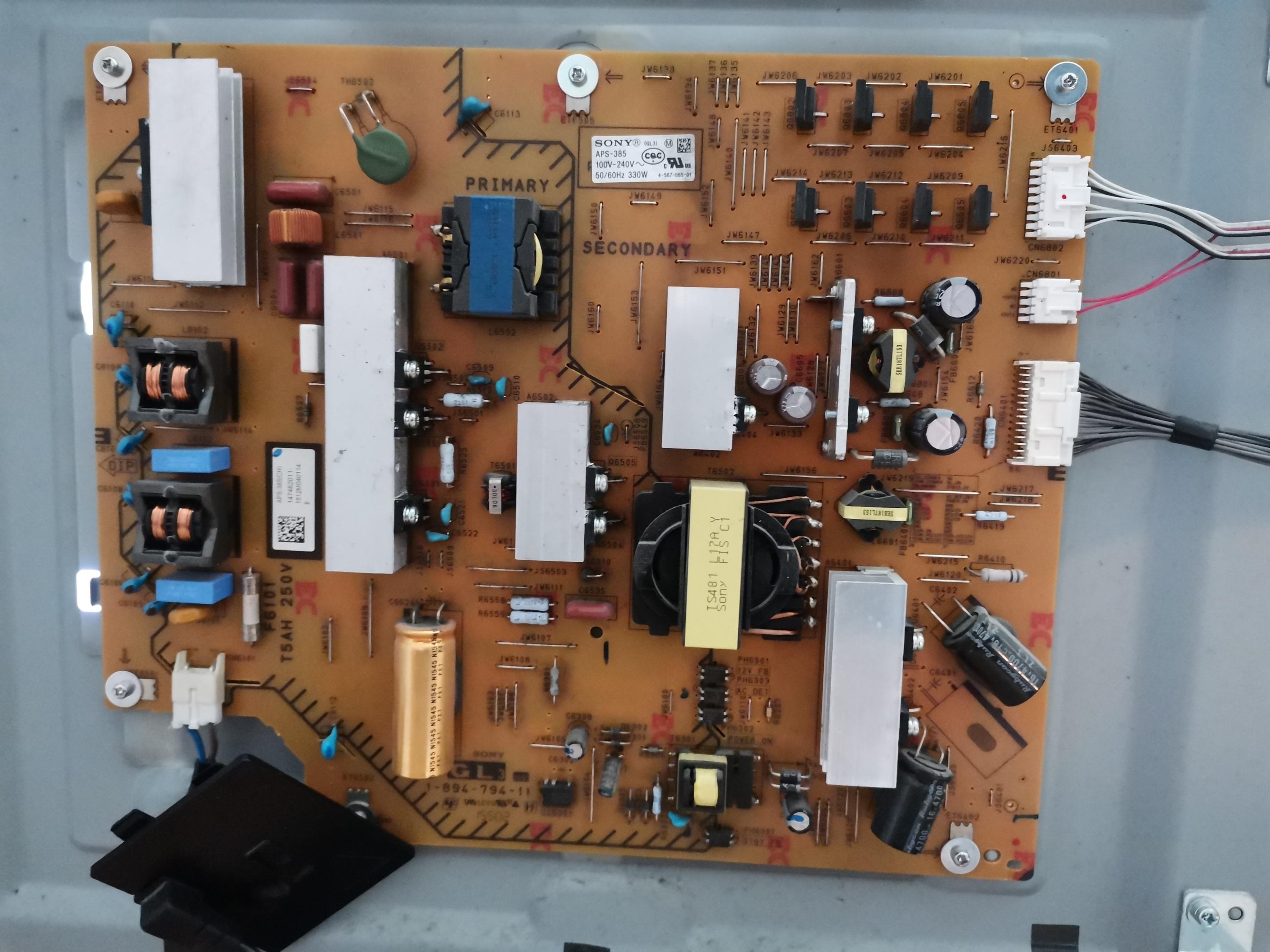

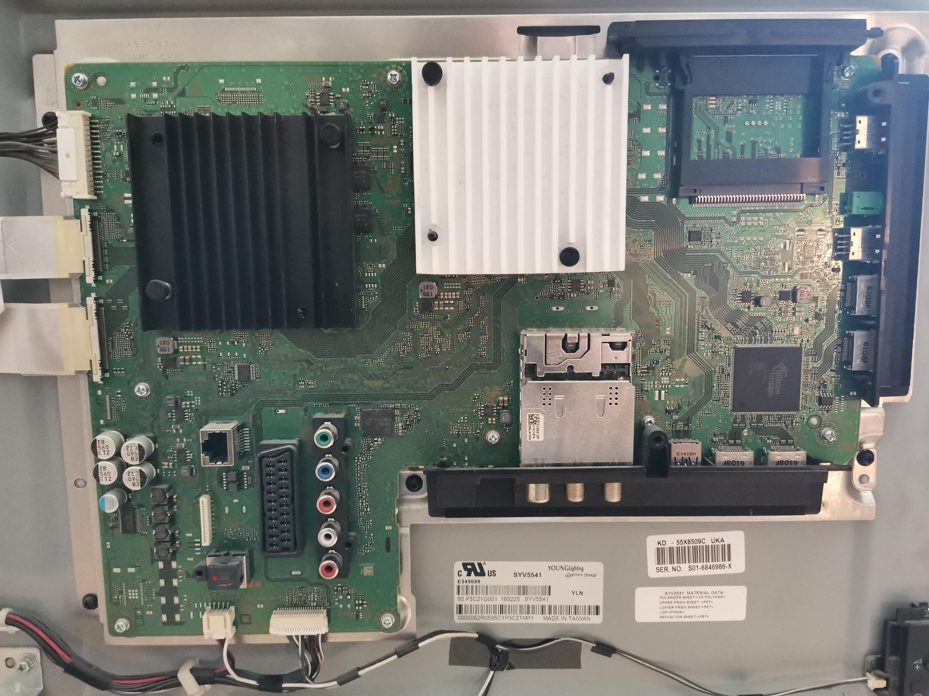

    Hi, I've got a Sony set that acts weird. It works absolutely fine for 2-3 hours, then shuts down with 6 blinks. After a bit of cooldown it works again for some time. Service menu indicates backlight error, but in edge-lit TV it would be clearly visible that one or more LEDs fail.
    The person I bought the TV from replaced the power supply with no effect on the issue (he even gave me.the spare one with the TV). Main board and the TCon seem reasobably warm.
    Pics of PSU (original one) and MB attached.

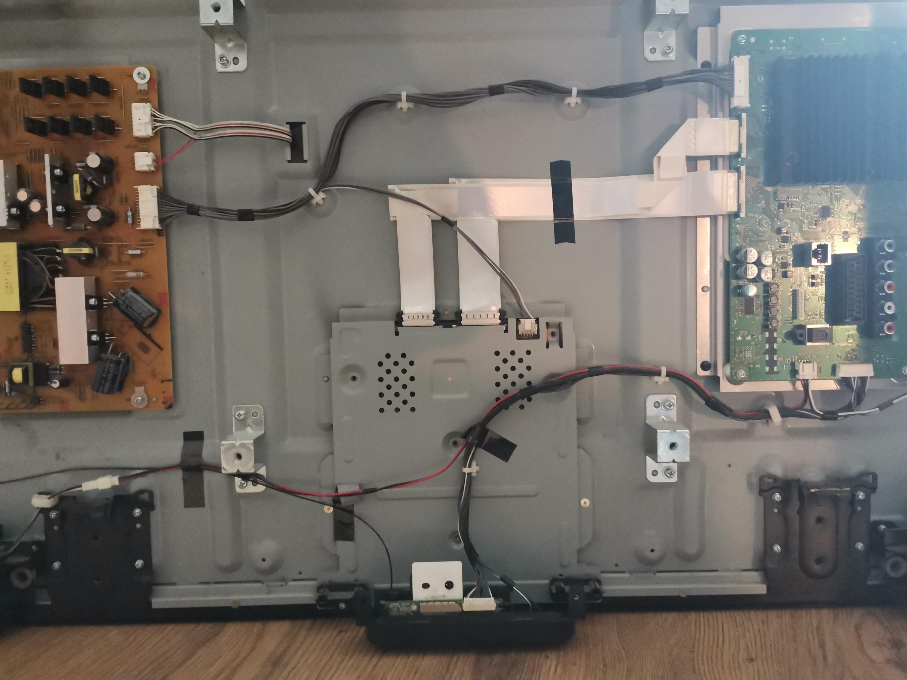

    Re: Sony KD-55X8509C fails after warmup
    need a picture of the whole back of tv as to see how everything is connected.
      I would heat parts of main board and see if you can locate problem.
          Pic attached showing how everything is connected.
          I'll try heating.
            ok, have a good look the legend/map on powerboard, do any of them say bl-err?
              BL-ERR gives 2.3v with set powered off but plugged in.
                what does it read powered up?
                  Nothing at all.
                  I've been told by 2 separate sources that the smthe LEDs tend to fail this way in this TVs. Been explained how and why and it made sense so I've boufmght replacement strips. I'll post if it solved the problem after changing and testing them.
