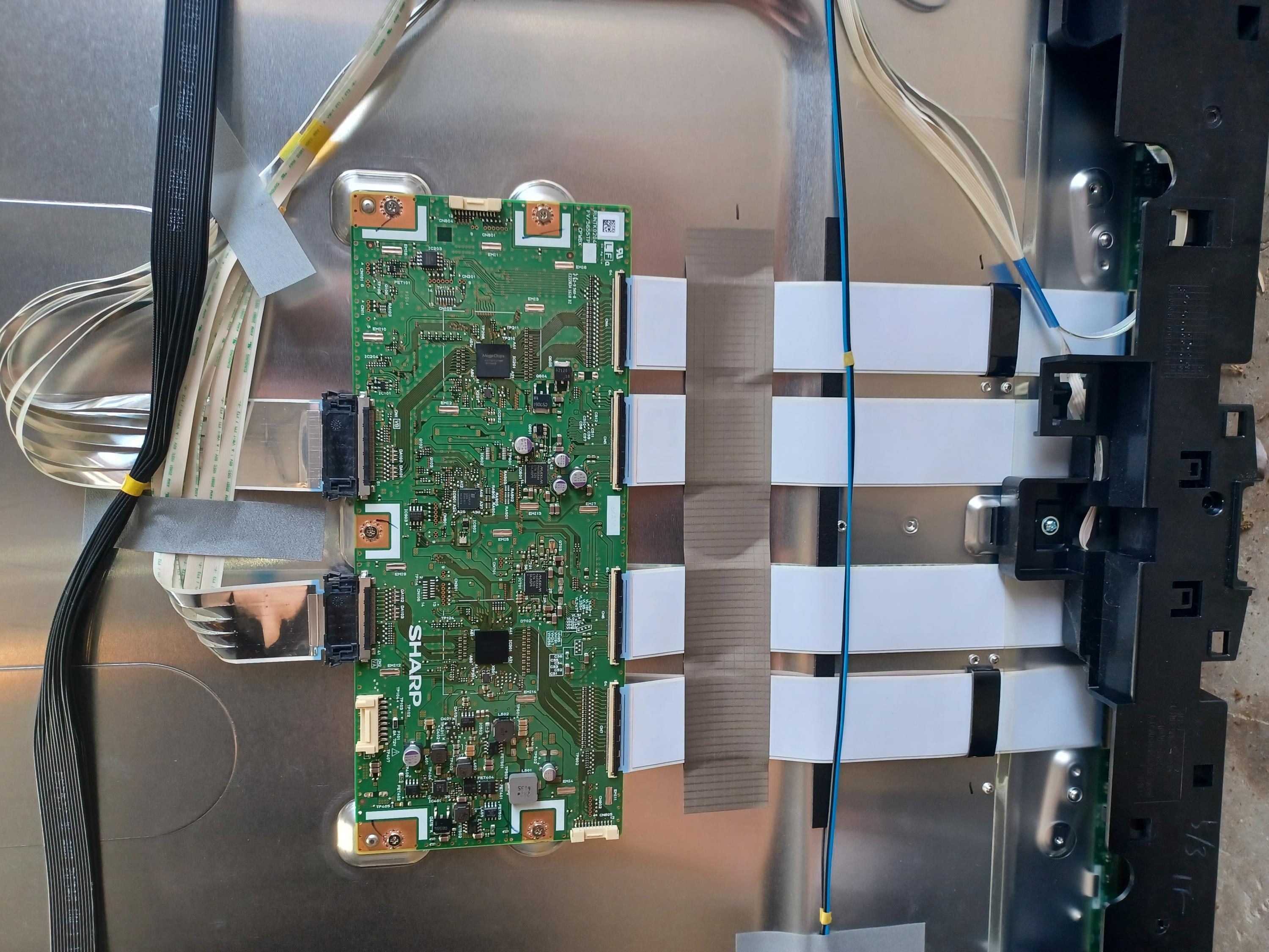

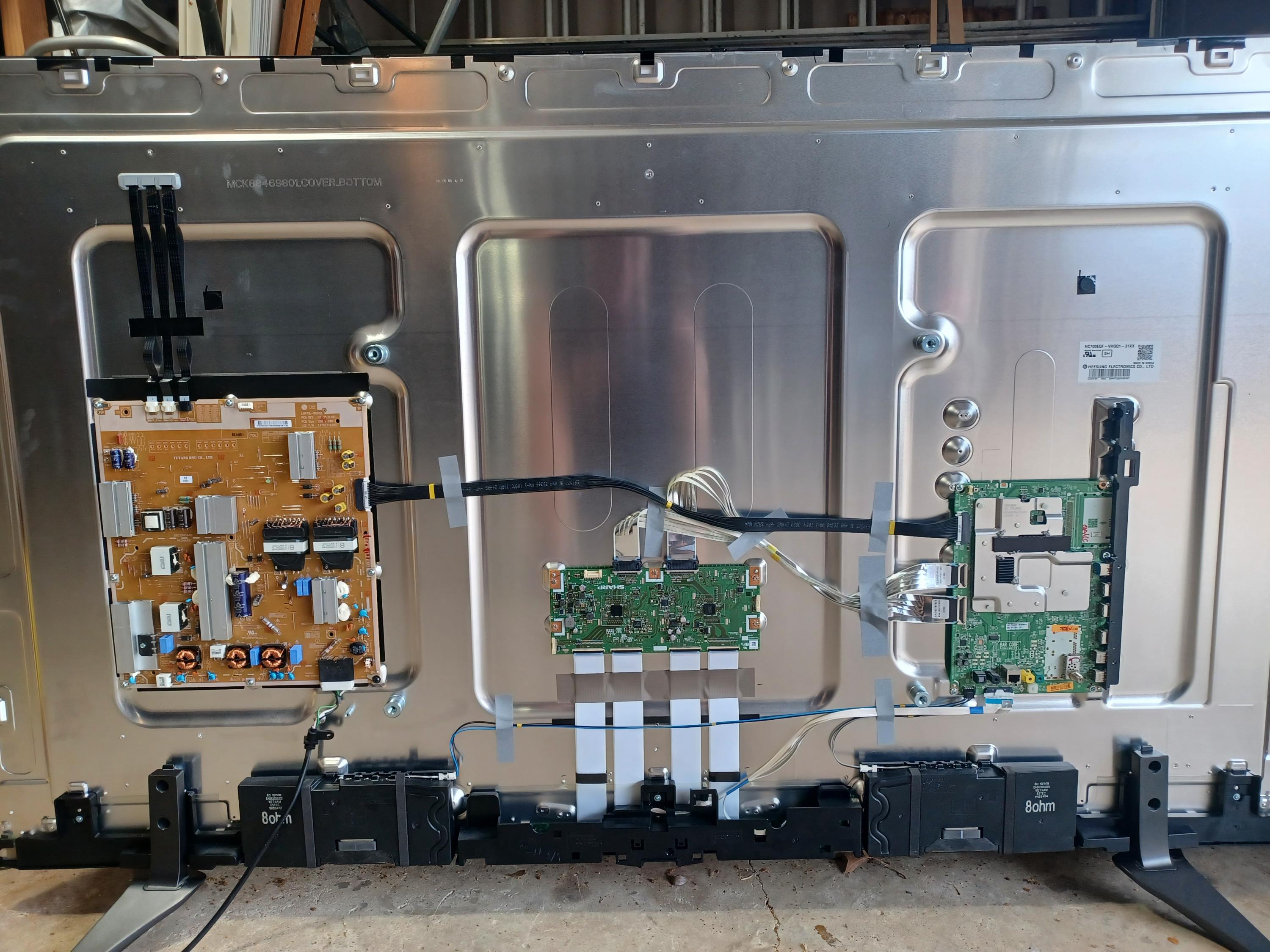

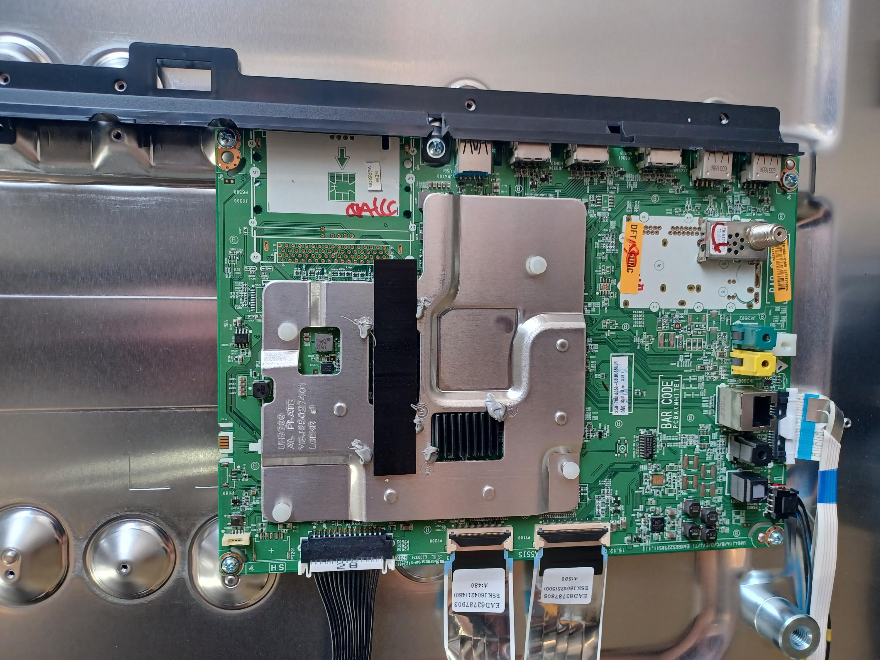

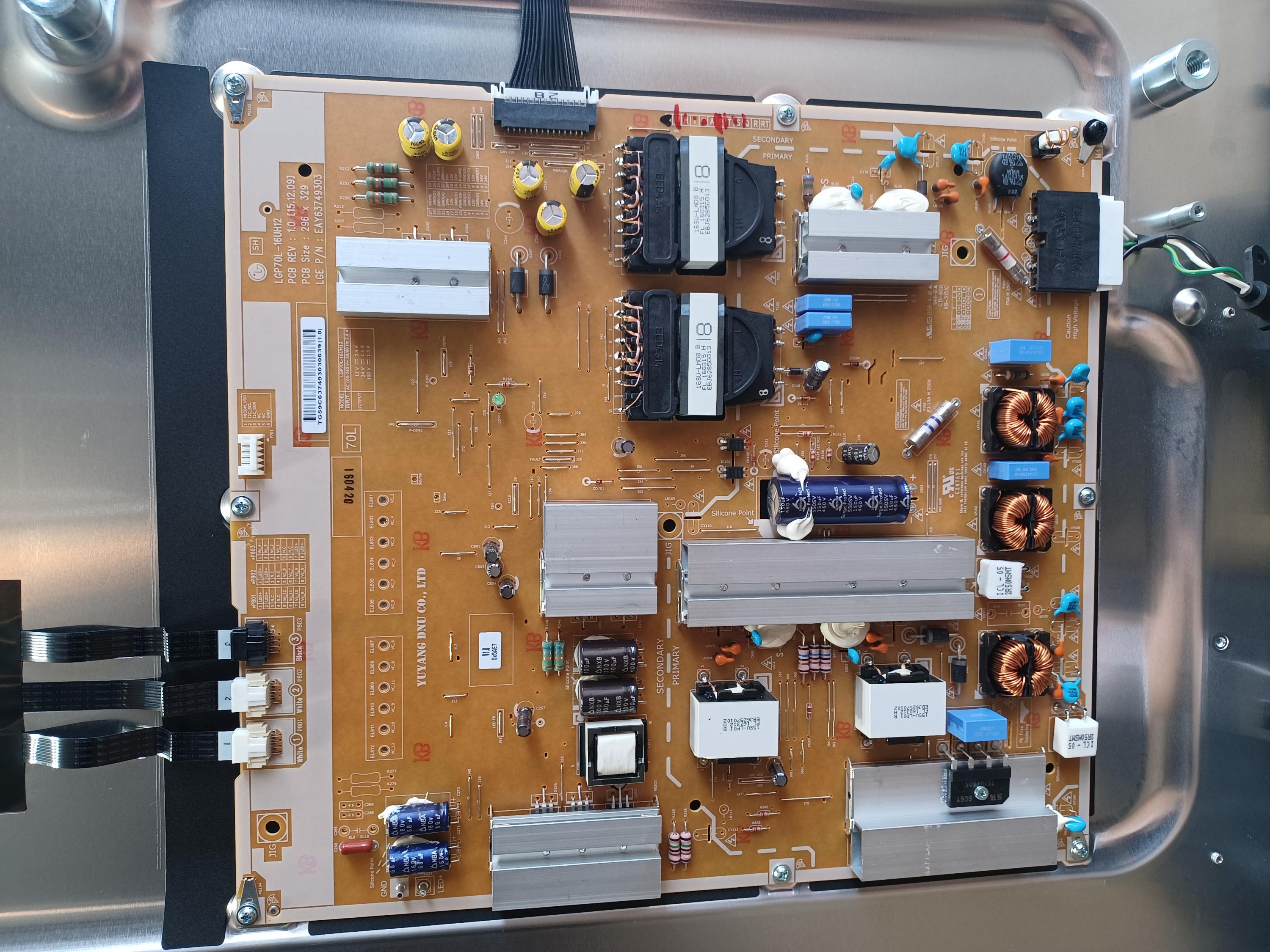

                Re: LG TV shuts of (70uh6350ub)
                Attached are photos showing 1.the back of the TV, 2 power board, 3. main board, 4. t-con board.
                I did reduce the brightness during a previous start up. no real change in how long it is on.
                I did notice some heat from the power board area when I still had the back on the tv. stayed heated if I kept the tv plugged in, but not on. could this be an issue?

                    upload photo of the power boards from the downside to the area where you have 3 sockets for BL LED to see LED+ on each socket are connected together or not to tell you how to make the measurement.
