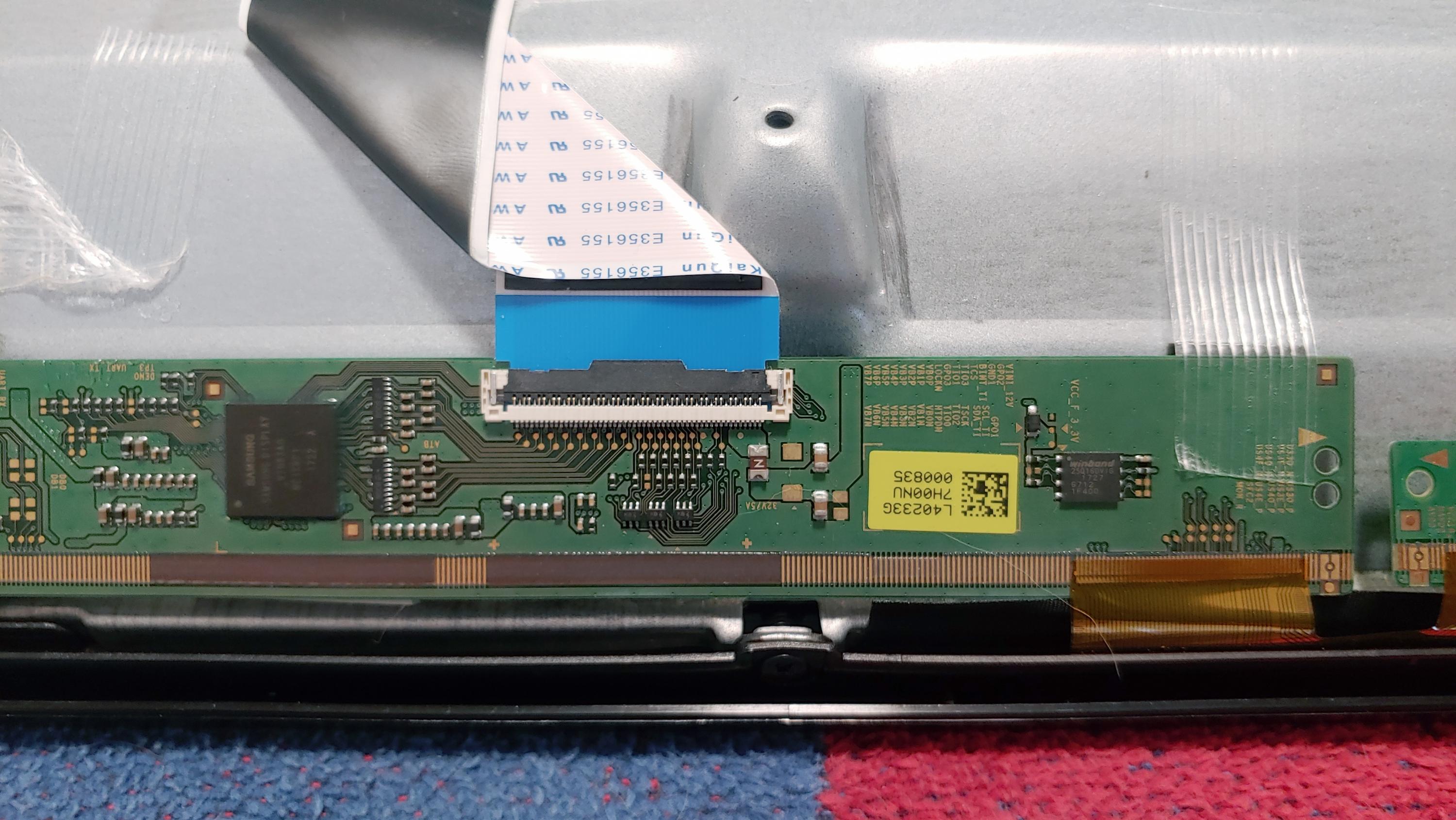

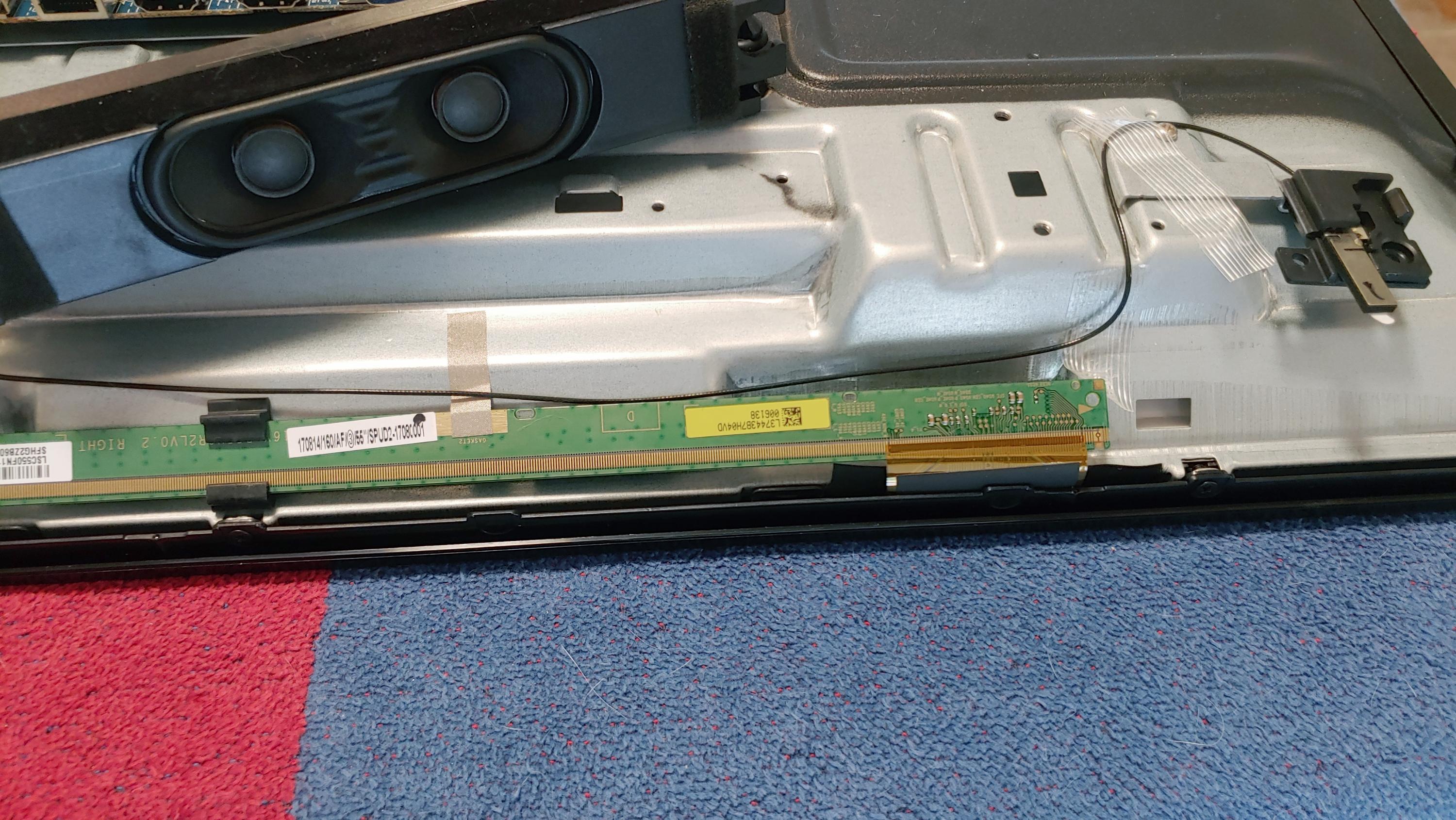

            Re: 55" Element tv turns on, no picture
            Your t-con is on panel. Need some good pictures panel boards.

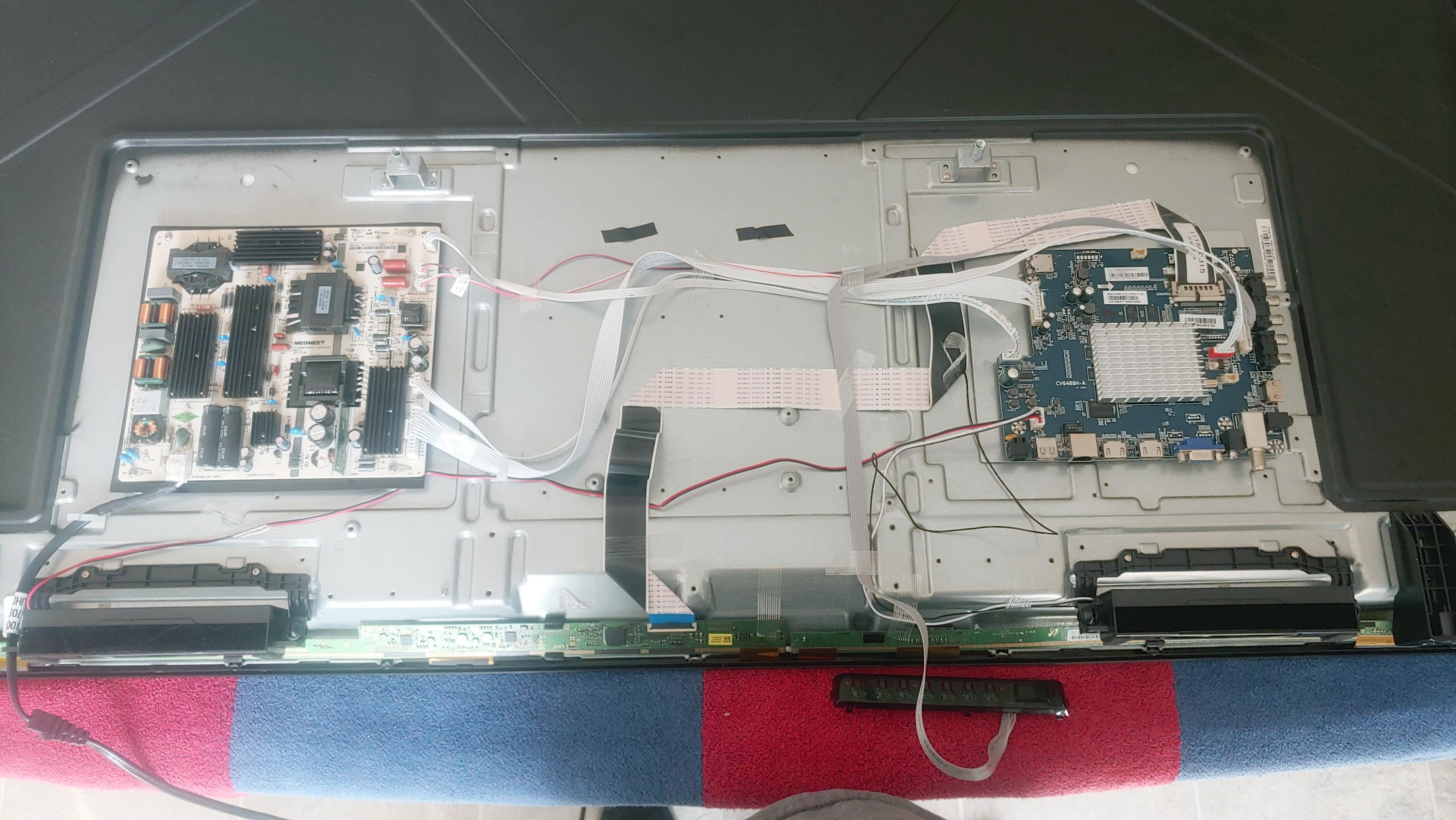

              Pics
              • Jerdejong
                • Apr 2022
                • 48

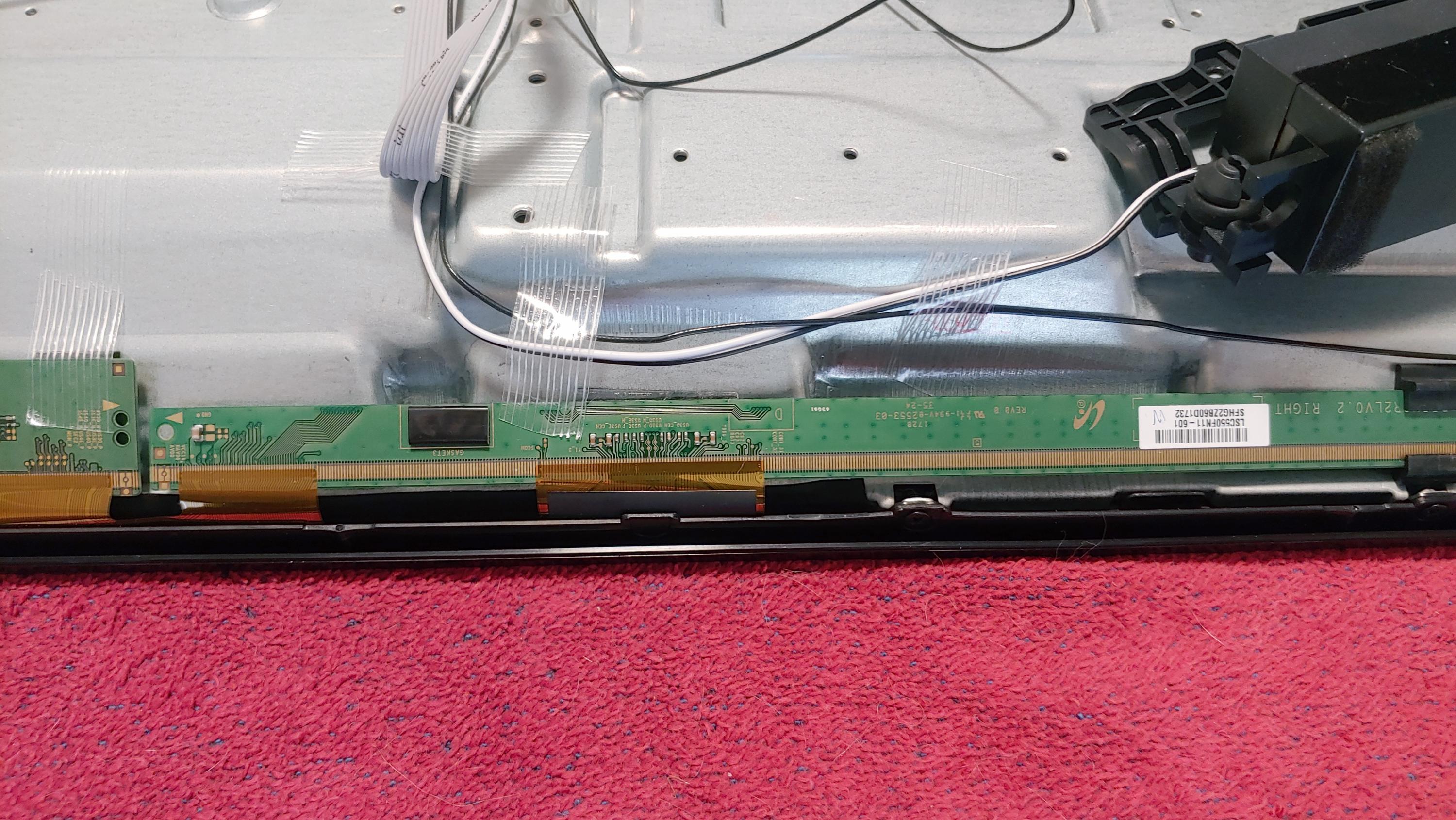

                I'm assuming these panel boards are not replaceable since they look permanently attached

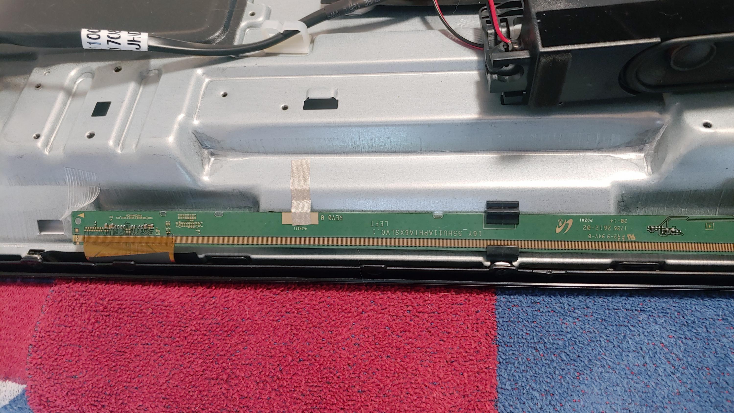

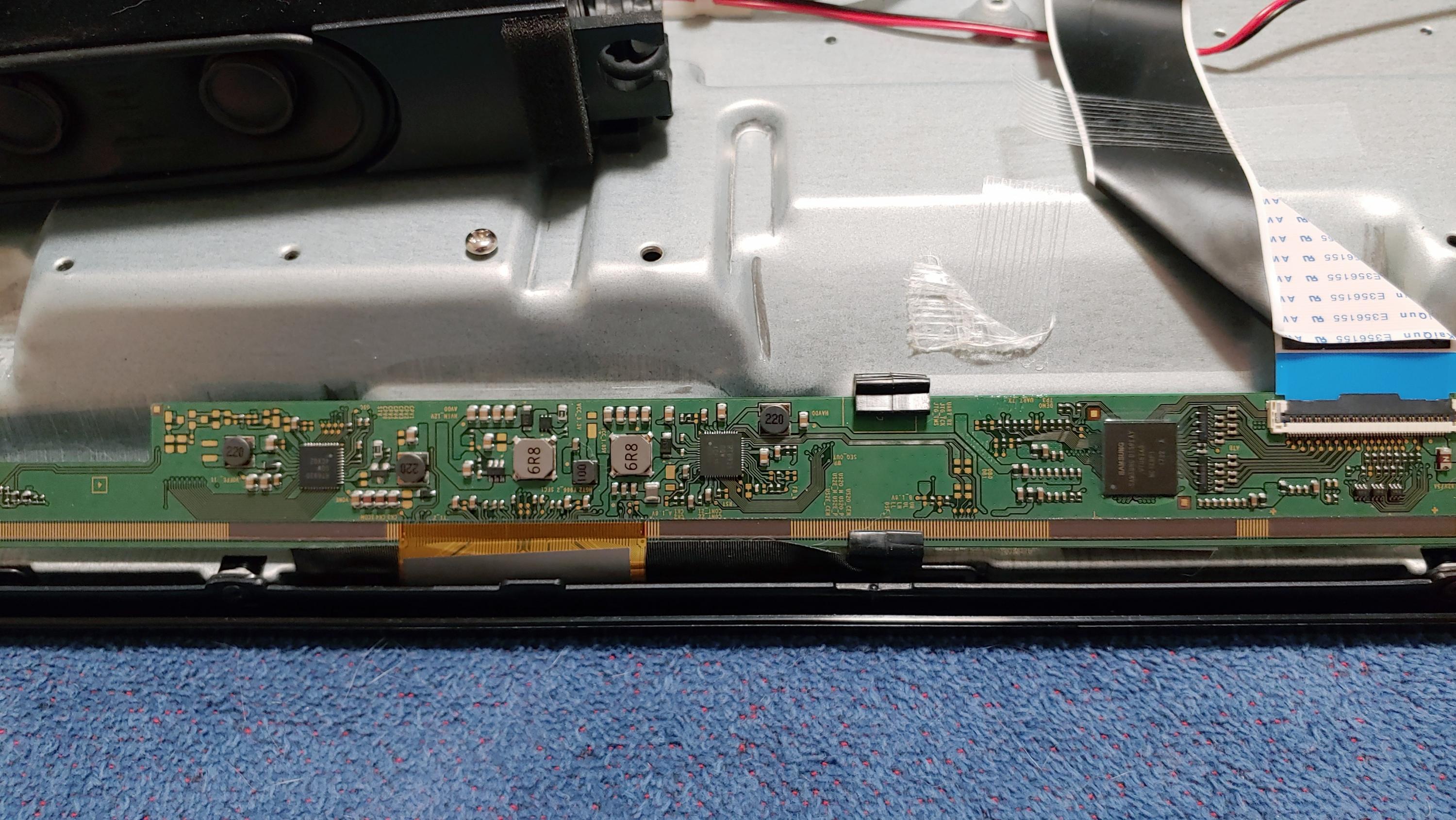

                  You are correct board swapping is not an option. Your only choice is board level troubleshooting and replacement of component. So checking voltages is first step. 12v input, hvadd, vcc, avdd etc. Your second most important picture is to blurry to read.
                    Hope this one is better. My phone is old and doesn't take the best pics
                      You have vone, voff, vcc, avdd, hvdd voltage points you can check.
                          Here's some voltages on the panel board:
                          vone: .3v
                          voffe_11: .15v
                          vcc: 3.3v
                          (vcc_f_3.3v): 3.3v
                          (vcc_1.05): 3.4v
                          avdd: .03v
                          havdd: .02v
                          (vcc_3.3): .02v

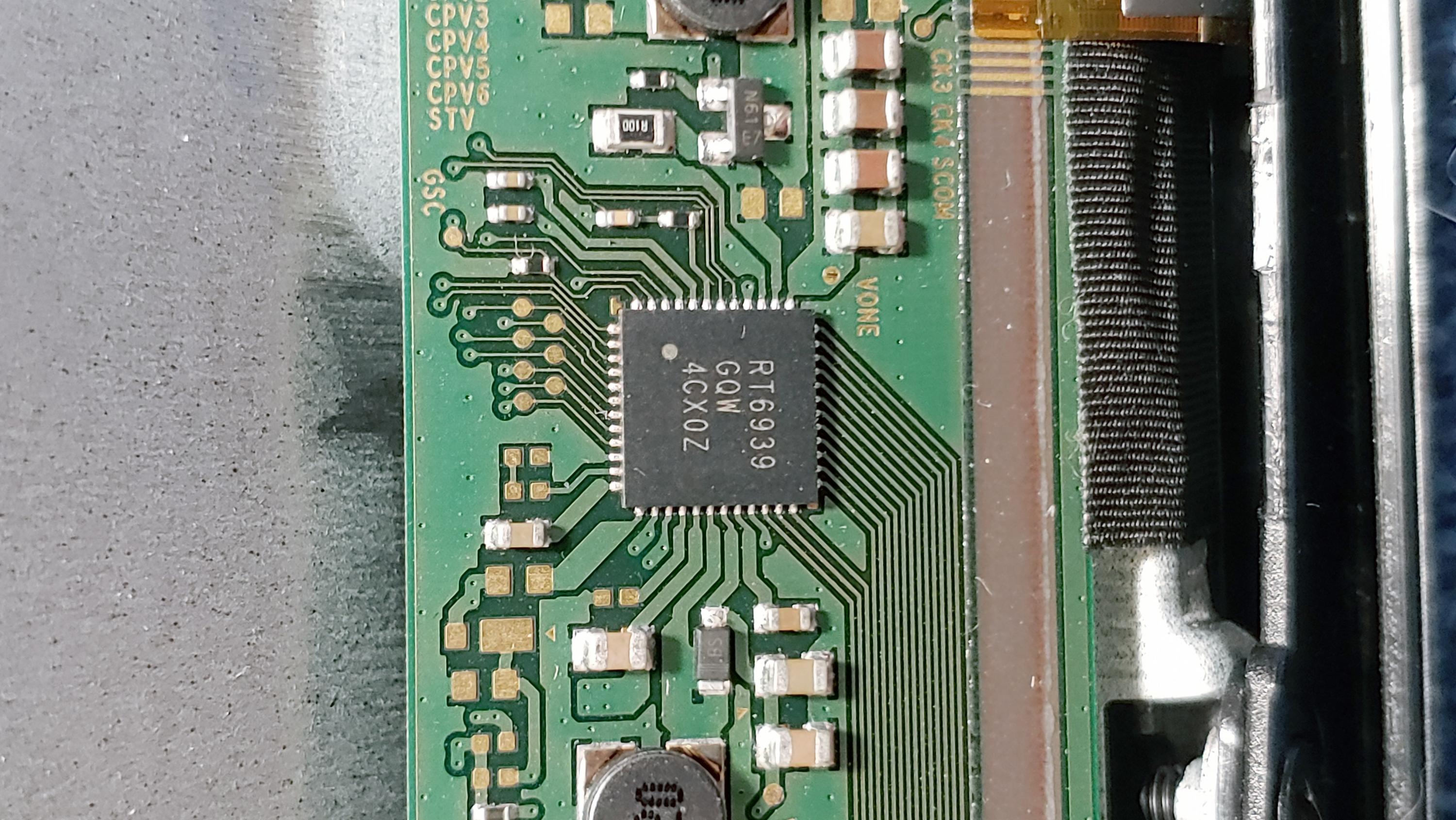

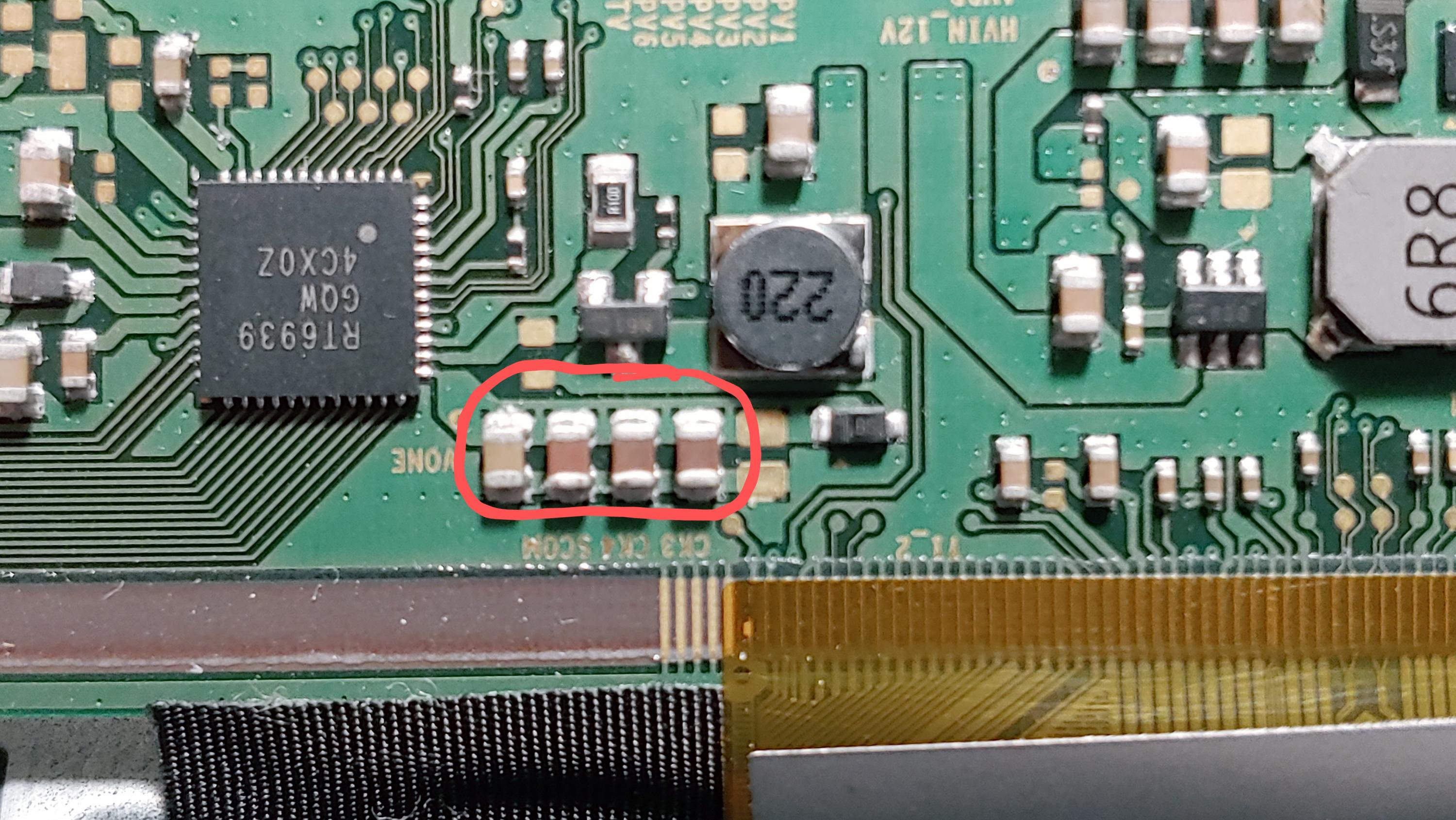

                            What is part # on left chip? With power off and in continuity or diode mode read across the little brown capacitors around the 2 chips on the left.
                              Is this the chip you're referring to? It's the far left chip

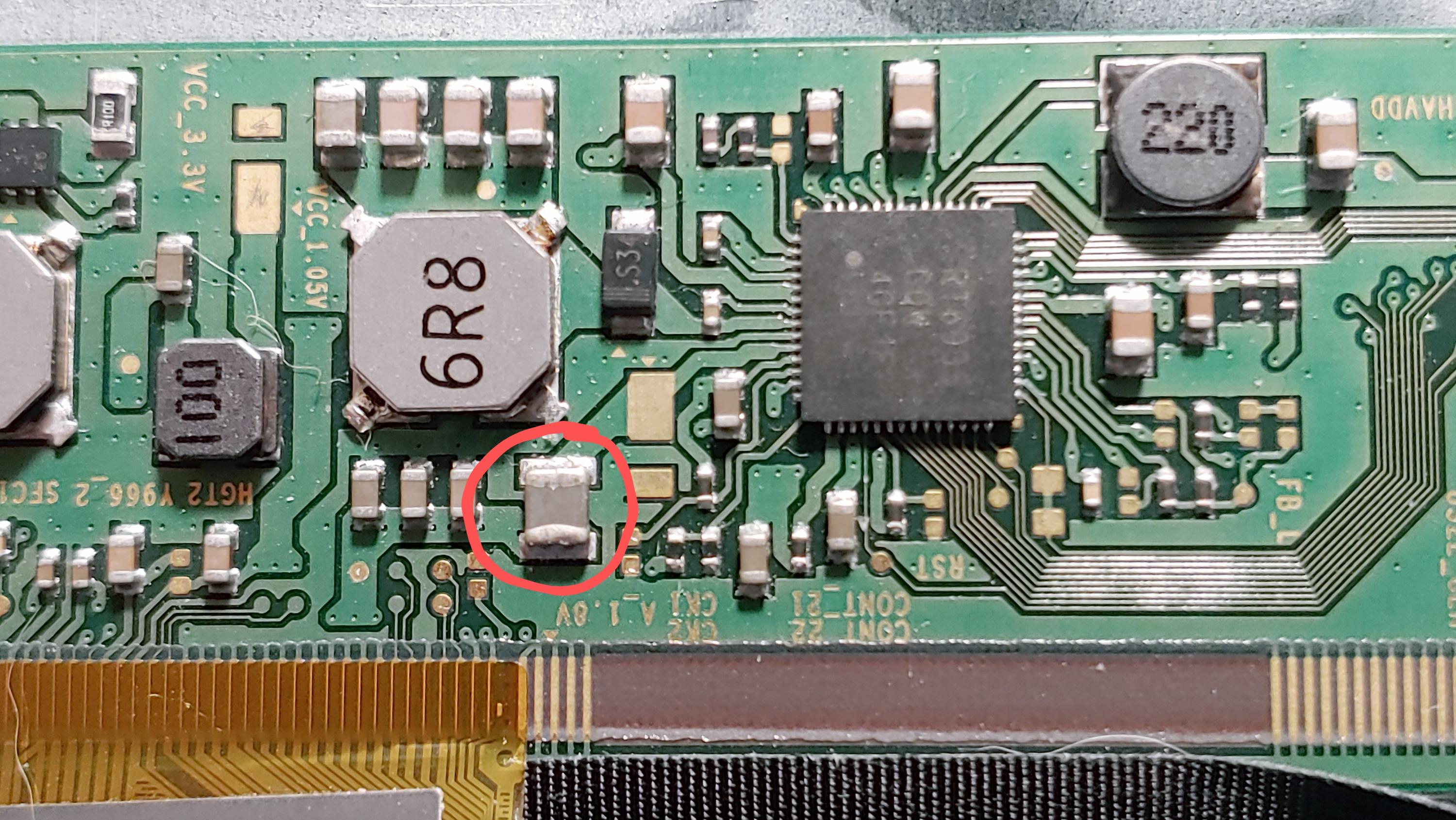

                                The group of 4 circled capacitors(pic) measured .45v, but when switching the test leads, they measured 0v. The single circled capacitor(pic) measured 0v, with test leads both ways. The rest of the caps ranged from .1v - 1.8v. All were tested in diode mode.
                                  Those 2 chips don't have the same numbers, do they? You are missing voltages from your dc to dc chip. Not sure which one it is. Not finding any info on the rt6939. I would think one would be gamma chip, but don't see any gamma points.
                                      Closest I could find is this chip schematic, which looks similar to yours. I would look for HVIN12v around the chip. Check for shorts on points with no voltage. If you have voltage going to ic and no shorts I would replace RT6939
