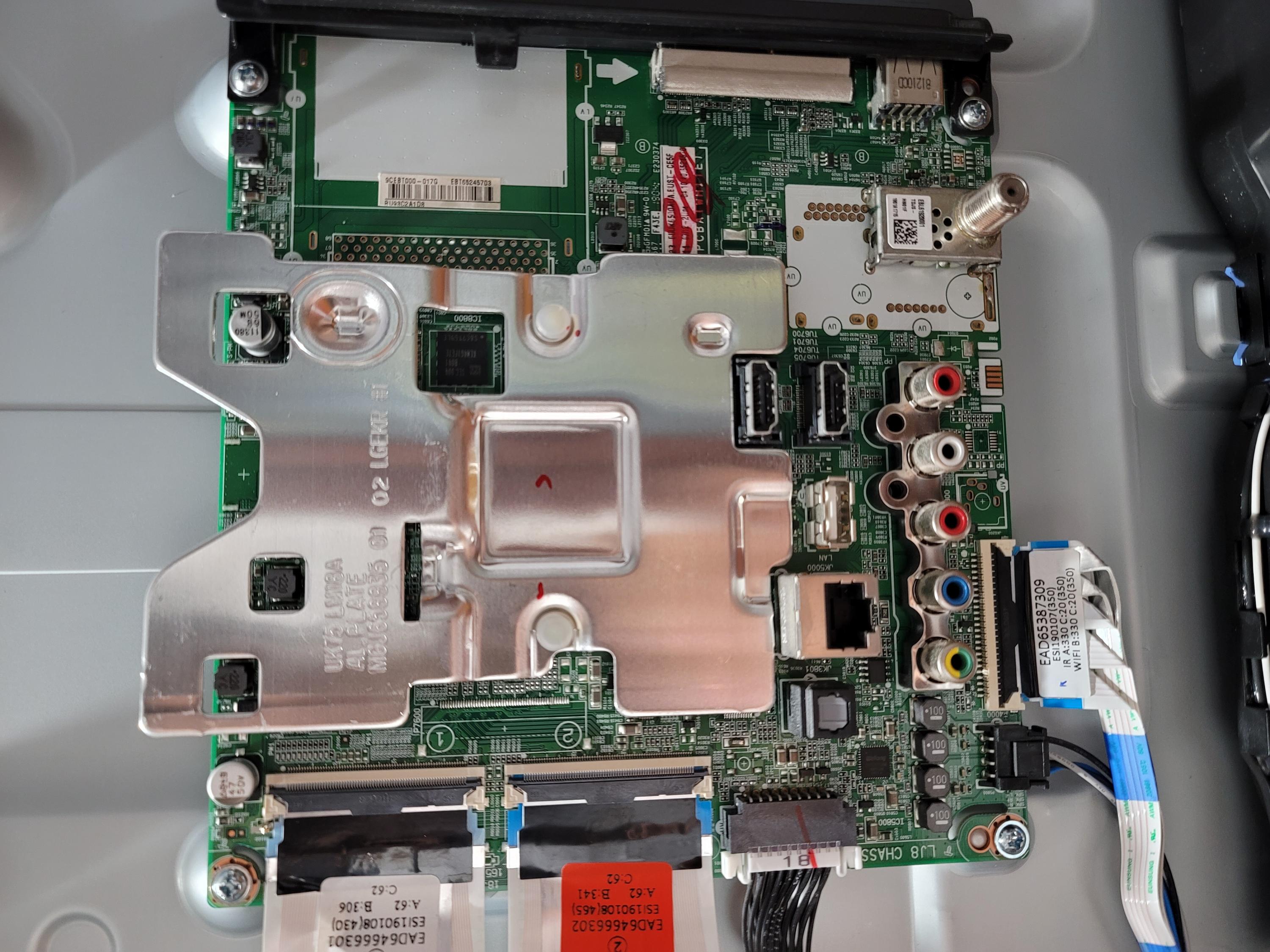

          Re: LG uk6500 LEDs Turn on but no image.
          This is how it looks
            ok, so it only has one board in it then?

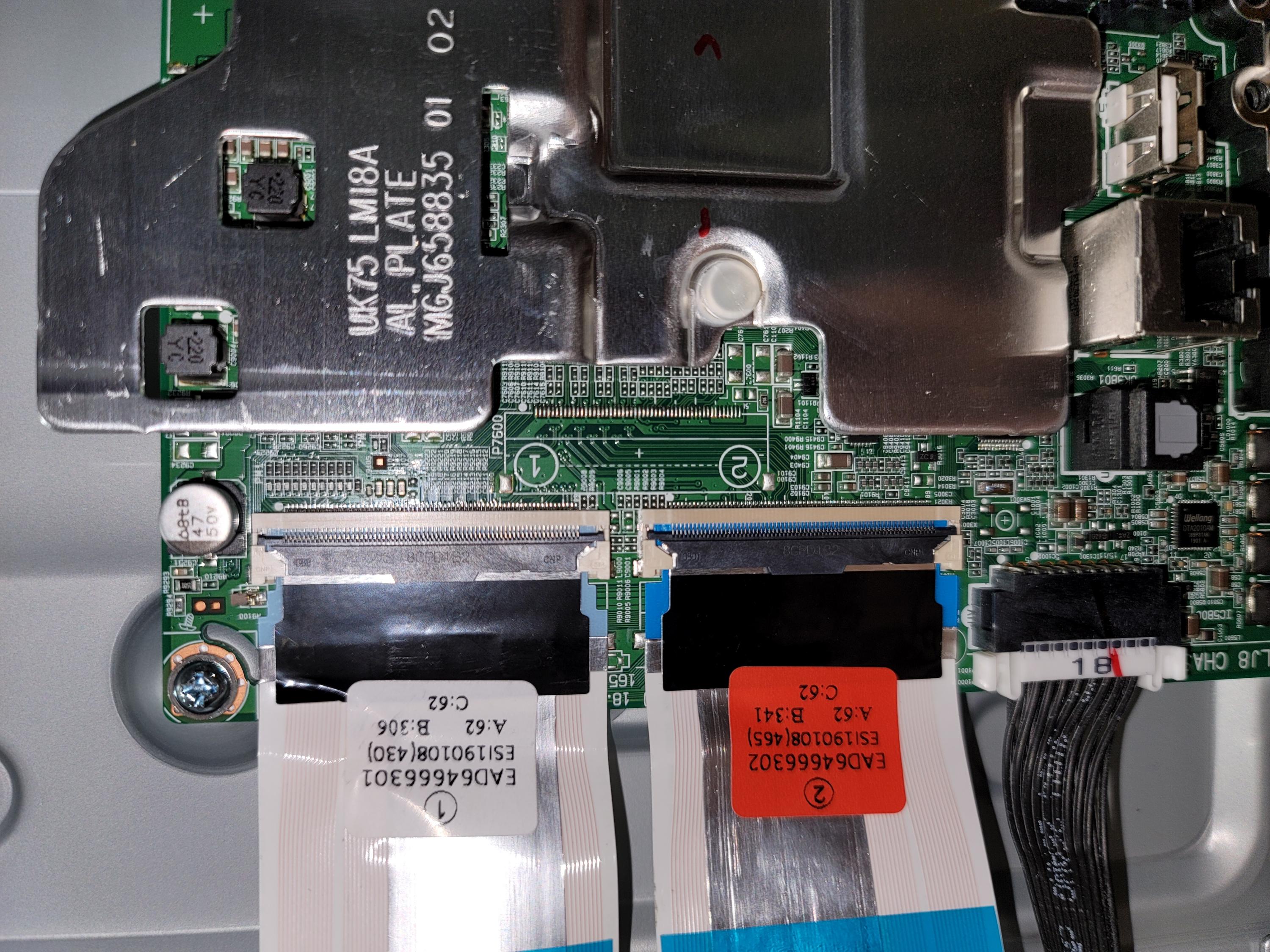

                              Main Board just arrived today and I installed it and got the same results as with the original board.Pulling the flat cables one at a time did not give me any picture at all.I did read some voltages in the tcon section of the main board (5v,12v ) on both boards .There is a 50v cap adjacent to the flat cable labeled No.1 .I dont read any voltage there which seems odd.
                                How do you know the t-con is on main board? I see nothing that looks like t-con. But a lot of board is shielded. How about some pictures of panel boards.
                                  we can only see the pictures you post, need a picture of the whole back of tv to see everything.
