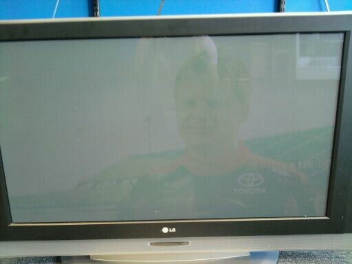

    i have a LG Plasma 42PC3D that was working fine till today the screen has gotten dark i have taken a picture
    do you think this has something to do with Z sustain failure

    Yes, it is z sustain failure.

      thank you will order part today

        For us, newbies, how can you tell it is a z sustain failure?
          The symptoms. The very dim picture (sometimes a picture is only visible in the lower right corner) is very characteristic of LG Electronics TVs using the 6871QZH056A (or B, or C) Z-sus. Either replace the board, or replace the hybrid.
