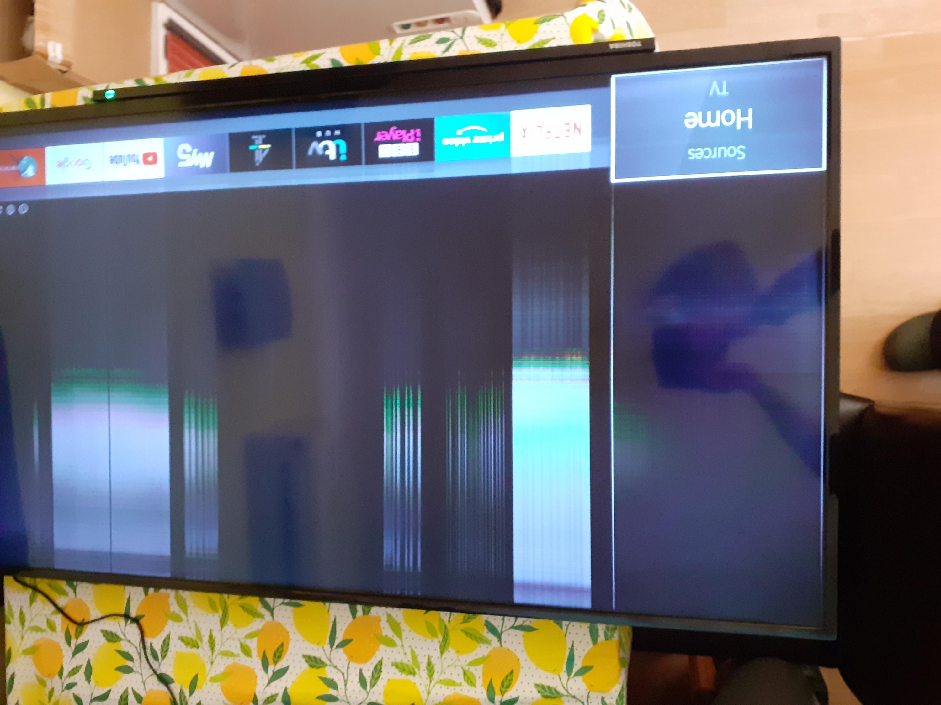

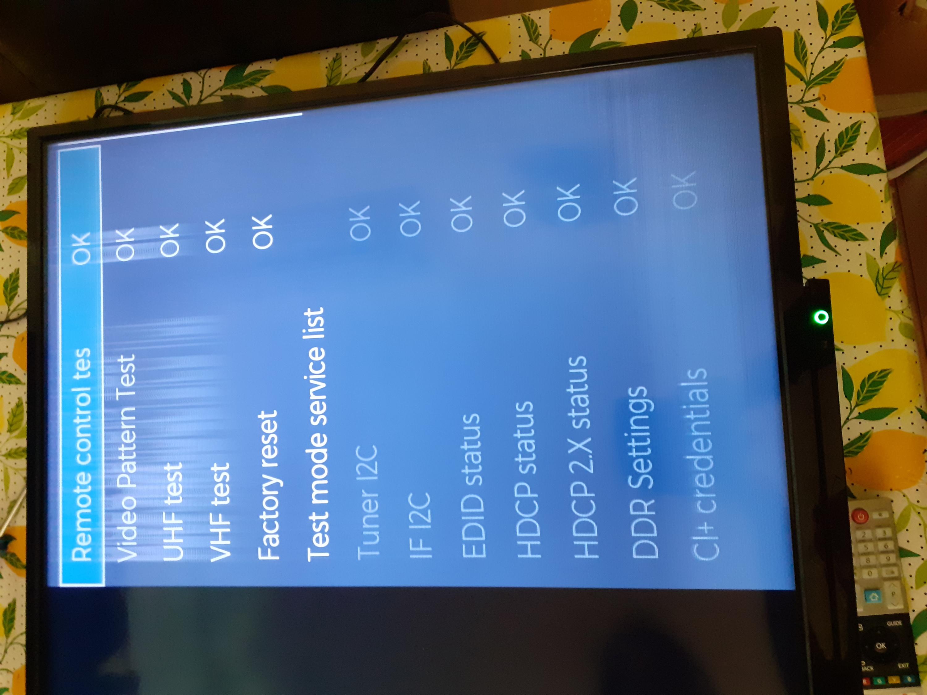

    I checked again, and the t-con I had fitted was the original t-con which came with the tv when it was faulty, so it is possible that the washed out look was a symptom of the original t-con.
    I now have the replacement t-con fitted and have been able to connect both ribbons and get a full screen picture, but the picture has the same issues as before with some vertical and horizontal lines in the image (difficult to see on photos).
    I have entered the service menu, performed a factory reset, and USB Diagnosis and this shows no issues, and did a USB download, which saved some "syslog.gz" files, but they dont have much size, only 16kb. A DVR folder was created, but these are for recordings etc.
    Any advice?

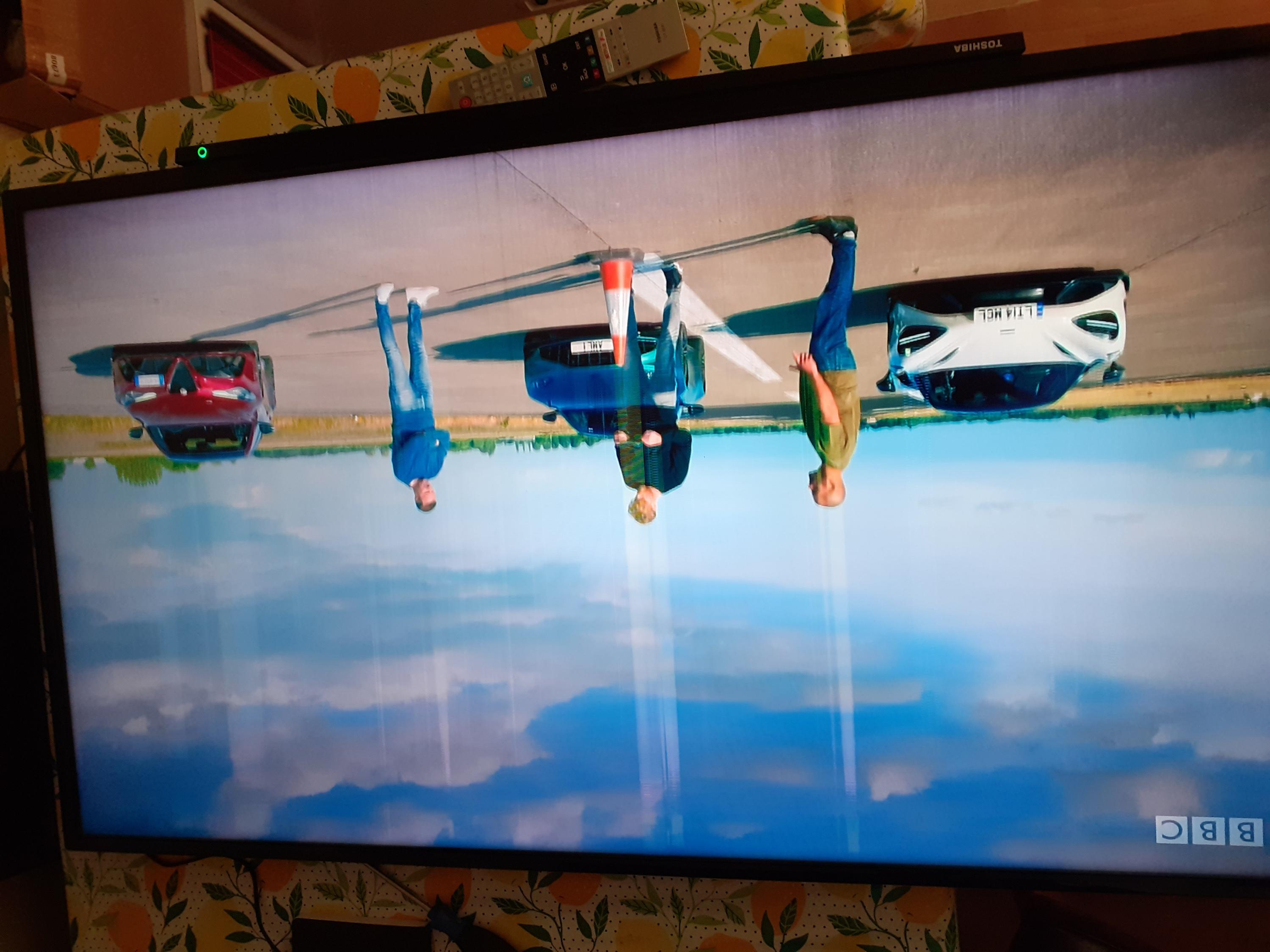

      Re: Toshiba (Vestel) 50UL2063DB - bad COF?
      If there is little "data" being displayed, the area where the screen is black, there is no distortion (circled) but where there is a lot of picture data, there are vertical lines (red lines added to the picture) - see attached picture.

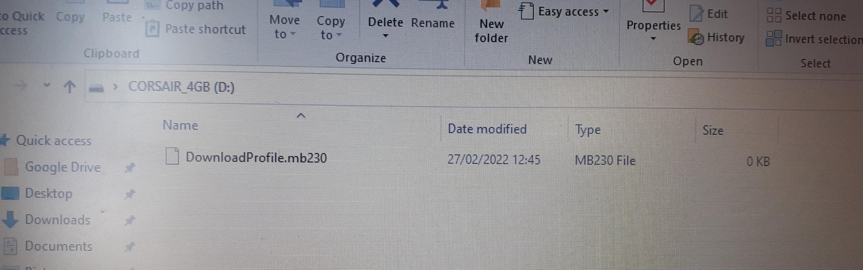

        where are the test picture with different resolution we talked on before to play them with usb ?
        on PC format USB drive fat32 and great file in name DownloadProfile.mb230 ( the extention should be as it written .mb230 )
        inset usb at the Tv and turn on go to service menu and press USB Operation
          I will do the test pictures for you, just trying to juggle so home improvement issues too. The "boss" is watching me!
          Would you prefer the same picture, with three different resolutions to help in comparing the issue?
          I have deleted everything on the USB drive and now just have the file "DownloadProfile.mb230" in the root of the USB. Windows reports this as a "MB230 File" under "type "
            usb are fine to download all profile..
            doesn't matter which photo even if its blank one color or adult one lol.... main things they are different resolution.

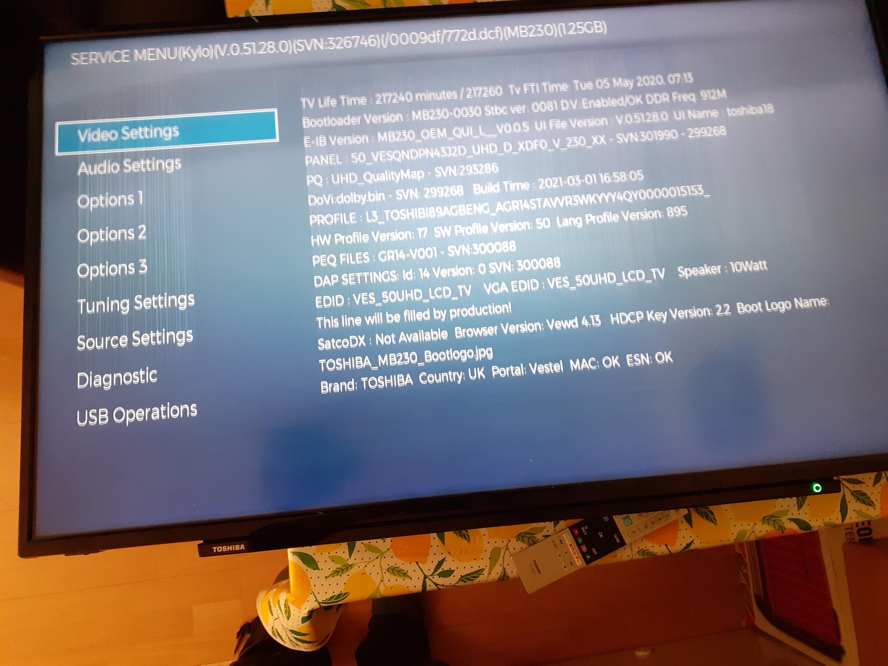

                • Russ17
                  • Mar 2018
                  • 125
                  Originally posted by yokoono
                  If you think the image is bad because of the software you will need a panel profile for 17MB230 and VES500QNDP-2D-N43 panel (if so on the label on the back of the panel)
                  . I do not have. Or if someone can fix your TV profile save the panel profile from your TV and post it here. Proceed as above only that the folder needs to be renamed to downloadpq.mb230.
                  I have download the TV files to USB.
                  3 profile files, biggest one is language 4Mb
                  see attached image

                    #29
                    zip hwprofile and swprofile together and upload them over here

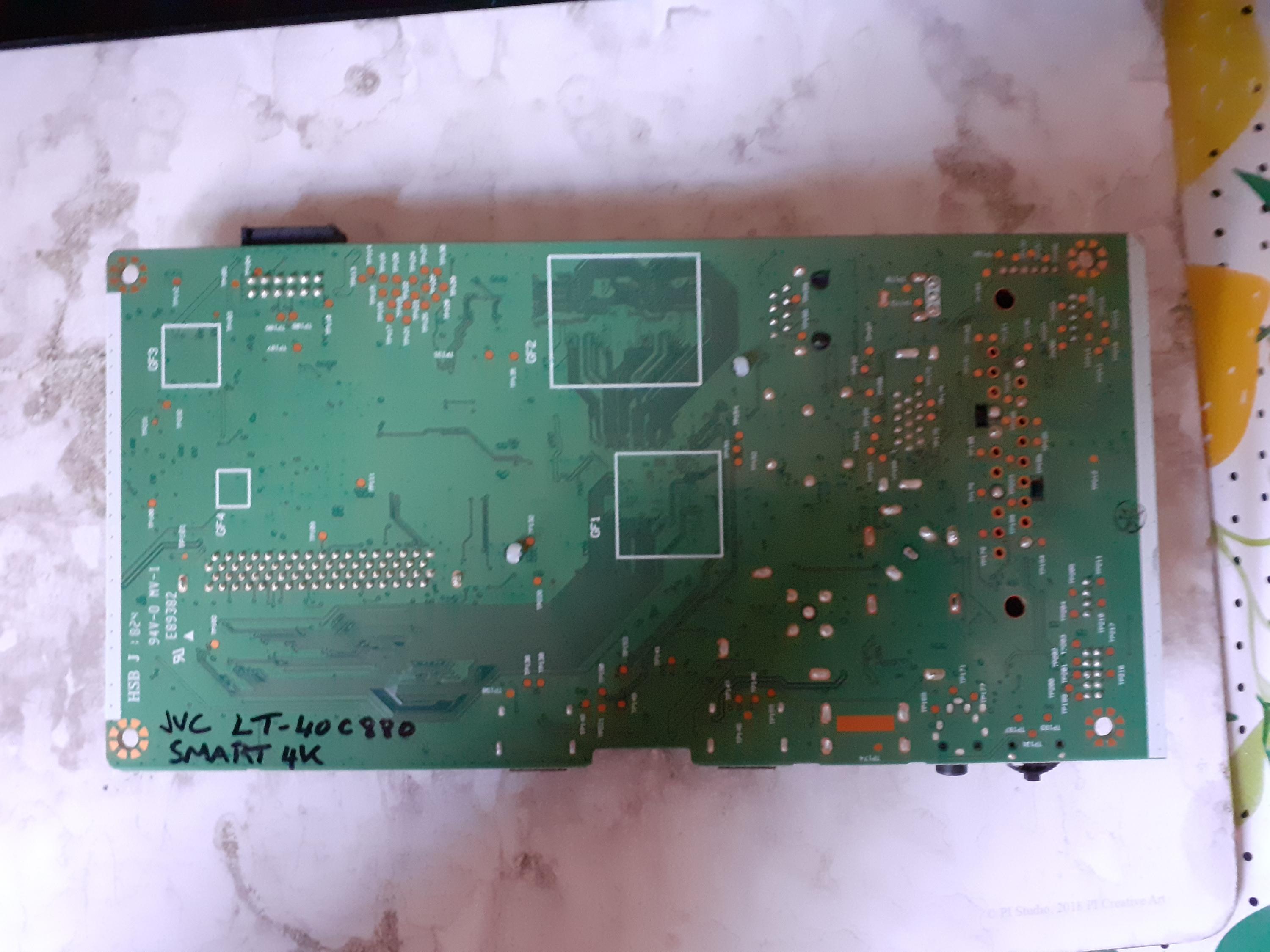

                      @diah
                      I actually have a 17MB130S which came from a JVC LT-40C880 which had a broken screen.
                      Seems like the same power and LVDS cable connection.
                      Coukd I try this board?
                          Originally posted by Russ17
                          @diah
                          which screen lable this jvc had?

                            #33
                            Unfortunately I dont know the number of the screen as it was salvaged 2 years ago and screen was destroyed a long time ago. I know it was 4K resolution, but dont know the exact number.

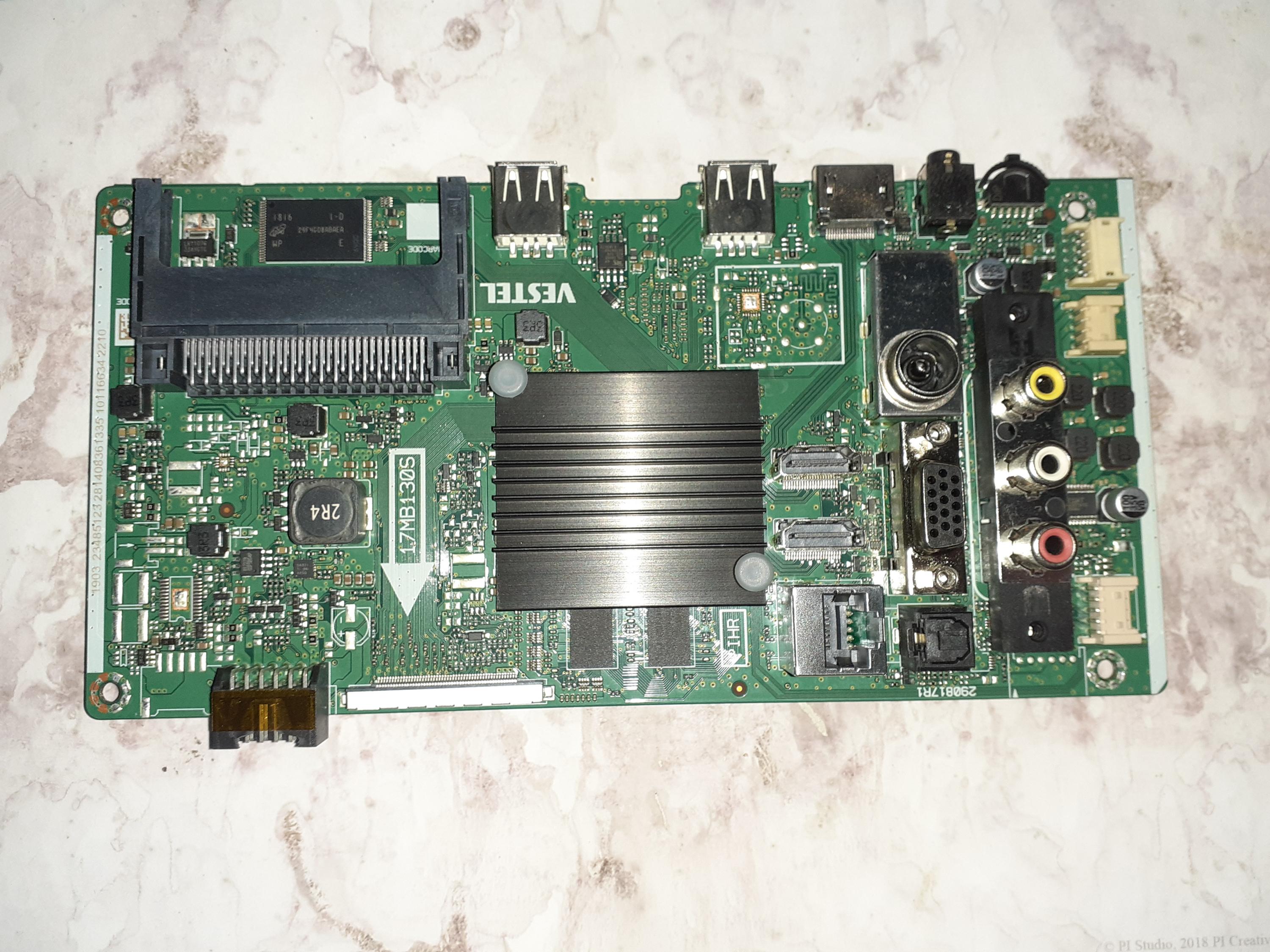

                              #34
                              If I power this mainboard, using the PSU and t-con, from the JVC LT-40C880, but no screen connection to the t-con, and do the same button presses in service mode, to perform a USB download, would a USB download reveal the screen type?
                              Could I use the same profiler you gave me, or do I need a specific profiler for this 17mb130/s
                                you can try the boards if you still have its IR sensor boards because the one you have will not match the wriring same to wifi module in case you still have its RC
                                about yours profiles as i expected the perviouse owner turn on all futire on which this SOC cant handle all at once, so the possibility of MB issue very high to me.
                                you can use this tool to learn with profiles or turn off some of config/picture & sound they are at SWprofile.
                                    I do have the IR and wifi boards for the 17mb130s.
                                    Is there any risks of component damage or data corruption?
                                    If no risks are involved I will give it a go and report back.
                                    The TV has gone back to only showing a blank screen with both ribbons connected.
                                    It concerns me that by disconnecting the right side ribbon, the "fault " is removed. Would a bad mainboard be so specific that it could only give issues on one half of the screen, and only intermittently?
                                      i wrote to you before on my post#15 if yours Tv discharged 100% it will show you full screen while 2 ribbon in place.... and this happen today as you wrote the tv was stored
                                      correct me if i read wrong.
                                      this belong to the SOC overload to work as single channel. if any one had other idea welcome to correct me
                                      trying the boards with 130s will not harm the boards or yours tv. just pray you can see some things on the screen then if yes you can correct 130s firmware with other brand version
