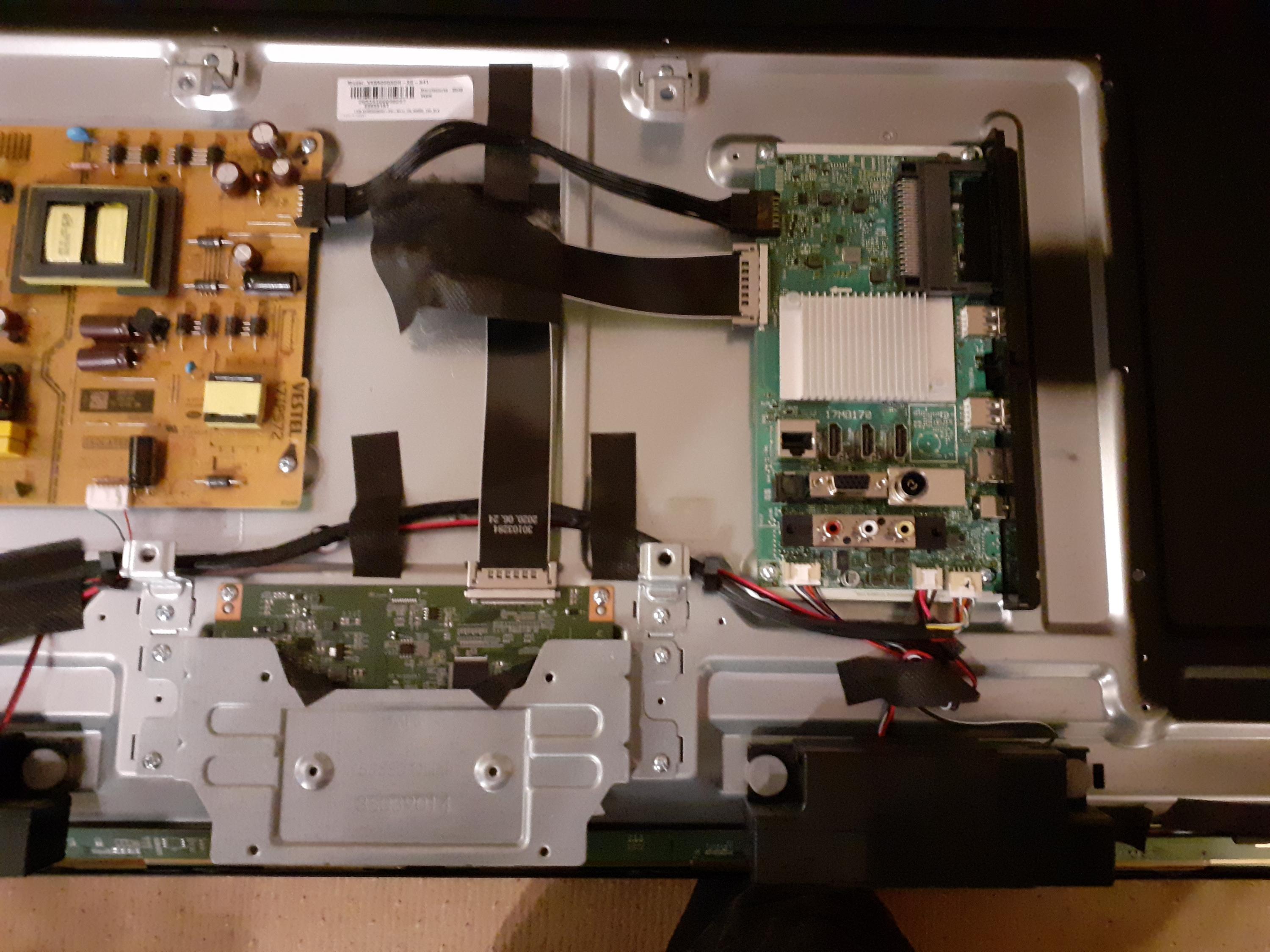

      I haven't had time to do the software yet, and I need to get the screen to stay on long enough to see the instructions!
      I have found that if I touch the LVDS cable connection to the T-Con, when the TV is on, it can improve the picture and sometimes restore the picture if it is not displaying an image.
      In other news, I have been given a JVC LT-50CF890 with a cracked screen (but otherwise full working order), which, according to Google searches, uses a VES500QNDH-2D-N41 panel and 17MB170 Mainboard, although I haven't checked if these are the actual boards and panel inside this actual TV yet.
      Do you think I could take all the boards and cables from the JVC LT-50CF890 (PSU/MB/TCON/IR/WiFi/LVDS Cable) and connect them to the Toshiba TV Panel type VES500QNDP-2D-N43?

        Re: Toshiba (Vestel) 50UL2063DB - bad COF?
        i think you need just take the LVDS from this JVC to put it on yours in case the T-CON side socket passed , it was to me too in thought and i did write it before.. it seem when you move the tv the issue come or it work straight.
        but it could be not the LVDS.. its just the pressure you push could in case screen glass some where brocken stay in touch.. so need also inspect after take the bezel out

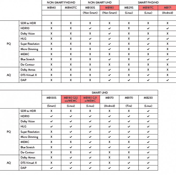

          Vestel_MB_PQ_AQ function
          in case you are willing to switch MB this is the compatible table with it function of PQ/AQ
            I tried the 17mb170 complete with t-con and LVDS cable (t-con has a different socket for lvds cable and it has a completely different layout to the toshiba t-con) but this did not work. The backlighting was on immediately at power on (Toshiba 17mb230 takes 3 seconds before backlighting is enabled ) and no image was displayed at all.
            I did upgrade the software, but still the same, with usually a blank , backlit screen, but occasionally a picture which has interference caused by area of brightness.
            I think.it is time to disassemble the screen and examine the connection tabs.
            Thanks for the MB compatibility tables.

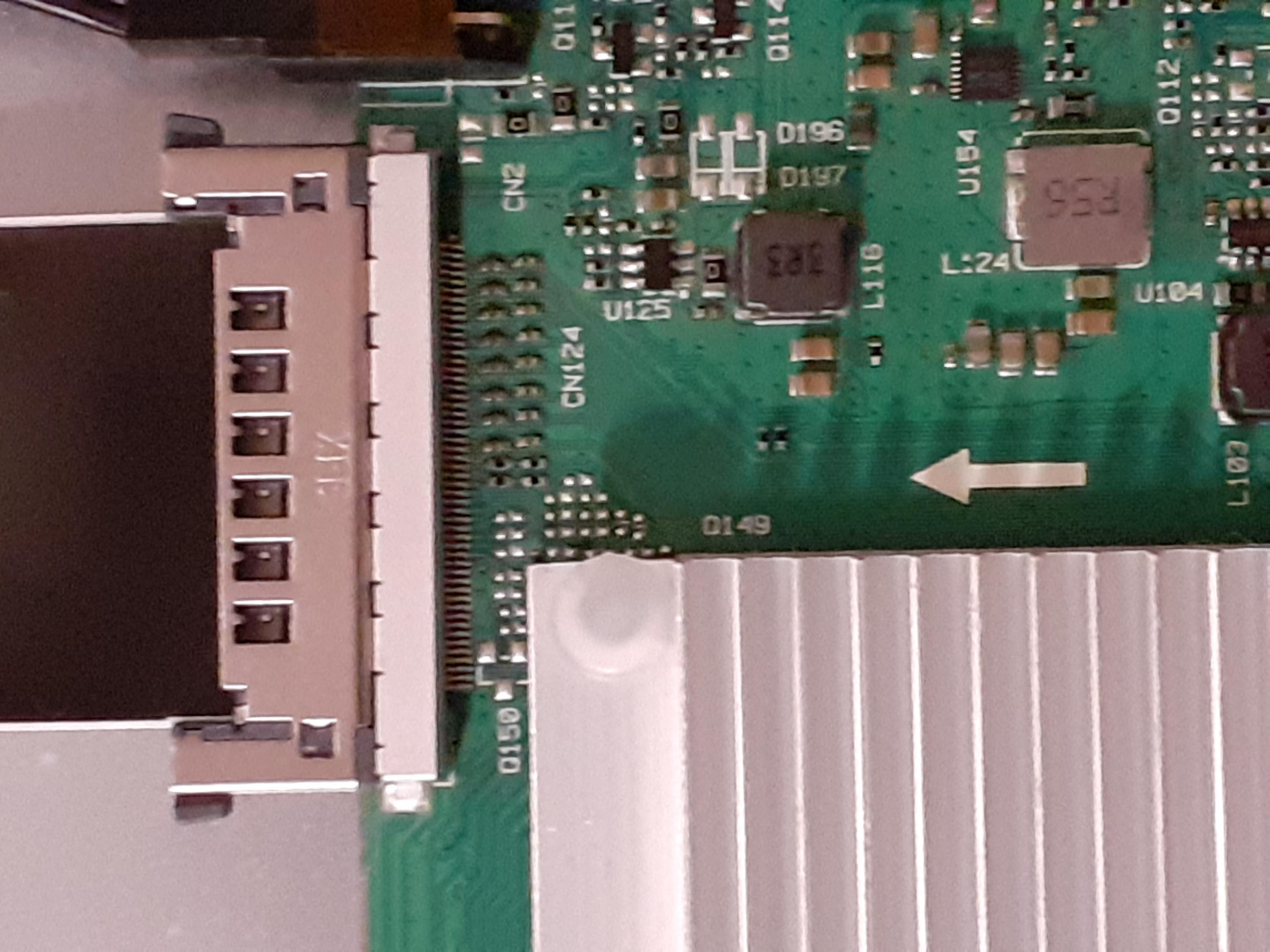

                    Photos of Toshiba MB230 LVDS and T-con LVDS
                    Edit, the MB LVDS Cable looks like it is not inserted properly, but I have removed it and reinstated it (clicked into place) with no change.

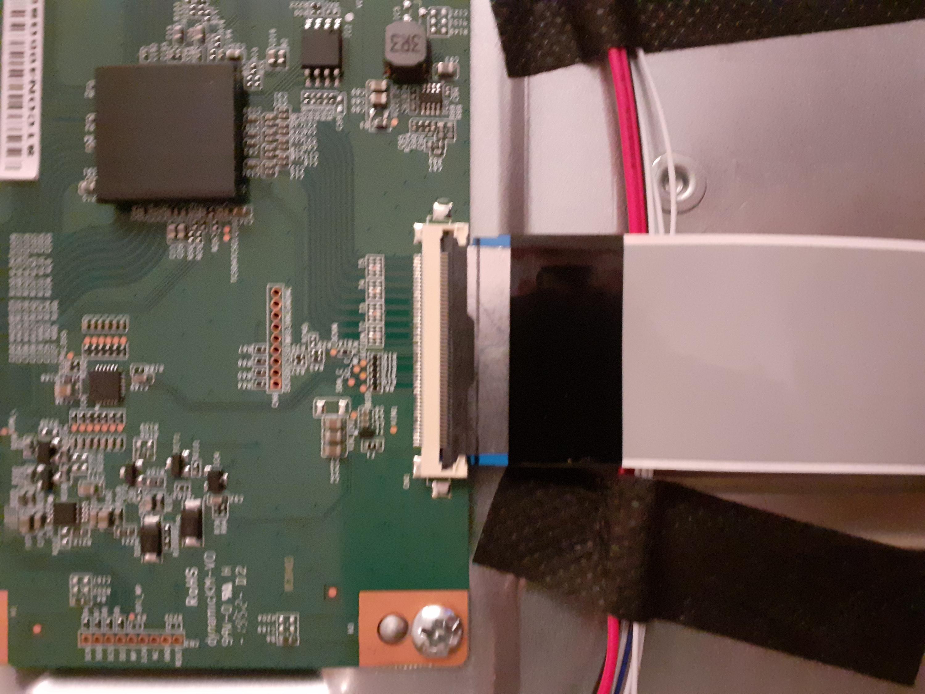

                      #70
                      Photos of JVC MB170 LVDS & T-Con LVDS

                        #71
                        I can try backing up the PQ file - what will this achieve?
                        Would you expect the JVC MB170/T-con combination to work on the Toshiba panel? The panels have a similar, but not the same, model type, but buffer board and ribbon cables are the same.
                        On closer inspection, the JVC T-con is different to the Toshiba T-Con and the JVC panel distribution board is TOTALLY different to the Toshiba panel distribution board, so no surprise it didnt work.
                        The MB130 that came from a JVC LT-40C880N did give the correct (partial) picture on the JVC LT-50CF890 , even though the panel is cracked.

                          #72
                          pin layouts all passed... but it will not work. because panel driver on MB170 .so format ( android platforum ), MB130 & 230 are linux .bin

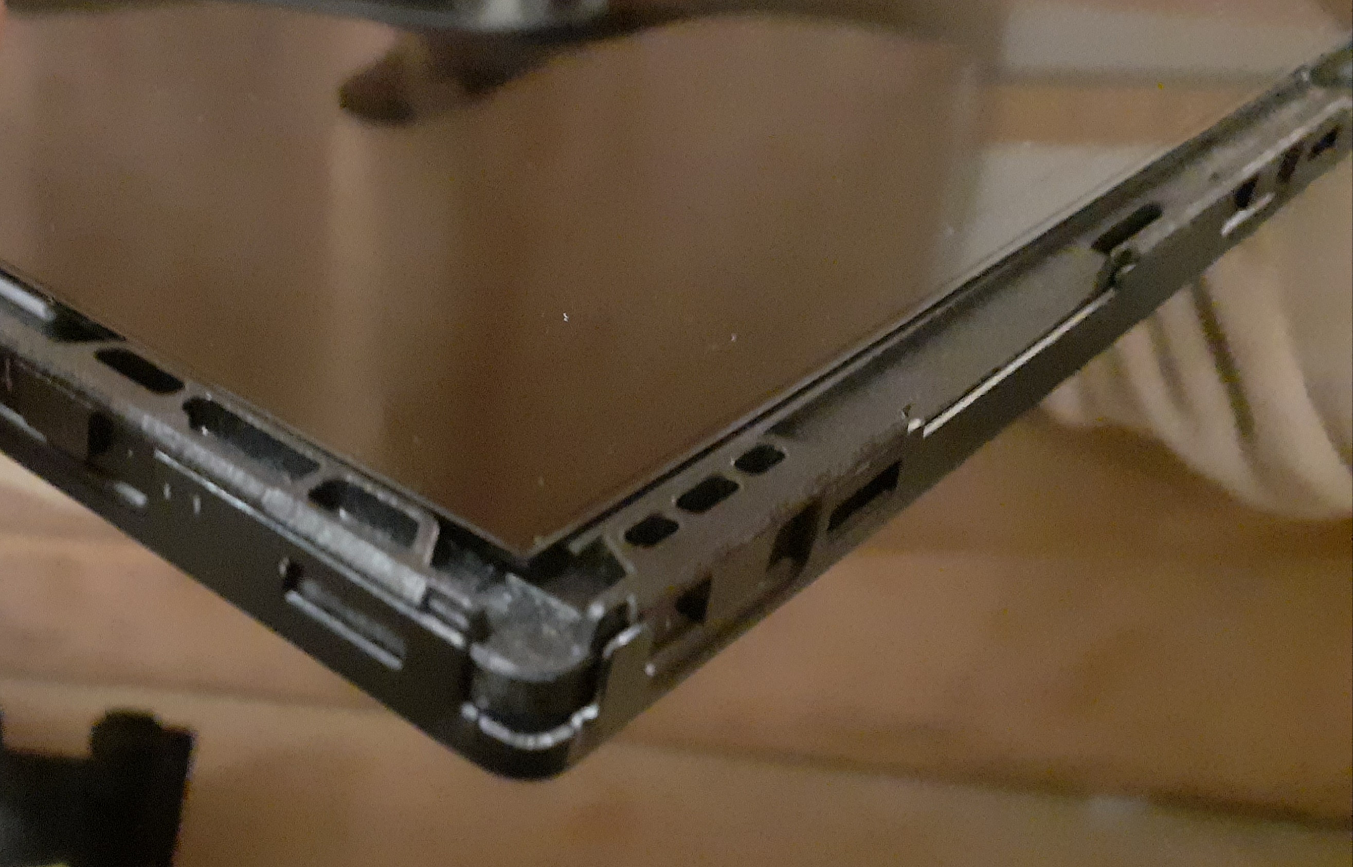

                              So I opened the screen of the JVC, as the bezel retainer is different to previous TV's I have worked on.
                              The screen of the JVC (type VES500QNDH-2D-N41) uses COG (chip on glass) for the gate drivers, so no chance of removing the gate drivers on the right side of the screen.
                              Assuming the Toshiba (VES500QNDP-2D-N43) uses the same COG gate drivers, the only hope of a repair is to isolate the supply voltage to those COG drivers.
                              I see that VGL and VGH voltages are generated on the T-Con, not the distribution board. I tried to trace the VGL & VGL from the T-Con, to the distribution boards, but neither of them seem to go to the distribution board through the ribbons.
                              Any thoughts on how I might "disable" the right side screen gate drivers, by isolation or cutting of tracks on the t-con or the distributionboard for the right side?
                              This might allow the left side gate drivers to do all the work, and give a full picture.
                              If no option is available, the screen is scrap.

                                  I have attached a photo of the top left corner of the JVC screen, after removing the bezel, showing there are no
                                  COF on the edge of the screen.
