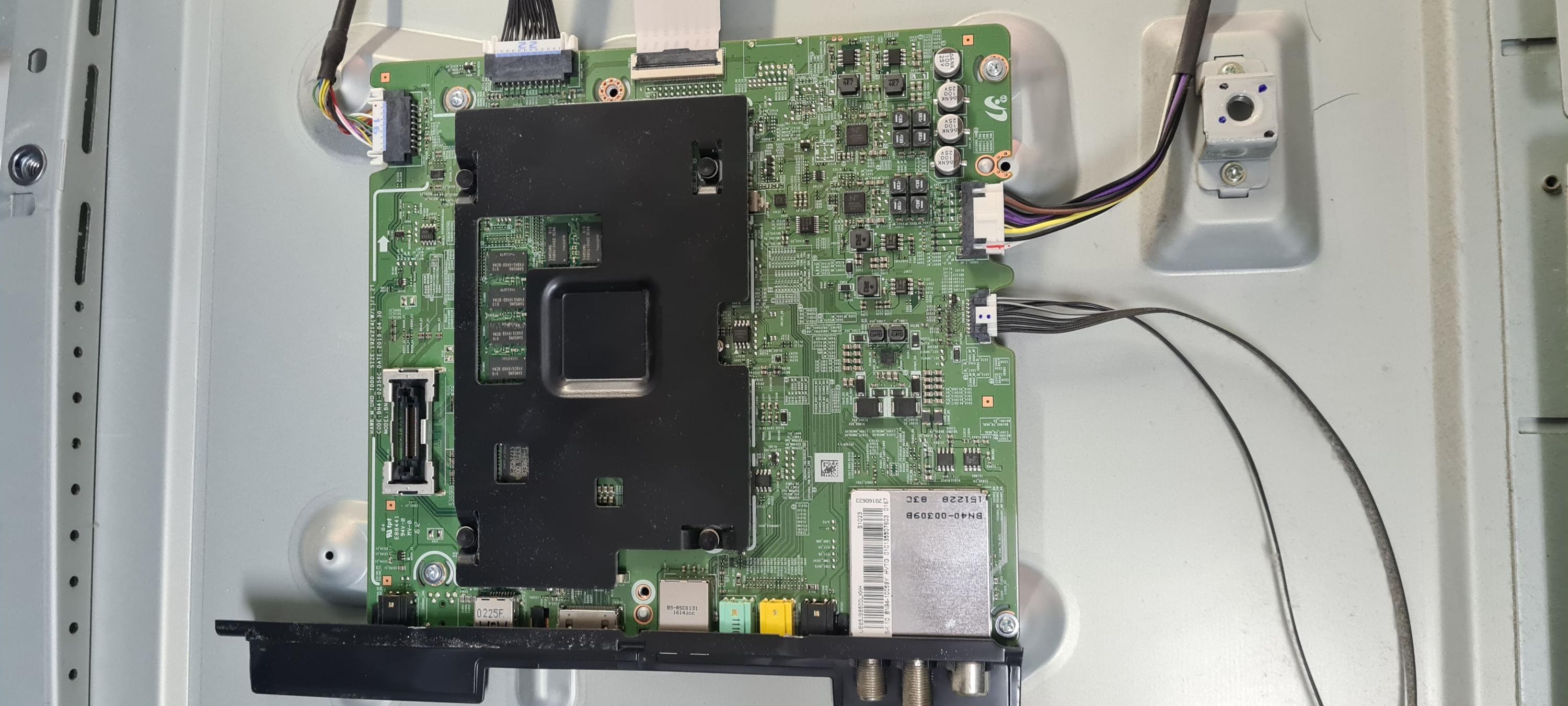

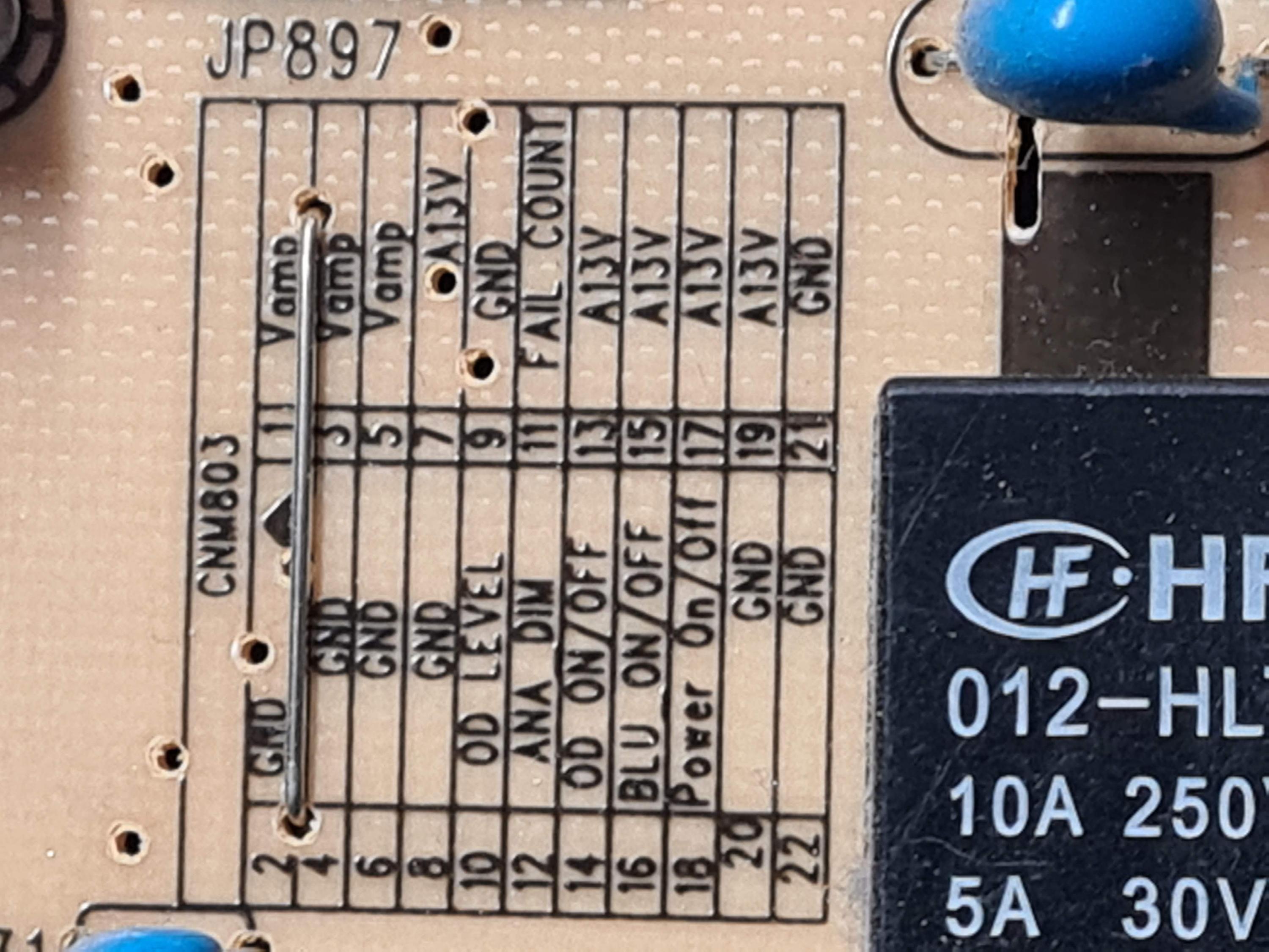

Samsung UE65JS8500 UE65JS8500LX 5 blinks
  • alltvrepairs
    replied
    Re: Samsung UE65JS8500 UE65JS8500LX 5 blinks
    Originally posted by Storyteller12
    The backlights are fine I think? In the US model of this TV UN65JS8500 it's a quantum dot TV. These tv use blue leds and not white. The layers i between the screen have nano dot technology and turn the blue backlight to a pure white.
    Screen CY-XJ065FLLV4H
    I don't think it is a Quantum Dot display but a SUHD
    Service Manual for the JU7500 series says:
    • . How to distinguish if the problem is caused by Main Board or T CON.
    • - No Video
    • If the problem is No Video but BLU is on and Indication LED is blinking repeatedly and faster than nomal booting, replace the T-CON board.
    • - Distorted Picture
    Check the inner patterns.
    If I apply this logic to my case, my BLU signal is 0v so more inclined to a main board.
    Last edited by alltvrepairs; 02-07-2022, 12:50 PM.
    Leave a comment:
  • RJARRRPCGP
    replied
    Re: Samsung UE65JS8500 UE65JS8500LX 5 blinks
    We haven't even been able to confirm blink codes for LG and Samsung TVs.
    We know that Panasonic, Sony, Sharp and Pioneer (most likely) OTOH, routinely give blink codes for a malfunction.
    But, it looks like you got one, where 5-blinks, is possibly the equivalent to Sony's 6-blinks. (The recent Sony TV that my father and mom had, suddenly gave 6-blinks at 1 Hz, (IIRC) stops and repeats)
    Went to YouTube after that, IIRC, then IIRC, YouTube videos indicate either a bad mainboard or bad LEDs in the case of that Sony TV, which we don't have anymore.
    Simply wasn't durable like the Sony TV that my brother-in-law has! I believe the Sony TV that my brother-in-law has, is still trucking along!
    Last edited by RJARRRPCGP; 02-07-2022, 12:29 PM.
    Leave a comment:
  • alltvrepairs
    replied
    Re: Samsung UE65JS8500 UE65JS8500LX 5 blinks
    Originally posted by Storyteller12
    The backlights are fine I think? In the US model of this TV UN65JS8500 it's a quantum dot TV. These tv use blue leds and not white. The layers i between the screen have nano dot technology and turn the blue backlight to a pure white.
    Tks I wasn't aware of this! It was a big help indeed!
    SO far found closer SM for:
    UE65JU7500T chassis UWJ50
    UE65JS9500F chassis UWH50
    UE65JS8500 chassis ???
    Leave a comment:
  • nomoresonys
    replied
    Re: Samsung UE65JS8500 UE65JS8500LX 5 blinks
    Oh I see, did not know that, thanks for explanation.
    Leave a comment:
  • Storyteller12
    replied
    Re: Samsung UE65JS8500 UE65JS8500LX 5 blinks
    Most likely the main board as mentioned. It could be the eeprom is corrupt but it sure.
    Leave a comment:
  • Storyteller12
    replied
    Re: Samsung UE65JS8500 UE65JS8500LX 5 blinks
    The backlights are fine I think? In the US model of this TV UN65JS8500 it’s a quantum dot TV. These tv use blue leds and not white. The layers i between the screen have nano dot technology and turn the blue backlight to a pure white.
    Leave a comment:
  • alltvrepairs
    replied
    Re: Samsung UE65JS8500 UE65JS8500LX 5 blinks
    Have found service manual for the JS9500 series but is very different from the JS8500 series.
    Anyone has this SM available please?
    Leave a comment:
  • nomoresonys
    replied
    Re: Samsung UE65JS8500 UE65JS8500LX 5 blinks
    Purple leds and the fail count, seems to be bad led backlights.
    Leave a comment:
  • alltvrepairs
    replied
    Re: Samsung UE65JS8500 UE65JS8500LX 5 blinks
    Originally posted by Sucher
    Main board is faulty. Please upoload the picture of the board, I need to see where eeprom and eMMC IC/ NAND are located, also check voltages on line voltage regulators directly after switch on- one of them could be dropping. Chcek if 12V to screen is present
    uploaded, see my comments. Tks
    Leave a comment:
  • alltvrepairs
    replied
    Re: Samsung UE65JS8500 UE65JS8500LX 5 blinks
    UPDATE: FULL MODEL UE65JS8500TXZT VERSION: 01
    These are the voltages from ps at standby and On
    CNM803
    ------------STBY ON
    2 GND -0 0
    4 GND -0 0
    6 GND -0 0
    8 GND -0 0
    10 OD LEVEL- 0 3.3
    12 ANA DIM- 0 3.3
    14 OD ON/OFF- 0 3.3
    16 BLU_ON/OFF- 0 0
    18 POWER ON/OFF- 0 3.3
    20 GND- 0 0
    22 GND- 0 0
    1 VAMP- 9 12.8
    3 VAMP- 9 12.8
    5 VAMP- 9 12.8
    7 A13V- 9 12.8
    9 GND- 0 0
    11 FAIL_COUNT- 2.5 2.5
    13 A13V- 9 12.8
    15 A13V- 9 12.8
    17 A13V- 9 12.8
    19 A13V- 9 12.8
    21 GND- 0 0
    The BLU_ON/OFF signal (pin 16) is ,kept TTL_Low from main board. I have disconnected this pin 16 from main board side. There is 3.3v coming from power supply now on this pin. But backlights still not switched on. If I remove CN9003 (power supply to TCON) backlights on but still same fault.
    CN9003 has the PWM signals from TCON to Backlight circuit in power supply.
    TCON supply 12v is actually being supplied from main board. 2 blue LEDs on TCON are lit when ON
    Now its a chicken and egg problem Is it the TCON not sending signals to supply or main board faulty or detecting another fault??
    Probably I can only get help from any Samsung expert that have had experience on the JS series.
    Last edited by alltvrepairs; 02-07-2022, 11:25 AM.
    Leave a comment:
  • Sucher
    replied
    Re: Samsung UE65JS8500 UE65JS8500LX 5 blinks
    Main board is faulty. Please upoload the picture of the board, I need to see where eeprom and eMMC IC/ NAND are located, also check voltages on line voltage regulators directly after switch on- one of them could be dropping. Chcek if 12V to screen is present
    Leave a comment:
  • alltvrepairs
    replied
    Re: Samsung UE65JS8500 UE65JS8500LX 5 blinks
    Originally posted by neilc6
    Did you see if the TV powers up with only one side connected at a time between the tcon and panel?
    Yes any or both no difference.
    Leave a comment:
  • neilc6
    replied
    Re: Samsung UE65JS8500 UE65JS8500LX 5 blinks
    Did you see if the TV powers up with only one side connected at a time between the tcon and panel?
    Leave a comment:
  • CapLeaker
    replied
    Re: Samsung UE65JS8500 UE65JS8500LX 5 blinks
    Check all the voltages on the connector from the PSU to main board and see if there is something missing. While purple LEDS aren’t the best, at least they did turn on with the main board disconnected and stayed on. Right now I think you are barking at the wrong tree. post the PIN number, name and the voltage measured with tv On and Off.
    Leave a comment:
  • alltvrepairs
    started a topic Samsung UE65JS8500 UE65JS8500LX 5 blinks
    Samsung UE65JS8500 UE65JS8500LX 5 blinks
    Have this curved TV for repair. I have noticed 5 blinks then goes to standby and cycle repeats. Seems responds to remote commands but backlights not lit
    What I have done so far:
    • Disconnected power supply from Main Board and TCON. (this model has a connector lead to TCON as well) -> Backlight lit on but have noticed that LEDS are purplish.
    • Tried ALL 16 sets of LEDs (8 LED sets per connector) with my LED tester and all Lit up although again purplish not that intense.
    • Disconnected Panel LVDS Connectors but same error code.
    Am not sure if this model detects the low emittance of the LEDs and goes to error state.
    Any hints on this model?
    09-07-2024, 05:50 AM
    09-06-2024, 11:40 PM
    09-06-2024, 11:40 PM
    09-06-2024, 08:40 PM
    Samsung Galaxy Book Flex NP950QCG-K01DE Notebook Specification for Upgrade or Repair
    This specification for the Samsung Galaxy Book Flex NP950QCG-K01DE Notebook can be useful for upgrading or repairing a laptop that is not working. As a community we are working through our specifications to add valuable data like the NP950QCG-K01DE boardview and NP950QCG-K01DE schematic. Our users have donated over 1 million documents which are being added to the site. This page will be updated soon with additional information. Alternatively you can request additional help from our users directly on the relevant badcaps forum. Please note that we offer no warranties that any specification, datasheet,...
    09-06-2024, 06:20 PM
