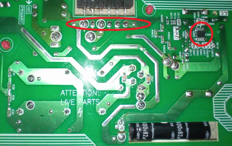

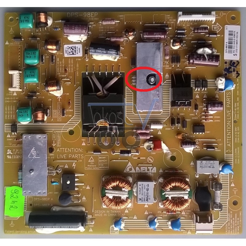

    Hi, for philips i need service manual.
    I have problem with power supplay DPS-98EP A
    I change fuse and TK13A65U. But not have voltage 12V only 3.3V.

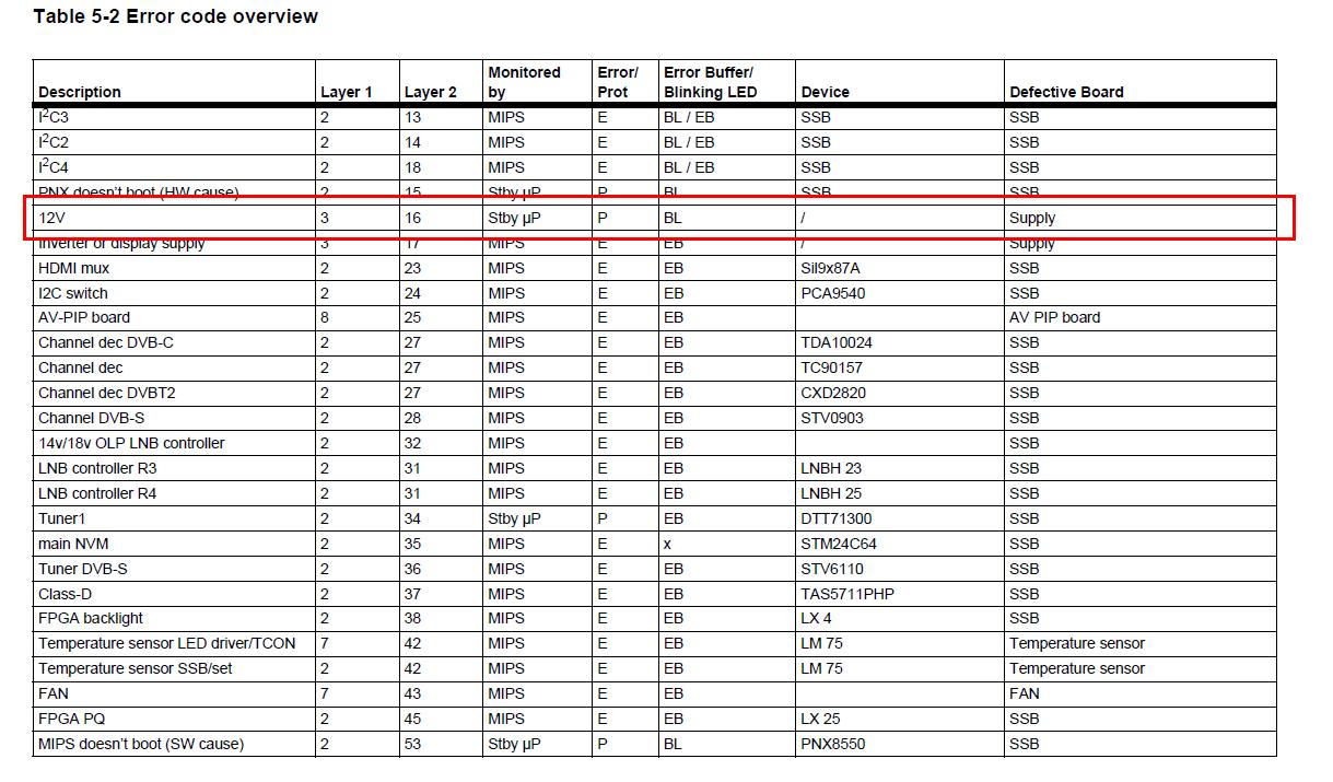

      I already found it. i have ERROR CODES - LED BLINKING CODES.
      4s pause and 3 fast flashing led blinking. I can't find this error.

          when connected to the power supply, red led blinking. (4s pause and 3 fast flashing led)
          Voltage is only 3.3V.

            Where is TK13A65U in the circuit? is it in the standby, pfc or main circuit?
            Usually when a mosfet like this shorts it opens the source resistor and can damage the drive ic as well.

                The service manual does not have the dps-98ep schematic. That does look like the main mosfet that drives the main transformer. There is a resistor R611 0.24Ω (mosfet source) located beside that heatsink, check that it is not open, I expect that it is open. If R611 is open, check R610 as well, it connects the mosfet source to ic601'a CS pin.

                  I marked it wrong, TK13A65U is located on the second aluminum plate.

                    What is its board location number? that looks to be a Diode (D120)?
                    Do you have any voltage across C700A or C120A? (I'm not sure of the numbers).
                    If it was indeed a mosfet I suspect it is used to switch a voltage

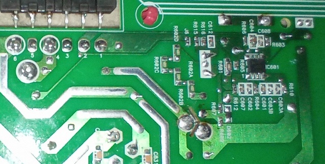

                      The problem is on the primary of the transformer
                      IC 601 may not work. How can I check the operation of the transformer.

                        Check R611 0.24 resistor and see if it is open What is the number on Q601 AND IC601?

                          R611 is good-closed, Q601 is good, ic601 2QS02G

                            Do you have vcc voltage (20v) on pin7 of ic601? be careful not to short the ic pins. There is a resistor connected to pin7, check the voltage there instead of on the ic.
                            I suspect there is no vcc and the supply for the vcc comes from the standby circuit.
                            I am starting to think there is no power on signal from the main board. I suspect PC903 is the optocoupler that turns on the power supply
                            CN4 pin 2 standby should be the power supply on. With CN4 disconnected from the main board, connect pin 1 (3.3v) to pin 2 (standby) and see if you get your 12 volts.

                                      When I connect the power cable to 220v only red led blinking.
                                      The main board works but reports an error.
                                      Voltage failure is possible.

                                        Here it is listed under layer 1
