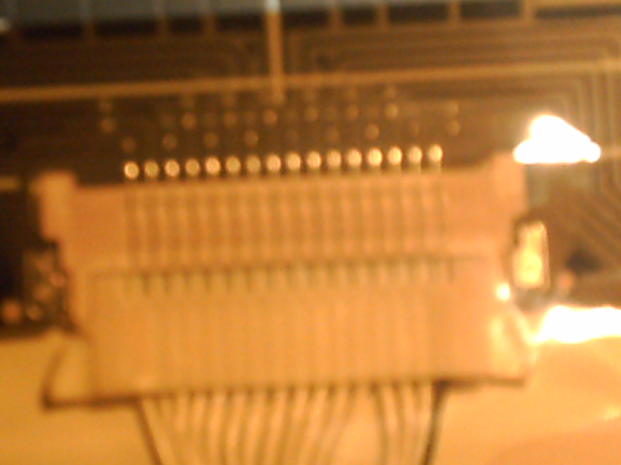

                              • Diah
                                • Feb 2013
                                • 6565
                                #75
                                Re: Sony xbr65x900c sound yes, no backlight or image.
                                you have the screen out.. so show me the strip LED.. edge LED built in zener.. some time it lit but the zener open.. or it short didn't let LED to lit
                                • nomoresonys
                                  • Jan 2013
                                  • 12330
                                  • U.S.
                                  #76
                                  pics.
                                  • nomoresonys
                                    • Jan 2013
                                    • 12330
                                    • U.S.
                                    #77
                                    There are tiny little + and - under the colored tape I guess that is, maybe I can test them with the dmm if I pull off the tape.
                                    • Diah
                                      • Feb 2013
                                      • 6565
                                      #78
                                      not with dmm, only led tester or any other v source because they are group could have 6-8 led in each.. each socket all group share the same + the dark wire you can feed each socket from the other end of the cable. so no need to pull off the tape
                                      if you are going to use DMM must be direct on each led on the strip
                                      • nomoresonys
                                        • Jan 2013
                                        • 12330
                                        • U.S.
                                        #79
                                        Can't see where to put the leads, guess I'll get a tester, I think theyr'e on sale, had one but lost it somehow.
