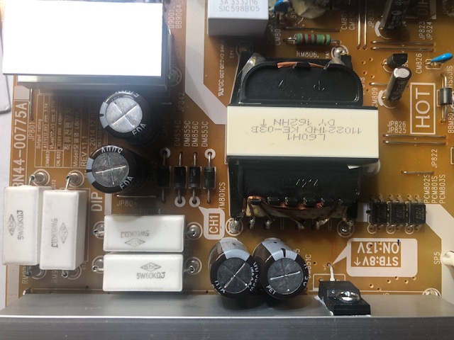

    Re: Samsung UN60J6200AFXZA
    This is an always on power supply, it does not use a seperate circuit for standby. I suspect you may have shorted the A13V not the ps_on, so start by checking for a shorted output diode, DM851, DM853~DM856
    Using HOT GROUND )JP823/JP824) check the dc voltage on SP7 (DM810 Anode) This is the main ic VCC voltage

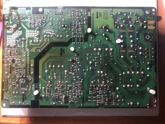

      if all that checks out theres a bunch of resistors on the underside to test, one of the ic's on the underside could be bad.

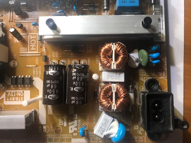

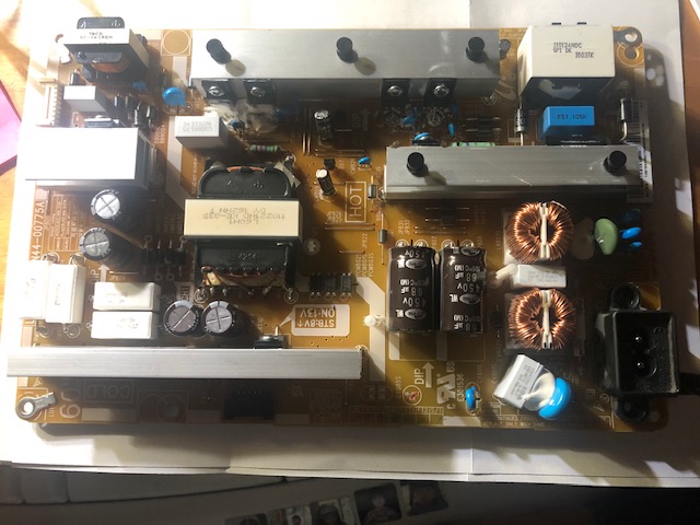

        Going to need better pictures of power board.

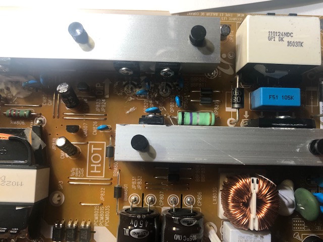

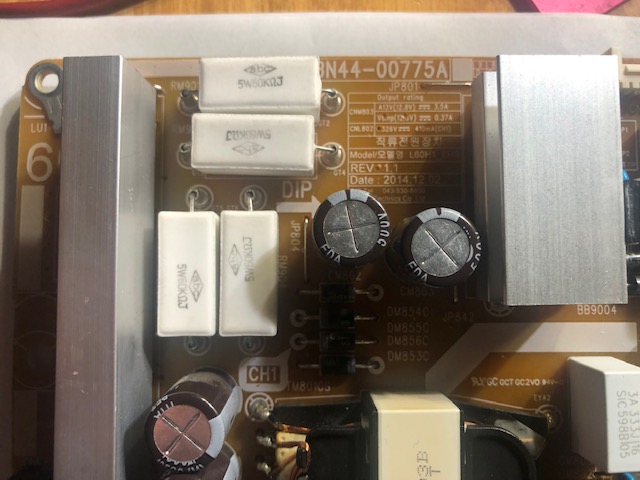

              See attached pictures...
                Hi res picture.
                https://www.shopjimmy.com/search.php...ry=bn44-00775a
                And you doublechecked your fuse. Outputs are usually protected from shorts by their controllers.
