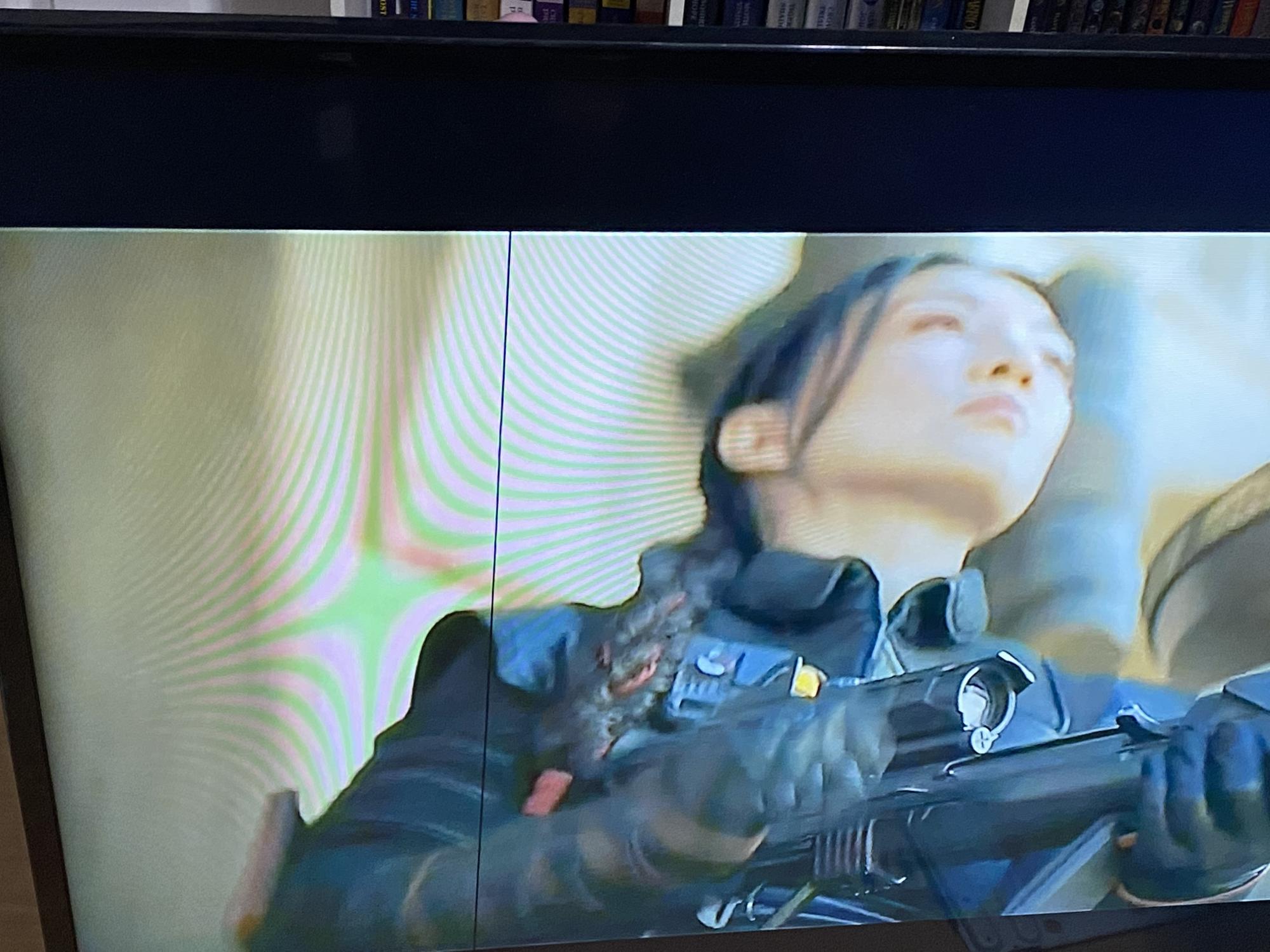

    What would cause this black line on the screen ?
    I reseated the ribbon cables but the line remains .
    Any ideas ?

    Static vertical lines are bad panels and not repairable. Google the Sony Tcon Training Manual.

      These j series panels all seem to have this problem.
      I have 3 with the same line on the left side as well.

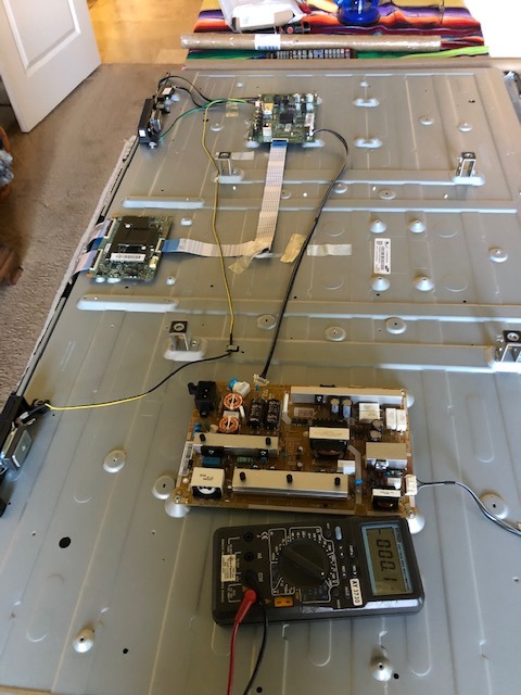

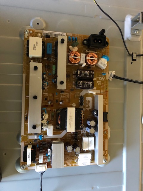

            Hi DSKALL,
            Here are the details on my Samsung UN60J6200AFXZA.
            Symptom:
            When Tv turned on, no backlight, has sound and does have an image when I used a flashlight.
            What have I done so far:
            a.) Replaced bad LEDs with new ones from ShopJimmy...did not resolve symptom

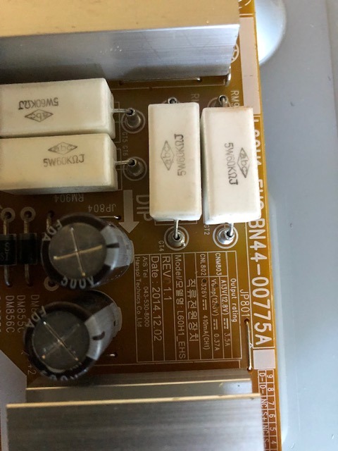

            On Power Supply Board BN44-00775A
            b) Replaced Diode D9001C and MosFet Q9001C...did not resolve the problem
            c) Replaced QP801CS, QP802CS and CP805...did not resolve the problem
            Disconnected Mother board then
            Voltage readings at present with the above replacements:
            STBY=0V with reference to chassis GND.
            With the LED Connector removed
            On Connector: CNL802
            pin1+ to pin 4:S- = 0V
            pin6:S+ to pin 9-=0V
            STBY =12.7V
            Voltage on either Side of D9001C = 0V
            On Connector CNM803
            Pin 2: UD= 0Volts
            Pin 4: PWM_BLU=0Volts
            pin 6: PS_ON=0Volts
            Pin 8: GND = 0Volts
            Pin 10: GND = 0Volts
            Pin 1: A13V = 0Volts
            Pin 3: A13V = 0Volts
            Pin 5: A13V = 0Volts
            Pin 7: A13V = 0Volts
            Pin 9: GND = 0Volts
            Fuse test good
            Can't get the high voltage on ConnectorCNM803
            Any help/guidance will be appreciated

              Hi DSKALL
              I have to update the above voltage readings as follows.
              Before the voltages all went to zero, and thru the probing process, i accidentally Shorted Pin 6 (PS_On) and Pin8 (GND) on the CNM803 connector.
              Before this occured, the readings were as follows
              STBY=12.7V with reference to chassis GND.
              STBY =12.7V
              Voltage on either Side of D9001C = 417V
              On Connector CNM803
              Pin 2: UD= 2.4Volts
              Pin 4: PWM_BLU=3.4Volts
              pin 6: PS_ON= 4.1Volts
              Pin 8: GND = 0Volts
              Pin 1: A13V = 12.8Volts
              Pin 3: A13V = 12.8Volts
              Pin 5: A13V =12.8Volts
              Pin 7: A13V = 12.8Volts
              Pin 9: GND = 0Volts
              So....I now have 2 problems.
              1. recovering the state of the powersupply to the condition before the accidental short
              AND
              2.How to get the High voltage to the known good LEDs
              Thank you for your help

                  Shorting ps-on probably turned off power supply. Should come back up when you press power button. Did you test backlights with a tester after you installed them?

                    since theres a question now, plug everything in as normal thats with all boards hooked up, then do this test, just like it is to see what you are getting: report the voltages you have in standby(tv plugged in) and when you power on the tv, report both conditions, as in: pin number, expected voltage and your actual voltage, example pin 1 ps-on, off 0volts, on 3.5volts.

                        did you very carefully check the voltage between the legs of the big filter caps on powerboard? CAUTION DEADLY VOLTAGE in the hot/primary side of the board, normal is around 165 in standby and around 390 when tv powered on. If your meter is not autorange, you need to set it at 200 or next higher vdc.
                              ON STBY (Since the PS is not turning on) voltage= 160.7V on both CP807 and CP806
                              • tahoe
                                • Jan 2012
                                • 18
                                Re: Samsung UN60J6200AFXZA
                                Pluged everything back together...
                                STBY= 0Volts
                                All Pins read 0 Volts no red light indication of teh Power coming on.
                                Perhaps teh rectifier circuit is bad? I have no schematics so cannot probe down to the component level...
                                Any Help appreciated

                                    ok, have to start with standby, so unhook all cables from powerboard, then plug the power cord into powerboard, see if standby is there.
                                    • nomoresonys
                                      • Jan 2013
                                      • 12086
                                      • U.S.
                                      make sure the screws holding the board down are not loose as they are also the grounds.
                                      • nomoresonys
                                        • Jan 2013
                                        • 12086
                                        • U.S.
                                        can check for standby voltage on dm851c, see the big stb:8v, on 13v printed in big letters on the board? others things to do, check all diodes in diode mode, probe on each leg, expect around .5xx one way, reverse probes, expect ol or l, check the resistors too, youtube is your friend for how to videos, also check the bottom of powerbard solder joints, check below.
