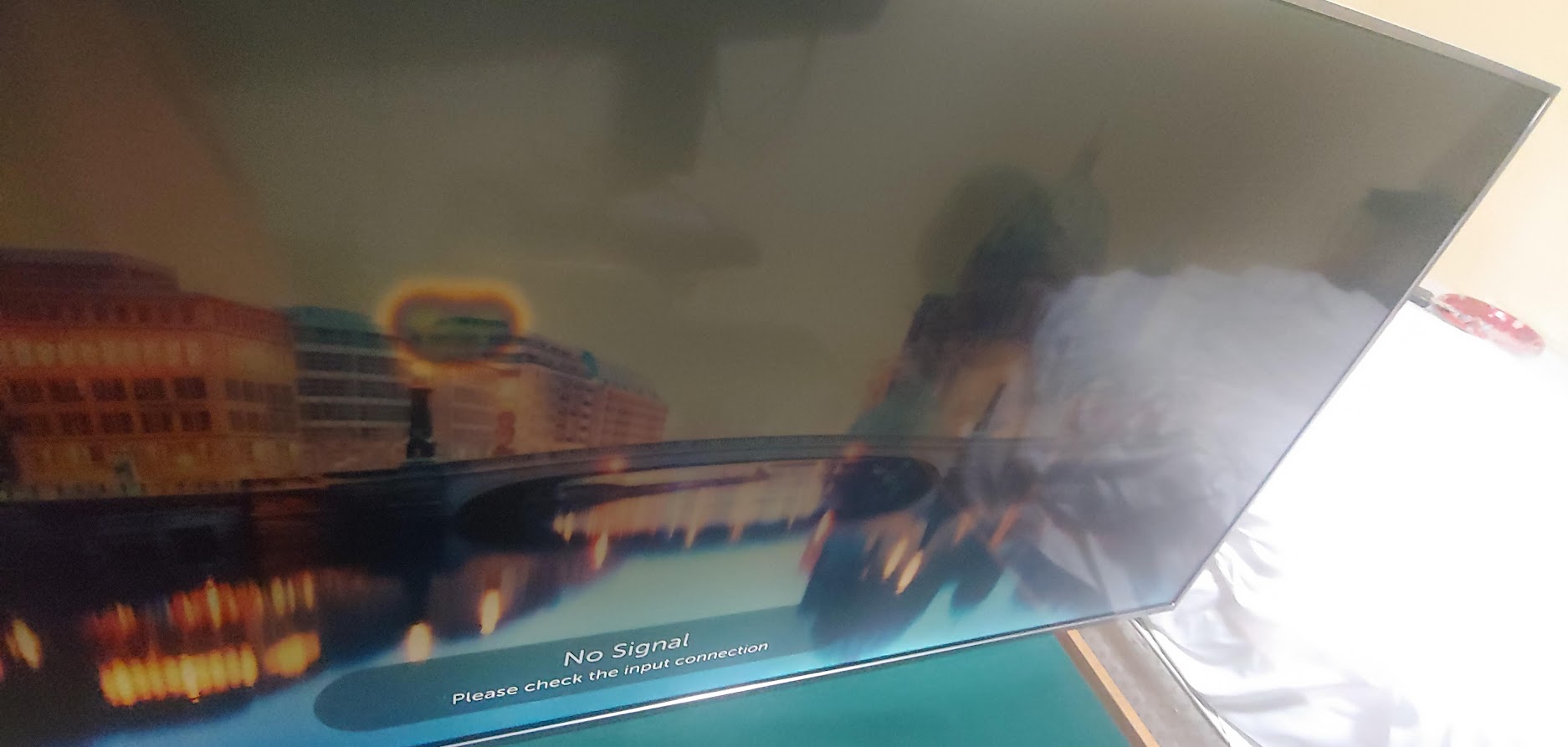

I had to replace the led strip in one of these edge lit led tv's. I'm trying to put this tv back together but unfortunately the diffuser panels got all mixed up and I really learnt a lesson on this one. If anybody knows how to put these diffusers on the right way please help. I have put this tv back together like 10 times and close to giving up.
lg-55UH6090 Diffuser panel mixup
Re: lg-55UH6090 Diffuser panel mixup
Ya I fixed this through days and days of giving up and restarting it. Their is no easy way of doing this other than trial and error and yes its a major pain in the ass. The school of hard knock taught me to never ever mix up tv diffuser layer ever again lul sorry man just keep trying different orientations.Comment
