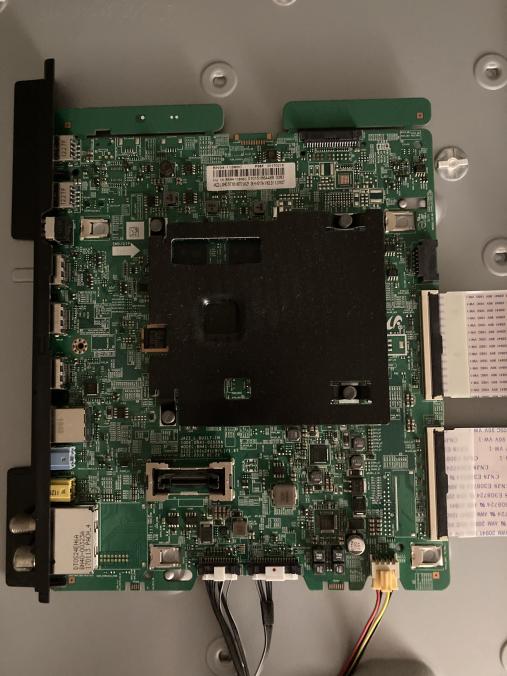

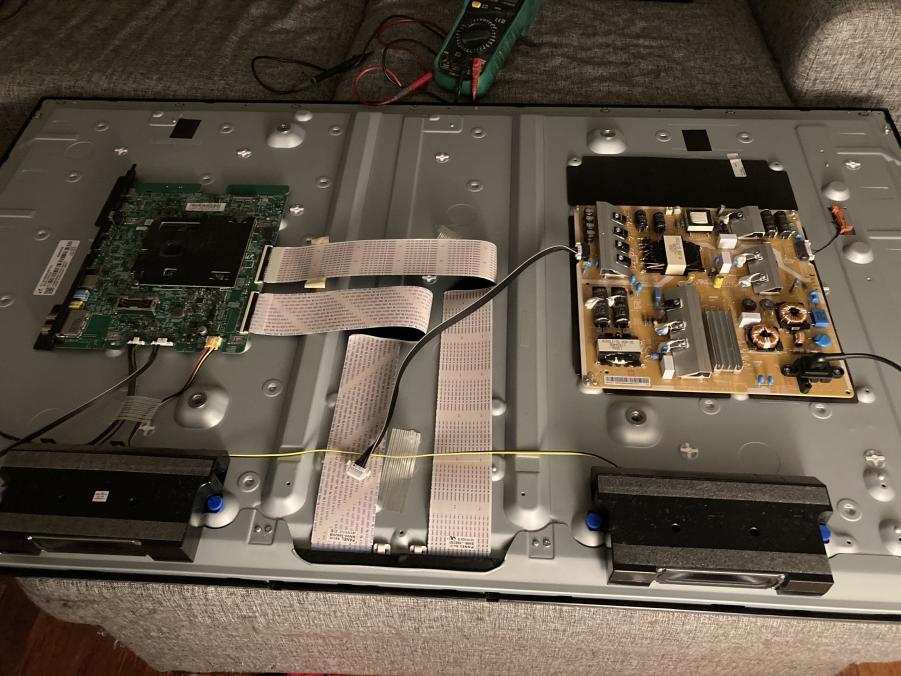

    Hey guys
    I got this TV from my friend and he said that one day he was trying to power it on it was just dead.
    I did open the back of the TV and check the boards and cable connections and everything seems ok (no popped caps or anything visible).
    I tried to turn it on few times and when I plug it in it flashes "Smart TV" logo and goes dark for about 20 seconds (no backlight yet) and after that the backlights are lit but no picture and didn't give any startup sound, sometimes it didn't start up but did show the standby led only and every time I pushed power button the standby light blinked and nothing else happened.
    I did measure the voltages from powerboard to mainboard while the cable was disconnected and these are the values I got:
    ANA_DIM 3.26v
    OD_ON/OFF 3.61v
    PWM_BLU 3.14v
    POWER_ON 4.5v
    GND 0.0v
    GND 0.0v
    FAIL_COUNT 1.57v
    A13v 12.85v
    A13v 12.85v
    A13v 12.85v
    A13v 12.85v
    GND 0.0v
    Any ideas how to proceed checking what's wrong? From what I've read it seems that the mainboard (BN94-11896C) might be broken, I did check for spares but it seems expensive (over 100€) and availability in Europe seems non-existant so if anyone knows if there is any other boards that would work with this TV, please share your knowledge.
    Sorry for bad photos, I will upload better ones when I get the chance
    Thanks in advance!

    Re: Samsung UE50KU6072U - Backlights working, black screen
    i am suspecting bad leds, have you got a led tester?
      Are you getting voltage at the t-con board?
