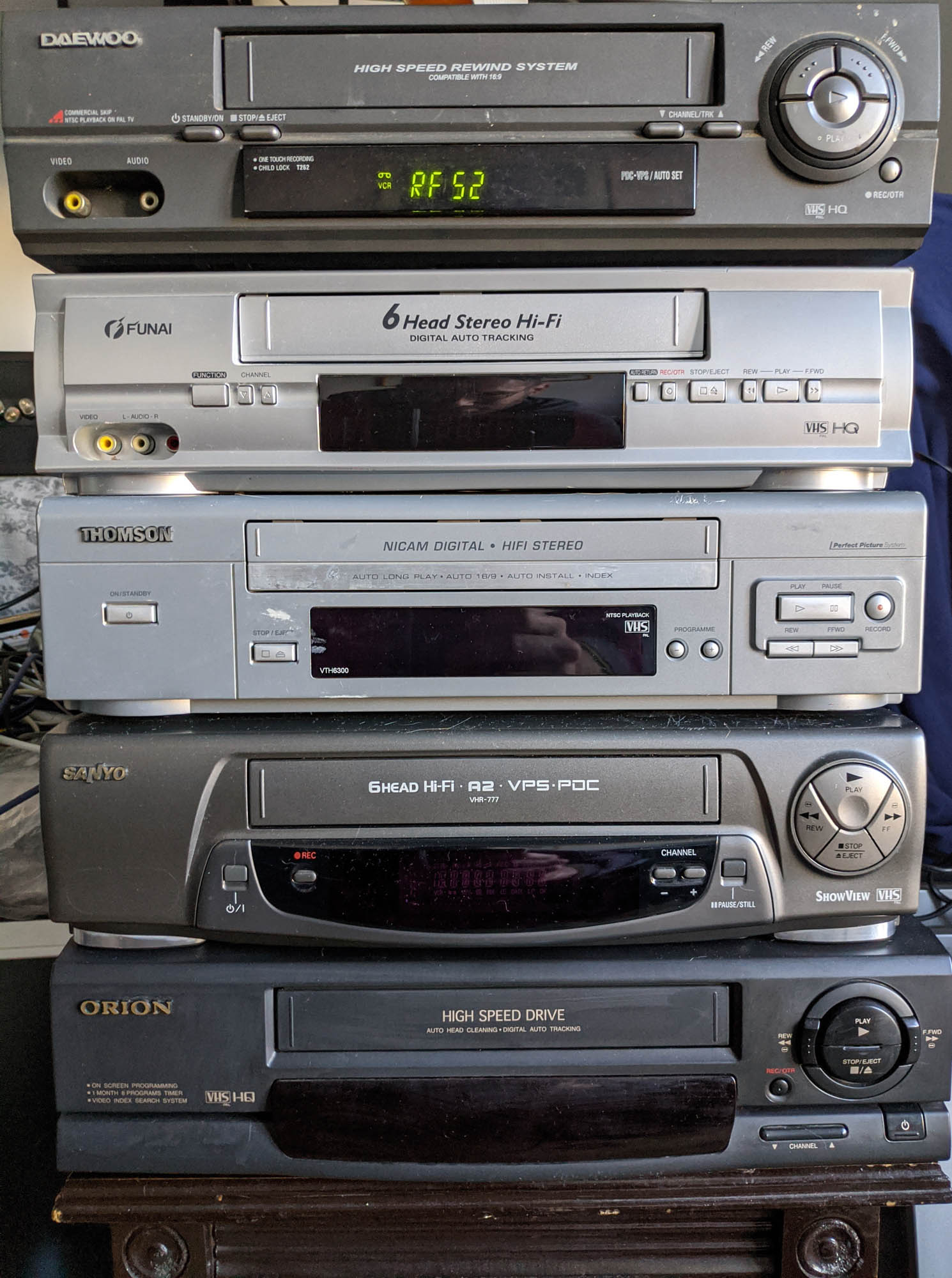

                                  hmm... I still have
                                  three working vcr's (at least of last check) though one has dry cracked pinch roller, still works...
                                  one vcr with a jammed mechanism (can't figure out how it's jammed...)
                                  one combo dvd/vcr whose vcr section has tracking problems (top of screen looks fine, bottom is garbled)
                                  one pretty worn out time lapse VCR, still works okay.
                                  one combo dvd-r/vcr combo that seems to work fine.
                                  Been wanting to fix that one vcr that has tracking problems but no luck. It was worse than this prior - it wouldn't even turn on due to water damage, but got it to turn on at least (and hence DVD works.)
                                  Not sure what I will do with these things... I do have some tapes however - not many, but enough so I can actually use them. I think I have two good commercially recorded tapes, one broken commercially recorded tape, and a bunch of uncommitted tapes. And that's not counting the VHS-C's...
