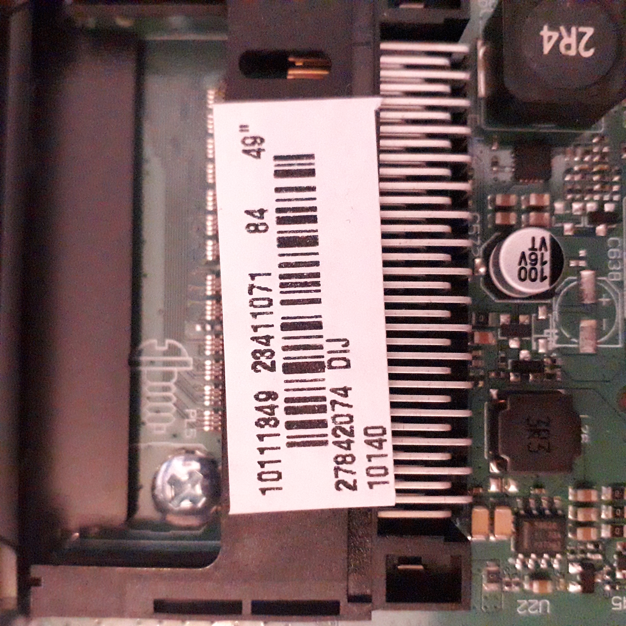

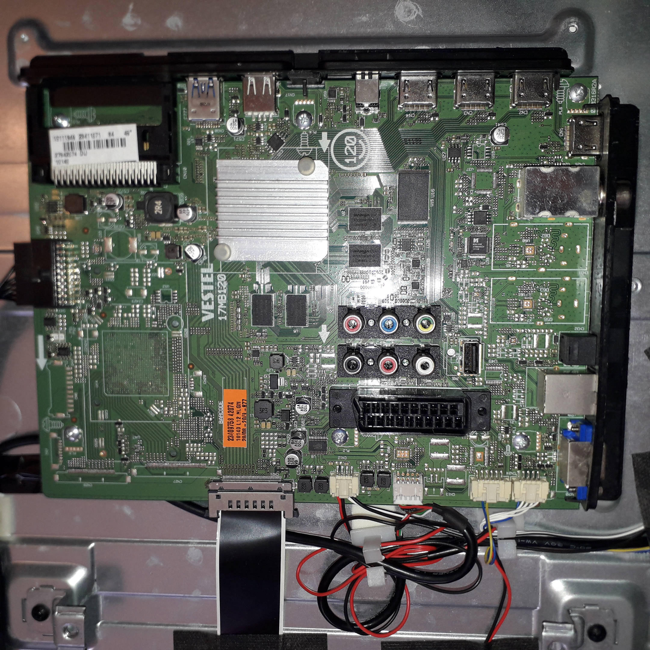

    I need help to dispel some doubts and try to reach the correct solution (if there is any...) to the malfunction.

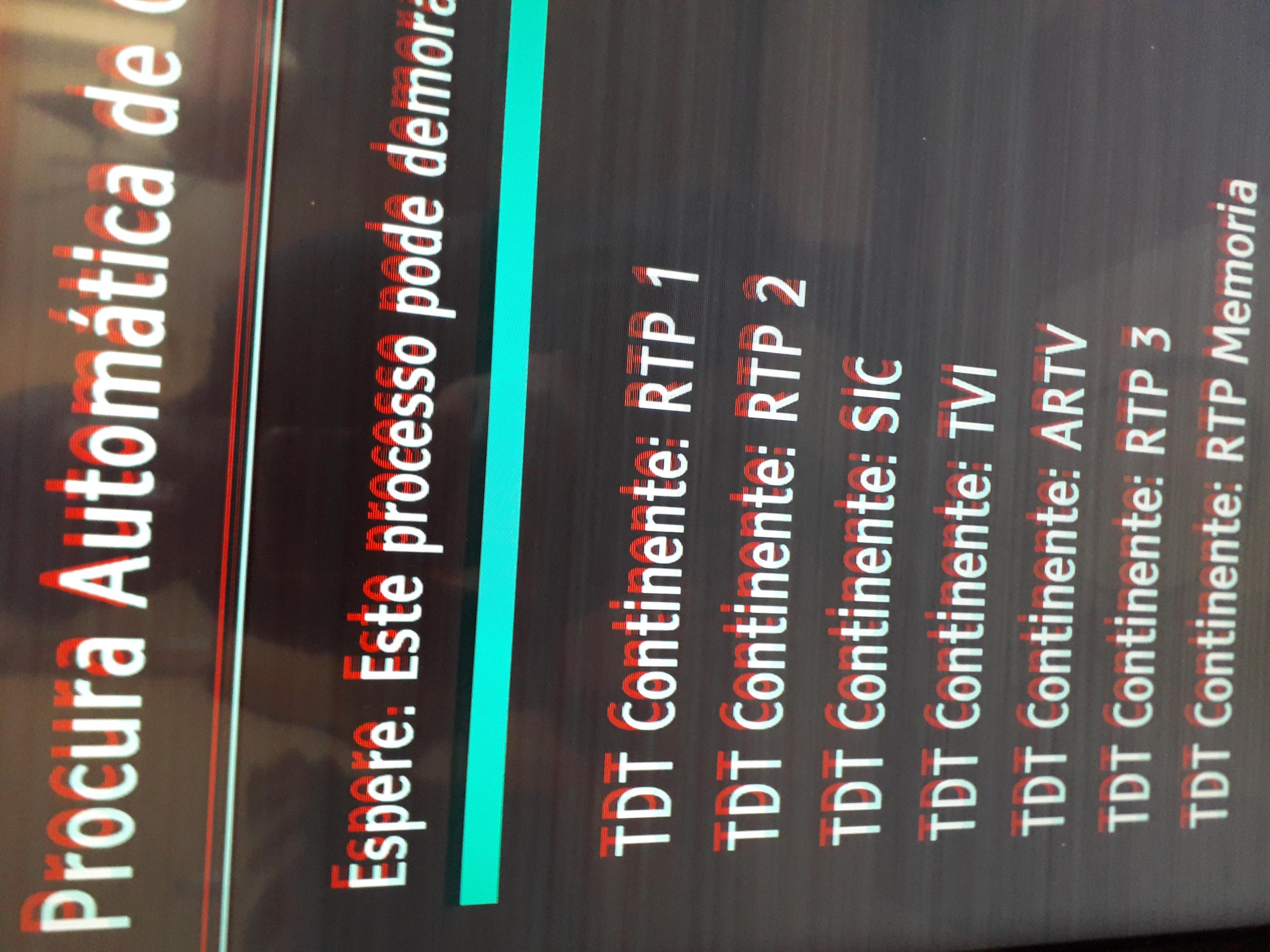

    the screen has red blinking shadows/outlines, duplicates images, characters. this anomaly crosses all image sources: HDMI, SCART, VGA, channel tuning...
    I can't find technical information about it. This is a white brand, I think it is produced by Vestel (Turkey).
    I can perform multimeter measurements (to dispel some doubts), but I don't have an oscilloscope, and I don't have technical skills to perform component exchange/soldering. There is also no store to perform this kind of service nearby.
    SO, which PCB do i need to change? (if it's worth it).
    where can i find the replacement parts in Europe?

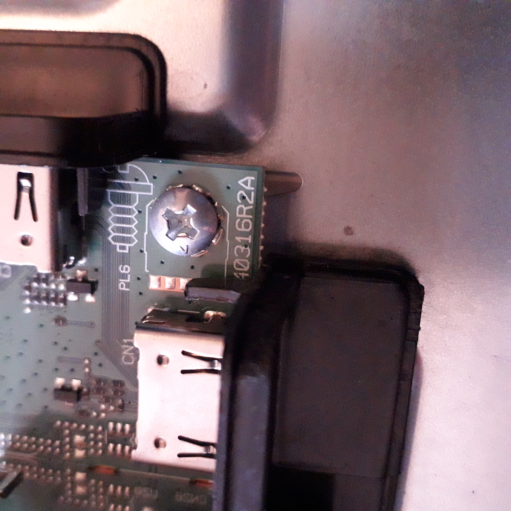

    Here are the references found inside:

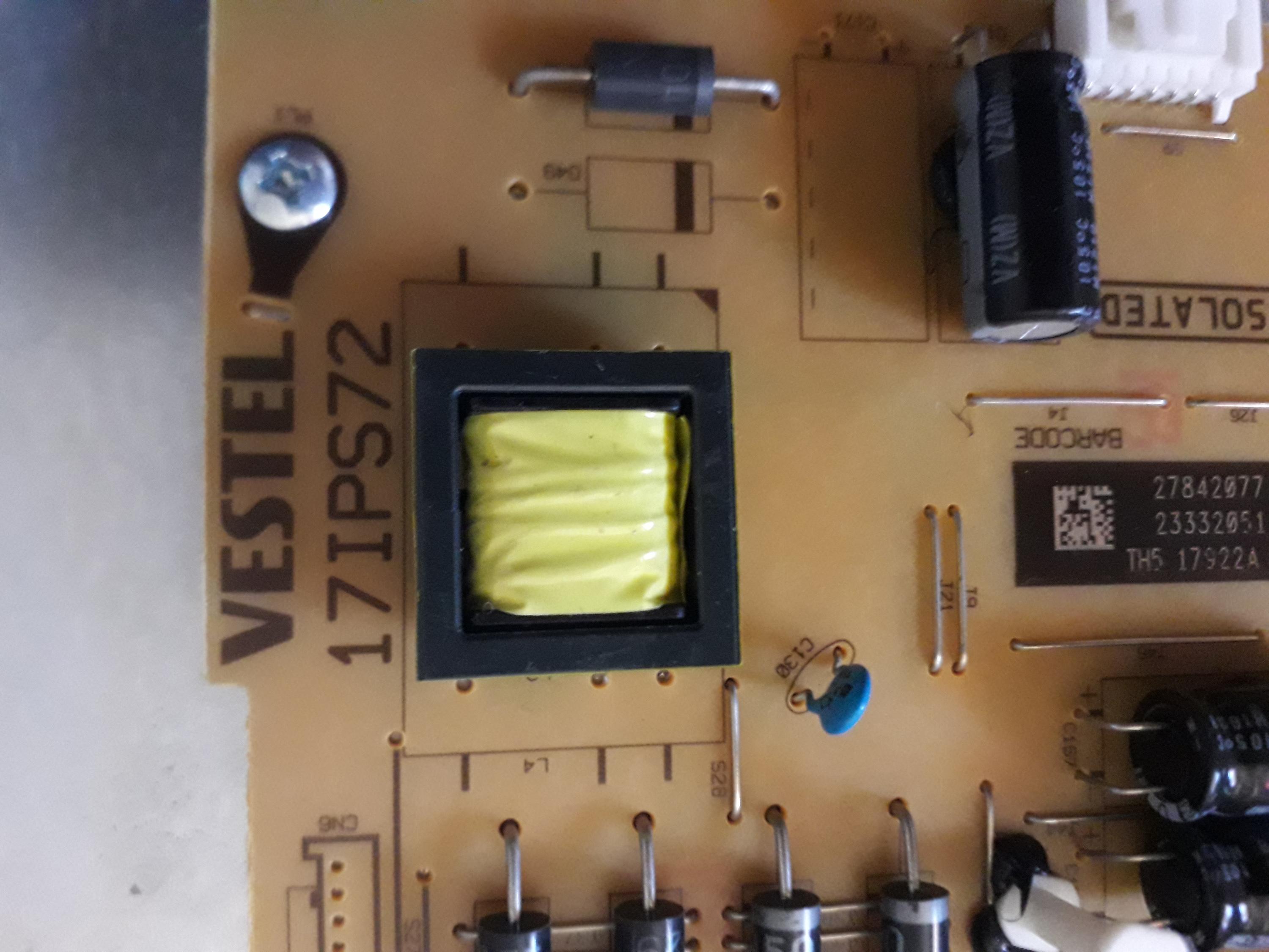

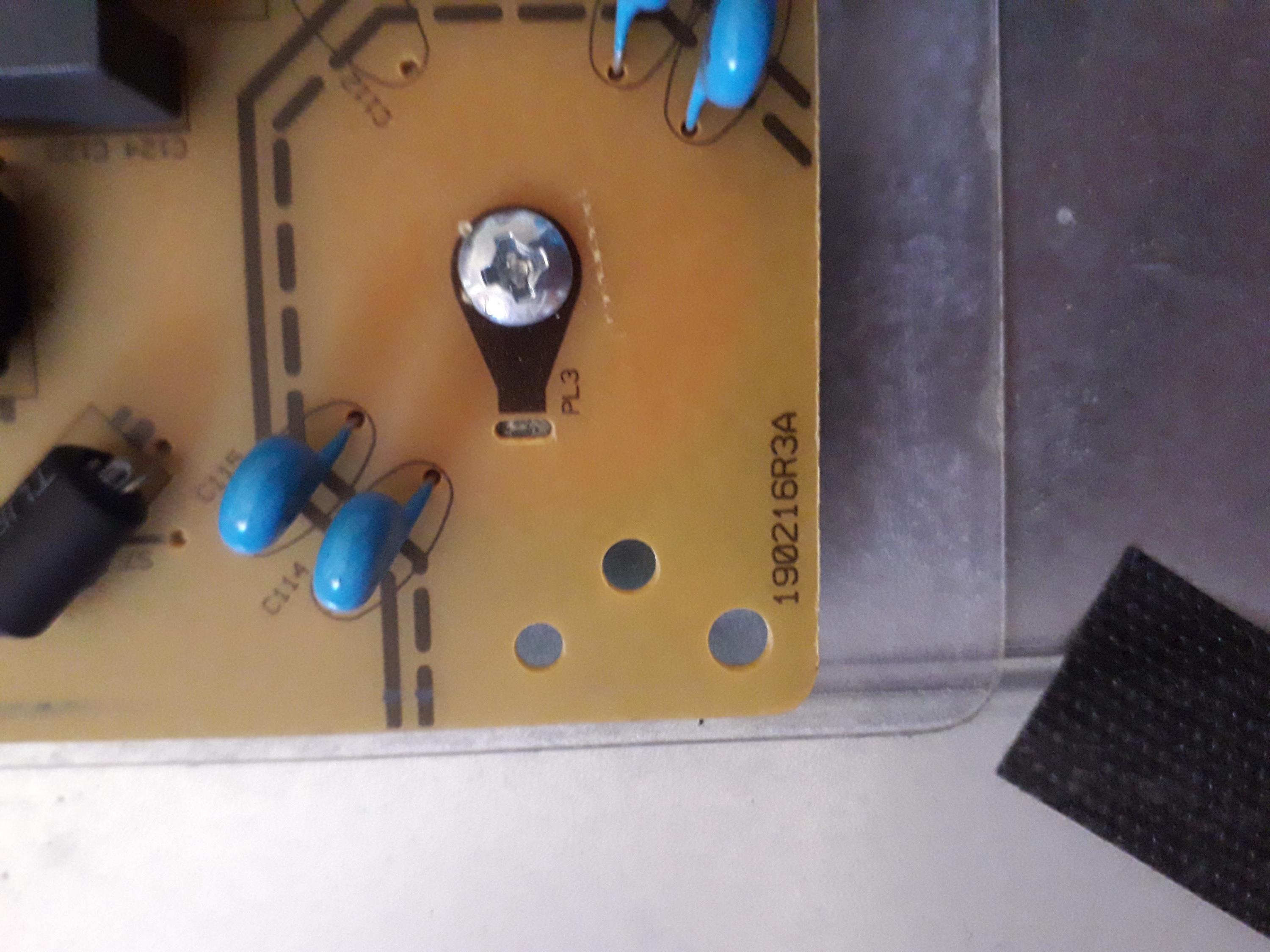

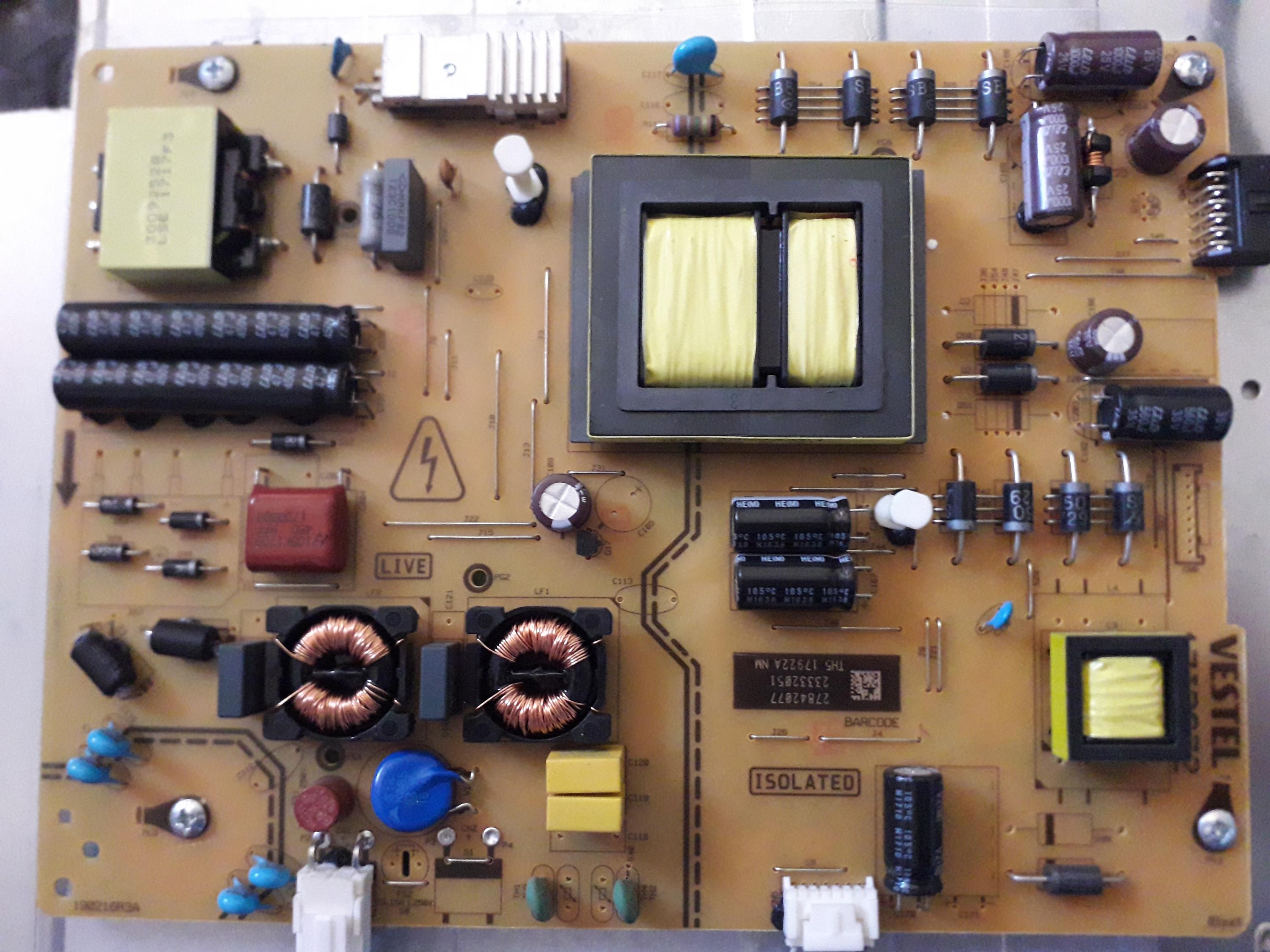

    PSU:
    VESTEL 17IPS72
    Part Number (SKU) 23332051
    PCB corner 190216R3A
    Main:
    VESTEL 17MB120
    Part Number (SKU) 23411071
    PCB corner 040316R2A

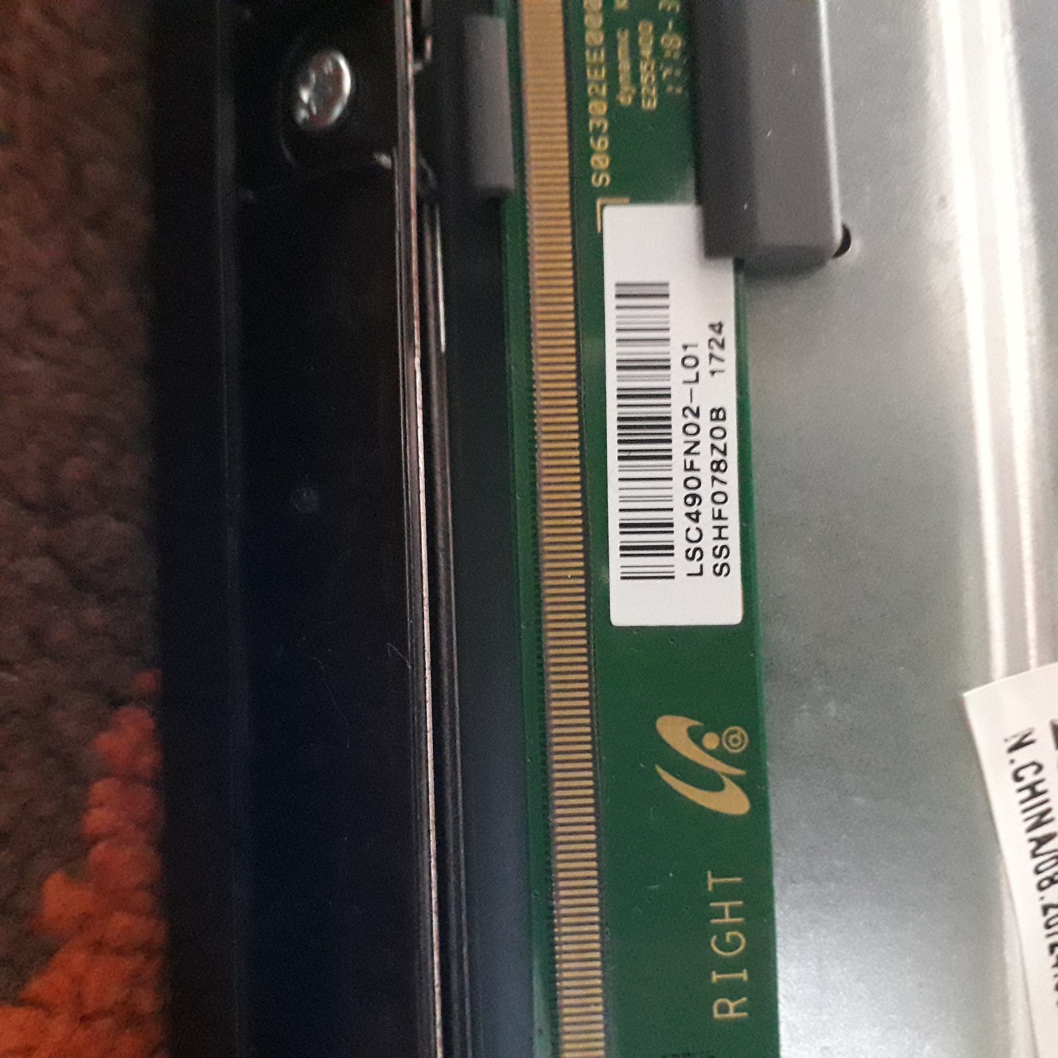

    LCD Panel:
    Part Number (SKU): VES490QNDS-2D-U11
    other info in white label: 23342328, 23333030

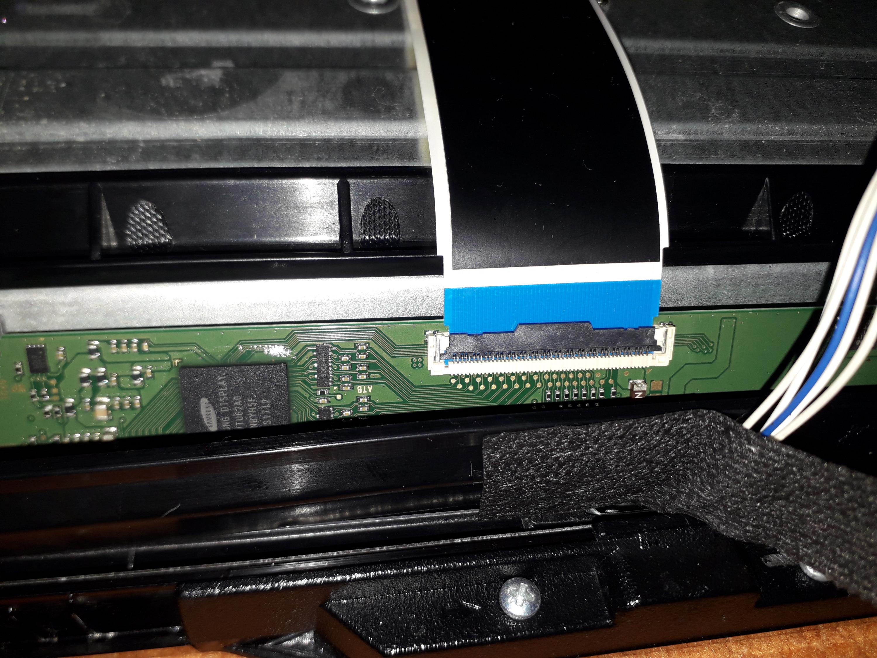

    COF IC & PCB:
    Part Number (SKU): LSC490FN02-L01
    16Y-49XSR2LV0.2 (screen PCB RIGHT SIDE)
    16Y-49GU11APHTA6XSLVO.3 (screen PCB LEFT SIDE)
    NOTE: THIS IS THE T-CON? PCB IS BONDED/INTEGRATED IN THE GLASS

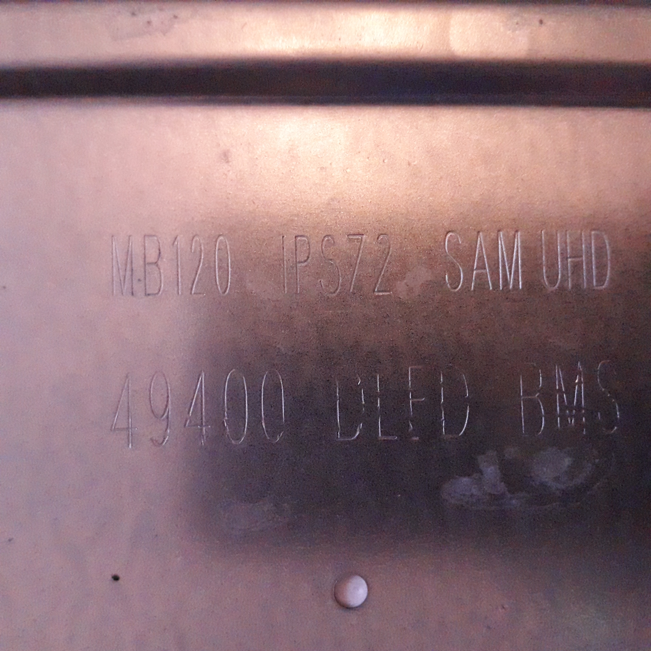

    info in metal Back Panel chassis
    MB 120 IPS72 SAM UHD
    49400 DLED BMS
    1- TV reboots fine
    2- TV response to remote control
    3- TV has sound
    note: photos/video/labels attached
    Many thanks

      I have already added two winrar files with the problem videos. can't you open it?
      anyway i have now added a picture of the problem "tunning menu". however, the picture does not elucidate the real problem, as it is not a static problem.
      thanks
      • dskall
        • Oct 2016
        • 2905
        • usa
        Re: KUBO K1249VTSTUHD (49" ultra 4K Smart TV): Screen Problem
        Looks like timing problem. You've cleaned and reseated lvds cable?
