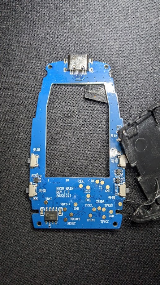

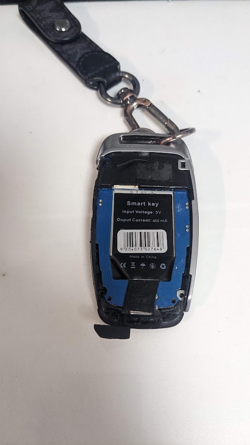

    Hy guys, i have this Audi smart key with a touch screen not working, the key has a 450 mA battery inside that looks ok on the multimeter, but when connecting the usb c on the board there is no power consumption, no current going to the board. Has anyone worked on these before?

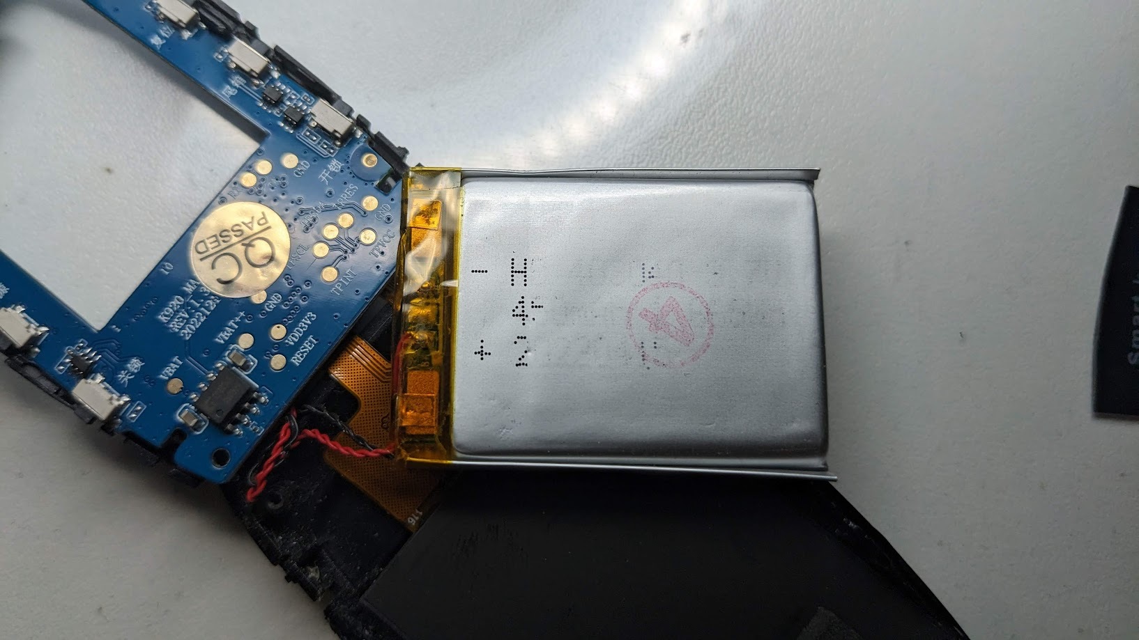

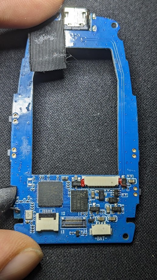

      Nothing wrong with the usb c port, i have voltage on the pins while connecting the charger 5v and 3v , but i don't have anymore voltage on the board, only on some ics i can find 1.7v .but nothing on the battery port.

        What Audi and year is this from? My guess is the the IC in the 3rd pic, bottom left. See if you got juice going in to it but not coming out.
