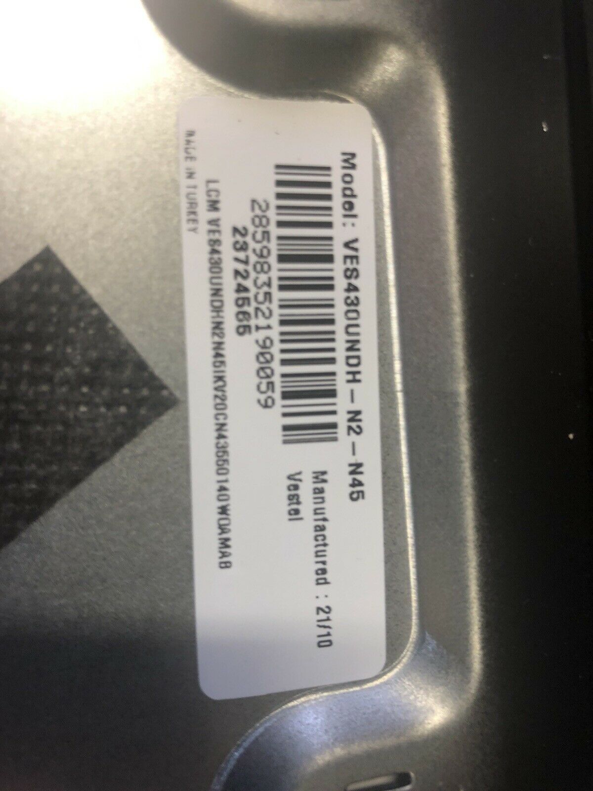

    I have a problem with this tv Hitachi with vestel 17MB171 board.
    I turned off a couple days ago and the next morning when I turned on it had the issue, i tried to left the power unplugged for several hours but nothing.
    The tv turns on shows the logo picture and after a few seconds reboots, and start over again.
    I was able to connect via uart to the tv and grab the log I attached, it has logged 3 reboots.
    I believe it is a corrupted software, but I could not find any online, does anyone has it, or where to download.
    Hope someone more expert can help me with this.

    what lcd panel number is used in this set? its usually on the metal tv chassis on a white sticker

      panel is LG LC430EUE FH M1

        Let me add chassis sticker number
        VES430UNDH-N2-N45

          Re: Hitachi 43HAE4251 - Vestel 17MB171 - Displays logo and reboots
          Hitachi 43HAE4251
          17MB171
          VES430UNDH-N2-N45
          Maybe post a firmware request in this thread too

            Ok, I solved it.
            A friend gave me the firmware for another motherboard 17MB170 and it worked, the brand logo is not Hitachi anymore, now is Regal, bit that is not a problem.
            Also had to change a setting on the factory menu, the screen was displaying some vertical lines and dots: SSC adjust-> LVDS to off
            Here is the file:
            LINK REMOVED AT POSTER'S REQUEST
            For this 17MB171 it has to be renamed "upgrade_loader_no_tvcertificate.pkg" for the TV to find it.
            Hope can be useful to someone else.
