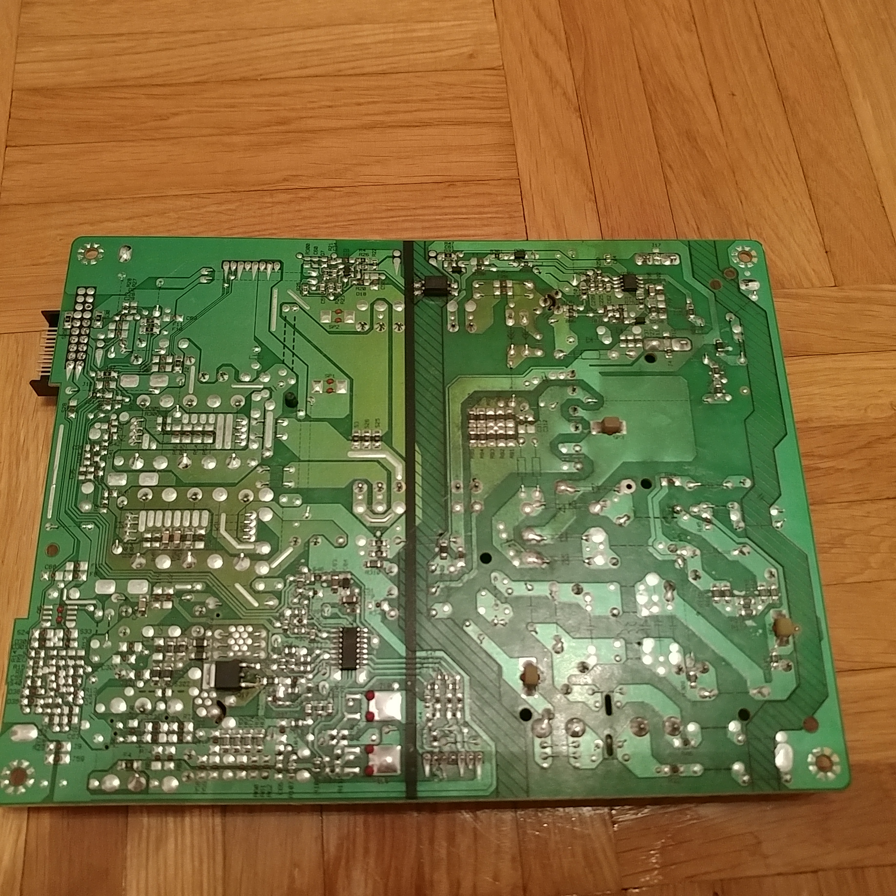

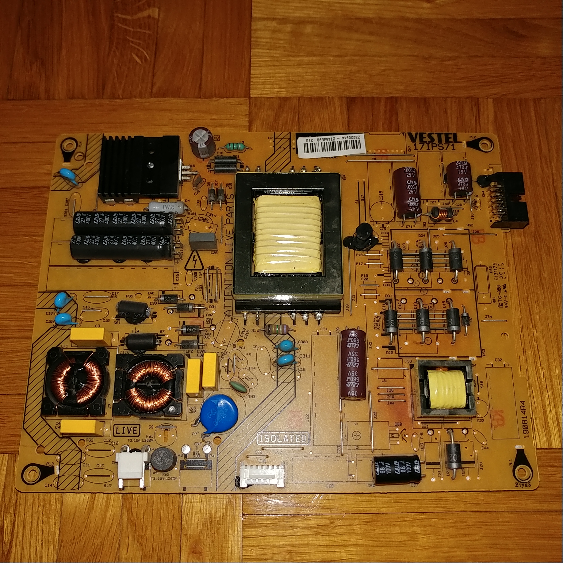

    Hello guys,
    I have 32 inch Hitachi TV with Vestel PSU board 17IPS71. Tv was working normally and I shut it down normally via remote control.
    The next morning it couldn't turn ON neither with remote controller or via button on the logic board.
    There is a red standby LED ON, so it is not dead totally.
    I have examined the PSU board and I cannot find find any traces of blown components or bulged caps. Electrolytic caps are manufactured by Elite.
    I also check diodes and big MOSFET (with cooler/heatsink). It seems OK.
    Can you tell me based on your experience if the fault is most likely on PSU or logic board? Based on what I have found on the forum, these Vestel 17IPS board are not really high quality boards, so I guess problem is on the PSU part.
    Do you have any advice what should I check further?

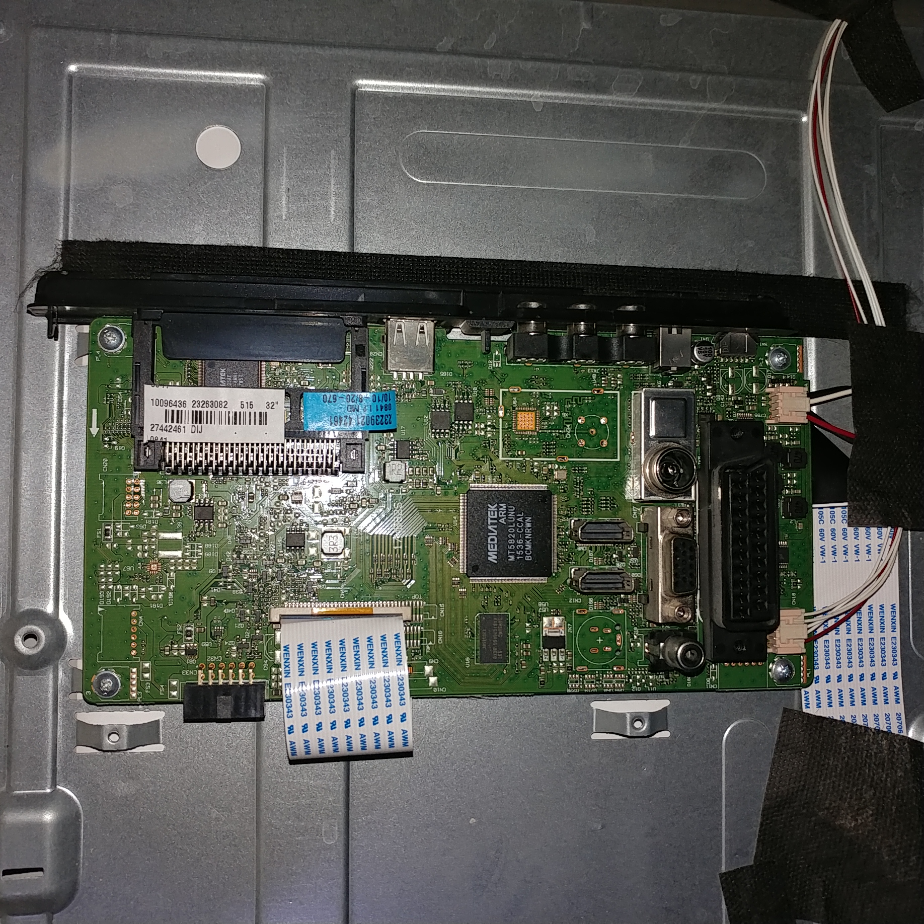

    whats the full tv model number and what mainboard number is used in this tv
    • Askic
      • Sep 2018
      • 187
      • BIH
      Re: Hitachi (Vestel) TV is not turning on
      model is 32HYC01, 65W and the photo of motherboard is attached. I believe it is 17MB82S.
