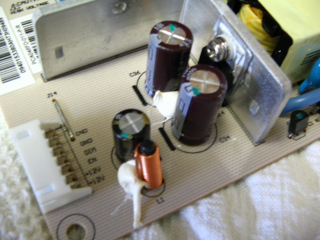

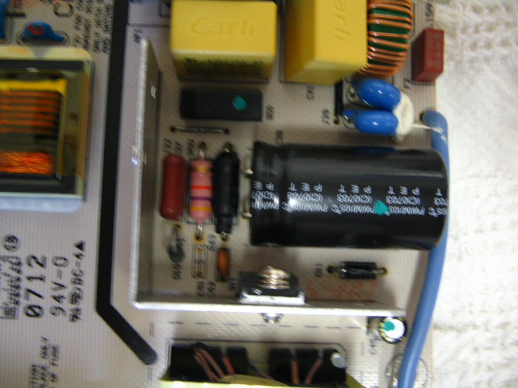

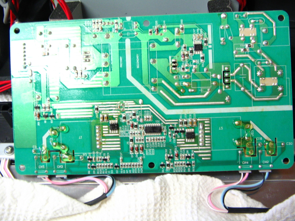

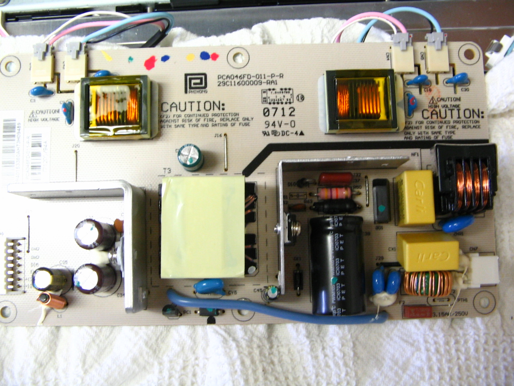

    Hi old Badcap gang. I was able to pick this up from the curbside. My introduction to the LCD world was a Viewsonic CPU screen that I still use today, so I thought if I could successfully re-cap a CPU screen((with alot of help from you guys)) that I'll give a TV a try.
    Symptom:Nothing happens when powered on.
    It's all dissassembled. I was surprised it has a Samsung LCD in it so I decided it was a worthy candidate. Power board looks OK. No dark areas or solder problems so I can rule out power surge type injury. I have a blue ECR meter but I need to assemble it. In the meantime...
    Some pics for you to peruse.

    Is this a TV or a monitor? And what do you mean by 'nothing happens'? No power LED? If a TV power LED doesn't go from red to green?
    First step it to verify the power supply is working.

      Hi PlainBill, It's a TV and DVD player in one. No LED's or anything happens to indicate power to circuits. Matter of fact, there is still a DVD disc in the DVD player. I'm guessing the original owner lost power while watching a DVD. Not much more to add. I think I'll go ahead and replace the few caps on the power board. Yes?

        No. Take your DMM and check the voltage at the power connector. The caps look good. If you have 12Volts, look elsewhere for the problem. If there is no 12 volts, look for 165 volts across the large cap, check the fuse, etc.
        Analogy: When your car won't start, verify there is gas in the gas tank before you replace the spark plugs, spark plug wires, distributor, etc.
